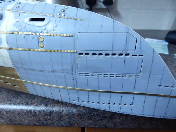

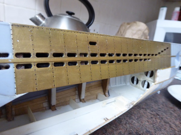

Looking aft.
#1082 Posted : 10 August 2017 21:38:10
Close up.

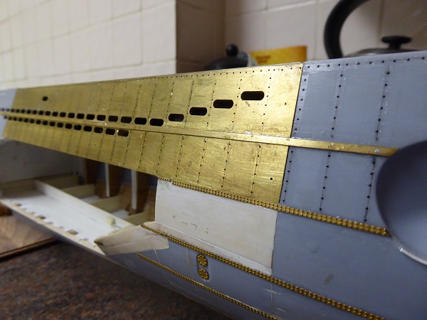

#1083 Posted : 10 August 2017 21:39:45

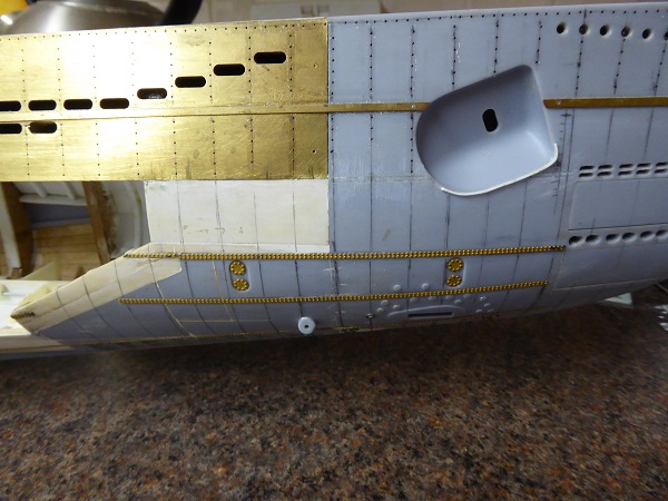

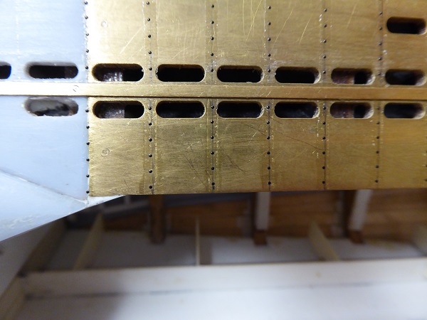

This photo shows the next section marked out in pencil, again, to act as a guide for the transfers.
#1084 Posted : 10 August 2017 21:40:55
Rivets laid.

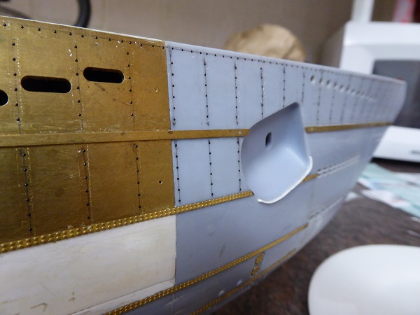

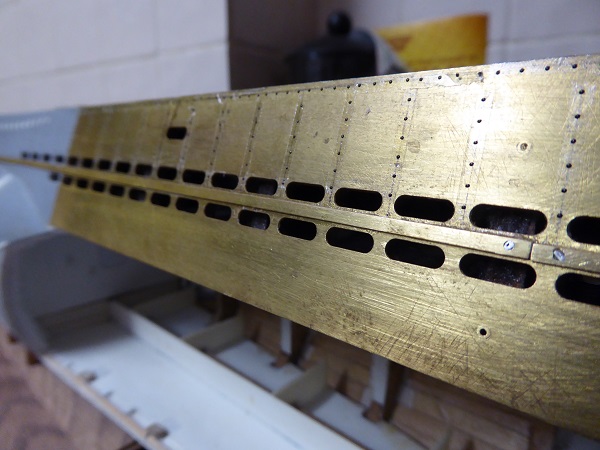

#1085 Posted : 10 August 2017 21:41:43
Looking forward.
#1086 Posted : 10 August 2017 21:42:45
Anchor well.

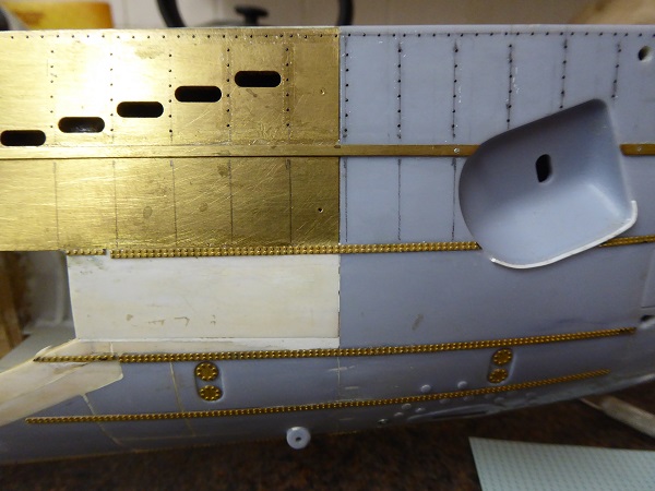

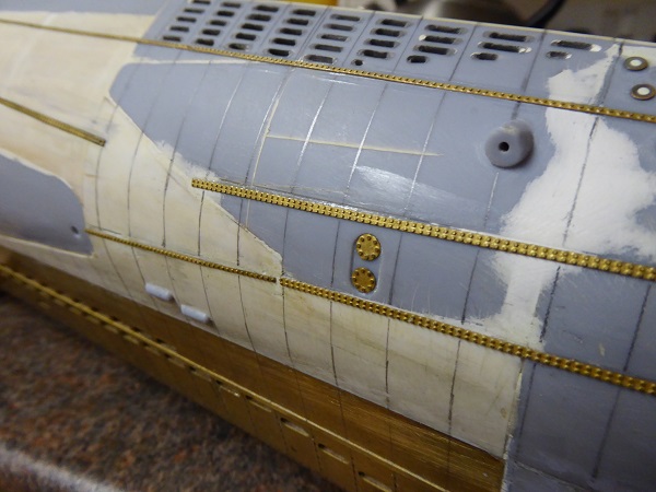

#1087 Posted : 10 August 2017 21:44:01
Upper, starboard hull looking aft.
#1088 Posted : 10 August 2017 21:47:09

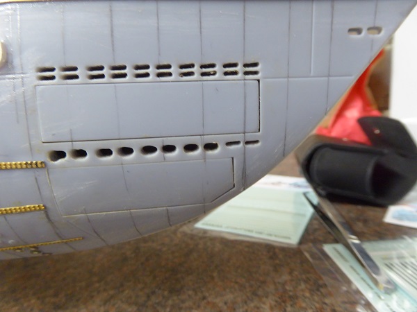

I then proceeded to mark out the remainder of the vertical rivet guide lines on the forward starboard bow. There are horizontal patterns around the torpedo tube bow caps, but I will add these as i go.

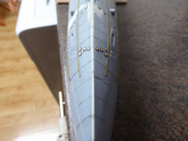

#1089 Posted : 10 August 2017 21:47:57
Another photo showing the pencil guide lines drawn out.
#1090 Posted : 10 August 2017 21:48:58
A side on view.

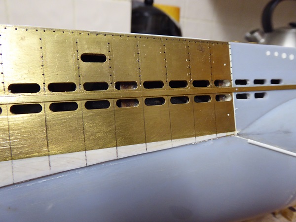

#1091 Posted : 10 August 2017 21:55:06
I then proceeded to mark out and lay the rivets to their corresponding port side sections.
#1092 Posted : 10 August 2017 21:55:56
Moving forward.
#1093 Posted : 10 August 2017 22:01:55
As with the upper starboard side, I then marked out the remainder of the vertical guide lines. The reason I chose to do it this way rather than lay all of the rivets on one side was to better gauge how many rivets I used and also not having to face the daunting task of laying them all again on the opposite side. I figured that working in small sections on both sides was a better option for me.
