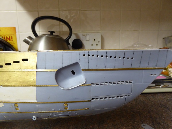

A plan view showing the completed casing extensions.
#1062 Posted : 03 August 2017 07:58:09
Overall, i was very happy BigGrin with the way these modifications turned out; blended curves that sit well against the angled casing sides.

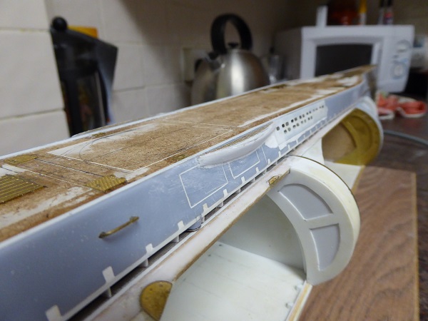

The attached photo shows the upper starboard bow being marked out in pencil to act as a guide when laying the rivet strips.

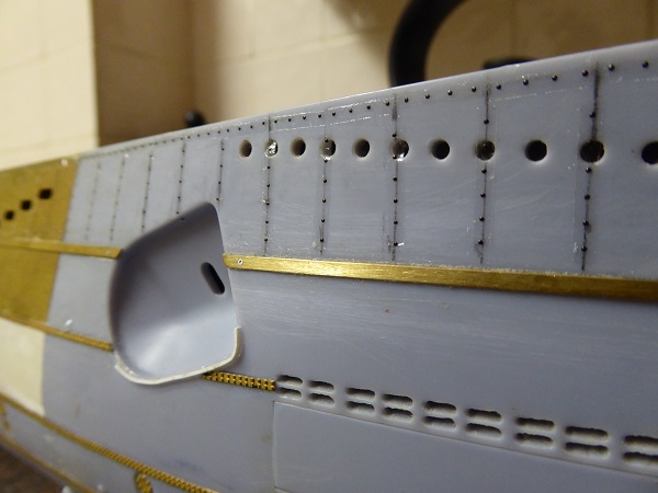

Laying the small strips with four rivets on each.

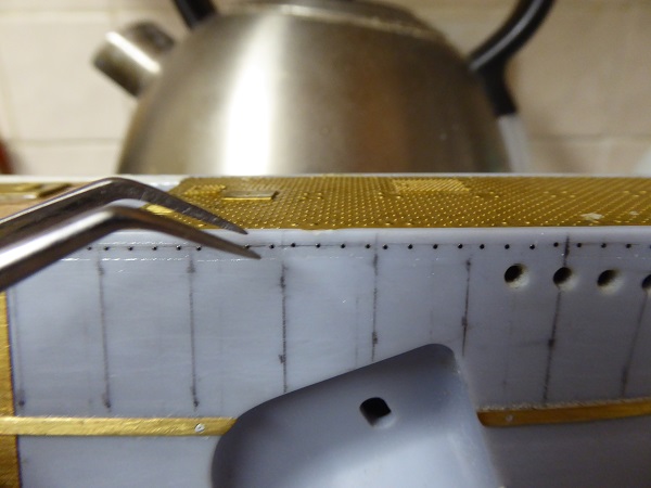

Upper, starboard bow complete.

This photo shows the transfers freshly applied prior to the Microsol.
