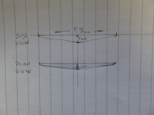

Morning from 'The Dockyard'.
This weeks update on my U230 build log will look at adding extensions to the casing near to where the conning tower will be located. These extensions were fitted to U-boats which had their conning towers modified from a Turm II to a Turm IV, including U230. U230 had already been a sea going vessel for some time before it received these extensions. Later on, all U-boats were fitted with a Turm IV conning tower and extensions from new.
The Turm IV type conning tower has an extra lower platform to facilitate a 3.3cm gun. To allow the crew to walk around a Turm IV tower, extensions were added to the casing as the previous space was now very narrow.
After studying photos of U995, which was fitted with these from new, I could determine their location on my build.
The attached photo shows my diagram with dimensions.

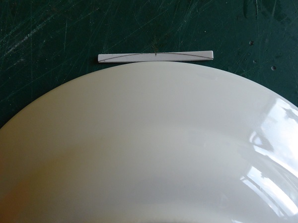

After cutting out two pieces of 0.5mm plastic sheet to the overall size I could then mark out and cut a curve to represent their outer edge.
The only thing I could find of suitable diameter was a plate!LOL
The photo shows the curves being marked out.

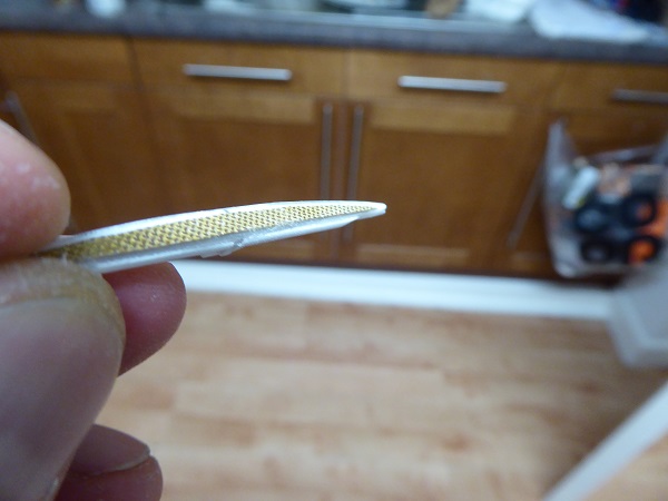

#1045 Posted : 03 August 2017 07:30:51

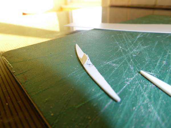

Using the same plate I could also mark out a curve on some tread plate.
#1046 Posted : 03 August 2017 07:31:45
Tread plate cut and then glued to the plastic profile.
#1047 Posted : 03 August 2017 07:32:29
Port and starboard pieces with tread plate attached.

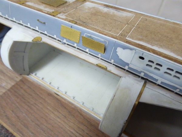

#1048 Posted : 03 August 2017 07:34:41

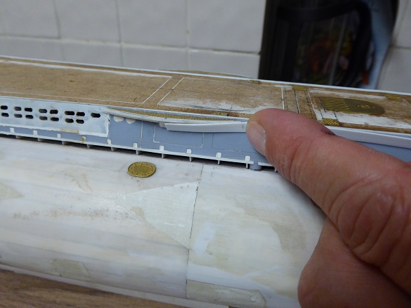

These were then offered up to the boat to determine how I was going to support them and in doing so, realised the etched brass rivet plates would have to be removed.
The attached photo shows the first one being lifted away.

#1053 Posted : 03 August 2017 07:44:47
This photo shows the port extension fixed in place, sitting level against the angled casing sides.

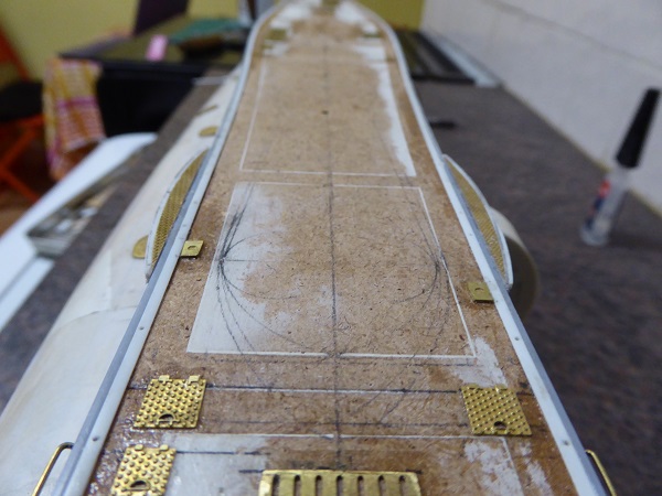

#1054 Posted : 03 August 2017 07:46:08
An overhead view showing both port and starboard extensions fitted.

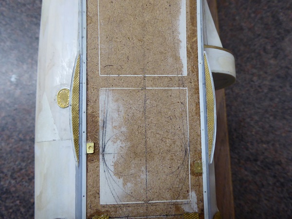

#1055 Posted : 03 August 2017 07:47:19
This photo shows the extensions level with the top of the casing.

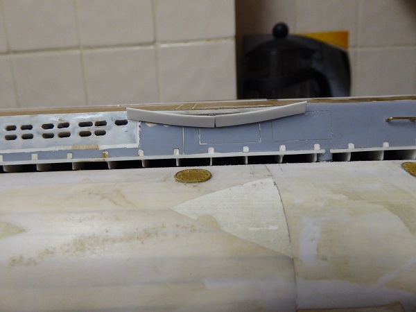

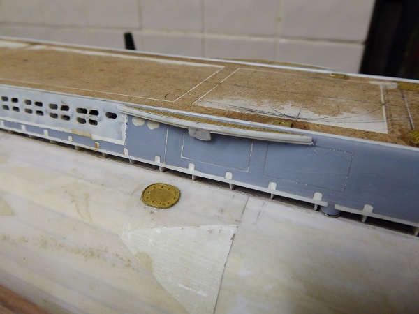

#1056 Posted : 03 August 2017 07:49:42
To make the outside contours I used 0.5mm plastic sheet. The attached photo shows the first piece, glued at one end, being checked for fit.
#1057 Posted : 03 August 2017 07:50:52
Two pieces fitted. The same technique was used for the other extension.
#1058 Posted : 03 August 2017 07:52:39
Plenty of time was then spent on filing these plastic pieces to suit, followed by filler and then more filing.
#1059 Posted : 03 August 2017 07:53:43
From another angle.
#1060 Posted : 03 August 2017 07:54:21
Port side.
