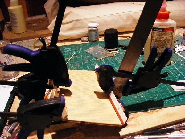

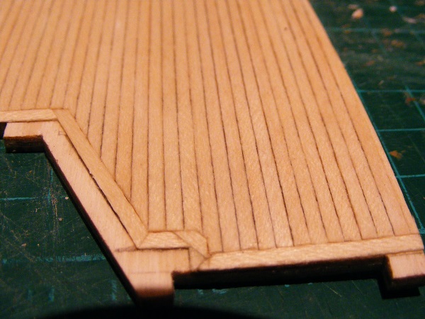

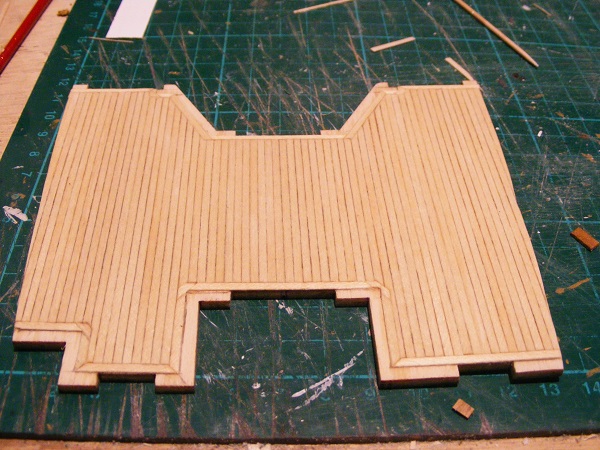

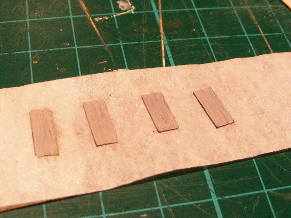

Finished planking the aft well deck and this I have to say with the size of the planks was a very time consuming process.. once again edged the deck with 2mm edging... And again, used a pencil lightly down one edge of the planks to give a little more definition....Cool Cool .. Sanded the deck with fine grade sandpaper and have given it the first coat of natural Danish oil.... Started the cladding on the bow well deck, cut the pieces to fit, gave them a coat of primer followed by a few coats of titanium white.... Also cut 4 of the etched doors off the fret and stuck them down onto masking tape before giving them a coat of metal primer......Cool Cool .. More soon.....

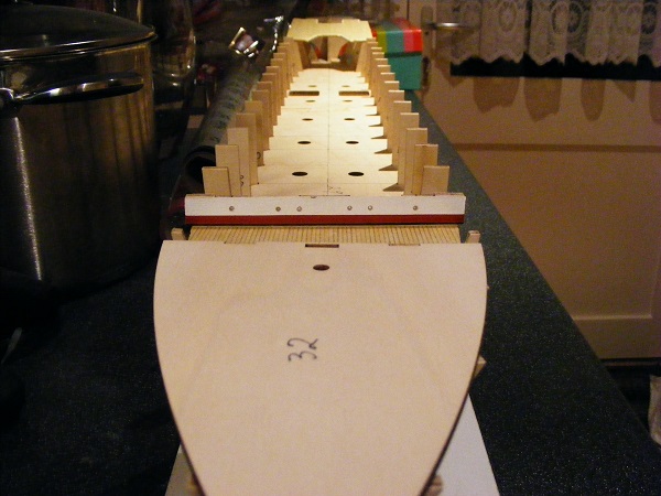

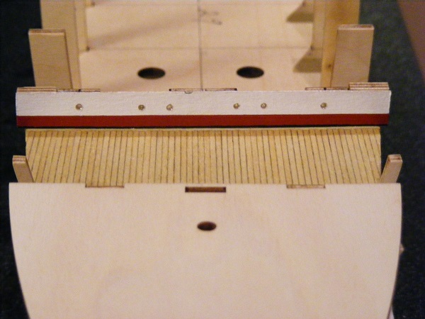

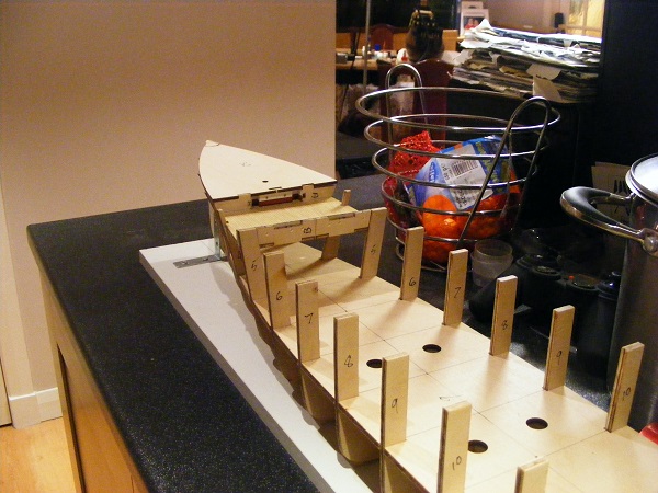

Moved forward a little and have now done as much as I can at this stage on the bow well deck... Sanded the tops of the bow ribs during the process of dry fitting the well deck and the bow deck as per the instructions. This is all dry fitted as yet and its my intention not to fit any decks fully until I have sorted out wiring runs etc.... Cool Cool .. There are still two light fitting to be added to the rear bulkhead, will be using fibre optics for this but still have to come up with a way fitting light shades rather than just leaving the end of a simple fibre optic bare.... thinking cap is on....Blink Blink .. Now going to start fitting the bulkheads on the aft well deck....
