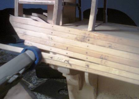

Hi Nigel, Keep searching for the book/s please, its usualy kept high out of reach of wife and kids hands.BigGrin
Thanks for pointing out the second layer. I am now only going to straighten the 2nd band due to the set egde I did to follow the decks Blushing . I noticed I have a few planks that clinker at the bow section due to the set edging (only find out recently its a bad thing).
At the stern section I shall have to fit a stealer/dropper to ease the planking towards the keel. If I can do all this in one band, I should be OK with the rest of the original built diary.
Regarding the cannons, it is the bronze ones. I am not fond of tinkering with chemicals. I might order enough for the top deck and keep the unpainted ones for whatever. I was going for blue gun the cannons at the gunshop, but Nah... do not like the colour.

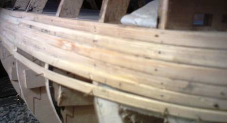

Its been a while since I did an update on my build.
I laid row six (from the deck)in a straight line to remove the klinker effect. This caused gaps that need to be filled with droppers. At the bow I used a 3mm dropper and in the middle a filler plank. I am happy with the results.
