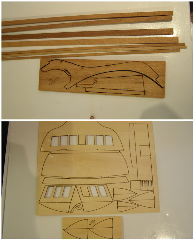

Thanks for the comments All,
Here is what I received in issues 9 and 10. I've not got anymore progress as am waiting on ordering the planks in Walnut.

#84 Posted : 12 October 2010 21:09:28
Thanks Secret,
I received my Walnut planks today, Here I thought i would see how they bend. I found them quite easy to work with when wet.

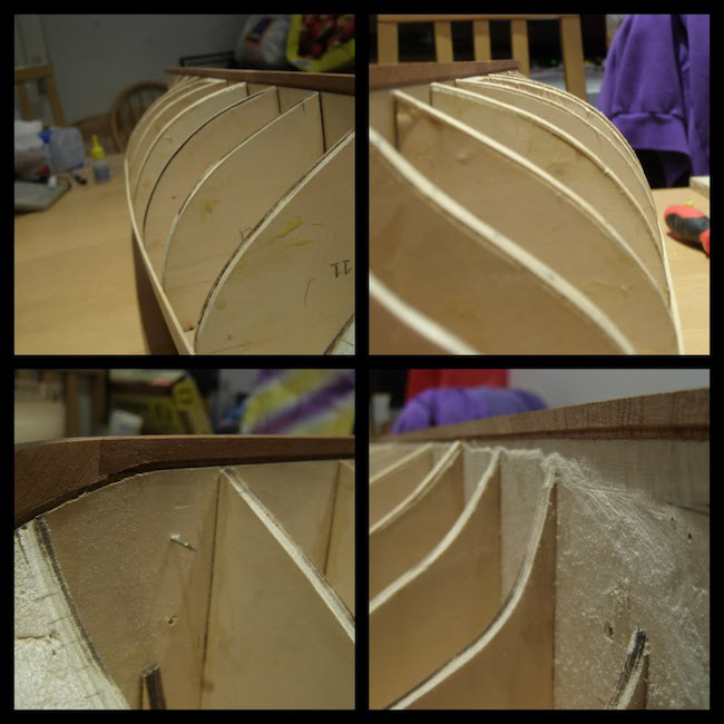

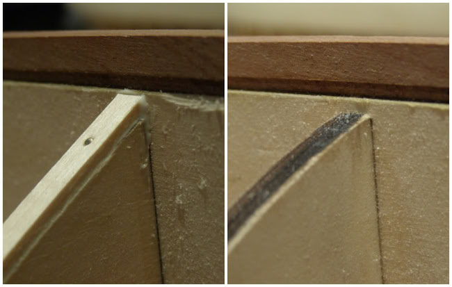

#86 Posted : 17 October 2010 23:45:35

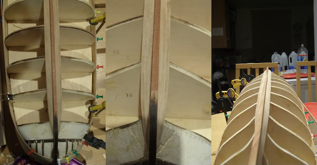

Hi ,, Thanks for the comments...
Here I have deviated from the instructions and fitted the Stem and Keel before planking and have cut a rabbet which the instructions don't have you doing. I am measuring for the garboard plank which I have bought a 10mm planks for..
I also have had to severly pack out the ribs to get them level..
Chris..

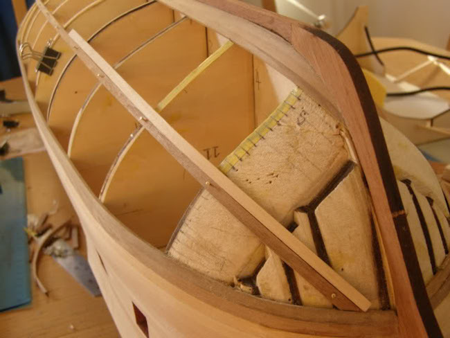

#88 Posted : 18 October 2010 21:12:44
Thanks Secret..
Here is the first Garboard Plank fitted, I have cut both just waiting for one too dry before fitting the second.. Didn't know how much of a pain they are to do the first time... LOL.
Chris..BigGrin

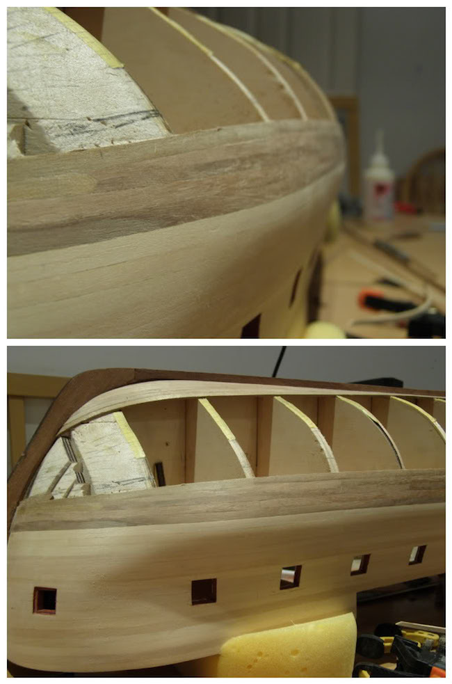

#90 Posted : 19 October 2010 21:25:32
Cheers Robert,
Here is the Garboard and first plank next too it finished, now for the two whale planks then I can start marking out where too star planking from...
Chris...

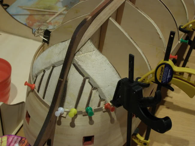

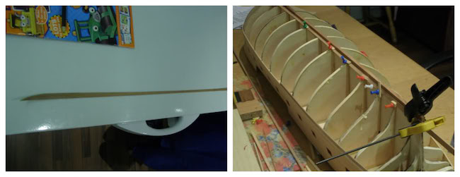

#94 Posted : 24 October 2010 10:33:32
Hi All,
Here I have started to make markings to where I will start the planking, Preparing and marking is time consuming. I have installed a Plank for me too mark up, It will be removed as it is pinned..Lol..
Chris..

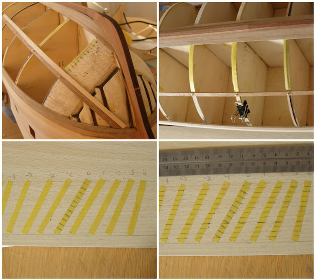

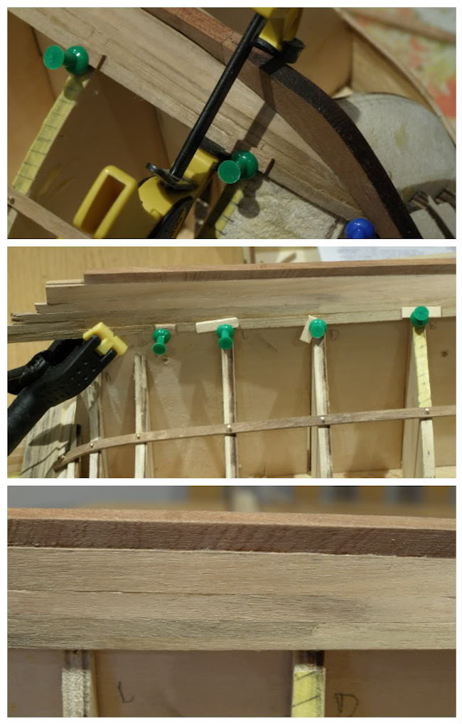

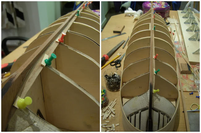

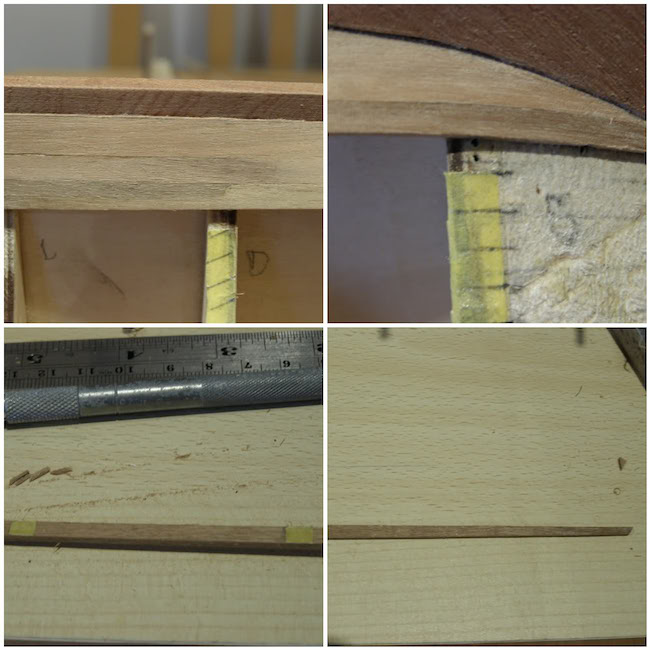

#96 Posted : 29 October 2010 22:36:20
Hi All, Not posted for while been busy..lol..
I first installed the centre strake to get a split between lower and upper hull. I then put masking tape into the gaps. and on the centre rib the wides gap I placed planks there and counted how many it would take to fill, i drew a line on the centre tape at the point of each plank. I removed the tape of the shortest rib and placed it on a piece of wood and drew a line with a square exactly the same as the tape then in order placed each piece of tape in between those lines, Then with the centre piece of tape in place I drew a line across all pieces of tape,
I Removed them and placed them back on the ship in the right sequence . I the cut along the tape on each tape parallel to the last plank and stuck them to a plank.( mark position of each rib).That then gives a width need for section of plank, So i can file or plane the plank to the tape. Giving the correct shape. Once sanded i Fitted them..
I didn't bend the plank along the ship sideways. At the stern I have used a stealer.. Last pic is the stealer, Find it..lol
Thanks , Chris...

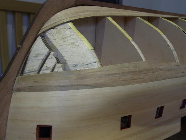

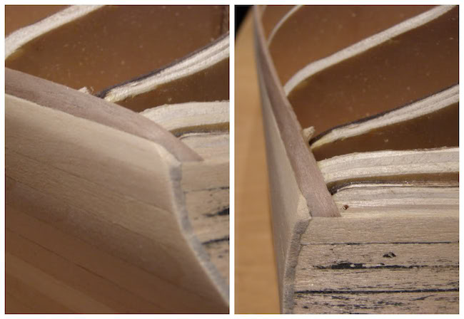

#98 Posted : 01 November 2010 20:38:40
Hi All again.
Thanks Budgie.
Only got one pic today. Here is the bow of the ship, I have attempted to plank the correct way inline with reality. No sharp ends lol..BigGrin
Chris..
