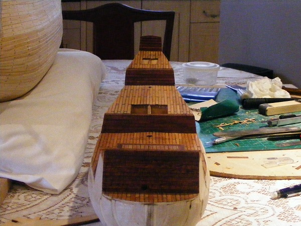

#83 Posted : 28 April 2013 10:05:37
jase wrote:
Looks stunning certainly rewarding the time and effort spent Cool
Thanks for the encouraging comments Jase, appreciate your input... BigGrin .. Has been a slow process but really like the way it has turned out... Cool .. I was trying to get a worn look to the deck, not so much a weathered look but a deck that looked as if it had been well used but very well maintained... Think I have achieved my aim..... BigGrin BigGrin

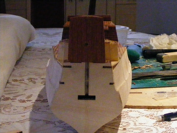

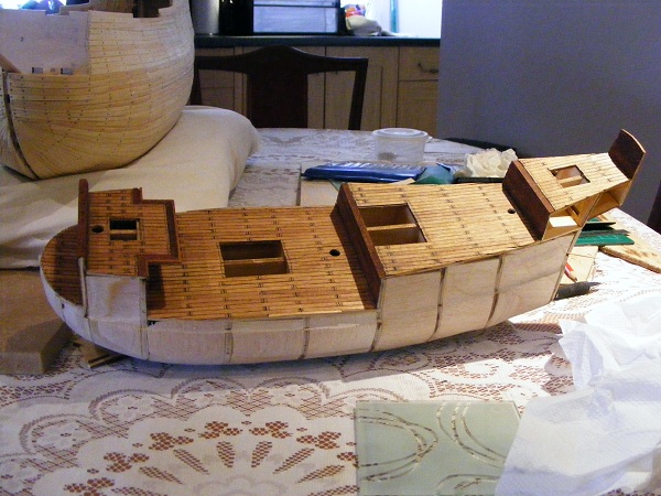

Finished the decking with the exception of giving it a coat of matt varnish and completed the lining on the bulkheads.... Also made a start on planking the stern section.... Cool Cool .. My intention now is to finish the stern planking then do some work on the SOTS BigGrin BigGrin

Coming on really well there Alan, all those ups and downs in the deck levels must be a nightmare to plank out! Blink

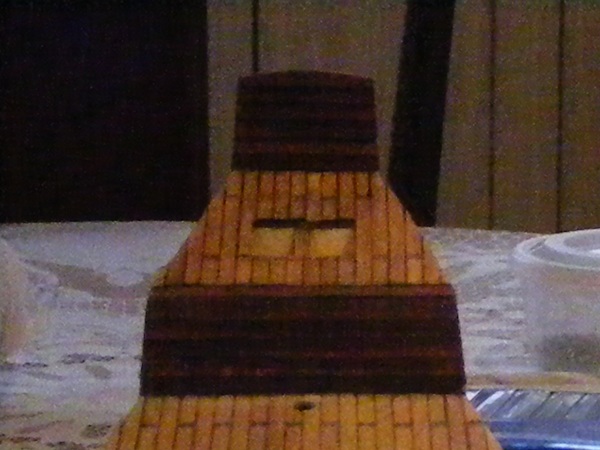

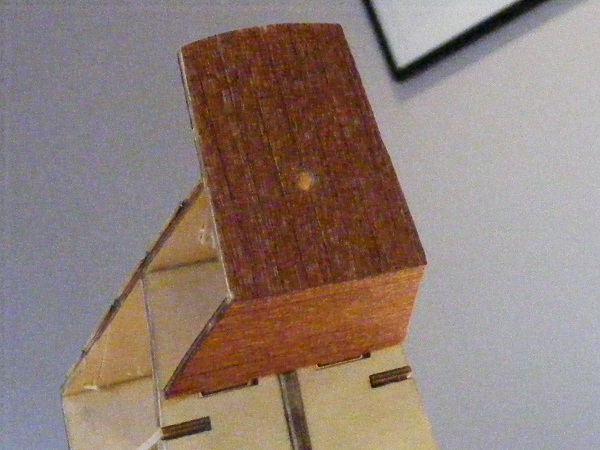

While waiting for filler to dry on the SOTS thought I would turn my hand to the SF.... Finished the planking on the stern section and trimmed the edges. Only have to finish cutting out the hole for the helm, a task for later..... Cool Cool . Build may take a little bit of a back seat for a while as the next stage of the SOTS involves quite a lot of work. May come back to the SF just to give a break from all the port cutting.... BigGrin BigGrin

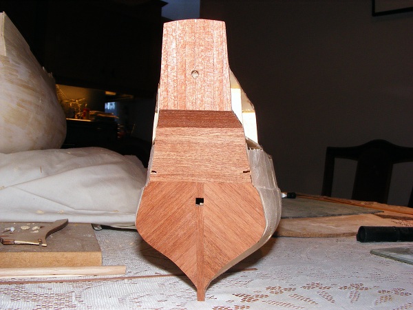

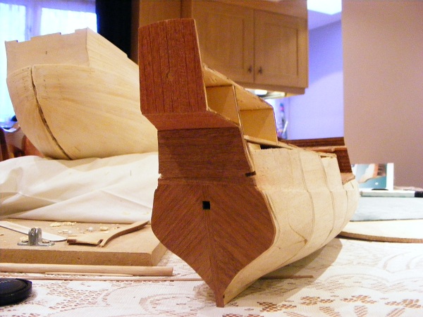

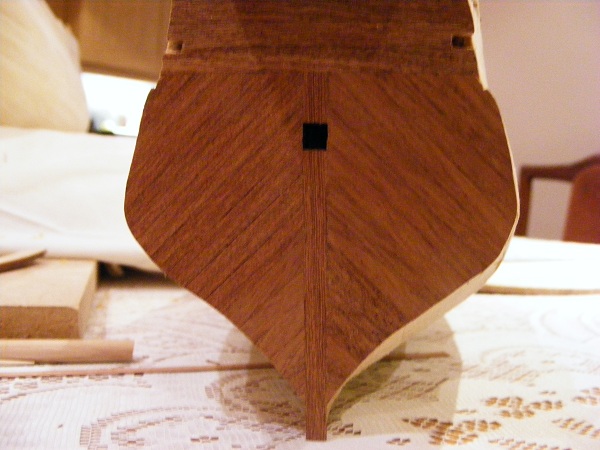

Really nice job. I think the chevron planking on the stern of this model really makes it stand outLove

That`s looking Cool and have to agree with Jase the stern chevron planking looks superb.I don`t know how difficult it was but it was well worth the effort.
Well done m8, Love it.
Thanks Jase and I have to agree, love the effect of the chevron planking. Think it will look superb once fine sanded and danish oiled... BigGrin BigGrin .. Thanks for looking in...

#100 Posted : 02 May 2013 11:26:30
delboy271155 wrote:
Hi Alan,Drool
Hi Derek, thanks for the encouraging comments... Cool Cool .. The chevron planking wasn't too difficult actually, simply cut the ends of the planks to 45 degrees using a razor saw and mitre jig, lightly sand the cut edges to remove any imperfections and test fitted dry before gluing with alphatic glue... BigGrin BigGrin ..
