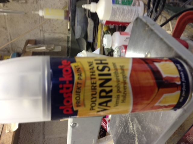

NMBROOK
#92 Posted : 05 May 2013 20:27:44
I really wouldn't risk it.Laquer is designed for wet on wet i.e.colour coat the laquer as soon as the colour has flashed of.This is to allow the colour to shrink at the same time as the laquer.The problem lies when the colour has dried then you laquer over the top,the laquer shrinks like mad but the colour cant so it crazes.I know its nearly eight quid a tin but if you are just sealing your finish one can might do the whole boat because you only need two or three mist coats.I cant recommend this enough

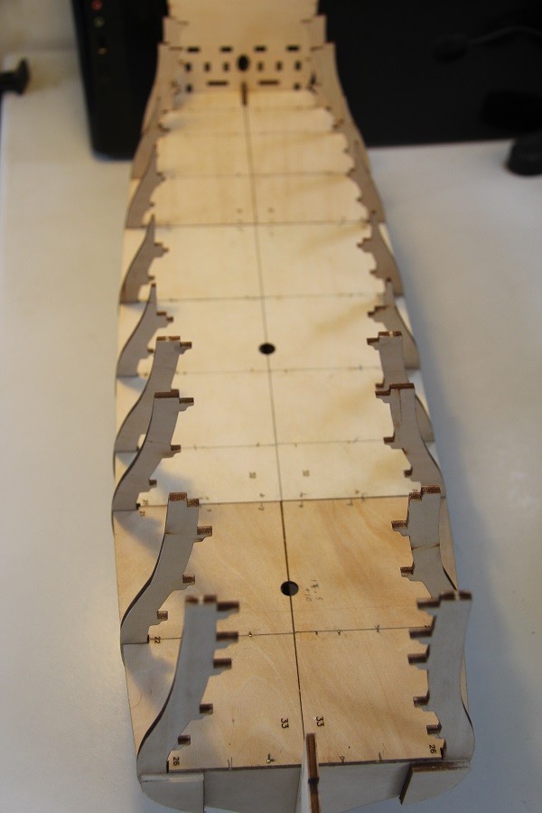

Captain David
#96 Posted : 13 May 2013 09:38:13
Joined: 27/02/2013
Posts: 228
Points: 664
Location: Bursledon
Fitting the ribs to the keel, using the lower deck as a template.
First, I checked the assembled keel for straightness by sighting down it, yet again. As it has been stored for a while, it might have developed a problem. Thankfully, it is still good.
All the ribs are now dry-assembled to the keel.

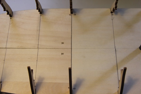

Keeping the deck section in the fret, look for drill bits of the exact diameter of the mast-holes. They are 10mm and 8mm. Dry-fit the deck sections, after marking the pin-lines. Check everything will line up properly, especially the joints between the deck sections.
All the parts are machined accurately. I checked each deck section against its opposite number for a perfect match of the rib slots. The points where 4 sections meet form a perfect cross, the mast holes match up. The aft deck meets the transom of rib 26 and the forward deck meets the front bulkhead, both dead square. As they all should, at this stage, or I would suspect a parts problem.
Some of the ribs swivel on the keel a bit, where I have over-sanded the slots. The deck sections will hold them where they should be.
Starting at the bow, lift the forward deck sections away but leave the other decks in place. Now glue in one of the exposed ribs - 5,6 & 7. I thought it best to start with the firmly fitting ones, glueing one in, refitting the deck sections and leaving the rib to dry thoroughly. Then lift the decks and glue in another rib, finally gluing in the loosest one as the now solid ribs and deck give a firm template for any loose ones.
Leaving rib 13 for now (the one where the forward and middle deck sections meet) I then followed the same procedure for the middle deck, fitting ribs 15, 16 & 20. The 10mm drill bit gets replaced in the hole after each rib is placed, to keep the mast-hole lined up. Once these are fully dried overnight, I can risk taking off all 4 of the deck sections around rib 13 and glueing it in.
Finally, the same procedure on the aft. I notice a small discrepancy on the centre line - the aft deck joint is not quite in line with the middle deck joint, but only by 1mm. This will be corrected by holding it in line when the decks are glued and pinned.
I now need to go out and get some deck pins. I want something more substantial then the ones supplied. This will be the most important joint in the ship - adding the horizontal plane to the other two. I want it to be bomb-proof, as the other decks are only glued.

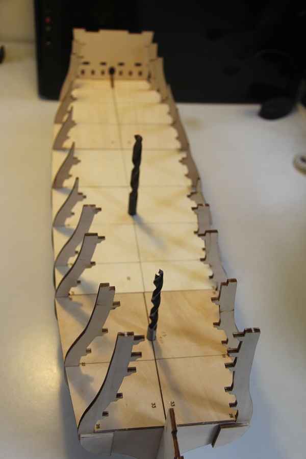

Lower deck glued and pinned.
I gave up on finding larger pins. Hobbycraft only had smaller ones, the DIY stores only had 20mm brass panel pins. I didn't fancy driving into Southampton just for some pins, so used the ones supplied. I can always add some bigger ones later.
All deck sections dry-fitted to start with. Next, mark where the pins will go and pre-drill holes for them.
The official build warns us not to place pins closer than 10mm from the ribs. Well, there is no way I could swing a pin-hammer that close anyway! The upper parts of the ribs curve in too far.
I marked a vertical down from the innermost part of each rib - the highest deck support. Then I allowed half a hammer-head width further in, plus a little bit more. The central edges (over the keel) have pins 10mm from the centre line.
My first attempt still damaged the deck supports on a couple of ribs Cursing. Luckily the bits glued back in OK.
Then I decided to be more sensible and placed a piece of card against each rib to shield it from the hammer.
I haven't bought a modeller's small hammer as I had a 4oz pin hammer and this seems to work OK at this stage of the build.
The last two pinning lines at the aft are so short (the ribs curve it a lot here) that each side only got one pin. Result - exactly 44 pins used, as supplied! Lucky that none of them bent.
The ship now feels pretty solid, though I will keep an eye out for some more pins to add, just to make me feel better LOL
