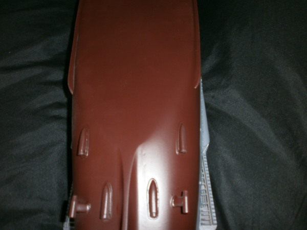

While I, and the rest of the forum, cogitate over what paint scheme my Bismarck is going to take I have pressed on with painting the lower hull, no debating the colour there it is Schiffsbodenfarbe III Rot 5 I have used Oil based paint from WEM and hand painted as i am rubbish with a air brush and don't want to make a mess LOL
First job was to prime the hull i have used Halfords Primer white once dry i masked off a line 2mm into the bottom of the boot top (see post above for boot top line) I have done two thinned coats so far, i recon 3 will do the job. i have also done the rudders (one coat to go) and picked out the zinc anodes with Tamiya Titanium Silver.
As always any constructive comments gladly received.

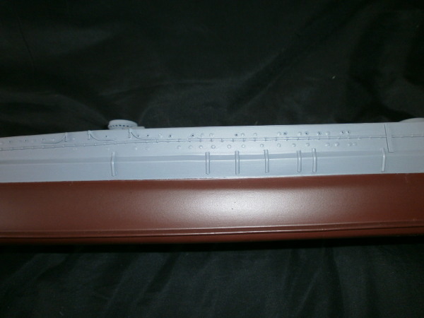

Painting the hull continued
Total Build Time 19.5hrs
Lower hull is now finished in terms of paint. So my next challenge was marking out the strips and false bow & stern. I used a number of sources of reference to get the position correct and had to build up some superstructure to get reference point. My stripes have worked out at 30mm each with the exception of the rear set which are only 20mm wide each. The false waves i have drawn free hand, I will make copes from tracing paper to make mating templates for the other side. the white stripes and false waves overlap the boot top; i have estimated the the boot top is reduced from 10mm to 3mm in these places. I have masked off ready to paint the black in tomorrow. just a point on masking. I have used 3m pressure sensitive tape. the advantage of this product is that it is clear allowing me to cut out shapes and sharp angles. it only works on flat surfaces as the tape is not very flexible, but perfect for this job.

Boot top and stripes went on today. Although i can not work on the bow and stern until my upgrade set turns up Mad I have been able to work on the centre area of the hull. just one side done at the moment. I would be interested in peoples view as to the depth of the stripes on the boot top, does it look correct? After masking i realised I had left the boot top at 3mm on the stern after the false bow wave when i should have returned it to the 10mm depth Blink A also mananged to smudge my nice fresh paint when removing my masking Cursing
