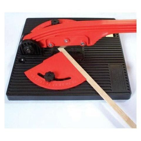

From what I've been reading about the difficulty of cutting the bamboo, thought it might be worth while getting one of these, hopefully should make the job easier. Confused
pabaz attached the following image(s):

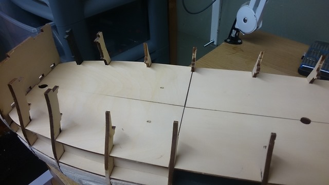

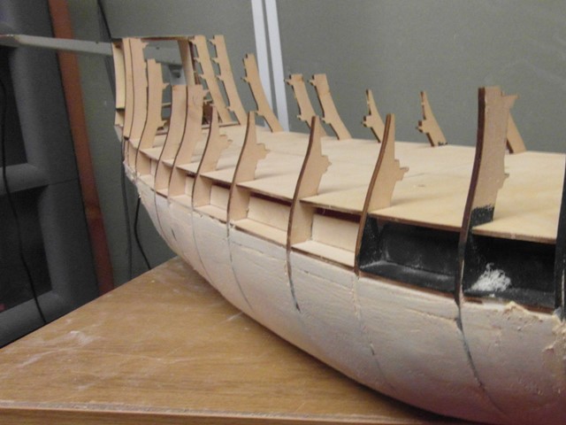

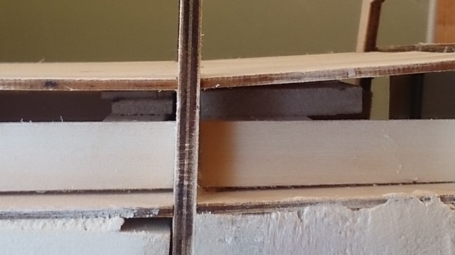

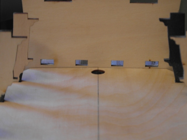

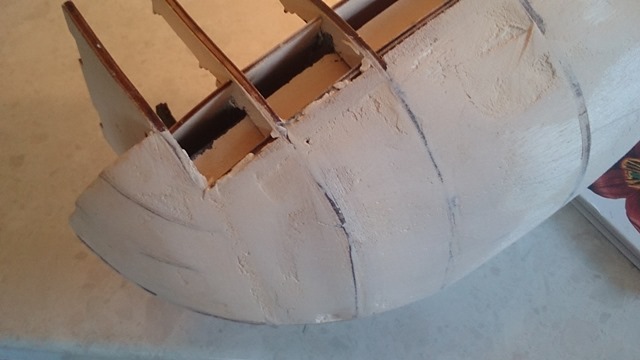

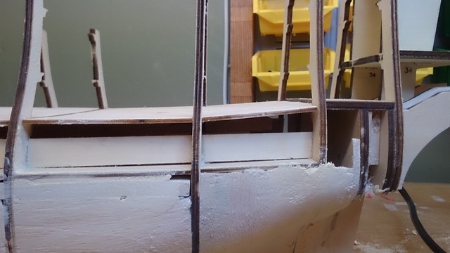

Photo 1 & 2 - As I had decided not to fit lighting I have been fitting the middle deck.
Loose fitted it first to check all was ok, had to sand some areas to make sure it was a better fit.
I glued down the decks to the support beams, also putting some nails in to make sure nothing moved.
Photo 3 & 4 - At the stern end I have glued some balsa to the lower deck to the same height as the support beams, this gave a greater area to glue the deck to as it curve's upwards to the rear of the ship, also put some nails in the secure in place.
The curve is more than I expected, is this what it should be like ?

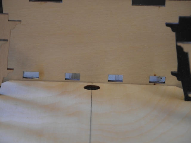

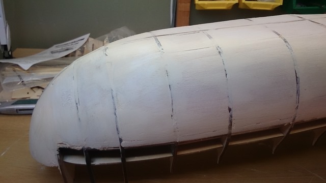

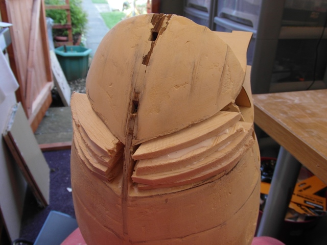

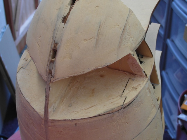

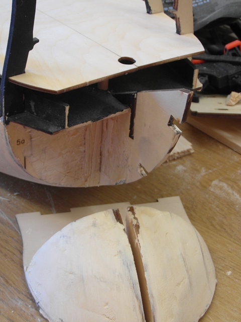

Photo 1 & 2 - After I fitted the middle deck I realised that the bulkhead didn't look straight.
Photo 3 & 4 - As you can see from the photo I have used balsa to infill the bulkhead, needed to cut this out & clean up the area of glue & balsa.
Photo 5 - 7 - The bulkhead re-fitted, with balsa infill & complete after shaping & sanding.
Photo 8 - The bulkhead now level with the deck.

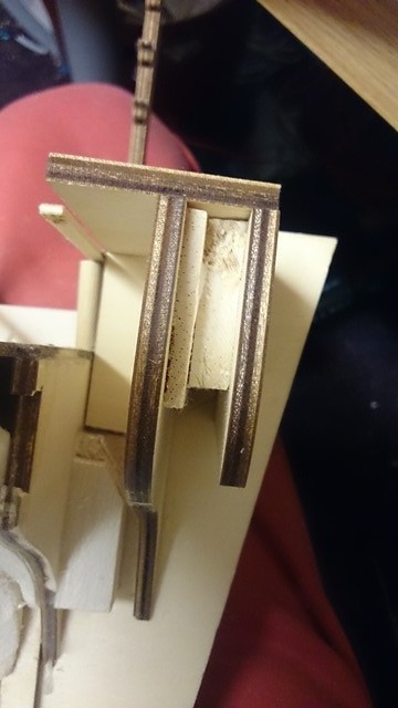

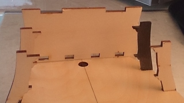

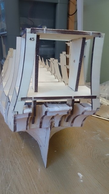

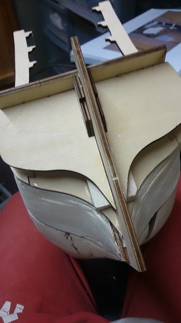

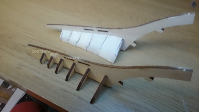

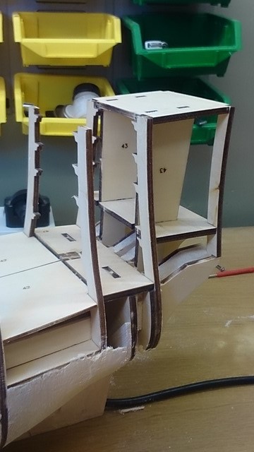

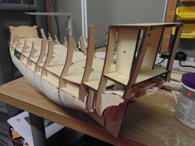

The next part of my build is the gallery framework for the stern.
Photo 1 - The gallery framework complete, (will take more pictures of future build sections so that you can see more detail).
Photo 2, fitted the supports & frame halves, you will notice where I had used balsa blocks when fitting the ribs, I will need to remove some of this as I want to use balsa to infill between them.
I have used the deck extension as a fitting guide, to ensure everything is at the correct angles.
Photo 3 - I've used balsa between the frame halves & the bracing pieces to give some extra support.
Photo 4 - 6 - Several photos of the gallery framework fitted.
Will keep you all updated with then next step of my build.

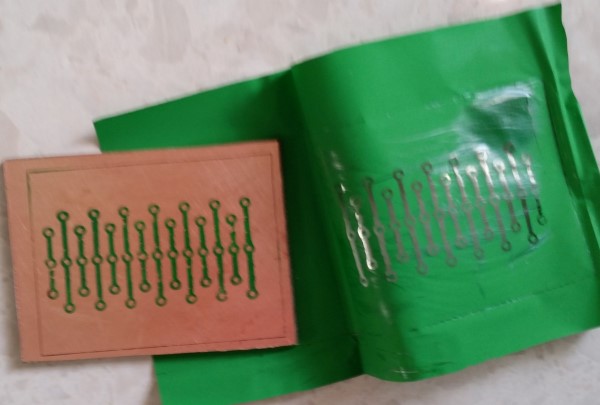

Well I'm finally getting some work done on my build BigGrin

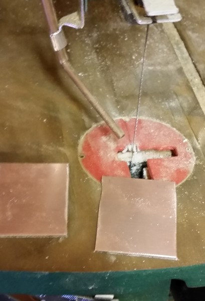

This is where I am so far with the lighting, I've started with making my own circuit boards for the LED's & the controllers for them.
Experimenting on making the circuit boards as I have never made any before.
Below are some photos so far (I know this isn't the ship build but thought some people might be interested in how it's all done)
Photo 1 - This is a piece of software I've used to design the circuit boards, it also creates the pdf files needed to create the boards.
Photo 2 - This is just the pdf printout of one board to give me some idea of size.
Photo 3-4 - This is where I cut the circuit boards to the size needed.

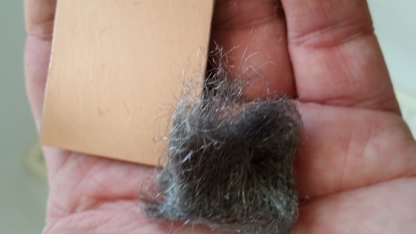

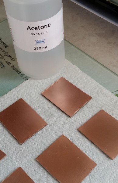

Photo 5-6 - The boards need cleaning before transferring the image onto them, all chemicals & finger prints need removing or the process won't work.
I've used wire wool to start with, then Acetone followed by rinsing off in water.

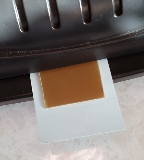

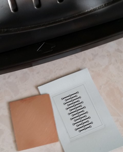

Photo 7-8 - This is photo transfer paper, the pdf image from the software is printed onto this using a laser printer, has to be a laser printer because of the toner, ink yet printers won't work. A mirror image is required so its the correct way round on the PCB board.

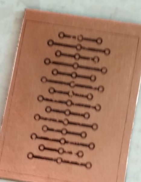

Photo 9-10 - To get the image from the photo transfer paper to the PCB board you have to use heat to make the toner tacky, it then sticks to the copper on the PCB board.
I first tried using a laminator but this wasn't hot enough to make the toner tacky.
I then tried an iron on full heat, this had the desired effect.
Photo 11 - (Not in focus !!) This is the PCB board with the image on it, you can see that not all the toner has transferred onto the board. I will need to experiment with the heat settings & the best way of putting pressure onto the board for best results.
Photo 12-13 - Before the copper can be etched away from the board the toner needs coating in this green foil, if this isn't done the copper under the toner could also be etched away.
I will leave the etching of the boards for another day, I need to experiment with getting the image transferred to the PCB board first.
Once I have this mastered I will update on the etching of the PCB boards.
