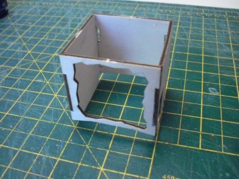

ISSUE 127 BUILD

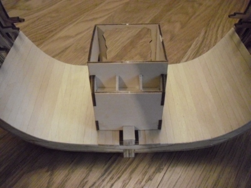

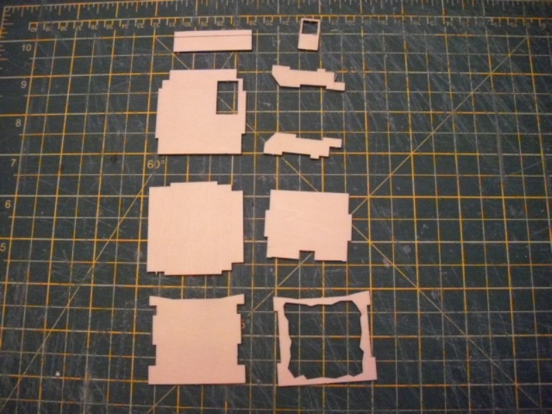

and the parts we use at this stage are used to forme the shot locker and pump well, here they are:-
#82 Posted : 24 September 2012 17:28:08
ISSUE 127 BUILD

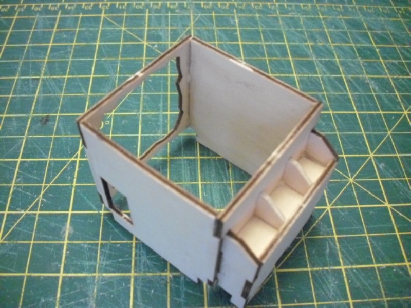

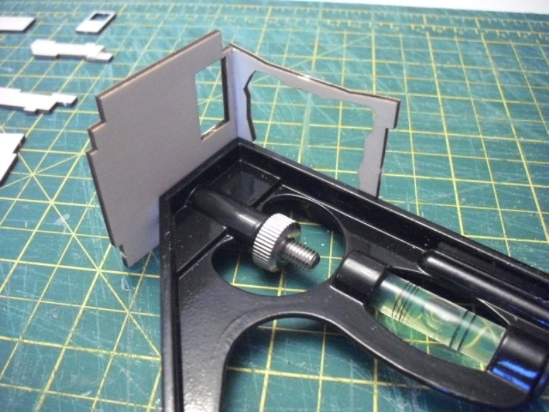

Following the instructions I built the item:-

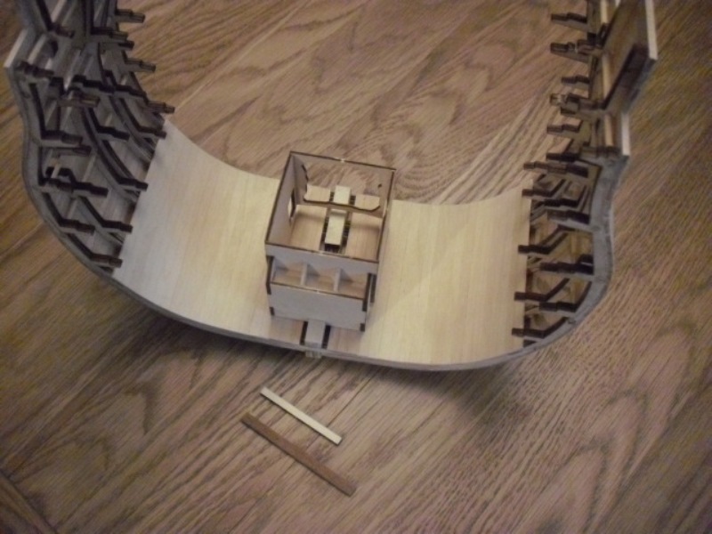

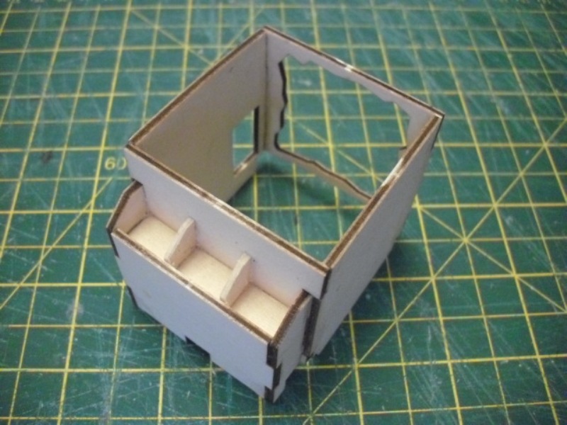

#83 Posted : 24 September 2012 17:36:33
ISSUE 127 BUILD

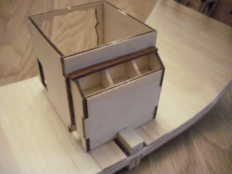

at the point I deviated from the instructions and changed the lip that goes across the back of the shot locker, from the ply supplied to a piece of walnut see the next photo:-
I intend to cover the pump well and shot locker in 5mm x 1/2mm walnut, It has a grain like scale oak and I will leave it rough looking without sanding.

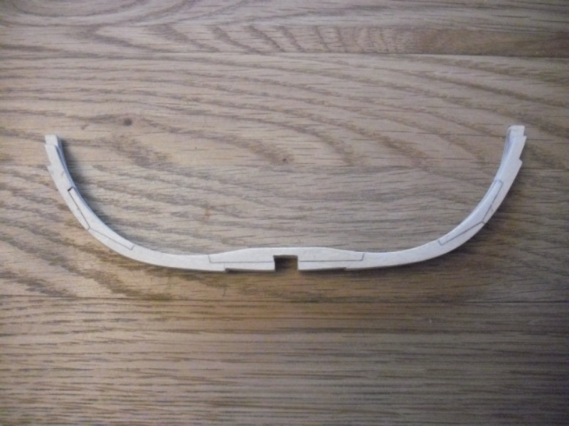

#94 Posted : 03 October 2012 21:05:19

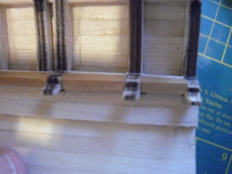

ISSUE 128 BUILD
Hi Team, I have not posted on this build for a while, as many of you will know this is one of my favourite builds with lots of scope for enhancements and modifications, but more about those later.

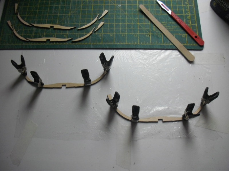

In this issue the object is to construct the main hull supports, these are made up of dedicated parts, I followed the instructions at this point:-

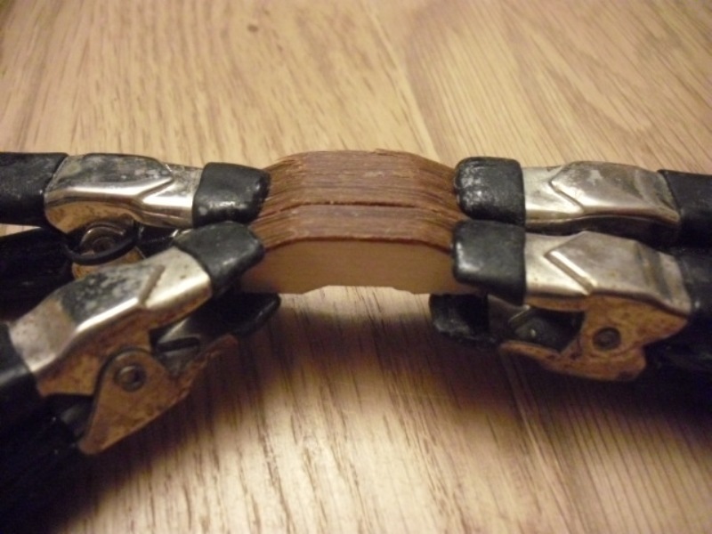

#95 Posted : 03 October 2012 21:15:22

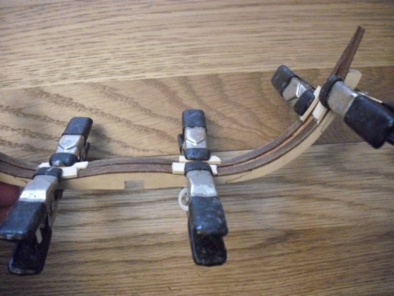

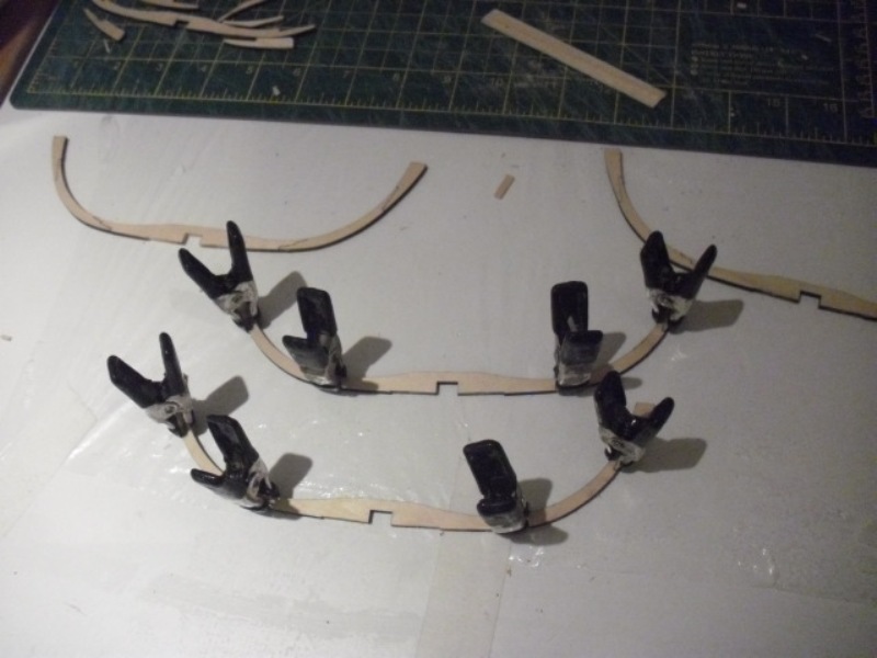

ISSUE 128 BUILD

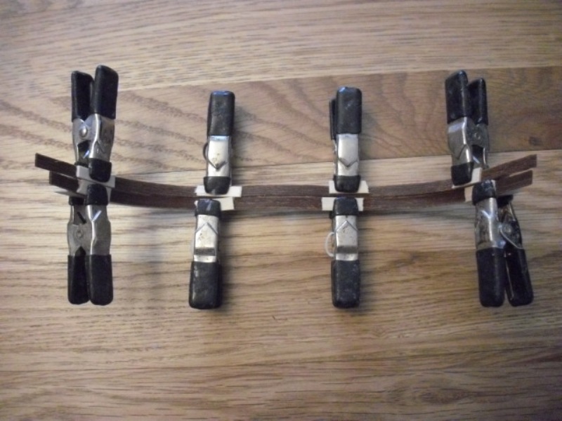

1st MODIFICATION

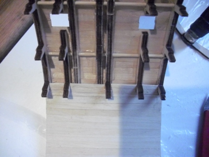

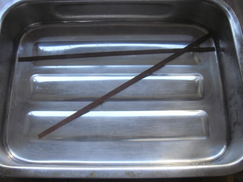

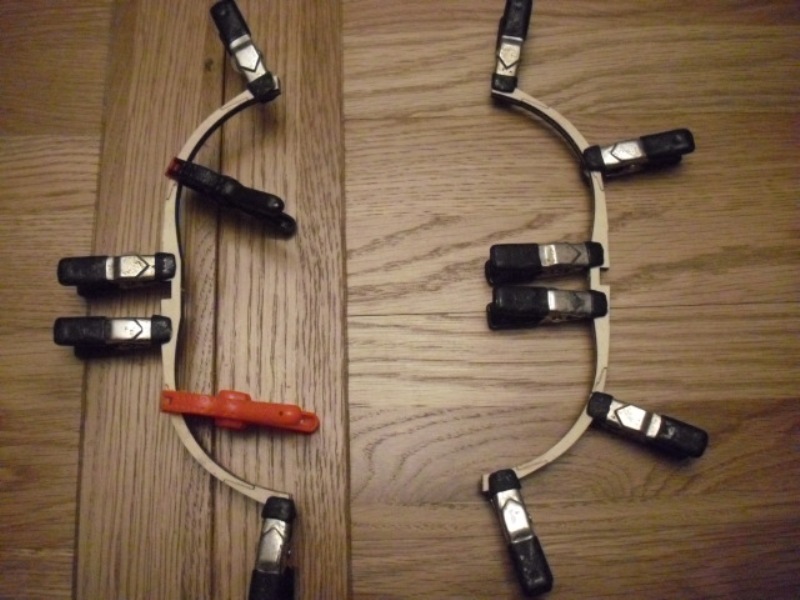

In the last picture I was not happy with the ends of the ply being on show so I decided to sheath the beems with 5 x 1/2mm walnut I have purchased to second plank the Victory, the grain is the nearest I have seen to simulate oak at this scale.
I cut some pieces and soaked them in hot water then clamped them onto the wood while wet but no adhesive, have a look:-
#96 Posted : 03 October 2012 21:22:47
ISSUE 128 BUILD
The sheathing will dry and the shape will be formed ready for the adhesive, I will show you the result next time.

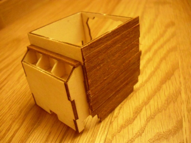

#98 Posted : 03 October 2012 21:29:25
ISSUE 128 BUILD
3rd MODIFICATION

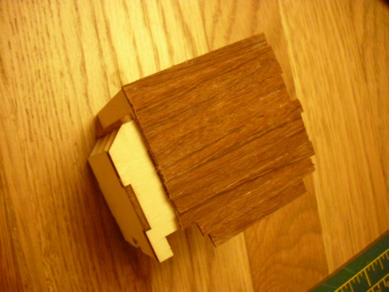

I decided to sheath the shot locker and pump well with the same walnut, I am very happy with the result:-

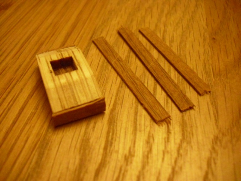

#99 Posted : 03 October 2012 21:35:46
ISSUE 128 BUILD
Well thats all for now, I have not finished this issues build but I thought you would like to see the progress.
thanks for looking inBigGrin as usual if you would like more info on what I am doing with this build do not hesitate to ask or commentCool

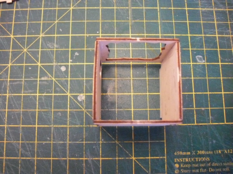

I will leave you with the 4th MODIFICATION ---- sheathing the mast base so you do not see the ends of the ply grain,( the sheaths were soaked in hot water first) Regards Mike

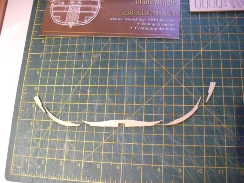

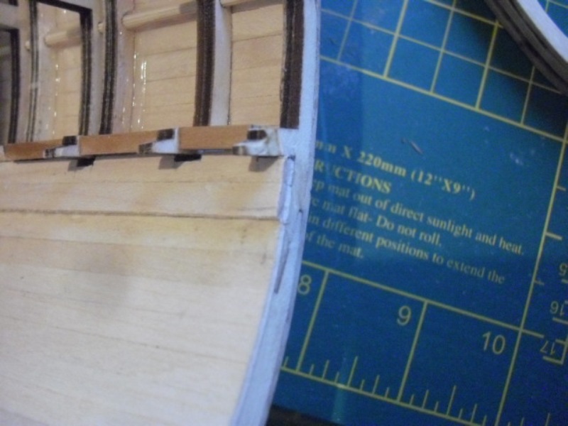

#100 Posted : 04 October 2012 10:18:01
ISSUE 128 BUILD

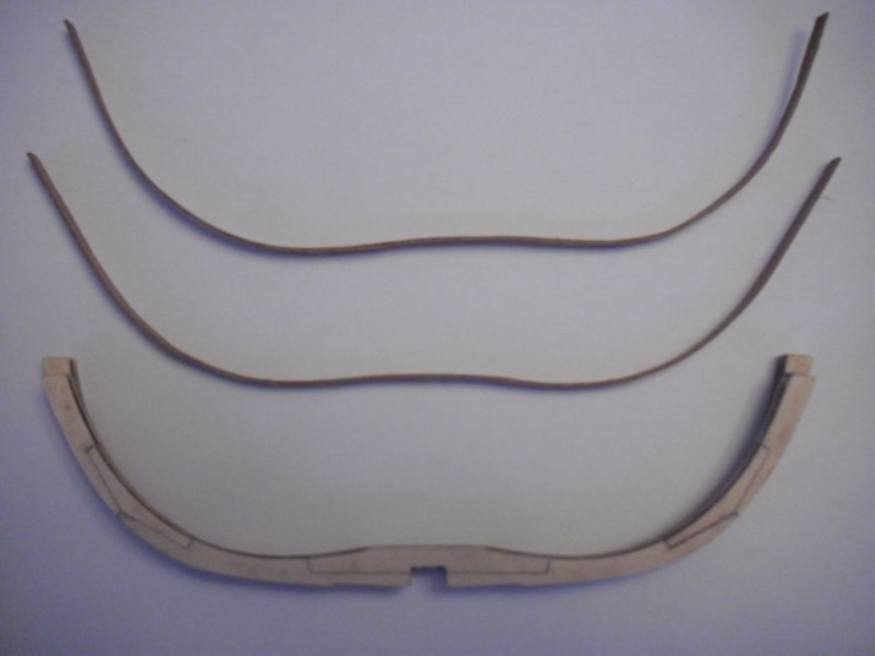

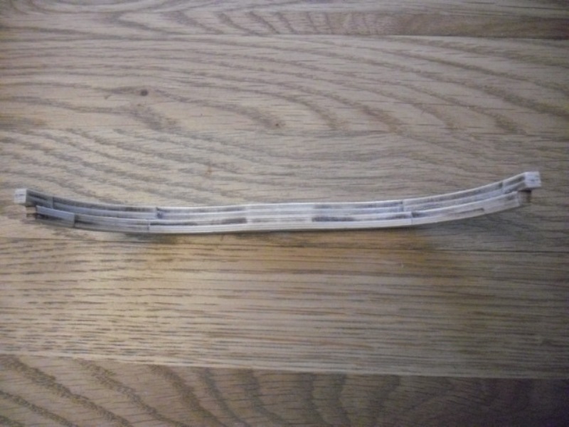

Hi Team I just thought I would post a photo of the planks now that they are dry, you will see how they are shaped ready to glue on top of the ply parts Regards Mike
