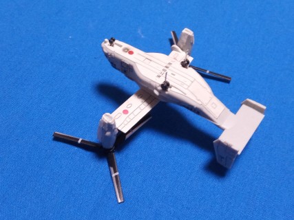

Hi All!

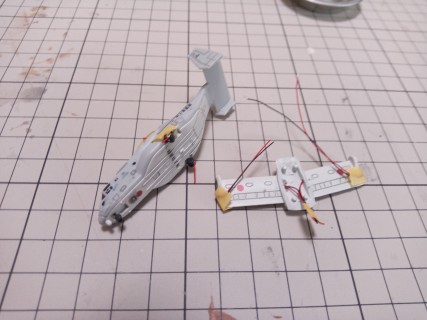

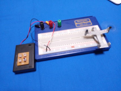

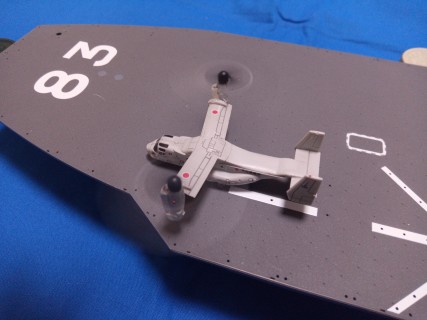

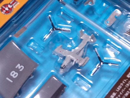

I sent photos that introduce enhancement of osprey model of DDH IZUMO.

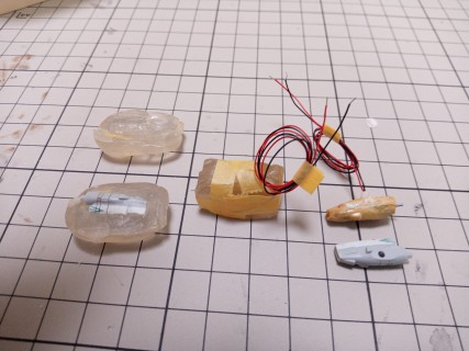

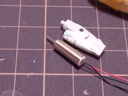

This 1:250 osprey model was included as a appendix of No.3 magazine.(No.1) Modelers often think about making the rotors move, and me too.

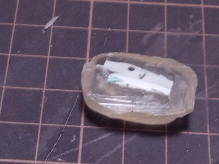

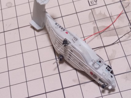

But the smallest motor that I can get is too large to be installed inside of the engine nacelle. (No.2)

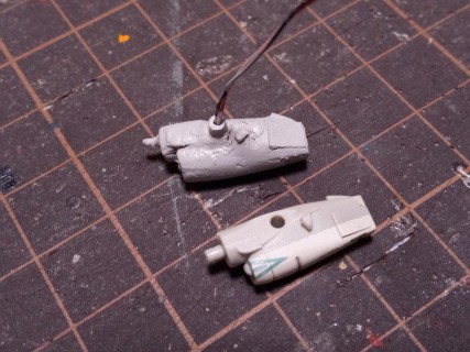

The thickness of the wall is in the way. I made a mold for the parts and buried the motor with epoxy putty and cast an engine nacelle with a motor. (No.3,4 and 5)

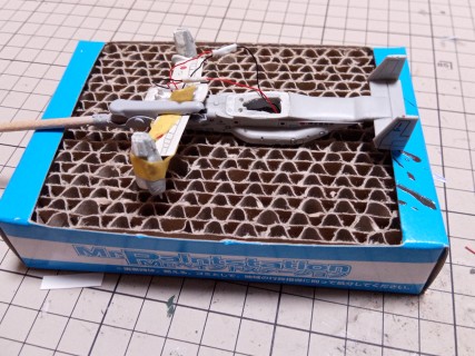

I wire the body and wings and pull the wires out of the landing gears to supply electric power. (No.6,7)
Every parts were assembled and an operation test was conducted.(No.8,9 and10) The model is put(not glued) on the IZOMO flying deck.(No.11 and 12)
A video is uploaded on my YouTube channel.
https://youtu.be/gA9Mzhob7YY

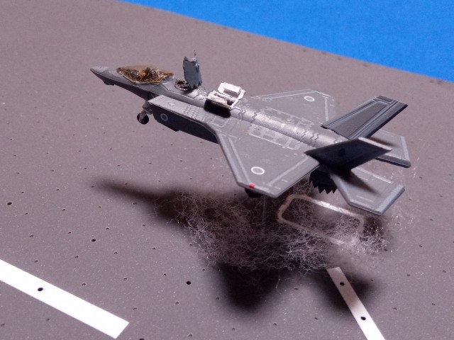

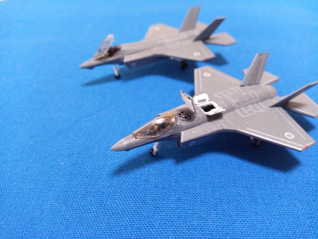

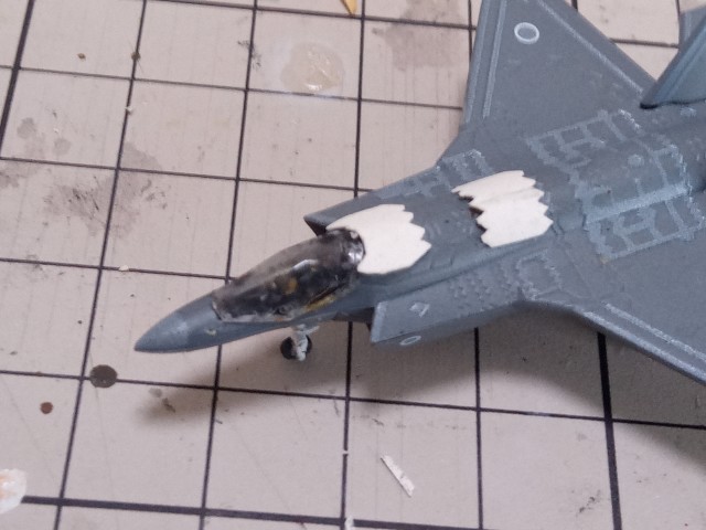

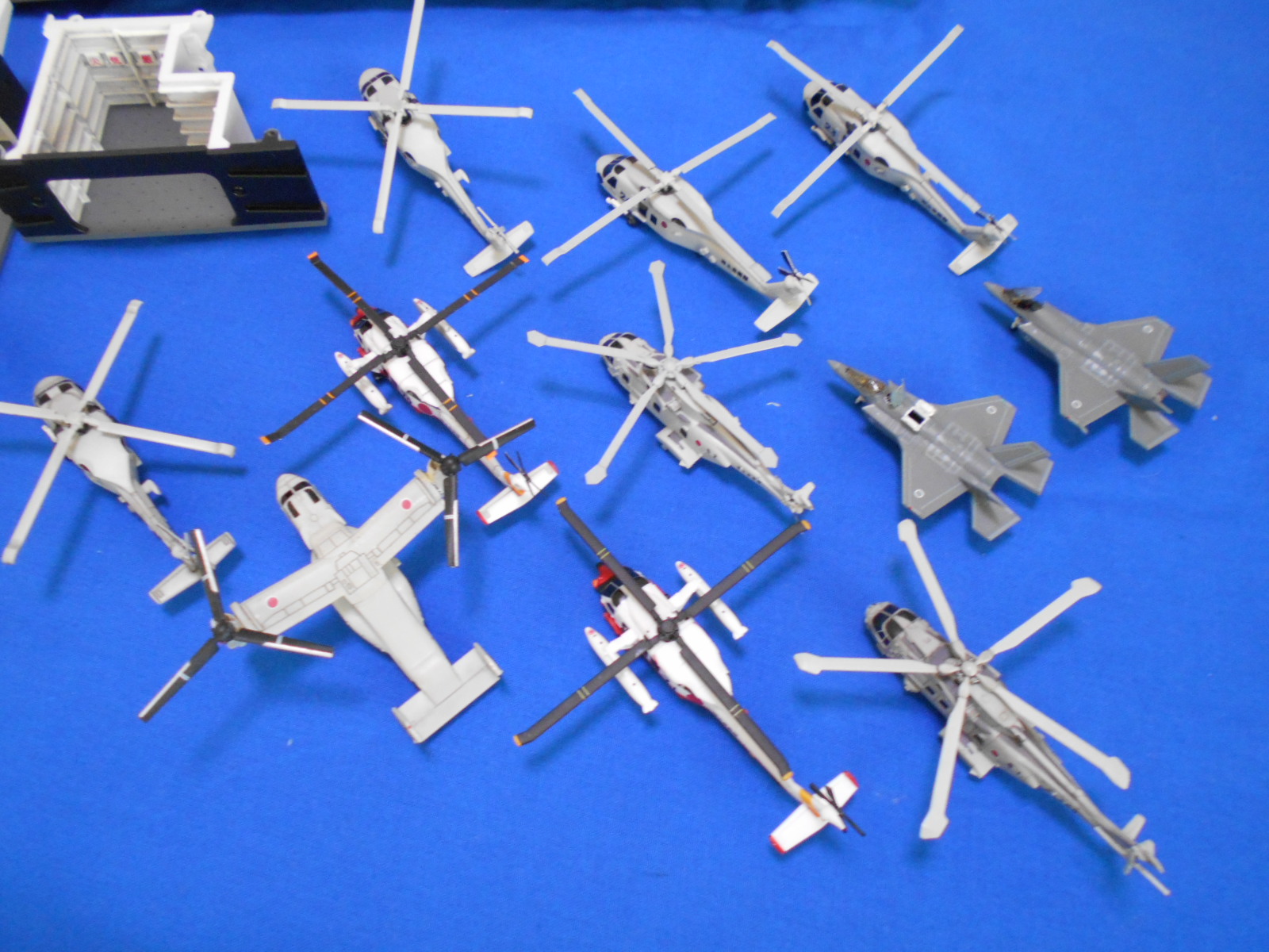

I have to wait for new magazines two weeks more. I enhanced F35B, VTOL stealth fighter models in this waiting period.
I exchanged a canopy parts for a clear part. I painted thin color as coating glass.
One is a closed-canopy model and the other is open-canopy.(No.1)
Jet nozzle is painted with burned iron color.(No.2)

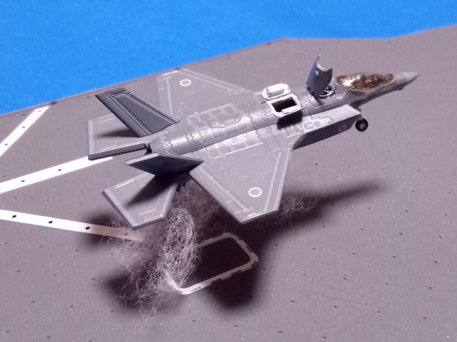

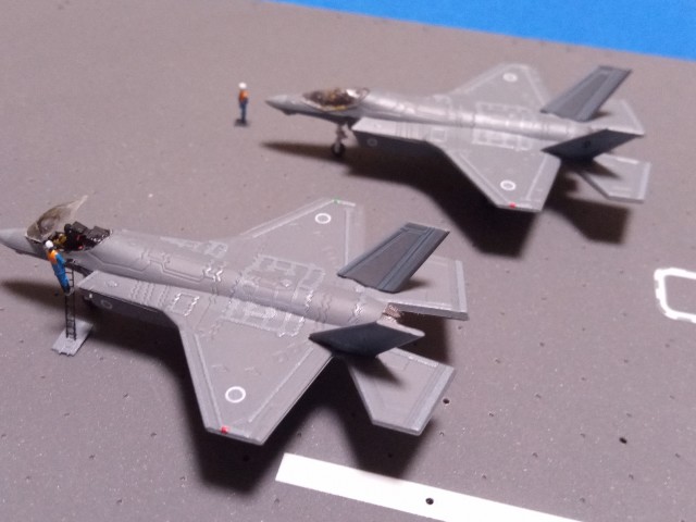

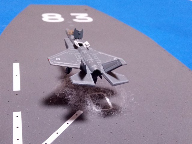

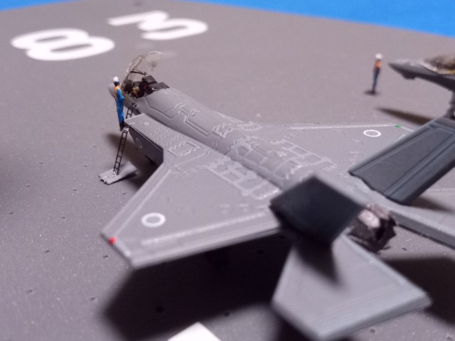

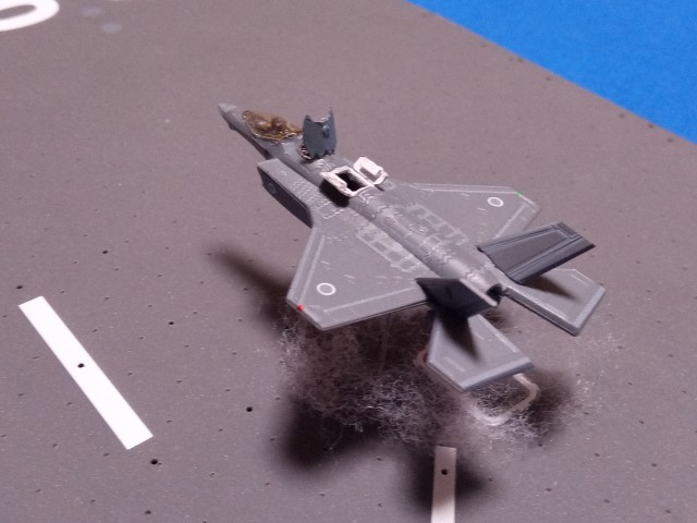

I enhanced more. I tried making F35B fly.
I made some scratched parts for this model (No.3) and attached them on it.(No.4)
I sent some photos of this model on the OZOMO's deck.(No.5-No.10)

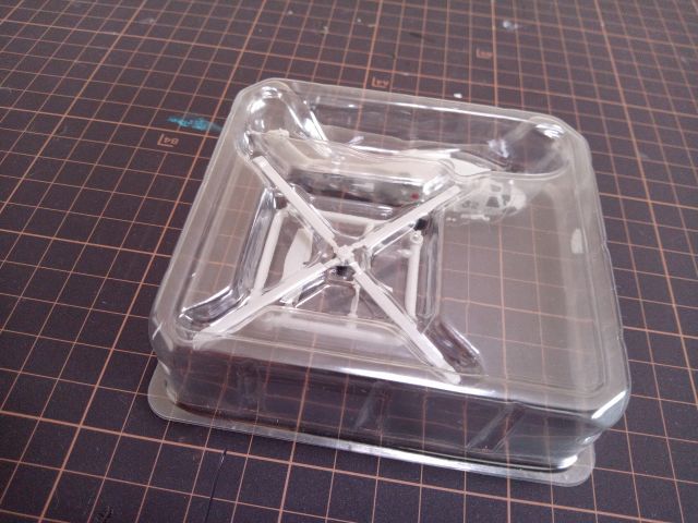

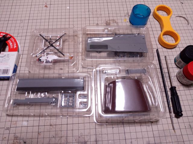

I received 4 magazines and parts of IZUMO last weekend.(No.1 and 2) The number of the parts are too small to send 4 posts here , no matter what they were! (No.3)
This time I sent a log for these 4 magazine's building processes.

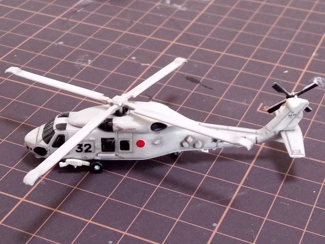

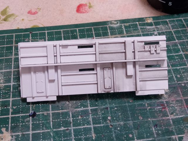

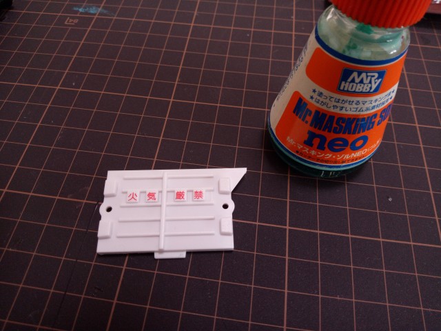

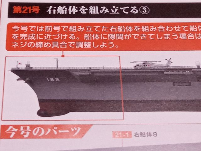

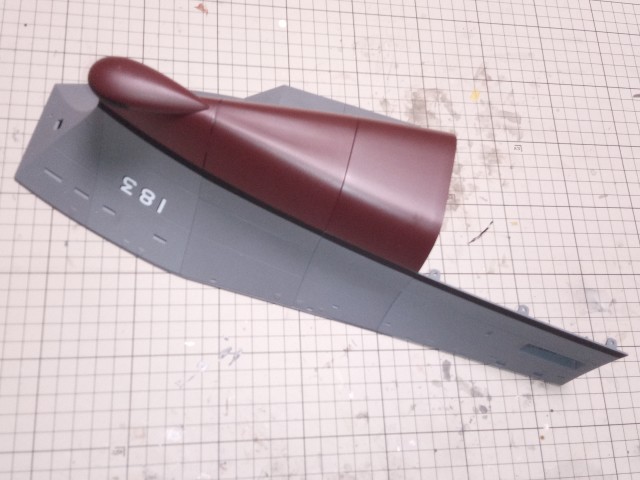

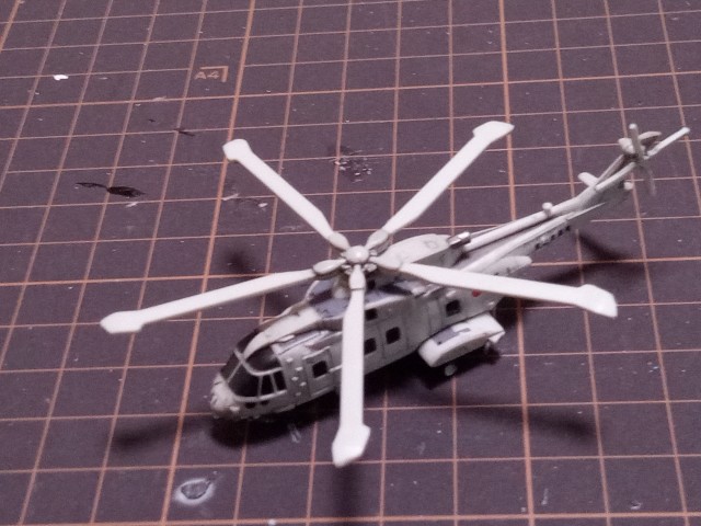

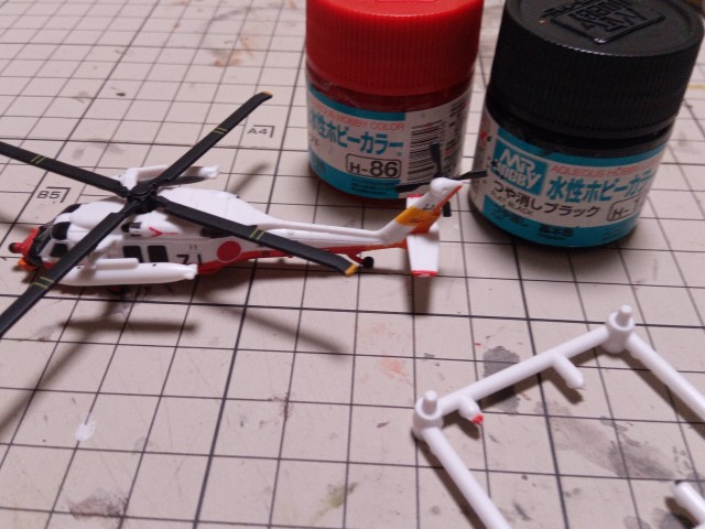

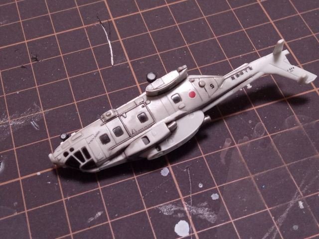

First I assembled helicopter. I painted black and red on where plastic parts were cut.(No.4)
Other plastic parts were repainted. Because the surface is perfectly plastic. I used the same method as warship's plastic model.(No.5,6)

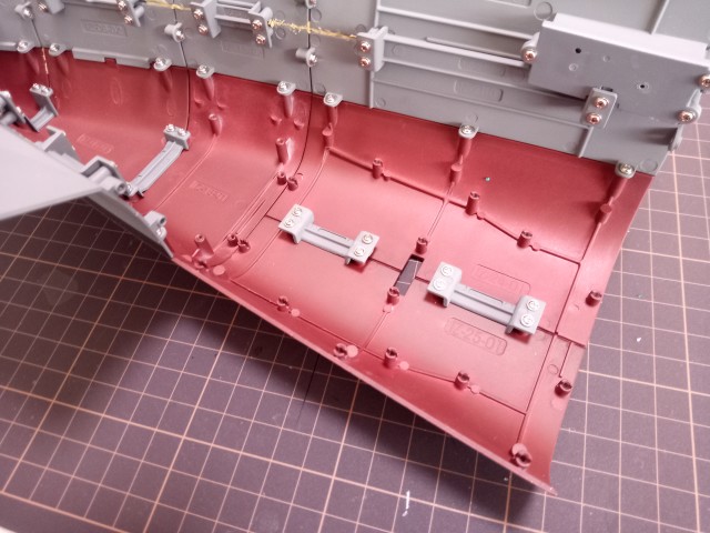

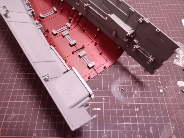

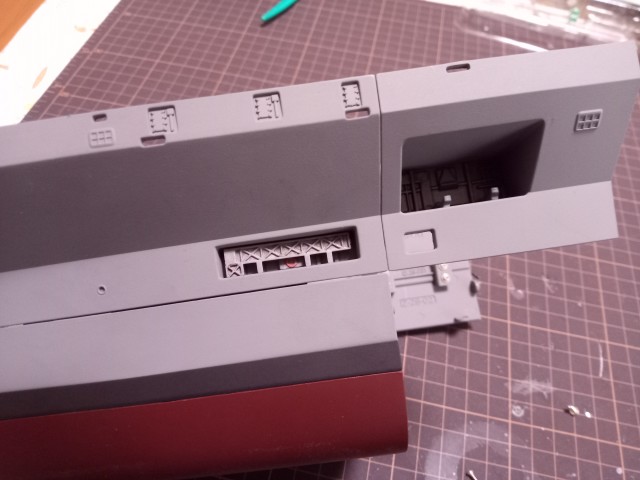

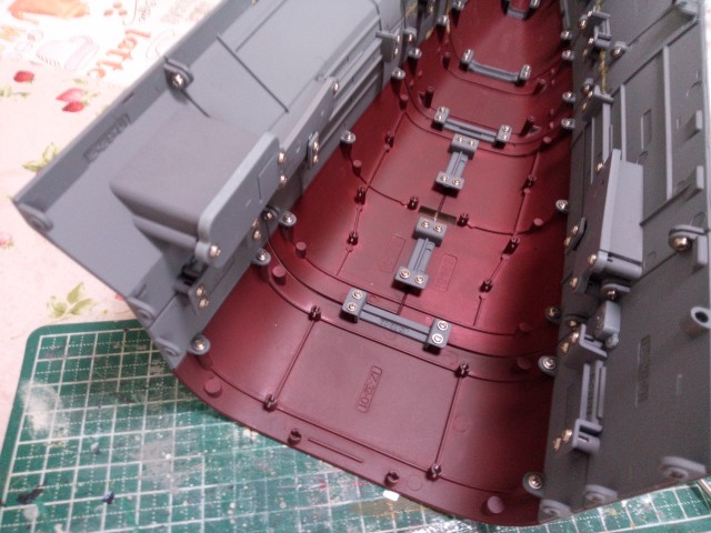

I assembled one part of the hull of the starbord.(No.7,8)
I have done every process.

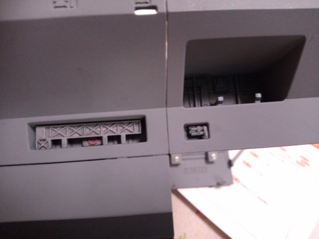

I noticed one sentence in the magazine. (No.9)Confused

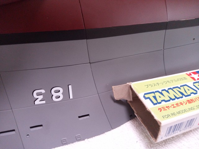

They say, "If there are any gap among metal hull parts, you should tune screws and repair them by your self. " (No.10)
This gap issue is one of the biggest problem among us, IZUMO's builders.
I guess that how perfectly we tune the screws, these gaps shall be remain on the hull. I realized that DeAGOSTINI Japan has no plan for the issue.Cursing

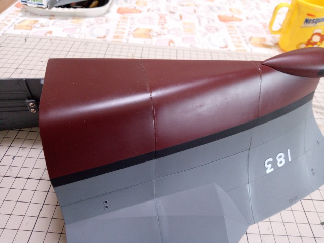

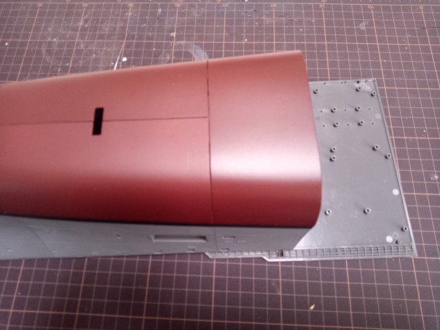

After reading this message, I gave up the tuning. I decided to use epoxy putty. After the putty curing, I painted only the putty's surface. (No.11)
I don't decide to paint all of the surface of hull at this time.

Excellent work, that putty worked nicely.Love Love

You have made a really good job of overcoming the panel gaps by using the filler. BigGrin BigGrin
Well done.

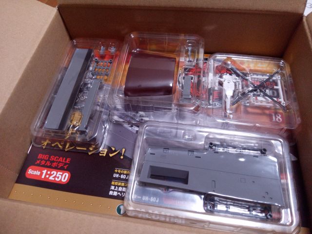

A box was sent from DeAGOTIONI Japan. (No.1)
A message was included in the box. They apologized that the parts were arrived delay. (No.2)Cursing
And there were two advertisements of car models. One is often seen Model Space Home page. (No.3)
This time, I have gotten 5 magazines' parts from DeAGOSTINI Japan. (No.4)
First, I build helicopter model. (No.5,6)

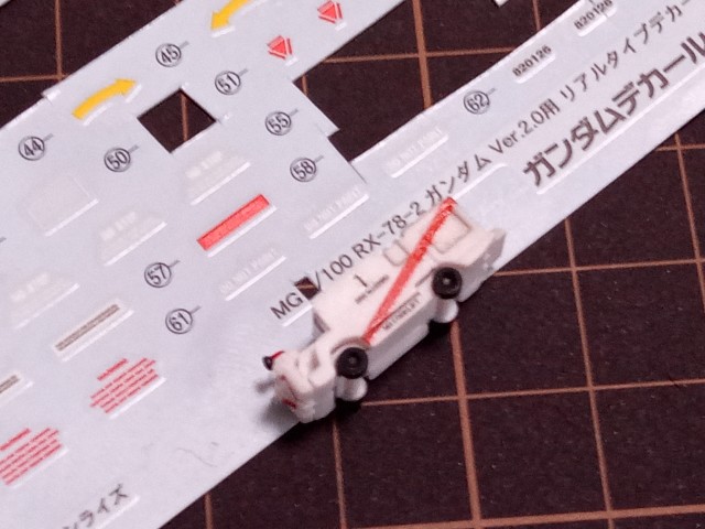

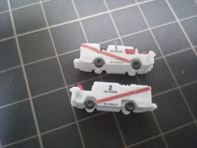

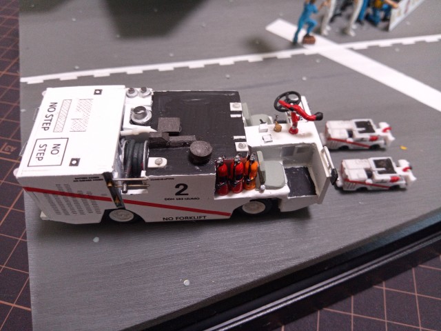

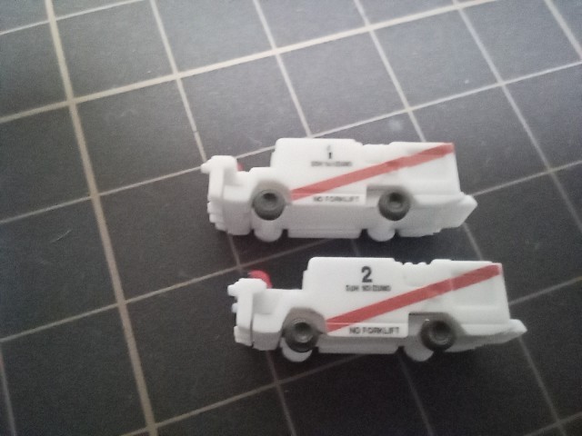

2 models of fire engine were included. "1" decal has fallen off. I put another decal on it. (No.13-15)

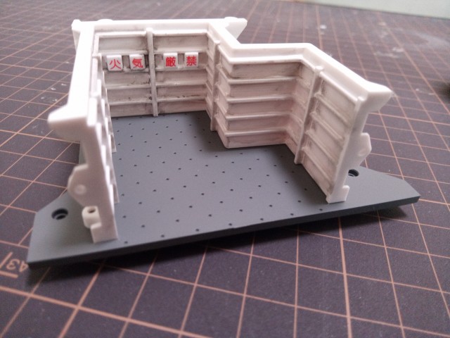

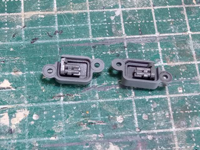

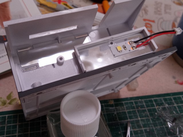

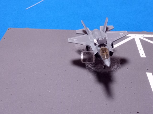

DeAGOSTINI Japan sent me No.27-30s' part set.(No.1)

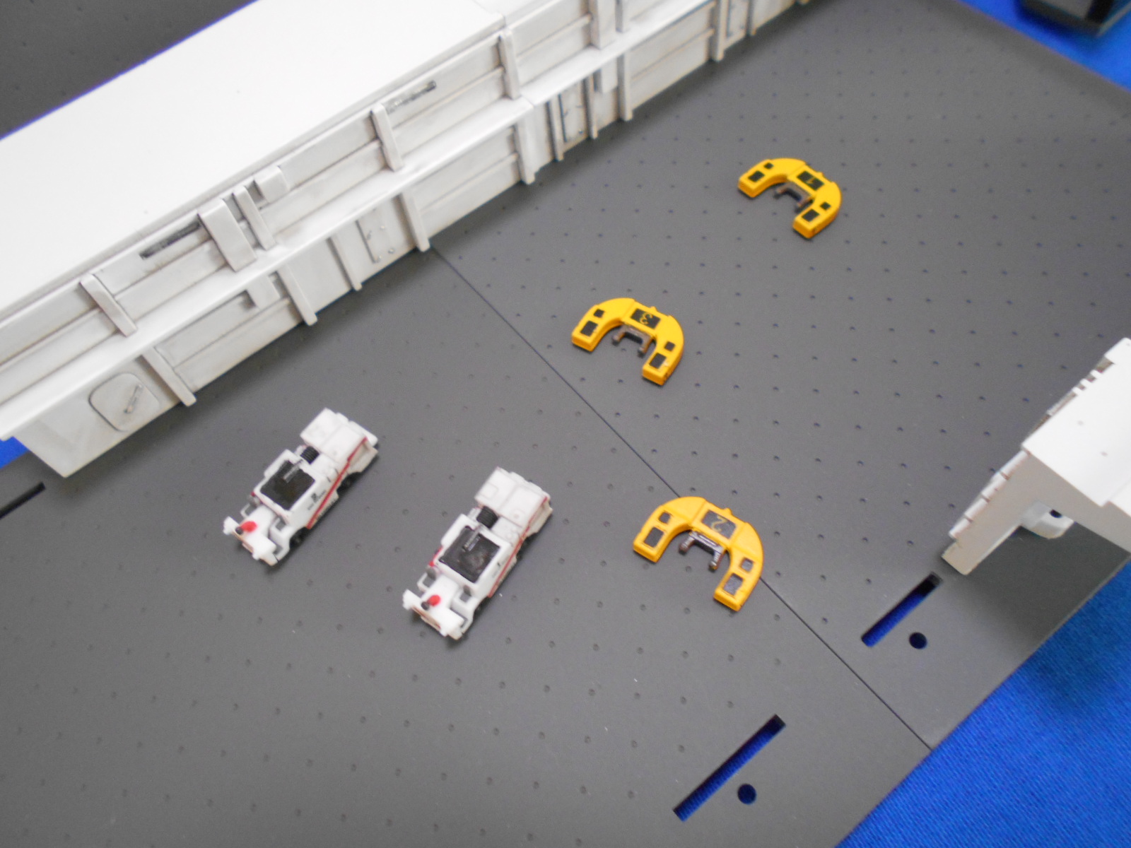

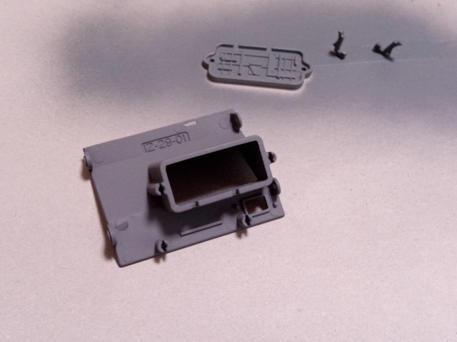

The set includes one helicopter model. I enhanced the shadow of it.(No.2,3)

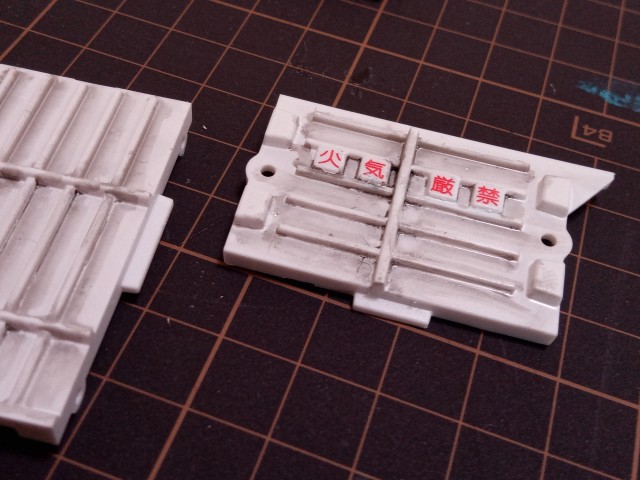

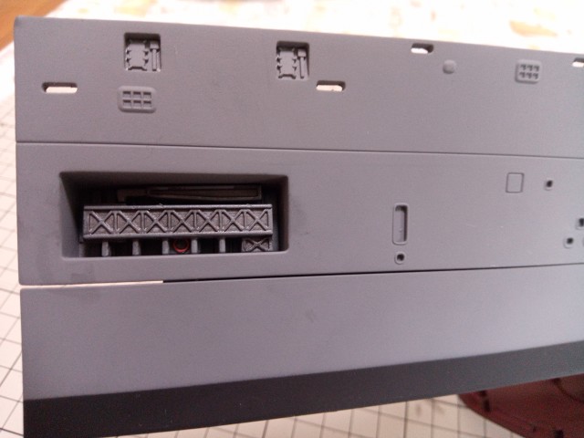

Some hull parts with a recess space were added. (No.4,5 and 6)

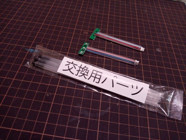

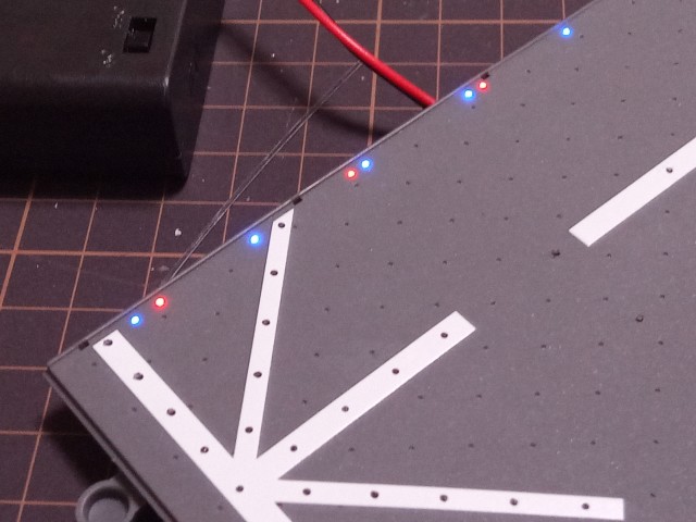

At this time, I have to exchange 2 LED electric bases and optical fibers.(No.7)

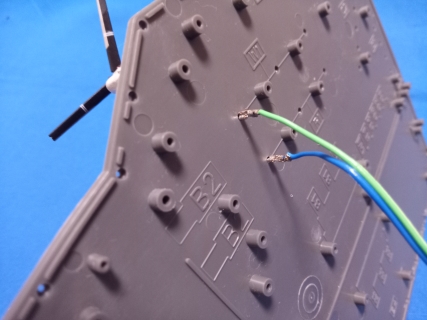

LED gimmick before the exchange was shown in No.8.
No.9 photo presents the LED gimmick after the exchange.

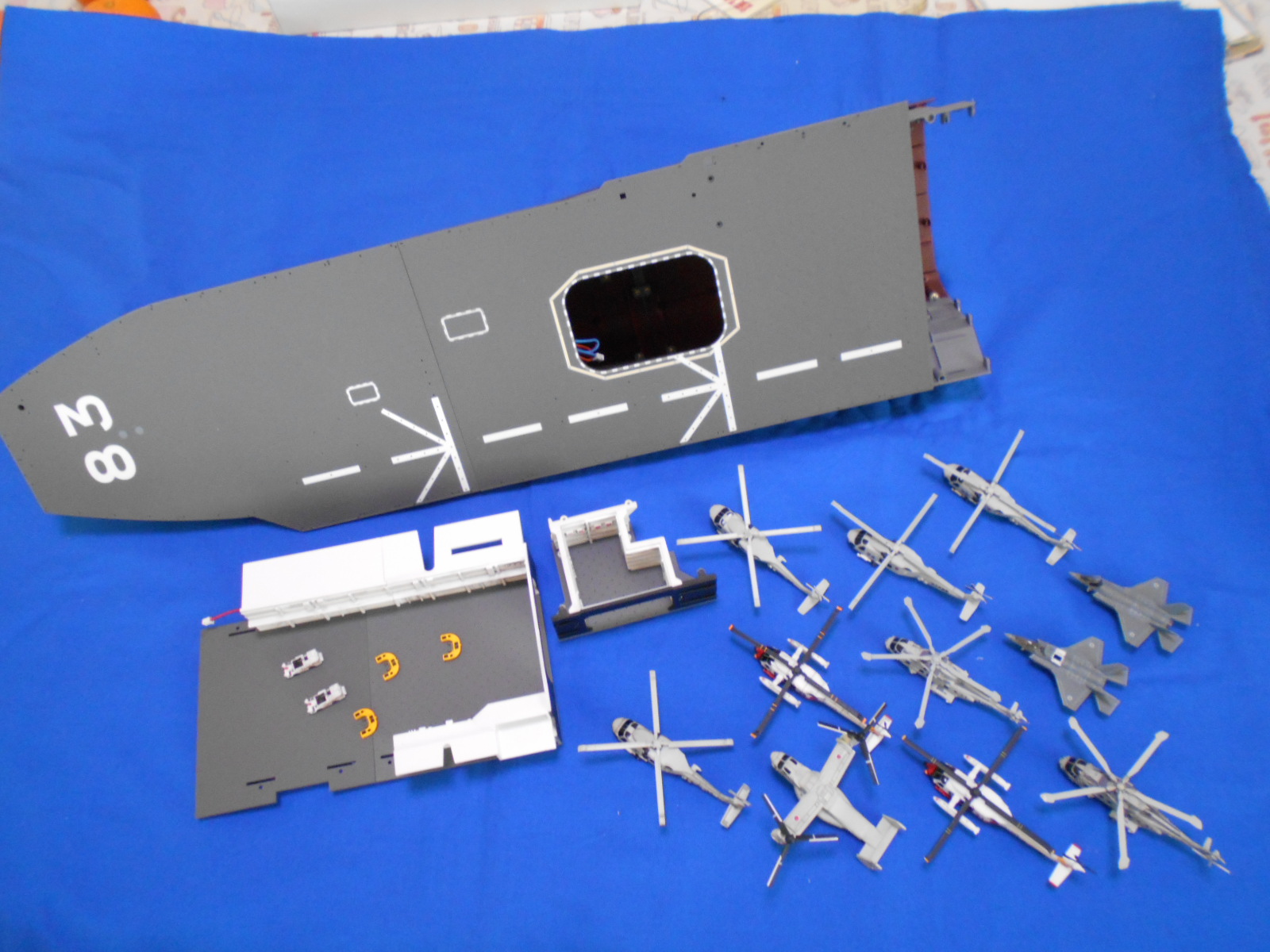

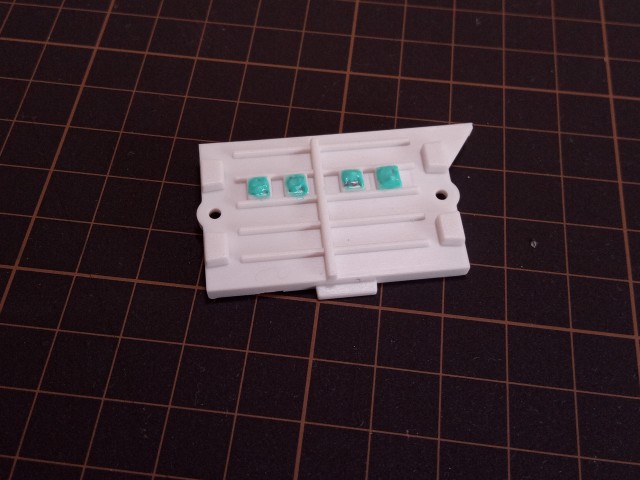

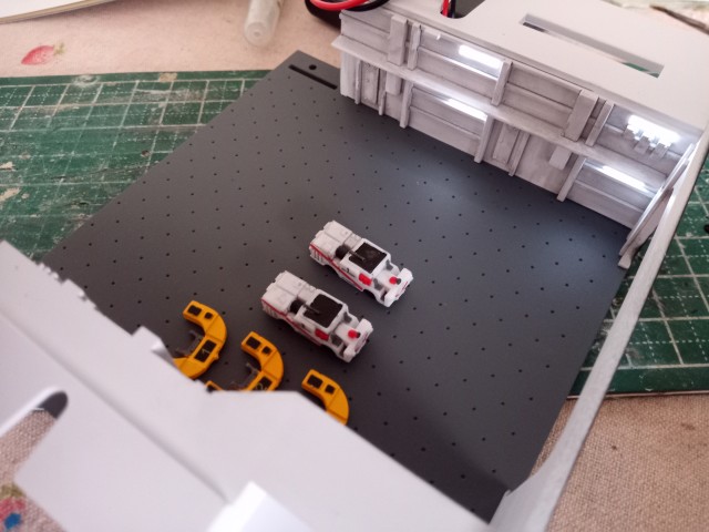

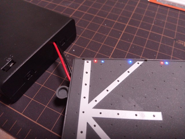

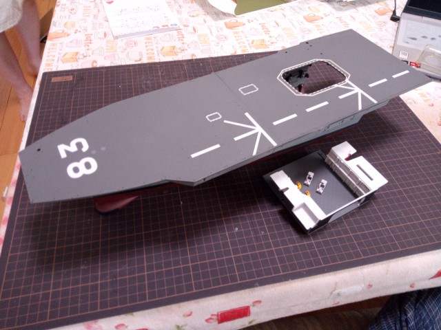

I sent some photos of building IZUMO. At this time, DeAGOSTINI Japan sent me IZUMO's parts of No.31 - 35 magazines.(No.1)

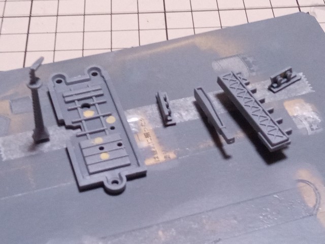

One of the parts was a middle part of flying deck.(No.2)
Some of IZUMO builders say that this series is not "weekly" but "monthly".Mad
Several advertisements were included. They start part new work series of ENTERPRISE model building (No.3) and a small wooden statue of buddha.(No.4)
I enhanced the wall of the hangar deck.(No.5) LED base was attached on the wall part (No.6) and tested to be lighted.(No.7)
Parts of decoy launchers were installed both sides.(No.8,9)
The hull was extended with additional parts.(No.10,11)
I tried to put the flying deck parts on the hull. They were not glued.(No.12)
I have done all the process.
