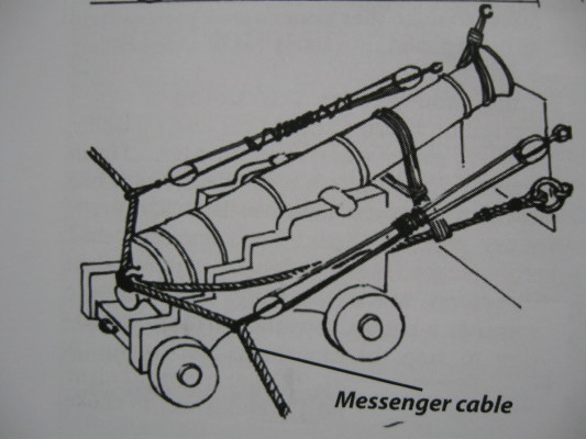

Hi Tom
Can you explain the rope going from cannon to cannon on one side of your model? It's like nothing I have seen before!
Mike T
Hi Mike
The rope going trough canons is called "messenger cable". According to DeAgostini in Issue 48 page 6 it is described as double breeching.
Quote from Issue48 page6
"...Below left, a more secure method was double breeching. As well as lashing the barrel and tightening the breech rope, the gun is secured to a heavy "messenger cable" running all the way along the row of guns on the deck..."
I hope it helped :)
I have studied many references to 18C/19C war ships but I have never come across any reference to a messenger cable run through the row of guns. In heavy weather, the guns were stowed with extra breeching cables on each gun to keep it close to the sides of the ship, an arrangement I believe was known as double breeching but frankly I don't see how a long rope would prevent individual cannons moving. If the only reference is DeAgostini's build notes, I would want to know where they got their information from!!Confused Confused
I'm always prepared to learn something new!
Mellow Mellow
Mike T
I have copied below the text from the magazine within the section titled 'Ships of the line', which in this instance talks about housing the guns...
For most of the time, except when the crew were at gunnery practice or the ship was about to go into action, the guns remained securely housed.
The guns on the upper decks were commonly secured in the run-out position. The barrel was set level, the side tackles and breech rope were pulled up tight and any surplus was lashed out of the way. Muzzle plugs known as 'tompions' were fitted to keep the bore dry.
On the lower decks, the guns were normally housed inboard, so that the captain could keep the gum ports closed. The guns' rear (training or traversing tackles) were removed, and the side (outhaul) tackles were pulled tight, so that the gun was hauled up against the bulwarks with the barrel raised to its maximum elevation, by removing the quoin from under the breech. This lifted the muzzle by about 40 degrees, to the point where it rested against the ships planking, on the 'clamp' above the gun port and just below the deckhead above. The barrel was held in this position by lashing the muzzle to the eyes of 'housing bolts' in the ships side. it was further secured by using the ends of the side tackles to make tight 'frapping turns' lashing the two sides of the breech rope together forward of the carriage. As a heavy breech rope contained enough slack for the gun to be run in to the ship, the rope was pulled up tight and the excess was made into a tight loop.
A more secure way of housing the guns known as double breeching. This helped to relieve the pressure on the ship's side by fastening the rear of each gun to a heavy cable running from the bows to the stern. The spare messenger (a heavy cable used to raise the anchors) was run from the stern bulkhead to the heel of the bowsprit, and fastened tot he cascabel at the rear of the barrel of each gun. It was hauled tight, after which the guns' tackles were strained between the quarter bolts at the sides of the gun ports and strops were passed around the messenger cable on each side of the carriage.

Thanks for that reply Tomick. It makes more sense with the diagram showing the gun tackle taking up the tension in the messenger cable.
Just haven't seen that method illustrated before.
We live and learn!
