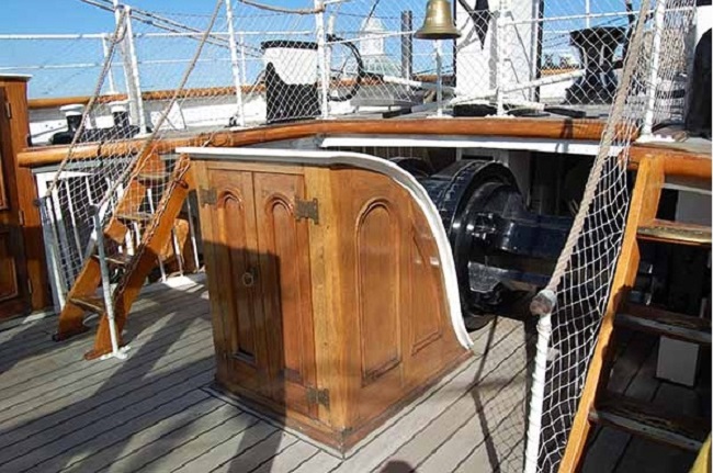

#90 Posted : 11 March 2020 23:57:19
Hi Ken, BigGrin
That ladder position looks mighty strange.
I just done a quick search and found the picture attached below of the Cutty Sark ladders to the poop deck.
Not sure if this help or add confusion to the situation. Hope it the first.Blink

kpnuts
#91 Posted : 12 March 2020 07:30:59
Joined: 08/03/2014
Posts: 2,977
Points: 8,523
Location: united kingdom
Well at least they make sense there.
#92 Posted : 12 March 2020 16:42:21
Hi Ken, BigGrin
They certainly do make more sense in that position, but the more astonishing thing is that there are no belay pins at the top of either stairway on the real thing.
I`ve had a look through my assembly manual and I can`t see anywhere that those belay`s are used anywhere for the rigging. Confused Confused Unless you have seen anything different?
When/if I ever get around to building this one, I think I would do a small reshape of the forecastle deck to accommodate the stairways and leave out the belays.
Which ever way you decide to go I wish you happy days building the rest of this stunning ship. You have done a great job so far considering what you started with.
WTG Cool Cool Cool

#93 Posted : 12 March 2020 18:51:02
Joined: 08/03/2014
Posts: 2,977
Points: 8,523
Thanks Derek I did consider moving them but it would require major work, the winch is far too wide (the steps should be inside that curve either side of the winch) as you can see the winch is the full width of that space. I did consider moving them to the straight bit on the outside but then they would foul the cabins which go there, in the end I decided I'm not going for accuracy anyway (just as well since when you really study it there are loads of errors in the kit) I'm just going for a nice wooden kit that resembles the actual ship.
I still think she will look good.
