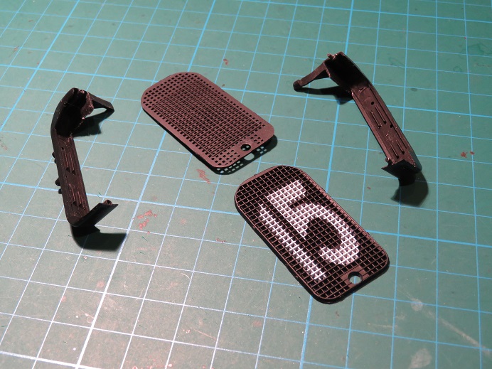

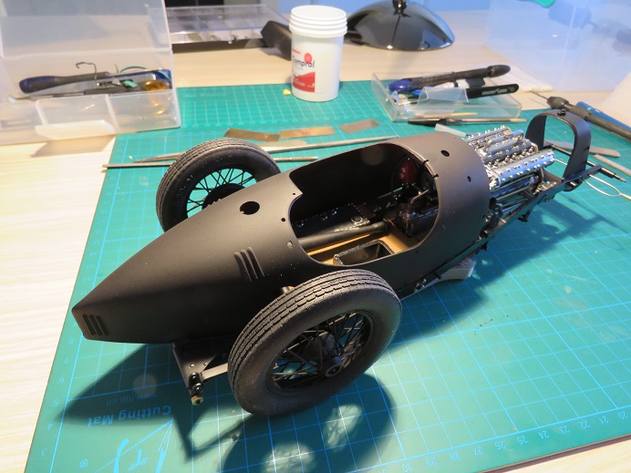

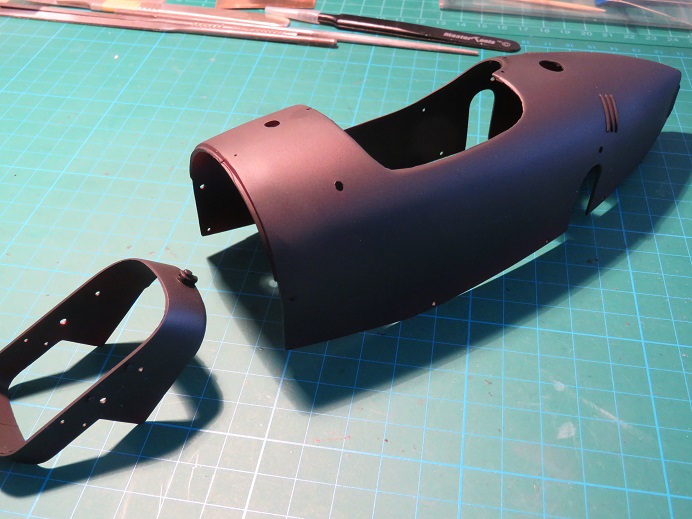

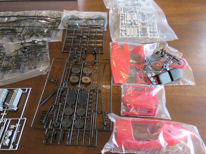

My attention has turned to the bodyworkBigGrin . The supplied parts are quite rough with loads of flash, mould lines and sink marks. They are made from a very poor looking red plastic. I spent quite a bit of time cleaning them up and because I want a dark red finish ( not too glossy ) I have primed them with a flat black.
#86 Posted : 04 September 2019 10:17:47

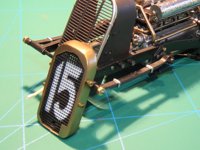

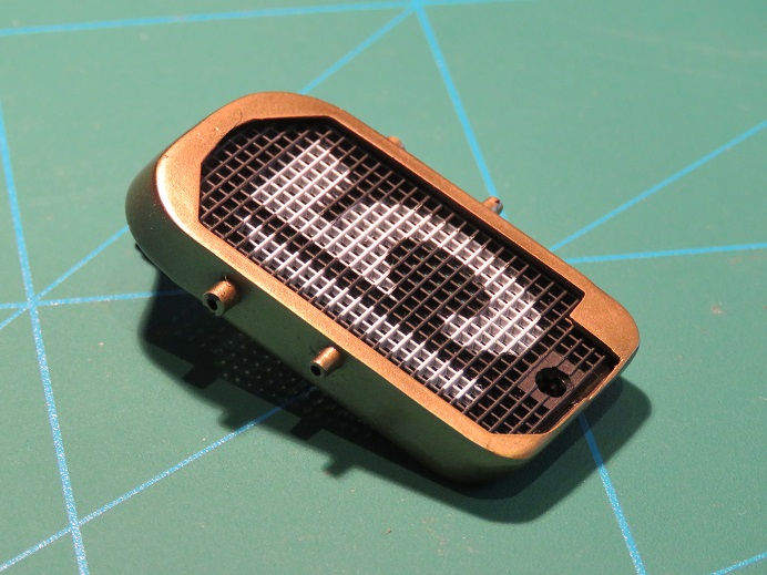

The radiator is in 4 parts. I sprayed on the number 15 ( template in kit ) and gave the outside a Brass finish.

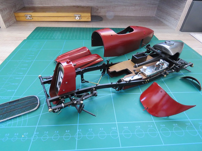

Colour coat of Tamiya TS8 ( italian red ) but the black primer has darkened it to my likingBigGrin

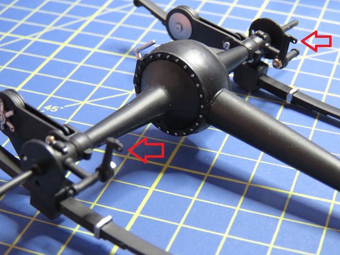

The instructions for this build are generally clear about the order of assembly but I would recommend that if fellow builders tackle the 806 that they plan well ahead for the construction. Some of the threaded plastic parts have poorly moulded screw threads which take brass fasteners. Generally these don't fit well and there is a constant risk of breaking the plastic. Even a die nut is not effective as the parts are so delicate. ( sizes M1.4 and M2 mm ).
A typical example is the pair of brake lever arms mounted on the inside of the rear axle assembly. The instructions show these being added at a late stage once all the rear suspension is in place. that would be very stressful !! I put them on before the main assembly.

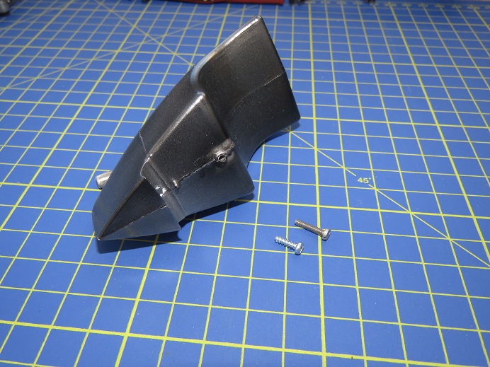

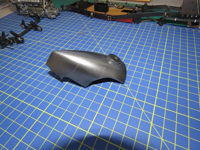

Another "silly" feature is the retention of the fuel tank on a single self tapping screw. No amount of clamping ( or hole enlarging ) stops the screw from splitting the carefully prepared tank Crying .
I tapped the hole for an M3 and used a machine screw.
