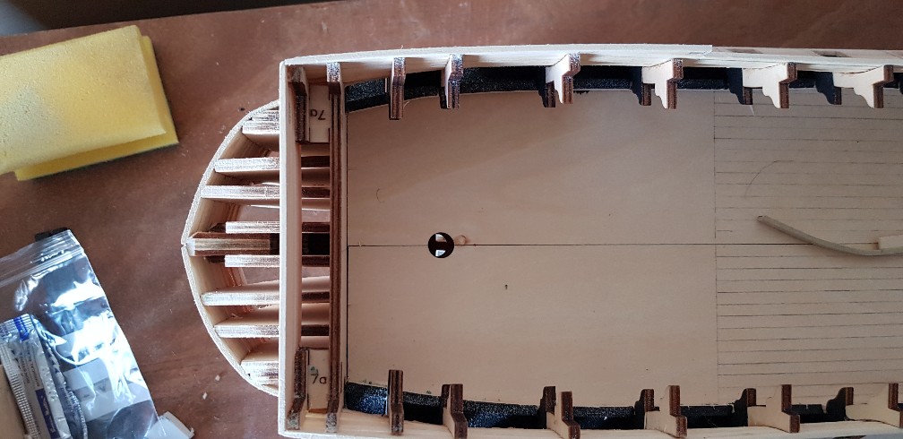

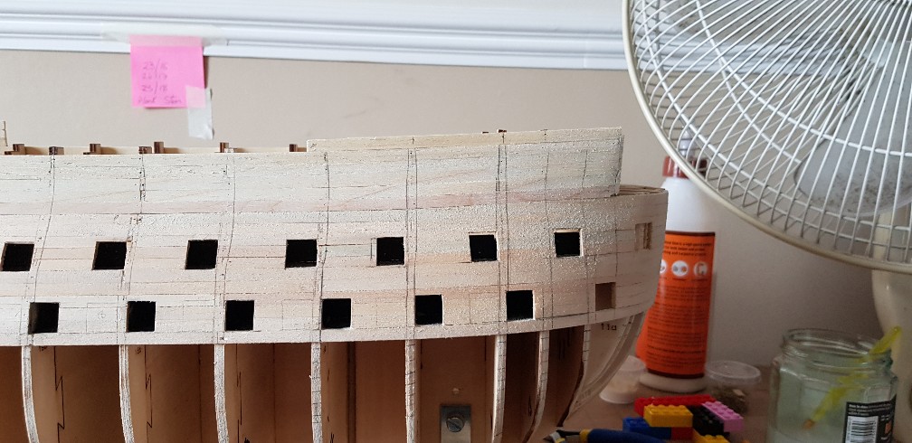

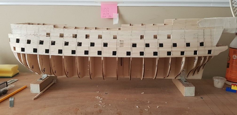

A spare couple of hours this morning so i cracked on with the 2nd deck gun ports and the eventually the entry port...
Just double checking things as i go....

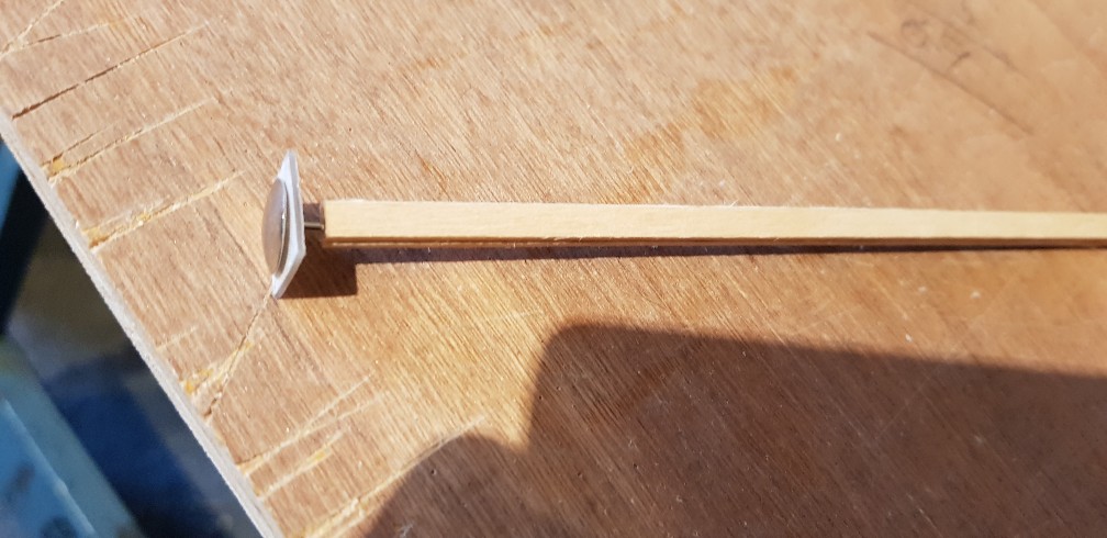

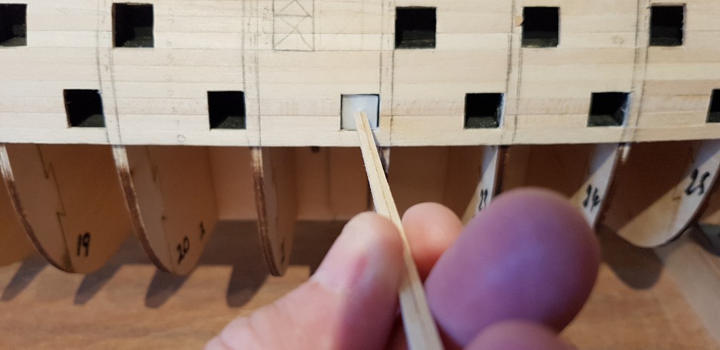

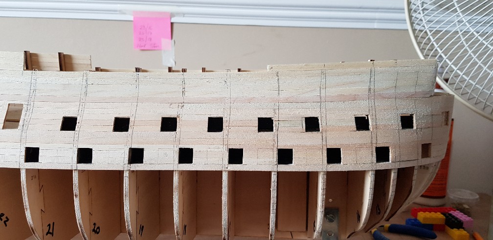

All the canon ports are a carved out of the middle deck and in doing so i came up with a canon port hole checker...
Some stiff ish plastic is required from something like a packet..
Cut your 12mm x 12mm square.
Make your centre hole...
Get two pieces of plank of cuts about 3inches long and glue them together and clamp...
Once dry get a drawing and push through the square...
Then push it into the end of the two glued planks....
Thn hold upton the hole to get the size....
Ant62 attached the following image(s):

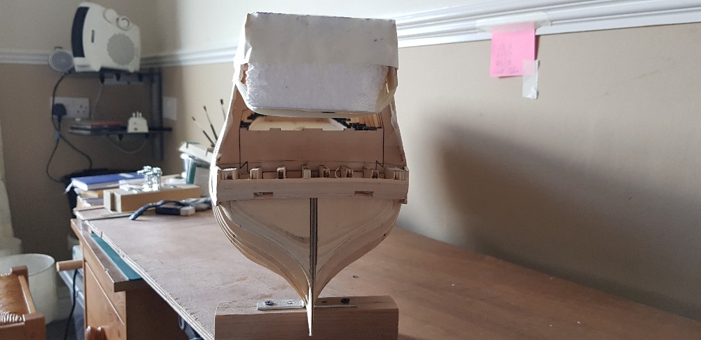

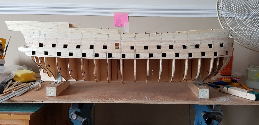

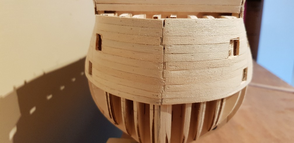

Here is a photo of bow..

z8000783
#87 Posted : 08 May 2019 19:46:11
Groups: Unapproved
Joined: 24/05/2010
Posts: 1,761
Points: 5,351
Location: London & Greece
Looks good. On track.
#88 Posted : 08 May 2019 23:57:38
Very neat.
You did well getting all of those gun ports cut in so short a time. Good idea with the size checker as well.

birdaj2 wrote:
Very neat.
It helps using the correct tool for the job like the Swann Morton scapel and blades......

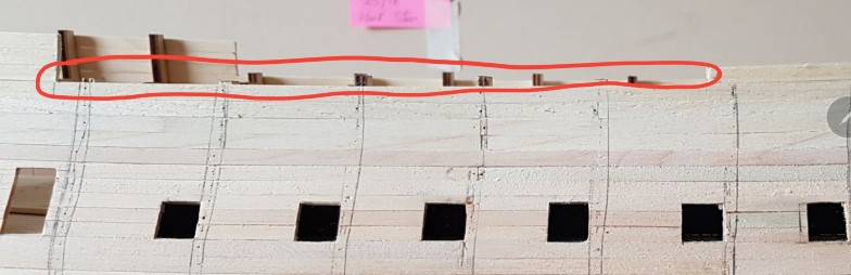

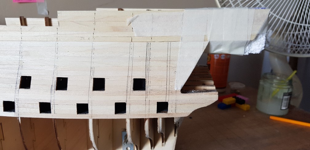

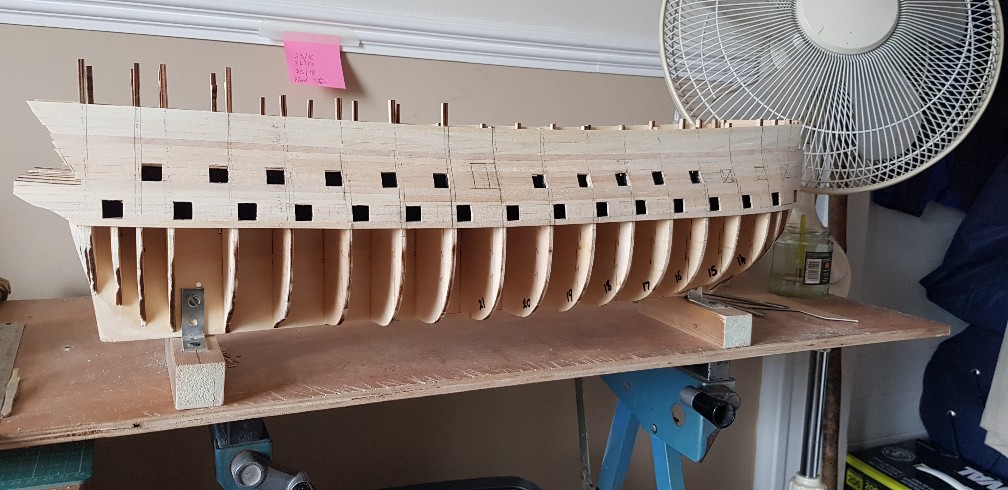

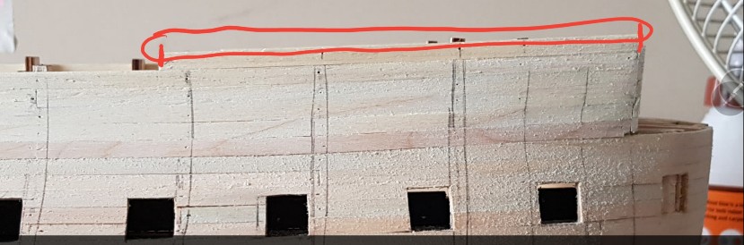

Ive hit upon something that maybe nothing it concerns my build and part 31/32..
Watching the videos through out and reading the online mags ive noticed several differences between my build and the official build and other people..
As you increase the planking up the ribs and you get higher and higher then onto the gallery and the forward section of planking.
Now the forward section ive noticed that people have two planks in height to the rib 12....
My build as one forward plank but with about 2mm to 4mm sticking up above the plank from the ribs..
Do i cut a piece to cover those ribs!
The middle of the ship it shows you on the video and in the book to place a strip of planking in the middle to cover showing ribs upto the top edge of the ribs..
Now if i did that strip it would come to the middle of the single plank along the forward section i mentioned above.
Again do i do as in the video in part 31/32 cut a length n trim!

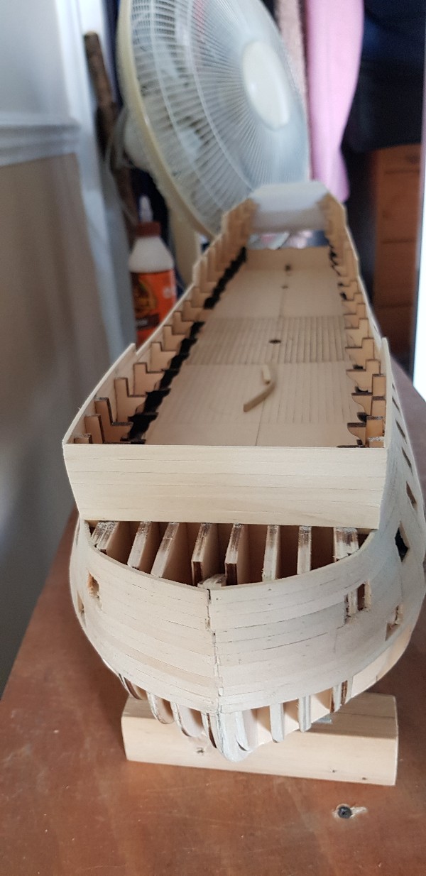

Here are another two photos of the areas that i have marked..
Photos next reply

I have given it some thought and i will cut a tapered plank for the front on both sides..
And a trimmed plank for the middle for both sides..

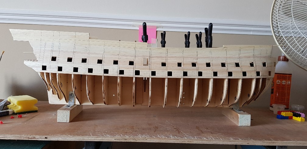

Two of the latest pics.

Just the top canon ports to mark out and cut....
The stern gallery wings as I call them are all wrapped up....
