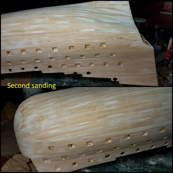

I've sanded the coat of filler smooth. Got a few spots that need more filler. Hopefully that will finish things off.

BigGrin Seems a never ending job there Mark, but you're getting there now. Soon be as smooth as a babies bottom LOL BigGrin LOL

After you've sanded and got smooth give it a couple coats of sanding sealer which will help when starting to glue the next layer. It stops the wood being too porous.

Coming on great Mark. Sounds like you’ve got a very dusty room with all that sanding.LOL
#85 Posted : 04 July 2019 08:15:07
Looking better and better each time I look in, looks like you're getting closer to applying the second layer of planking, that's when she'll really start to look like something special..... well done.....Cool Cool

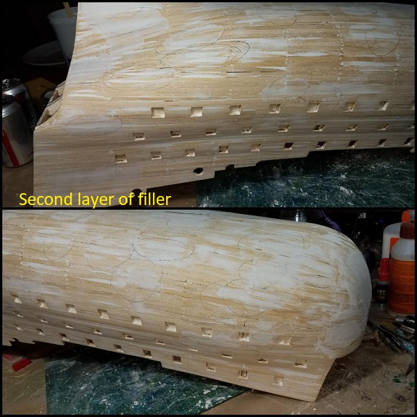

Foend several lopw spots so round 2 of the filler applied.

Looking good Mark.Love Drool
#89 Posted : 04 July 2019 21:51:29
BigGrin very nicely done Mark Cool

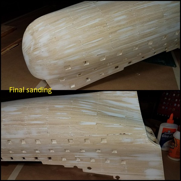

I've finished the filling and sanding process. I must admit this is by far the smoothest planked hull I've built so far.

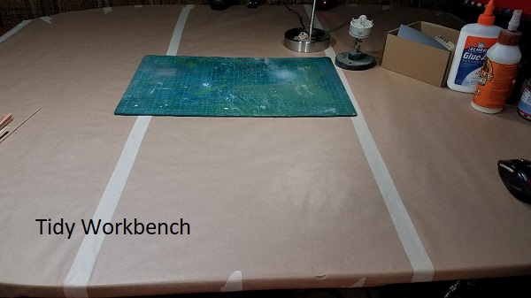

After spending almost 2 hours cleaning my bench from all the sanding dust, I'm moving on.

BigGrin Now that looks nice and smooth your efforts have really payed off Cool . Looking forward to seeing your next update Cool

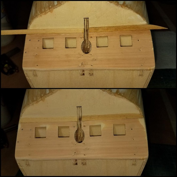

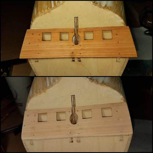

Moving forward on the stern. Pretty straight forward stage.

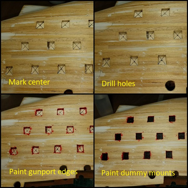

Before I started planking I decided to paint the gun ports to avoid spoiling the finished planking.

Sounds like a sensible option. Should give a nice clean finish once you get the next layer of plsnking in place.

This pic didn't upload with my last update

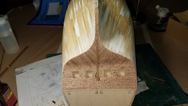

Finished final planking of the stern.
