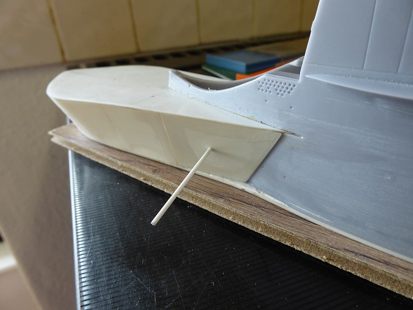

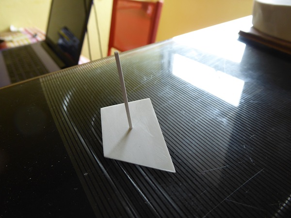

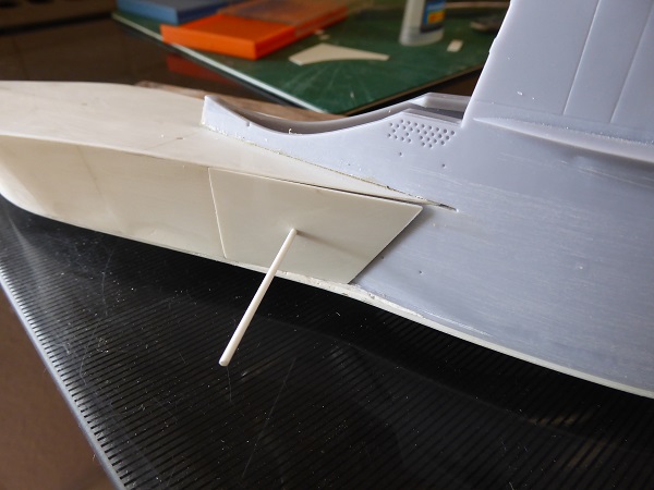

Continuing along the starboard side, i made the final panel, but found i couldn't hold the piece in place. To get round this problem i decided to fit a temporary rod to the centre so i could better position the panel before gluing.
The attached photo shows the hole for the rod drilled out.
#83 Posted : 30 August 2018 07:34:22
This photo shows the temporary rod fixed in place.

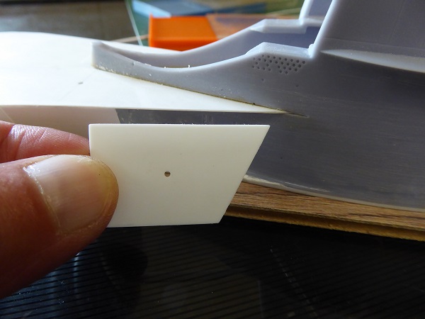

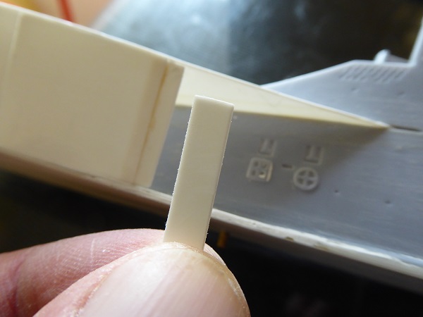

In addition to fitting a temporary rod to the panel i also made and fitted a support piece, glued to the back of the previous panel to aid correct alignment.
The attached photo shows the support piece.

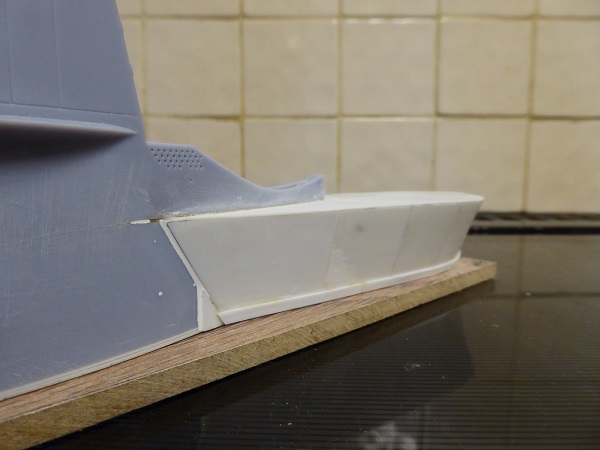

#85 Posted : 30 August 2018 07:37:25
Support piece fitted.

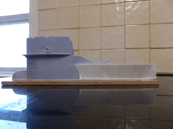

#86 Posted : 30 August 2018 07:39:05

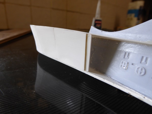

With a temporary rod attached to the panel and the support piece in place i could now test fit the final panel on the starboard side.
The attached photo shows the panel being checked for fit.
#87 Posted : 30 August 2018 07:41:22
The final starboard side panel fitted, connecting the base and lower deck of the conning tower.
#88 Posted : 30 August 2018 07:42:40

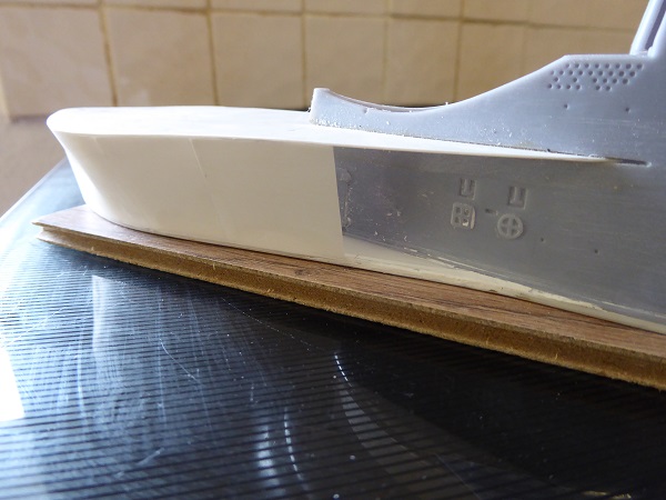

The same procedure was used for the final panel on the port side.
The attached photo shows it glued in place.

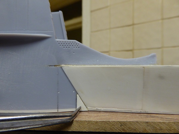

Back to the starboard side where i made a small triangular shaped piece to simulate the vertical weld lines when studying photos of U995.
The attached photo shows the piece in place.

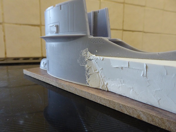

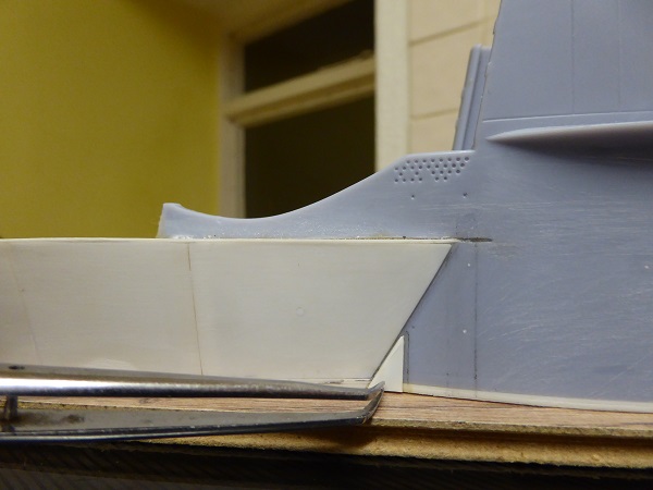

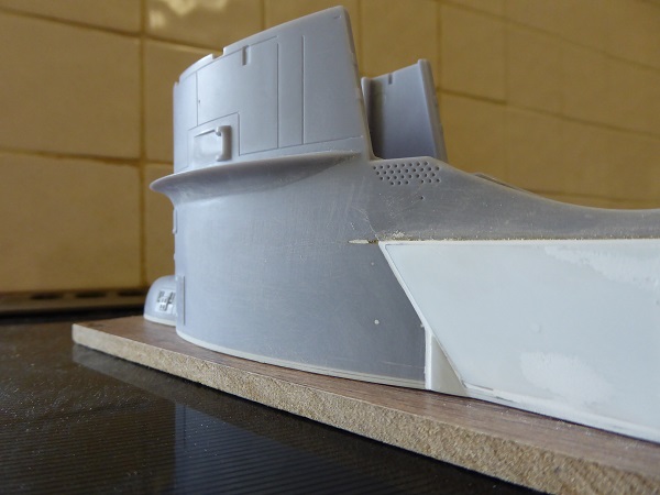

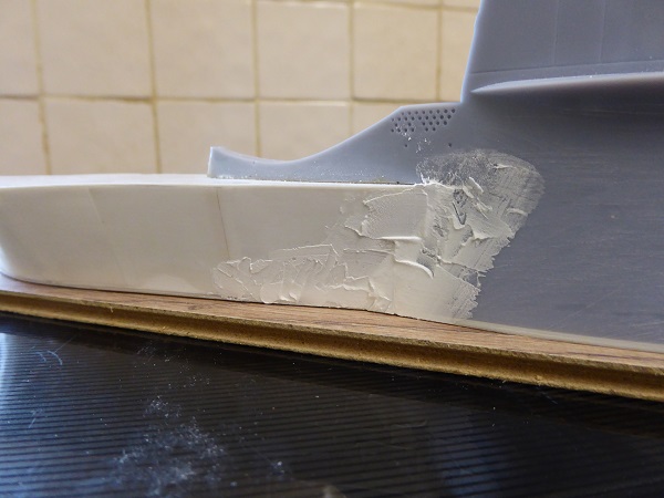

A liberal amount of filler was then applied to the starboard side.
#92 Posted : 30 August 2018 07:48:38
The port side was treated in the same way.

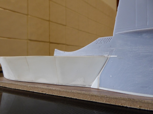

#93 Posted : 30 August 2018 07:50:01
The filler was then cleaned up using a sanding stick and a small needle file.
The attached photo shows the starboard side completed.

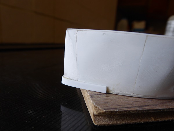

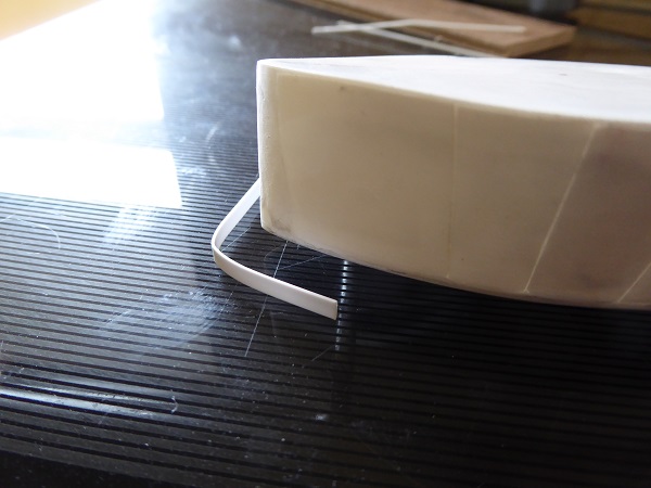

The next step was to add an edging strip around the base. Due to the nature of the curves i had to make this edging strip in several sections for it all to align. I used 3.2mm wide x 0.5mm thick plastic strip for this job.
The attached photo shows a length of plastic strip, bent into a vee-shape, cut and being checked for fit.

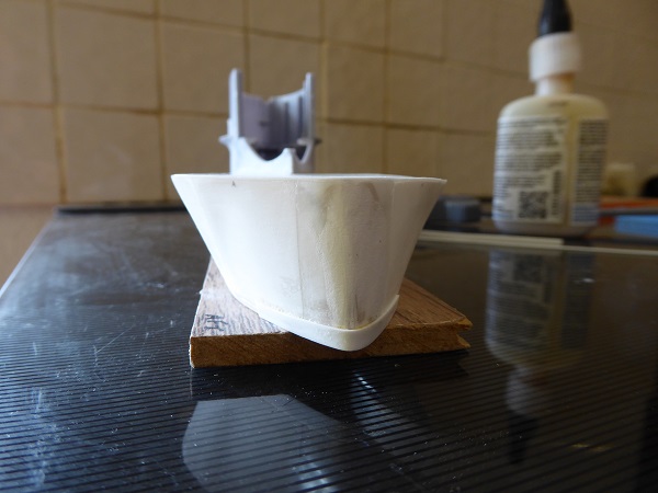

#98 Posted : 30 August 2018 07:58:42

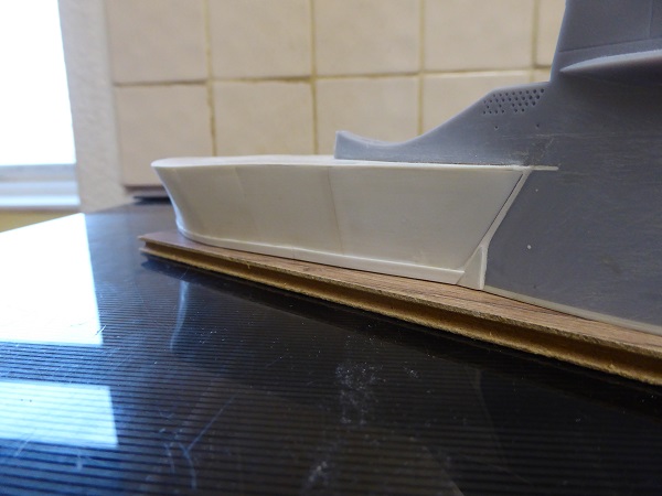

I then continued fitting small sections of strip along both sides until i reached the triangular shaped piece i mentioned before.
The attached photo shows the starboard side edging strip completed.
