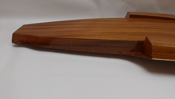

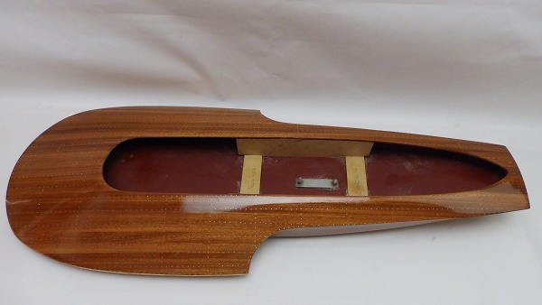

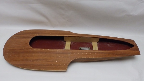

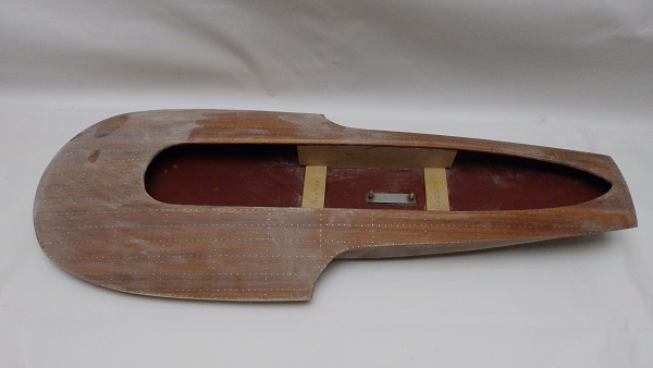

#85 Posted : 13 April 2018 17:05:31

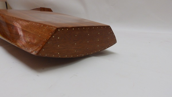

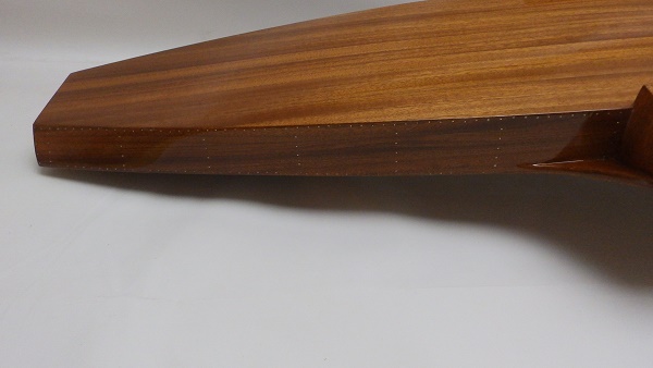

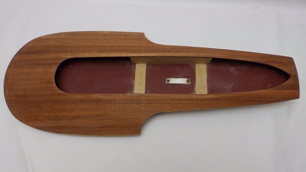

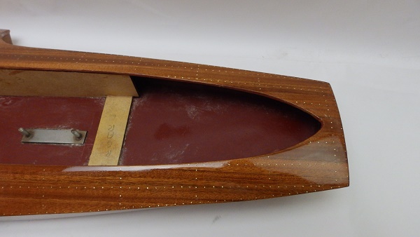

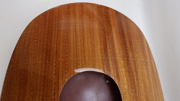

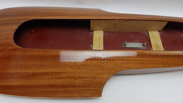

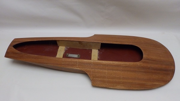

BigGrin Hi all
More progress. The hull wood came ready primed with a sanding sealer type semi gloss finish but due to the drilling ect it needs sanding back to get a good surface for the clear coat.
So the pins have been sanded back to the deck level where needed to get a flat surface, sand paper 1st then wet-n-dry paper getting lighter with the grits until I had a nice smooth finish top and bottom. To remove the dust Isopropyl Alcohol soaked cloths were passed over the hull several times this also gives an indication for a short while of how the finish will look and show any imperfections to put right.
The hull will be clear coated in two sections bottom and sides 1st then the upper surface. The bottom and sides have been coated and is now drying. Tomorrow the top surface will get the same treatment.
More soon.
#86 Posted : 13 April 2018 17:30:34
Thats some shine. Detailing was well worth all that time.
Cool Cool Cool Cool

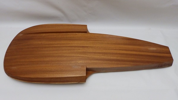

#90 Posted : 14 April 2018 16:33:07

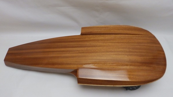

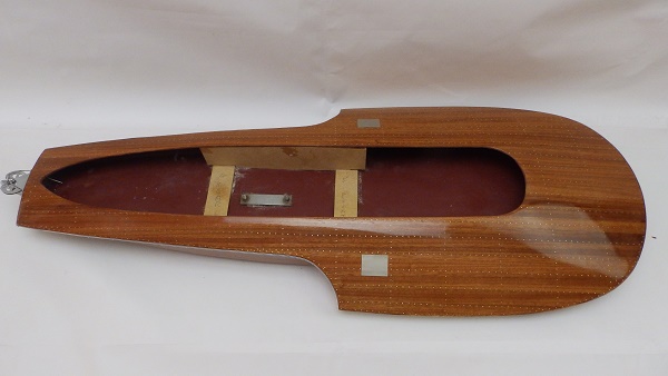

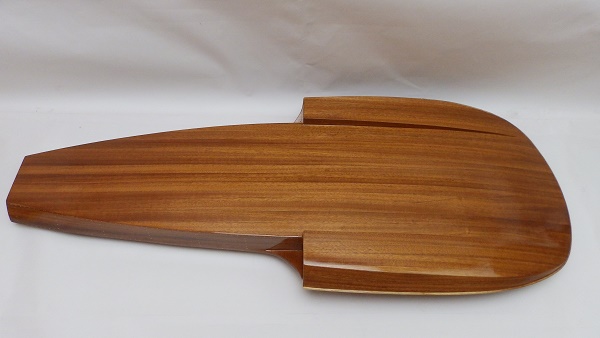

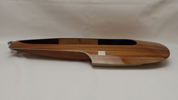

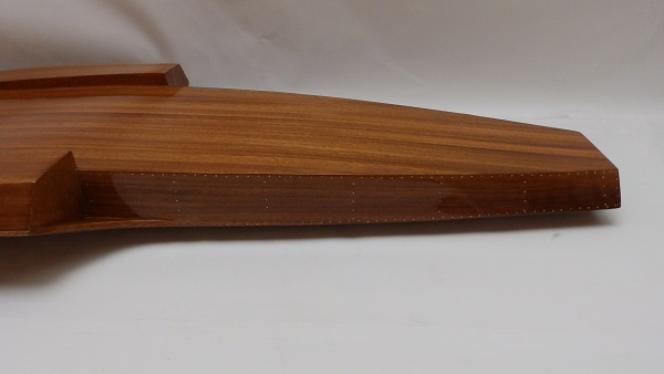

BigGrin Hi All
The hull has been turned over and the upper surfaces treated to a couple of coats of clear coat. Once its all dry the metal work can start to be fitted.
More soon.
#91 Posted : 14 April 2018 18:16:17
Posts: 6,866
Points: 20,915
Nice and shiny Andy, looks like Yacht varnish.Love
#92 Posted : 15 April 2018 00:06:52
BigGrin Thanks for looking in and your comments Mark the Yacht Varnish look was exactly what I was trying to reproduceCool

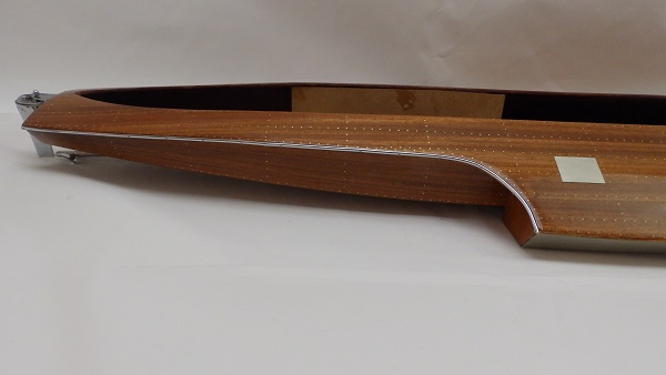

#93 Posted : 22 April 2018 17:38:57

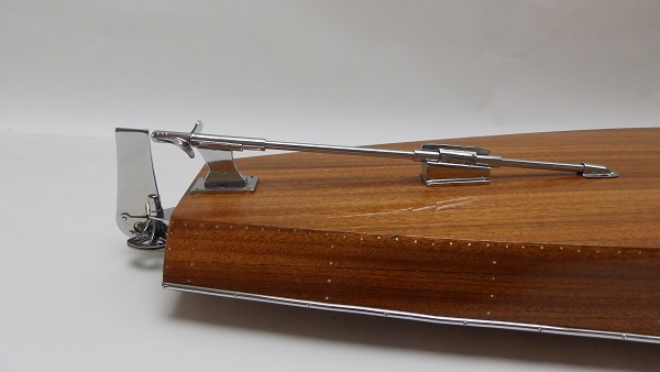

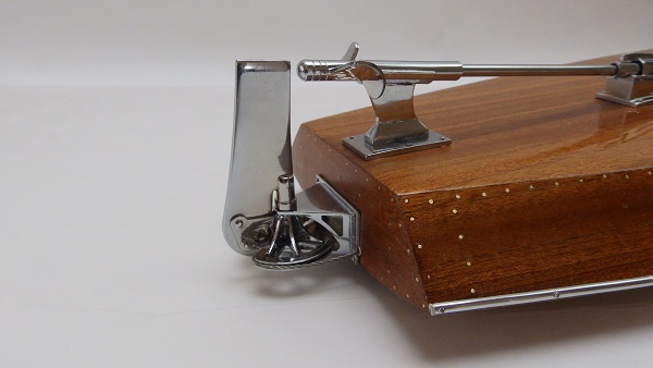

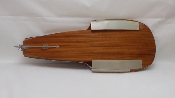

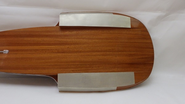

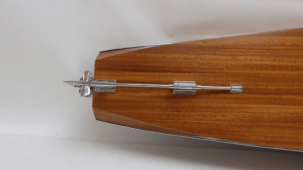

BigGrin Hi all
More bling added the rear sides has had more chrome strip added and the access panels added to the upper hull. Underneath the reinforcement plates have been fixed to the front and then the rear drive train and rudder added to the stern area.
More soon.
#94 Posted : 22 April 2018 18:09:24
Wowser, that hardware looks the business Drool
Any plan to paint the prop bronze or brass?
