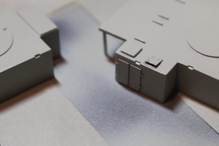

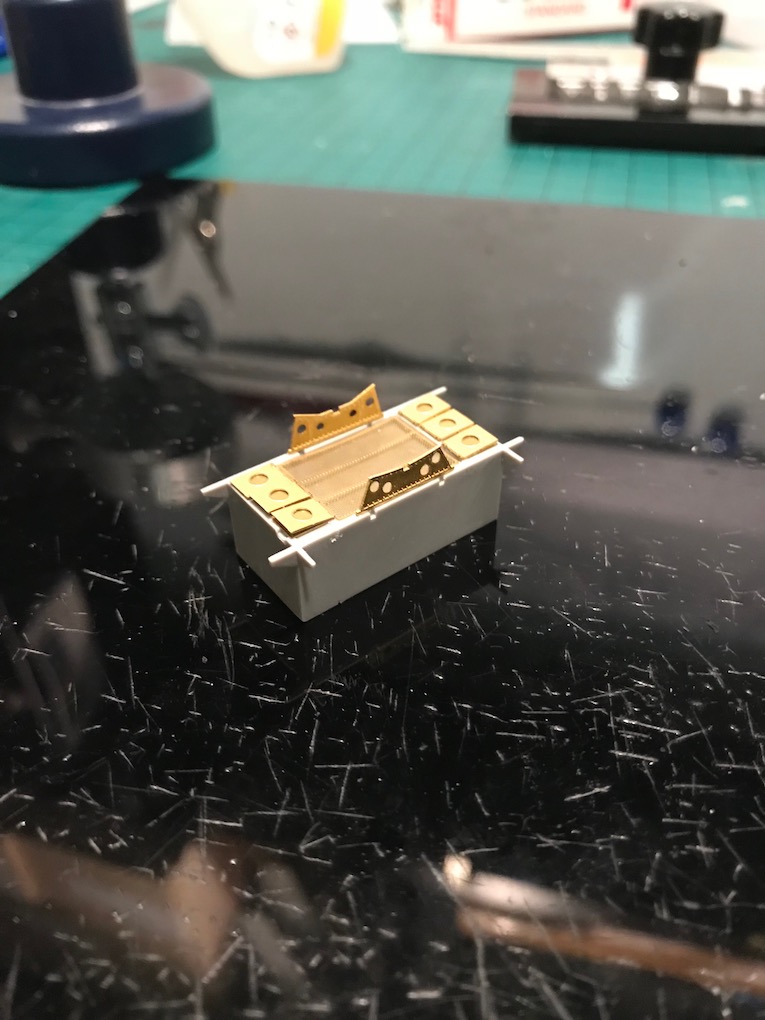

Lower superstructure part 1

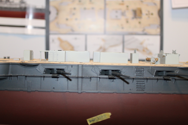

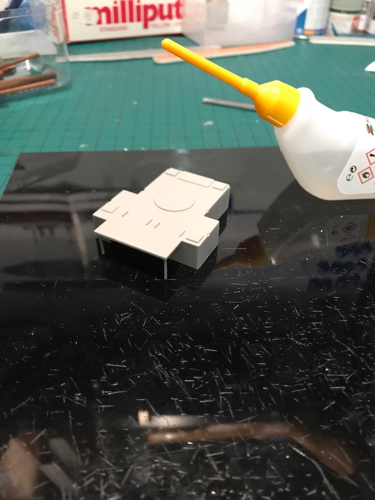

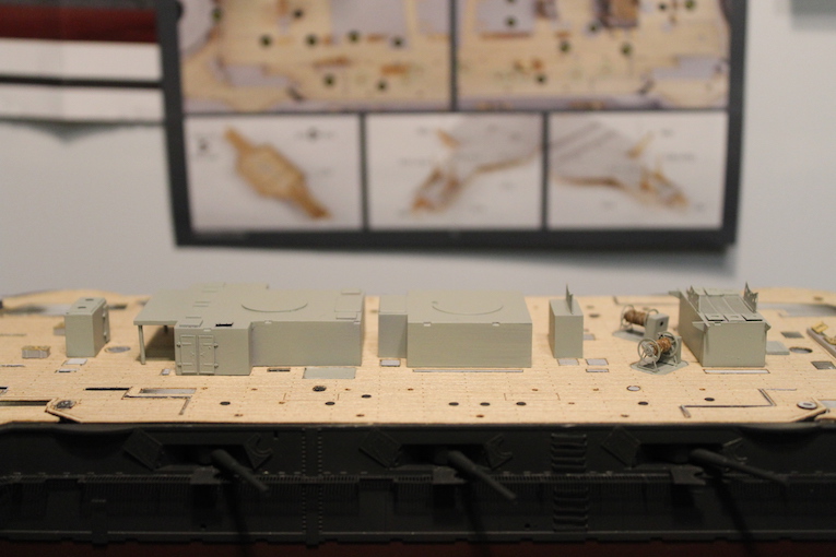

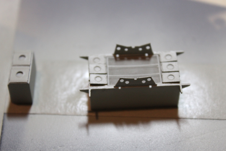

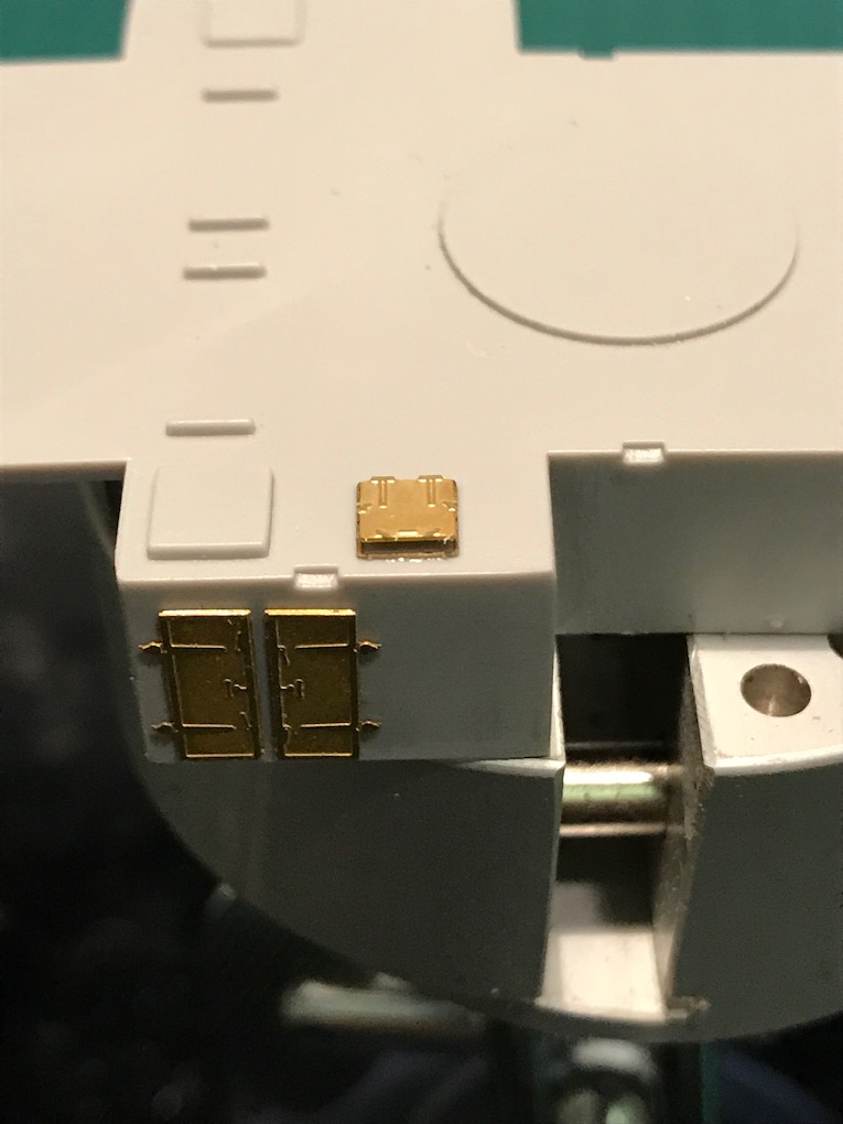

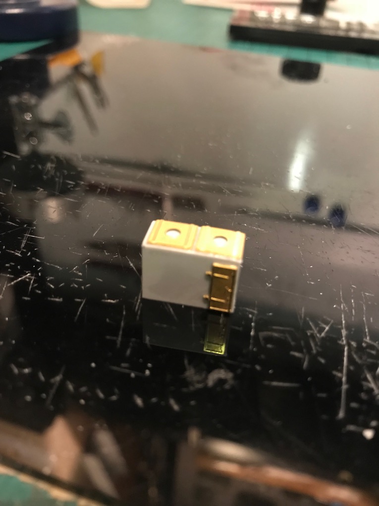

With the first set of winches done my next task was the lower superstructure amidships.

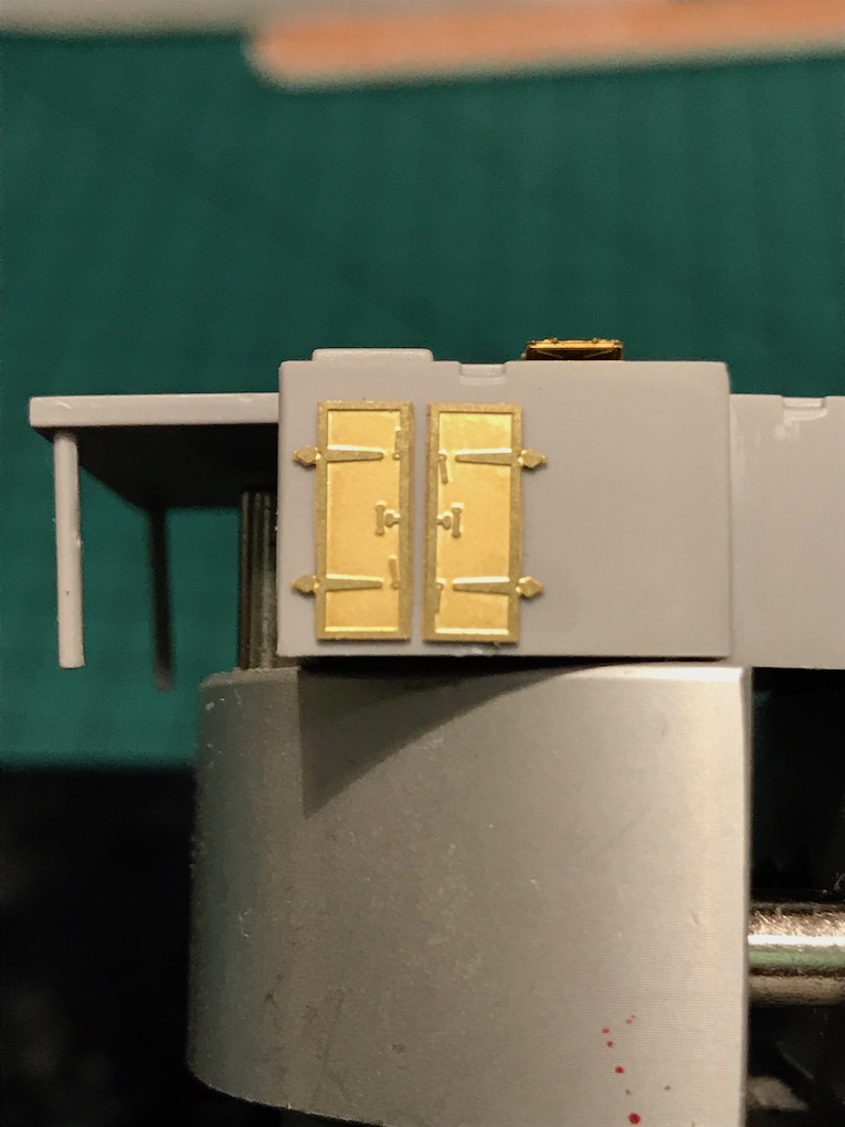

first up is a smal structure to which a single door and some hatches are added from the upgrade set. Photo 1.

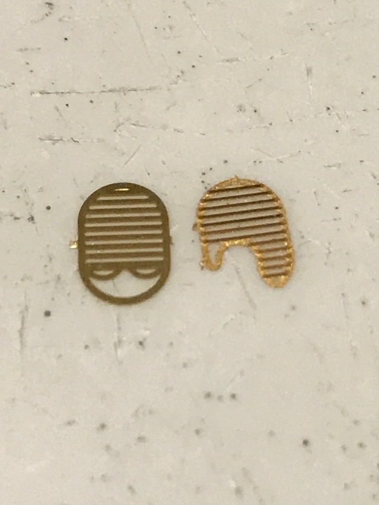

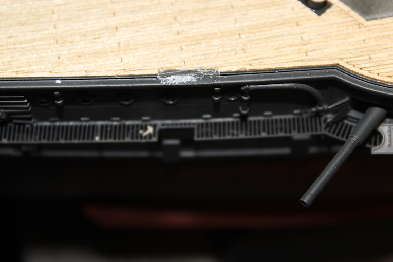

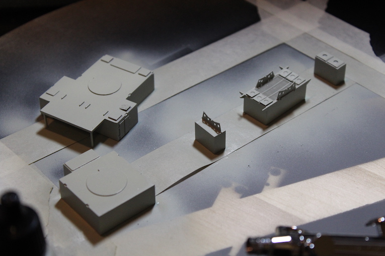

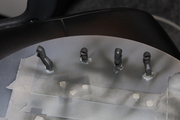

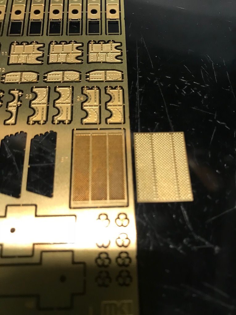

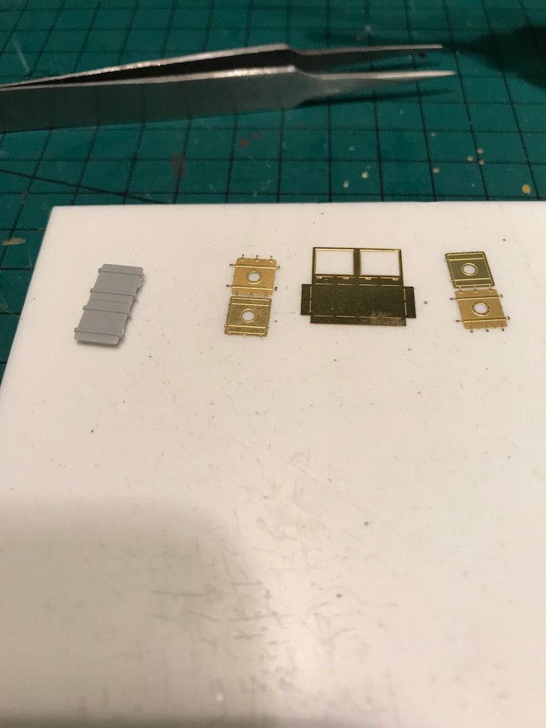

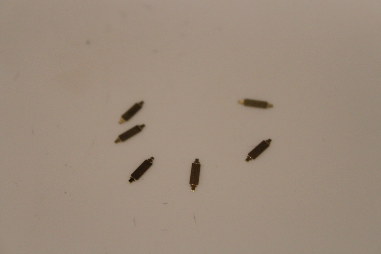

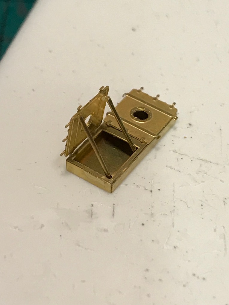

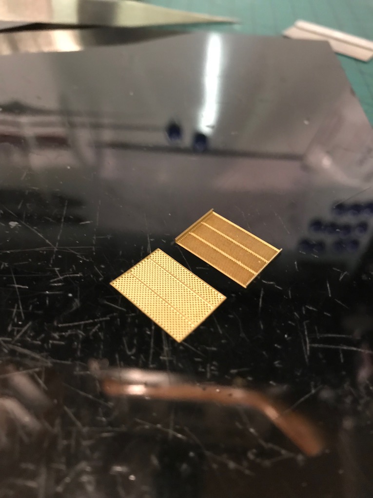

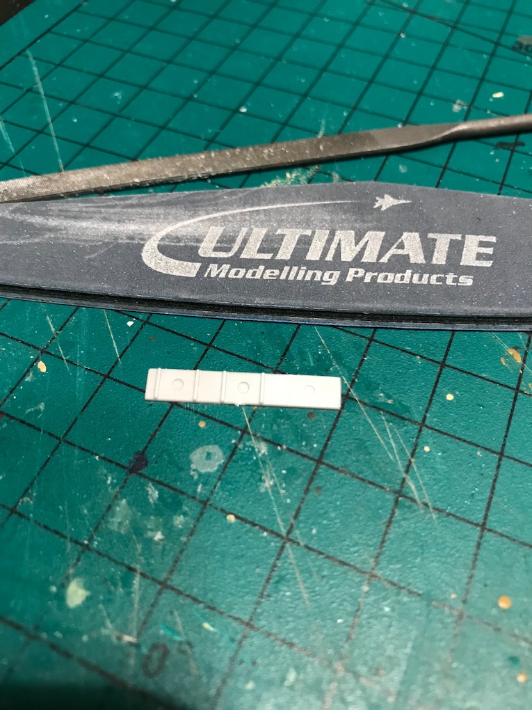

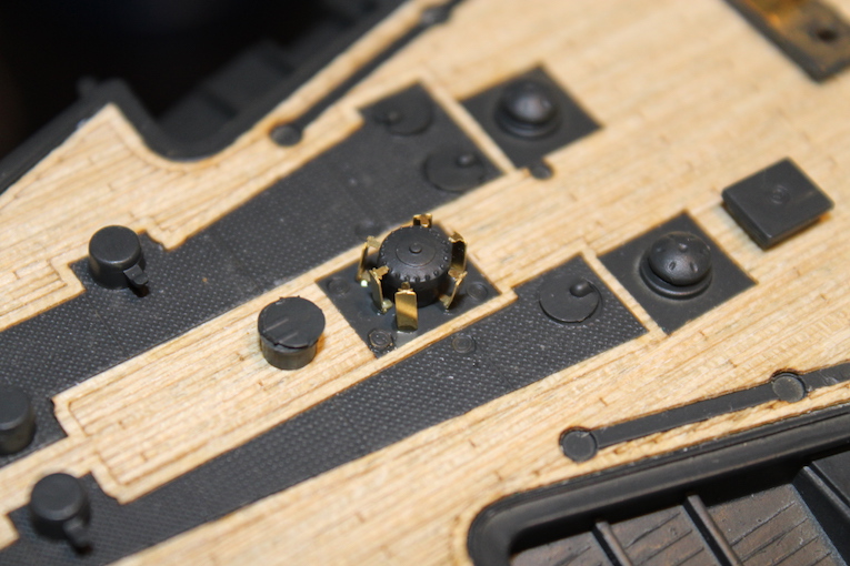

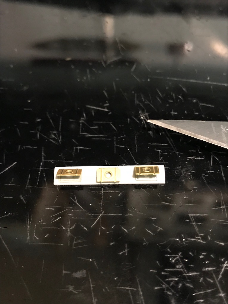

The etch doors are made u of 3 sections which are folded to create an outer and inter surface as well as a door frame. this allows toy to model any door open if your wish. Photo 2 &3.

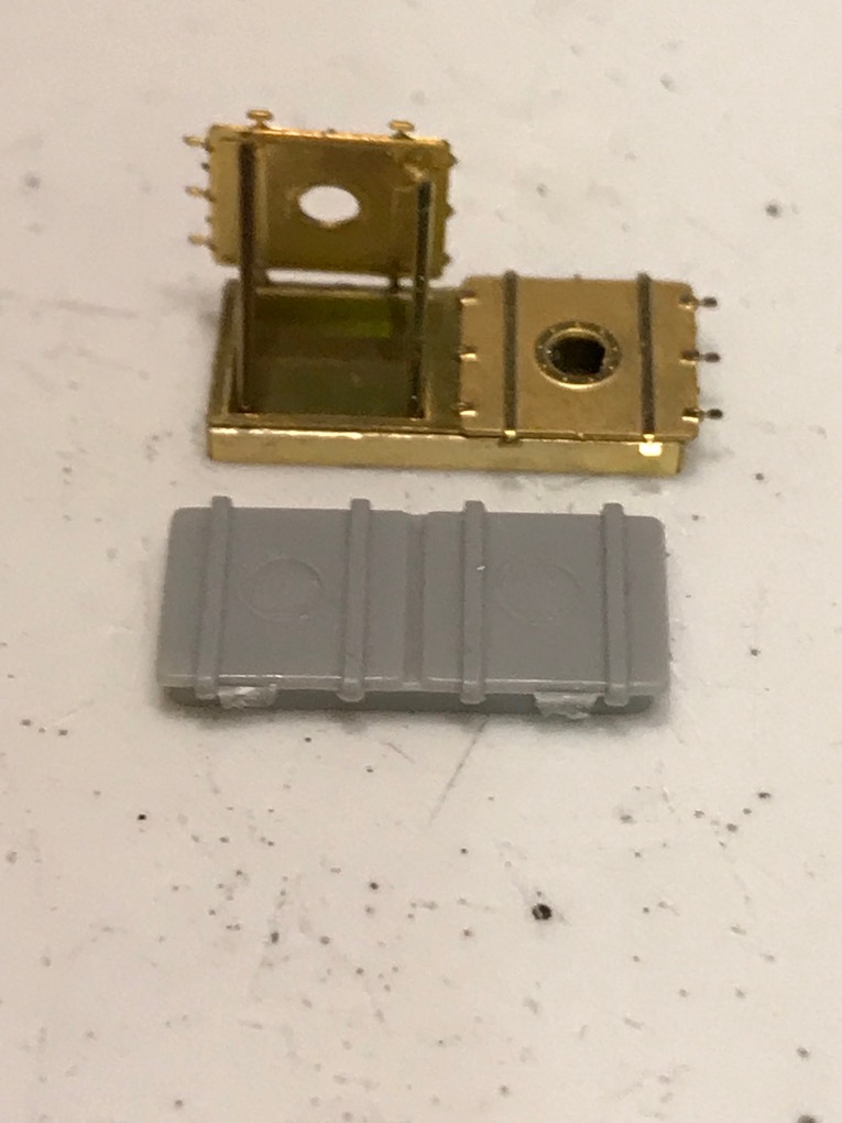

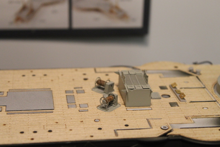

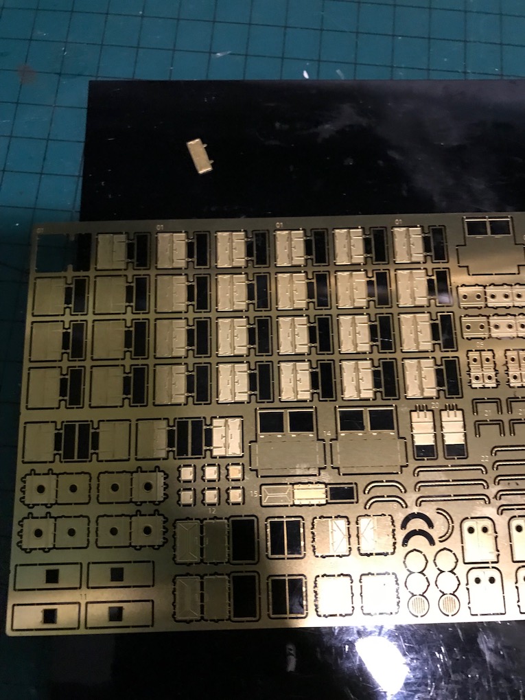

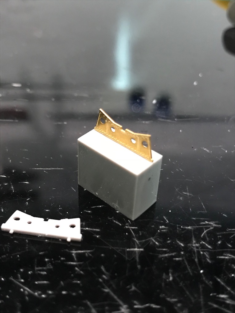

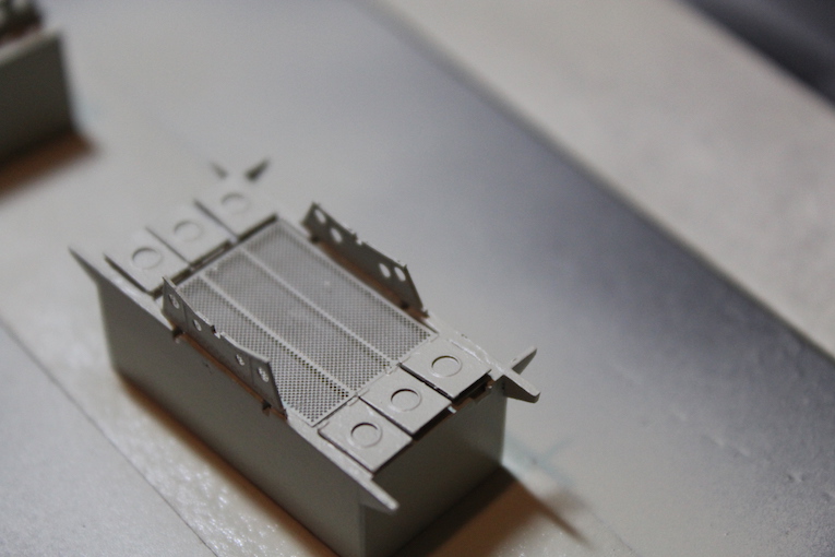

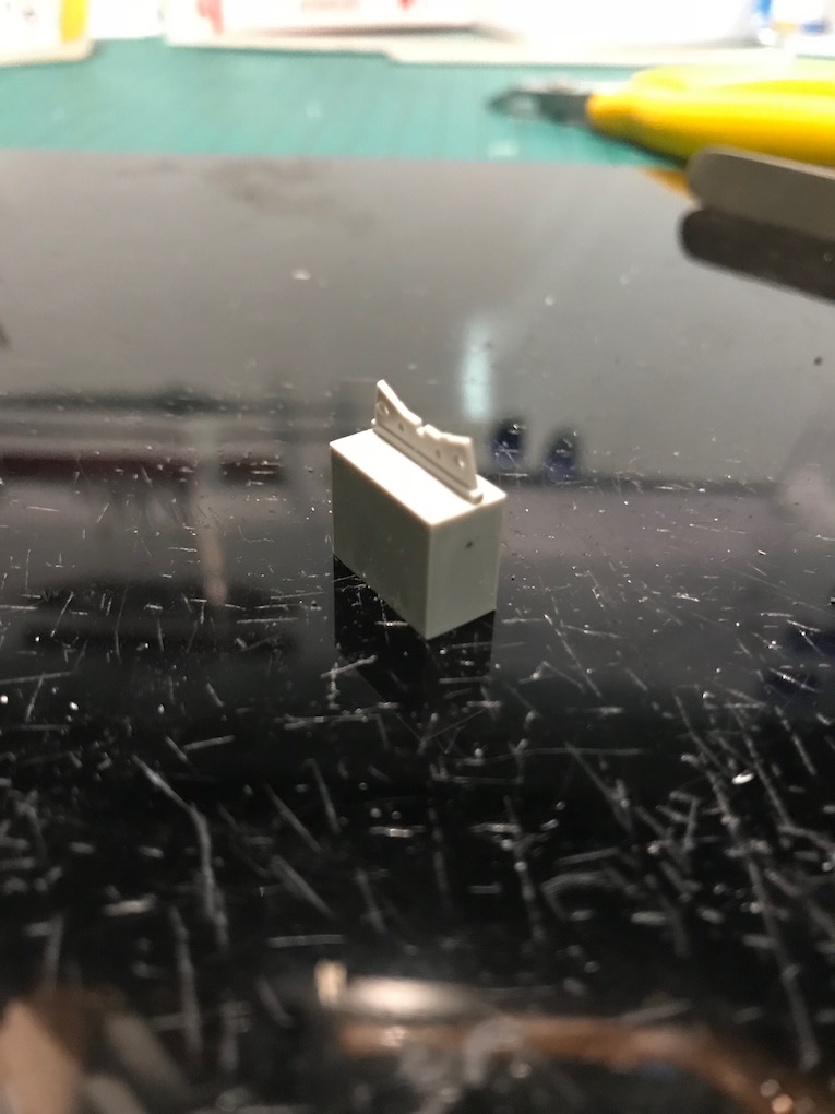

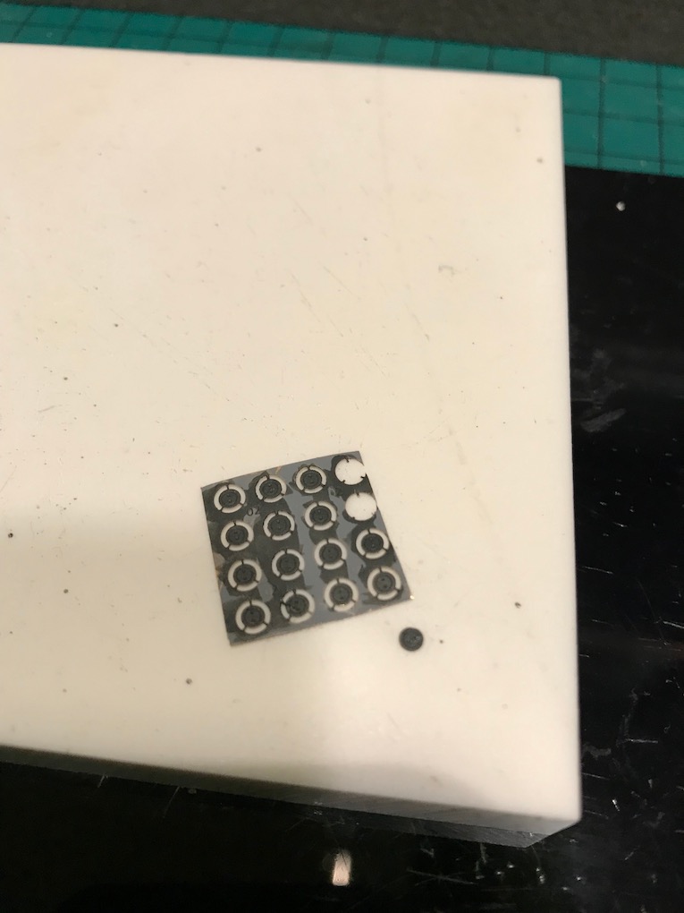

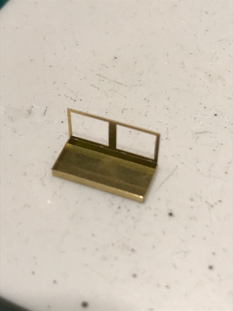

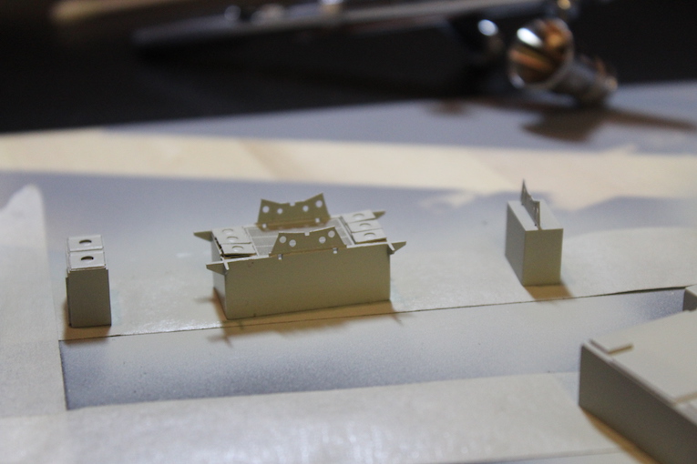

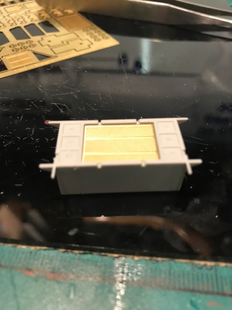

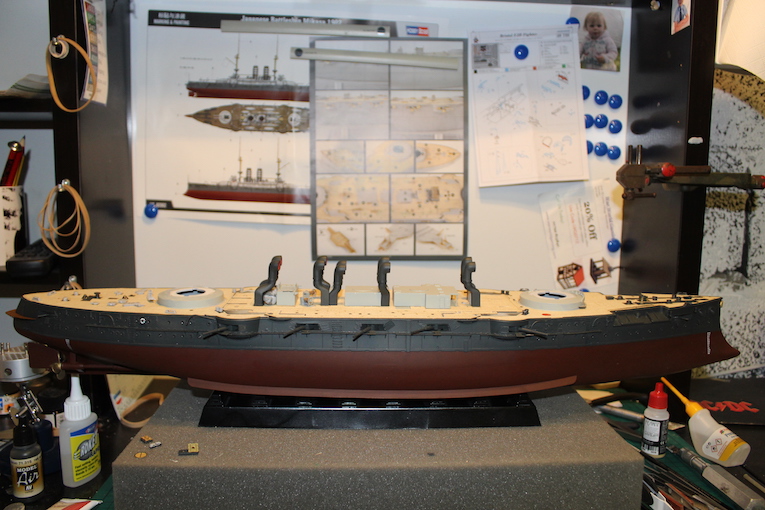

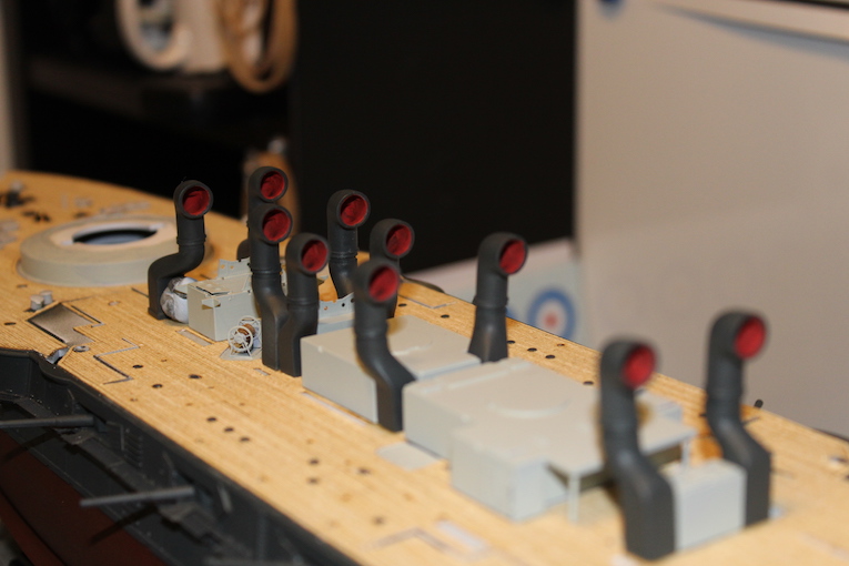

The second small structure has the kit supplied boat support replaced by etch. Photo 4 & 5
The next structure will accommodate one of the funnels. there are etch doors to add as well as a hatch

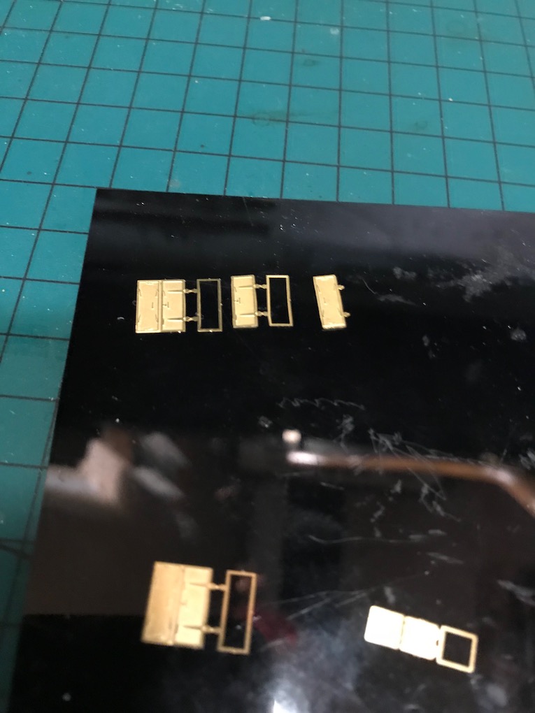

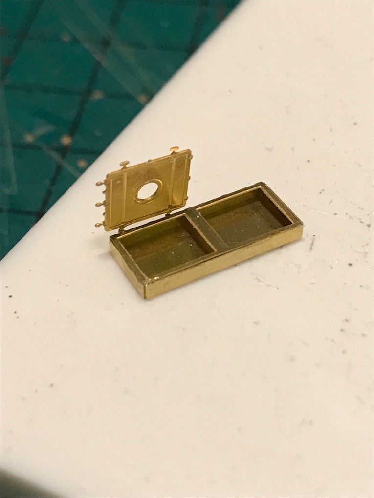

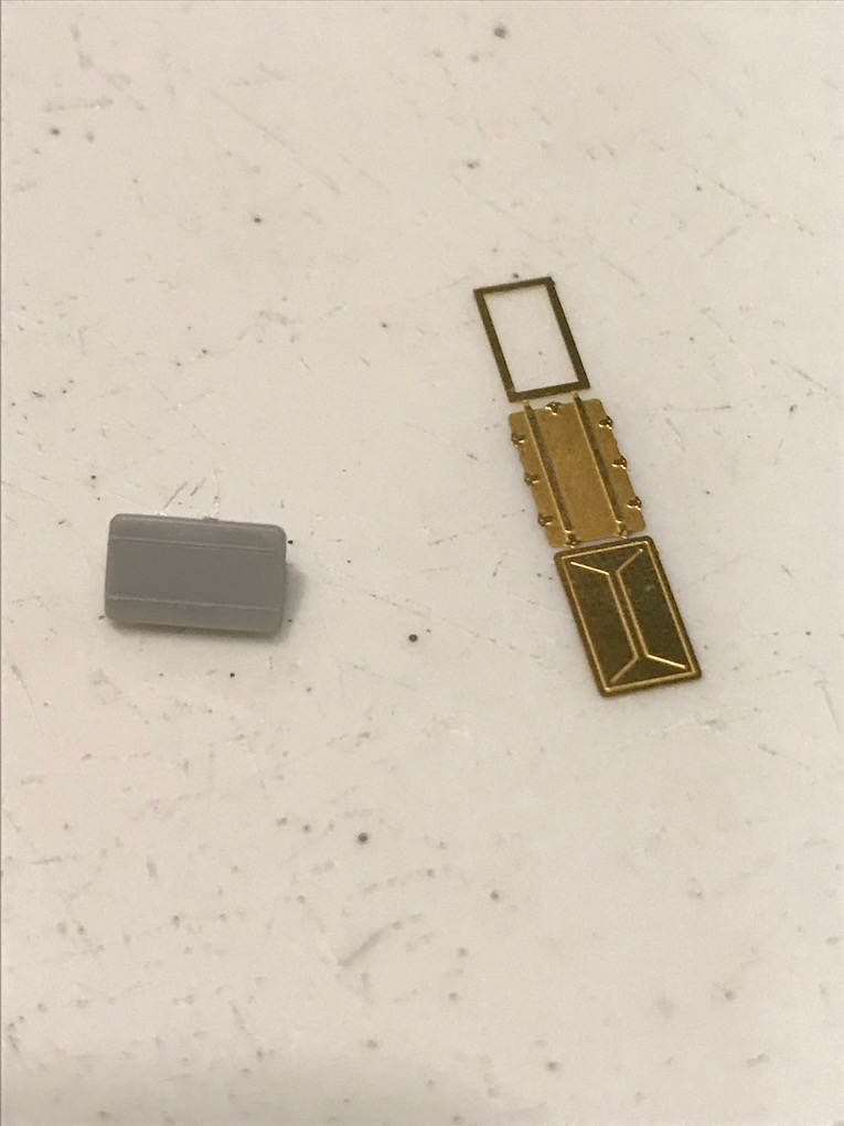

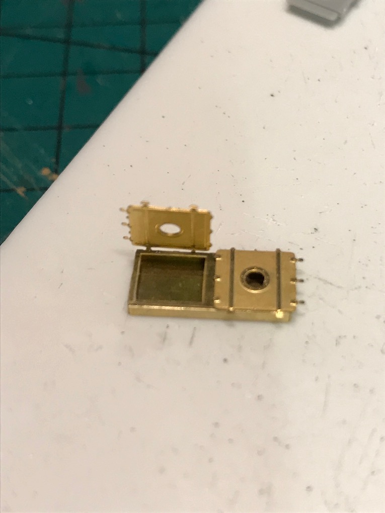

The last structure is more complex in terms of the etch. this part has some kit supplied etch, some mesh that sits in the top. the upgrade etch has folds to the side which lift the grill making it much more realistic. 6 hatches are also added, these fold in the same ways as the doors. finally two replacement etch boat supports are added.

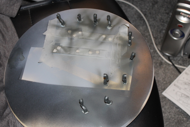

All the parts were primed with Halfords grey before bing painted with light grey. Although the artwork depicts the ship with white upper works this is not correct. it was a pail grey, IJN greys all appeared to dark so after trying several I settled on this grey.
Once dried the parts were secured in place with CA.

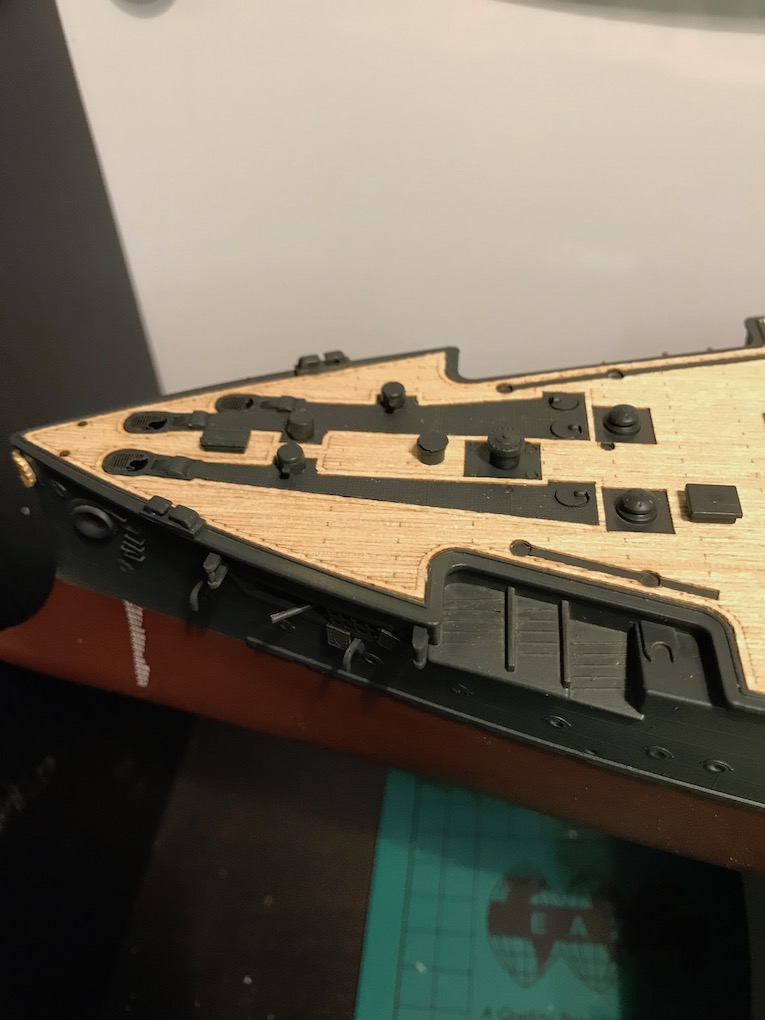

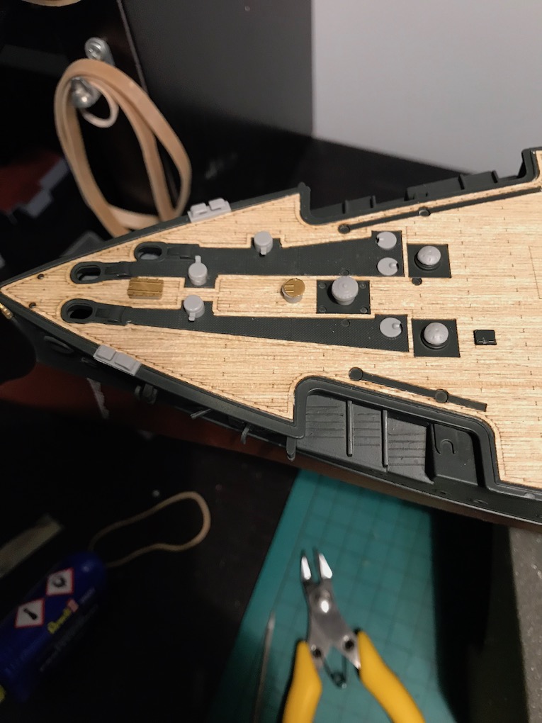

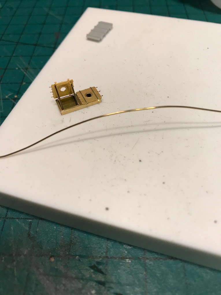

Deck fittings part 1

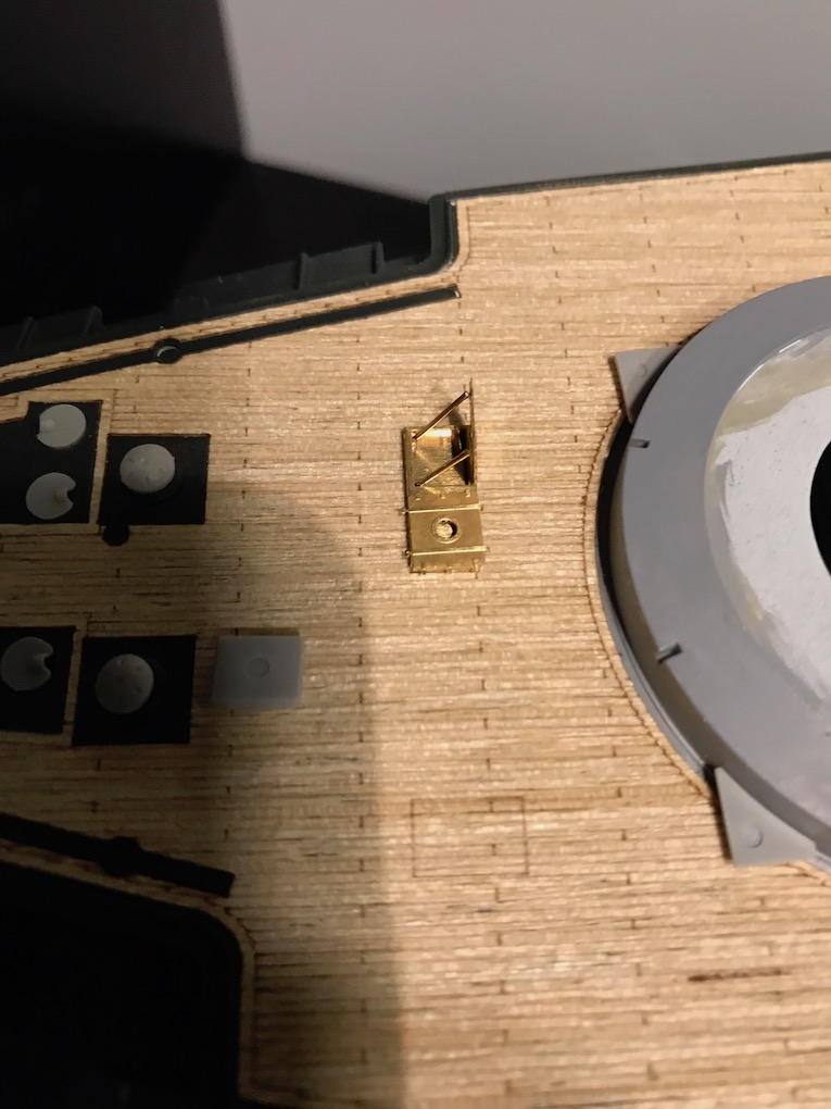

I started the deck fittings at the bow. there are a number of parts to be fitted that need no alteration, but most the hatches have some form of etch part to be added.
The kit comes with anchor grills the ones in the MK1 set look much better however.

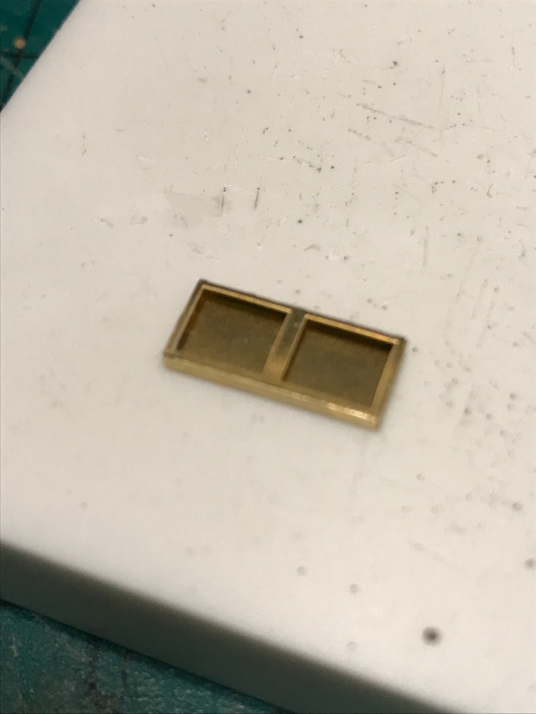

Most the hatches can be displayed open. some kit parts are totally replaced by etch.
I decided to display one hatch open so added a little wire to depict it proper open

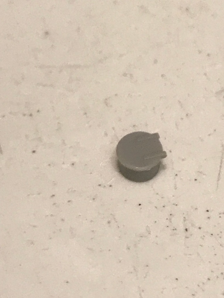

the 6 etch parts that are attached to a hub are kit parts, not sure what it is though?

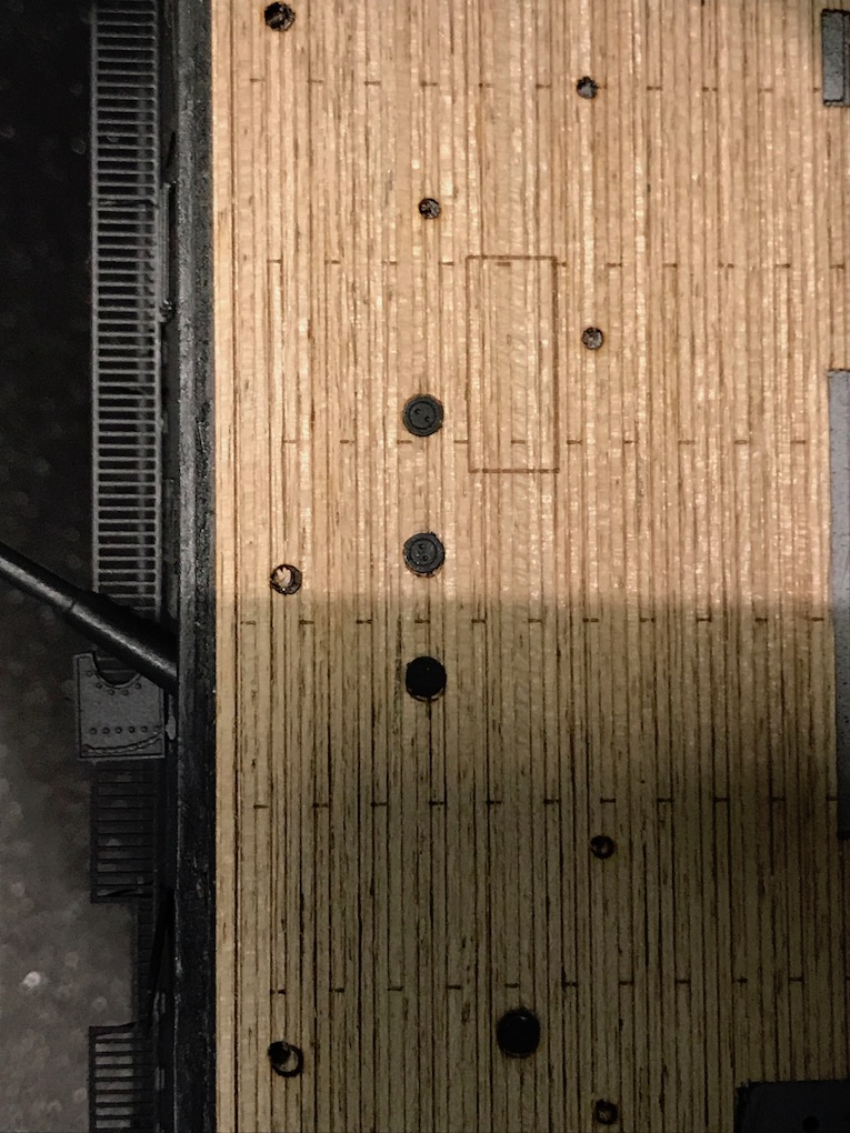

the wood deck needed a little trimming to take some part correctly
there are some very small etch discs that go on the deck. both the kit and the MK1 set supply these the MK1 set had a little more definition so I used them

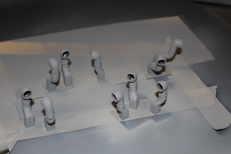

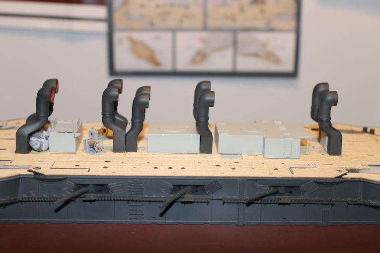

Air vents Part 1

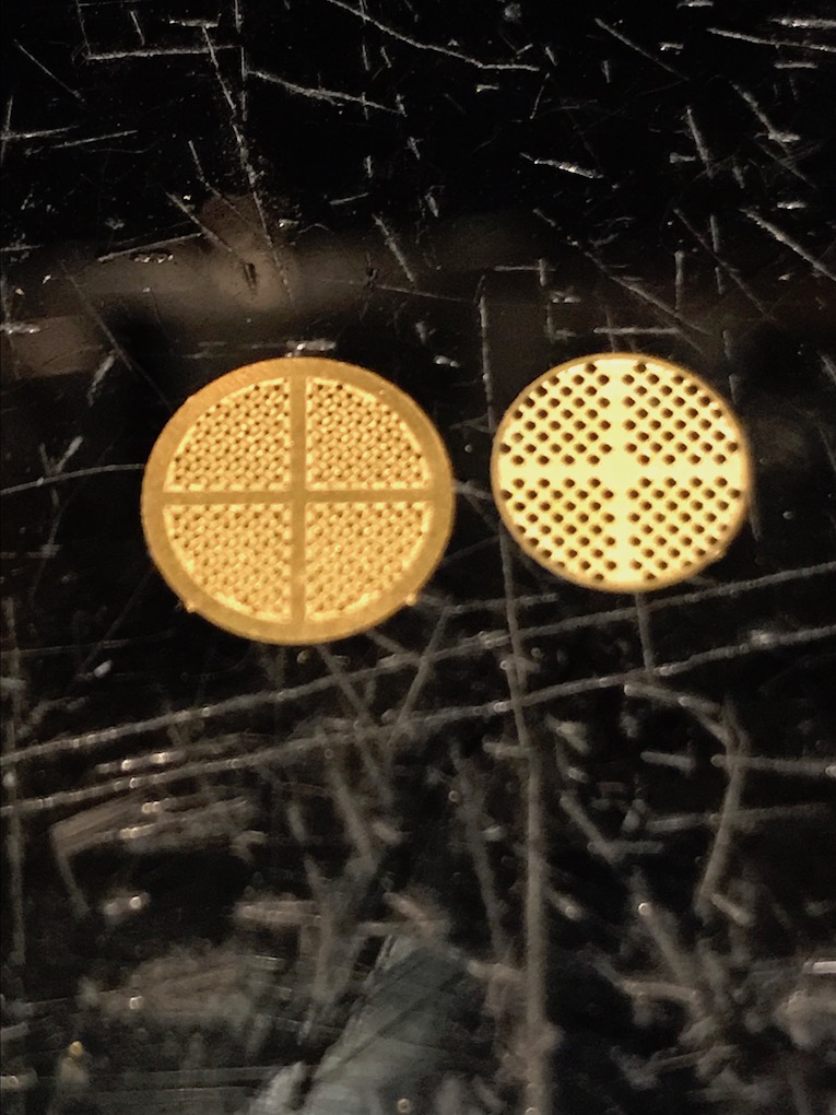

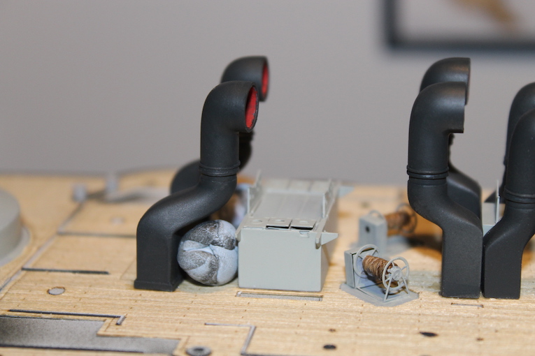

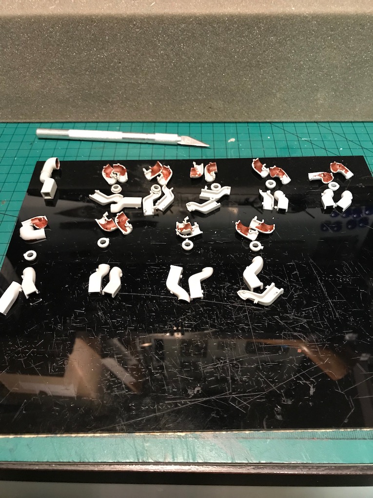

one of the loverly features of this kit is the large number of air vents. By 1905 most of the upper cowls had been removed and this kit comes with the etch to work the later vents, as does the MK1 set. however as launched in 1902 all the vents had cowls
Both the Kit and the MK1 set have cowl grills. My research has not been able to identify which is most accurate, however I decided I prefer the look of the kit grills which sit inside the towel rather than the MK1 which cover the whole from as this would be visible.
some considerable care is needed to check the orientation of the cowls the instructions are good but once they are built and painted it is very easy to mix them up
there is some cleanup and filling required at the base of a small number of the vents but otherwise fit is really nice.
