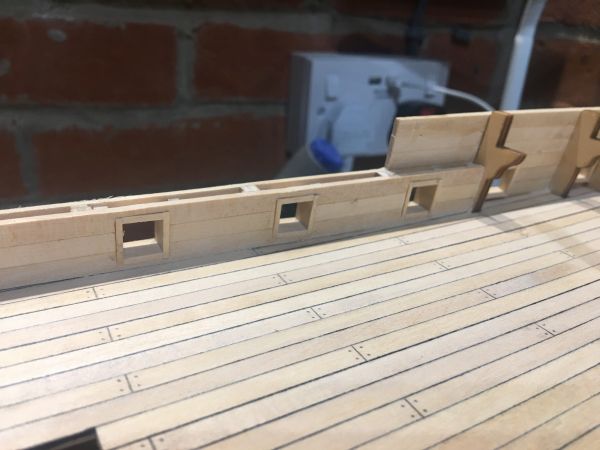

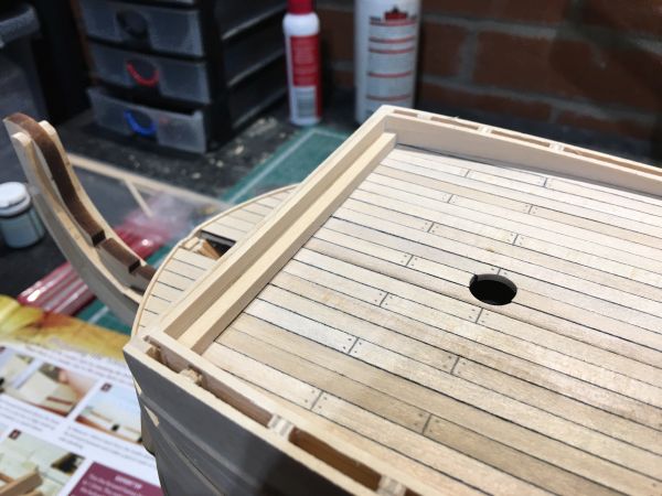

09/10/2017
Quarterdeck sanded smooth, plank ends and nails simulated with pencil marks... due to the sanding she’s now full with sawdust again, will be taken to my workplace to blow it out, again 😳... but probably last time due to delicate works coming now, she won’t be transportable anymore... also hopefully she won’t fill up again

10/10/2017
gun ports roughly cut out at quarterdeck, three of them sanded to their exact size

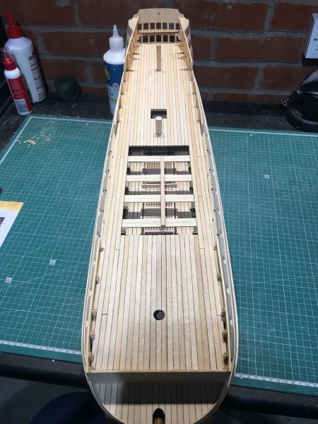

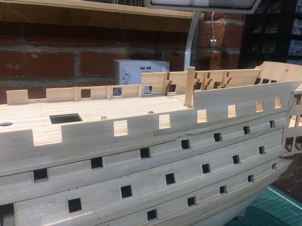

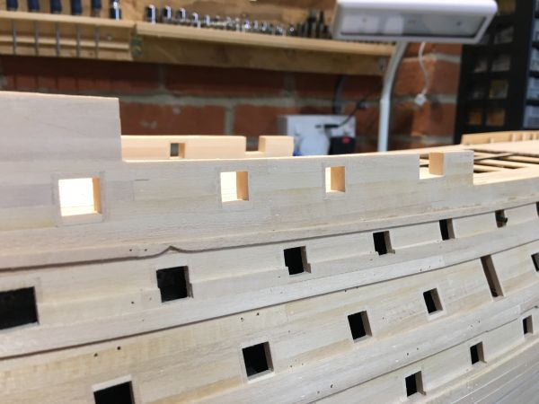

Points: 1,482
Location: South Norfolk

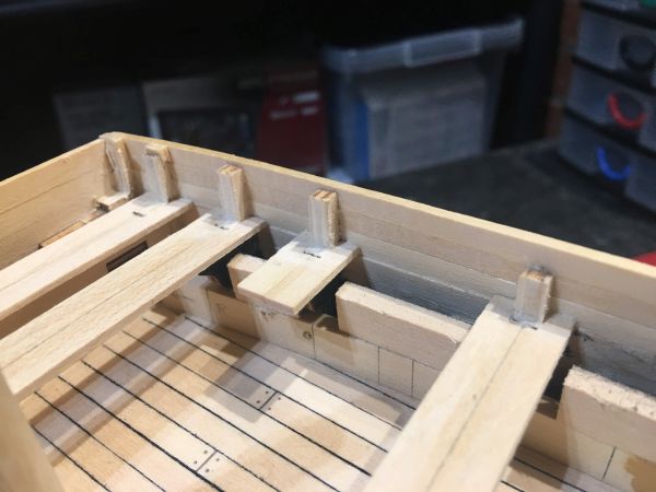

11/10/2017

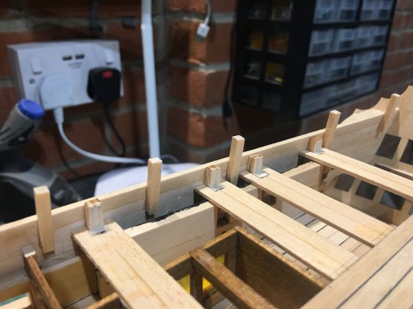

all quarterdeck gun ports and timber heads opening sanded to correct size... support pillars for bulwarks cutted and glued in place, need to dry fully before continue.

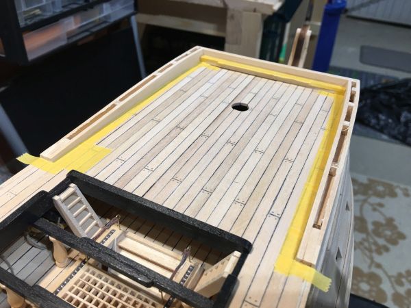

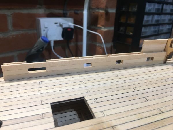

15/10/2017

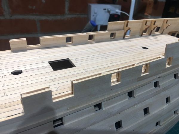

bulwark support pillars dried and inside faces built up with planking... gun ports sanded trough the inside surface... bulwark top sanded smooth.

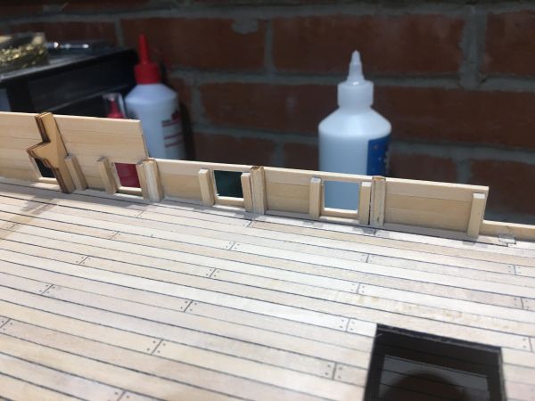

gingerale75
#92 Posted : 30 November 2017 21:30:12
Joined: 30/11/2017
Posts: 493
Points: 1,482

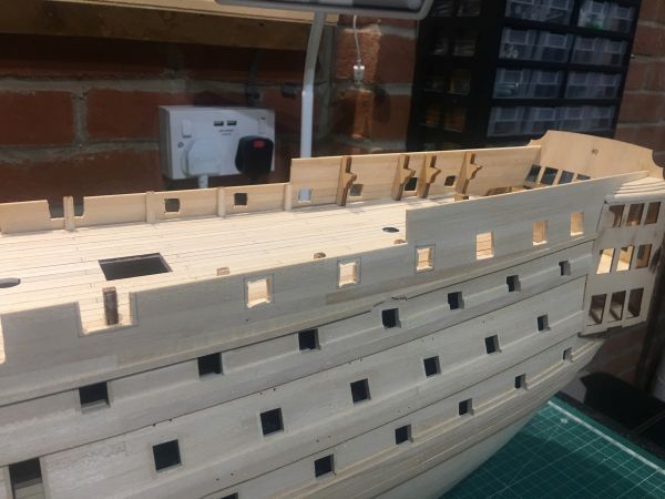

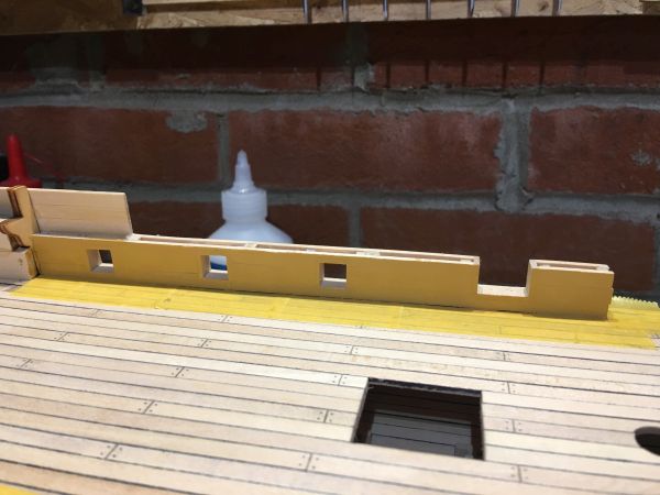

18/10/2017

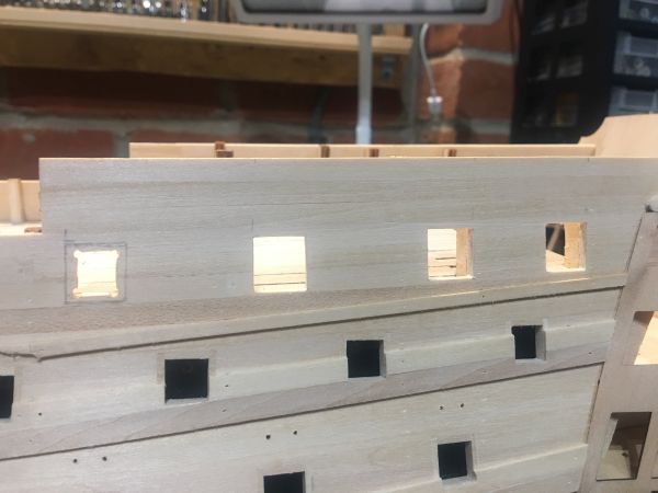

gunports at the quarterdeck bulwarks lined... cutout for timberheads also lined... let them dry completely before sanding smooth.
Happy building!

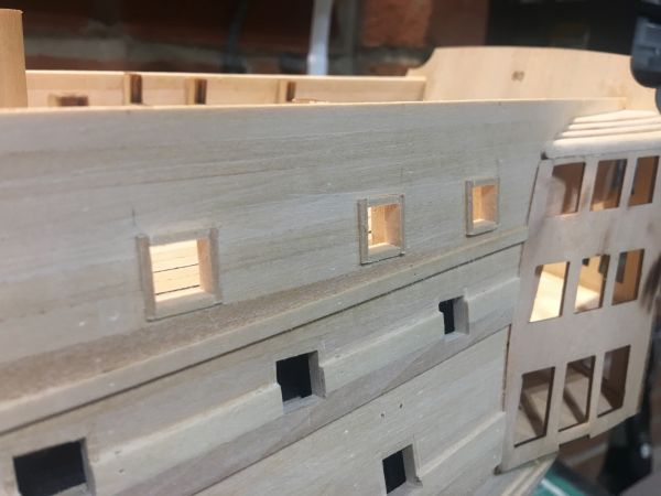

22/10/2017

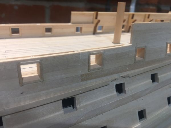

quarterdeck gunport linings sanded smooth outside and inside of the bulwarks... dummy cannon barrel support strips fitted and drilled... quarterdeck cabin walls prepared.

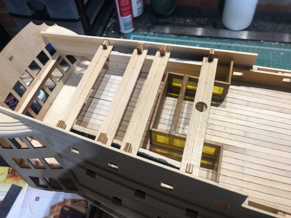

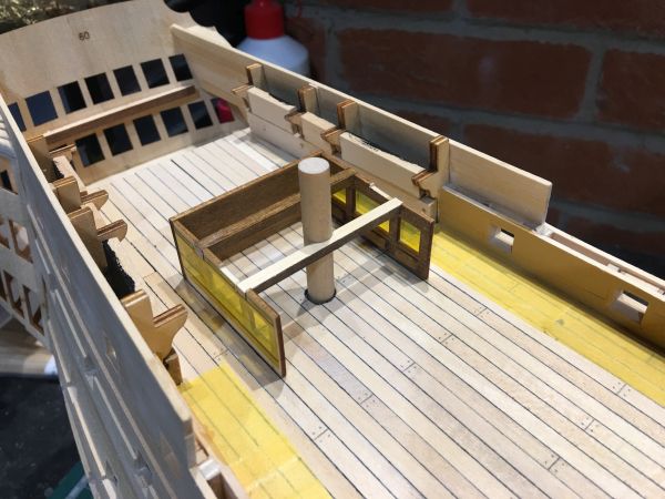

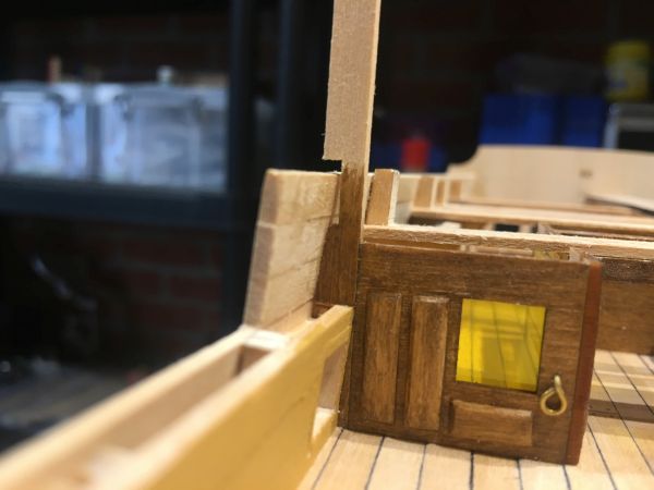

gingerale75
#94 Posted : 30 November 2017 21:32:05
Joined: 30/11/2017
Posts: 493
Points: 1,482

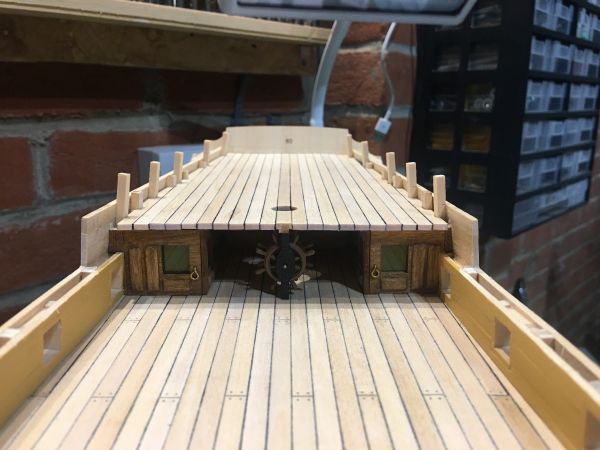

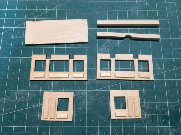

23/10/2017

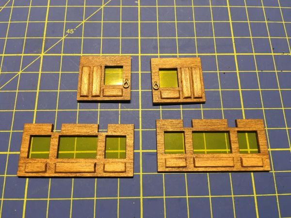

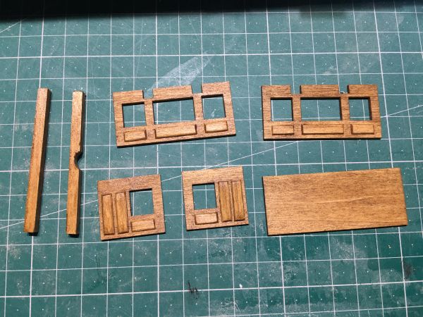

Cabin walls stained dark oak, window “glass” and door handle fitted... inside of the bulwarks painted yellow ochre.
Three of the cabin walls assembled and glued to place.
Happy building!

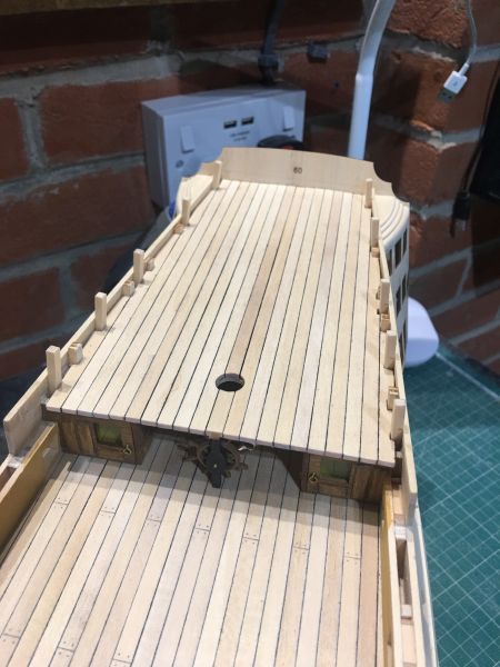

24/10/2017

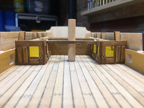

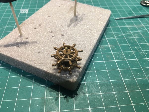

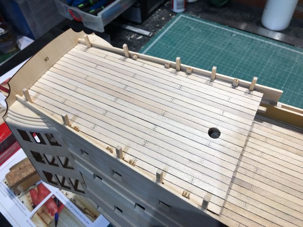

Morning activity: remaining two cabin walls fitted... poop deck (what a name 🤣) support beams fitted.
Afternoon activity: ship’s wheel fitted... gap around the cabin wall filled (top will be cut off)... started to planking the poop deck... now paused to spend some time with my son (daily XBox time 😊)

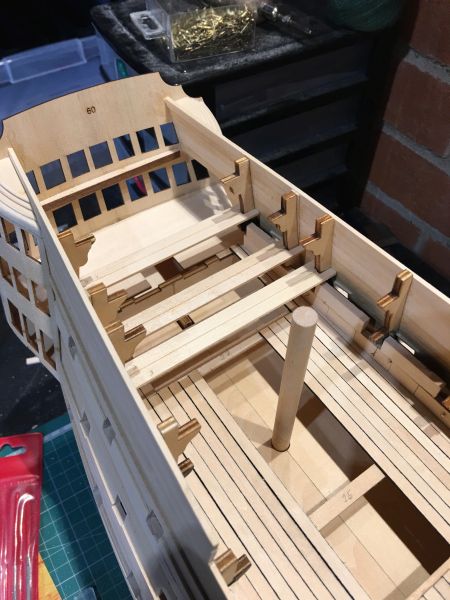

Evening activity: support pillars added to accomodate bulwarks on poop deck... poop deck fully planked, left dry overnight before sanding smooth. Cabin section now looks awesome.

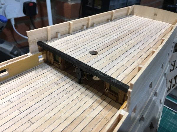

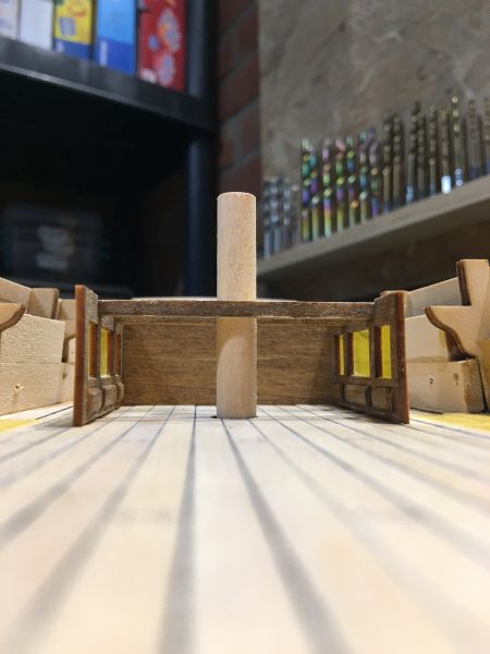

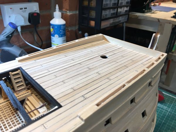

gingerale75
#96 Posted : 30 November 2017 21:35:31
Joined: 30/11/2017
Posts: 493

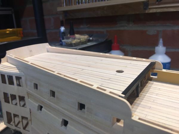

Points: 1,482
25/10/2017
poop deck sanded smooth and simulated nail heads/plank ends marked... outside of poop deck bulwarks planked up... poop deck edge strip cut, painted black and fitted... inside of poop deck bulwarks planked up... timberheads carved and painted black.
Happy building!

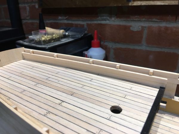

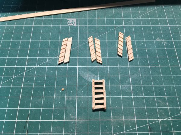

Bulwarks on poop deck cut to a declining angle, ends rounded... timberhead recess painted black, timberheads fitted.
Excess quarterdeck support beams cut off, quarterdeck opening lined... one of four companionway ladders assembled.

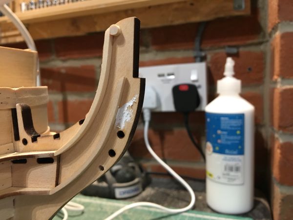

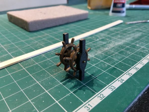

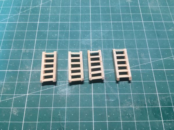

gingerale75

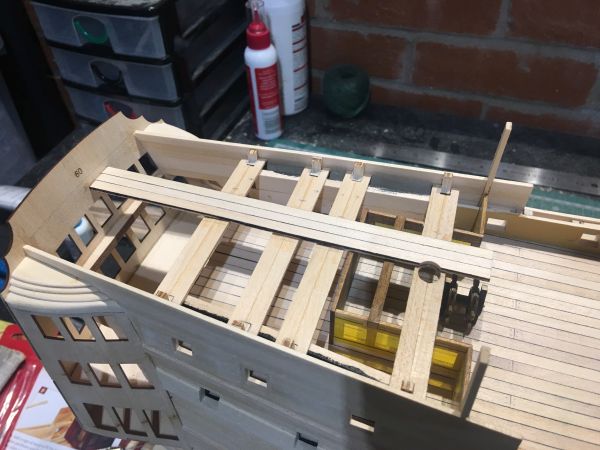

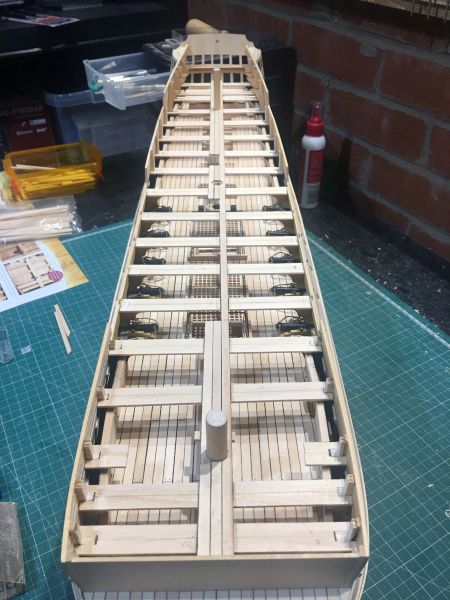

#98 Posted : 30 November 2017 21:38:49
Joined: 30/11/2017
Posts: 493
Points: 1,482

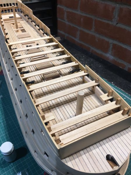

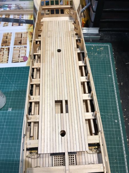

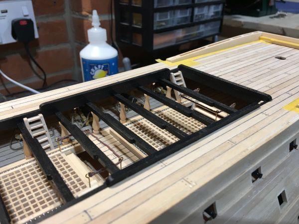

01/11/2017
all four companionway ladders assembled... pillars for skid beams fitted onto upper gun deck... I’m not sure how long I can carry on towards the winter, it starts getting freaking cold during the evenings in the unheated garage... 🤧😨🙁
Happy building!

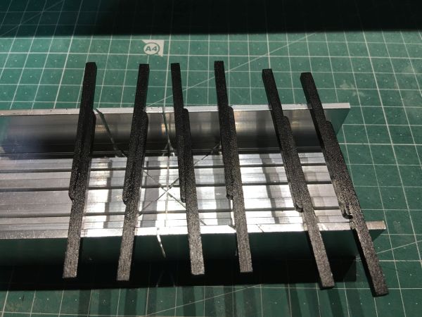

skid beams assembled and painted black.

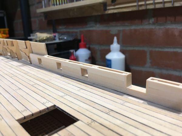

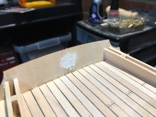

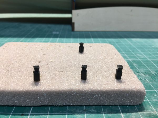

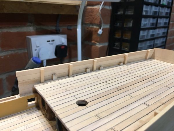

#100 Posted : 30 November 2017 21:41:24
Joined: 30/11/2017
Posts: 493
Points: 1,482

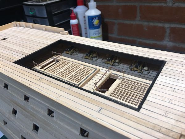

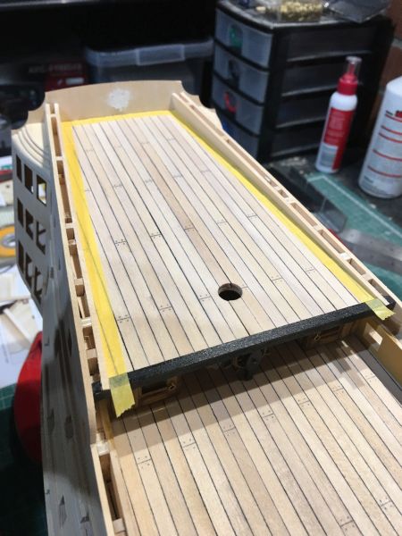

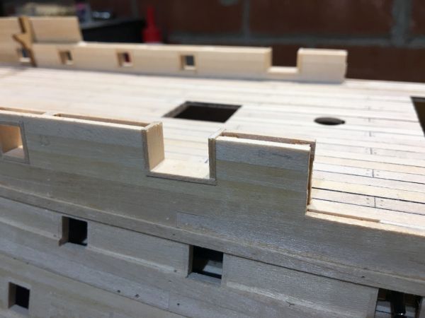

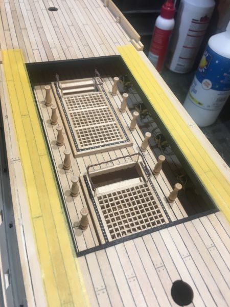

04/11/2017

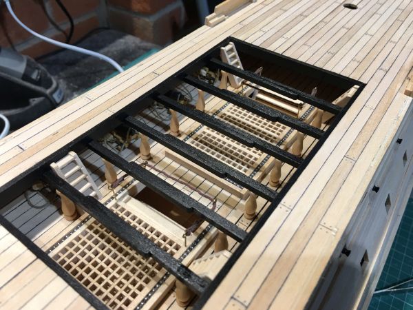

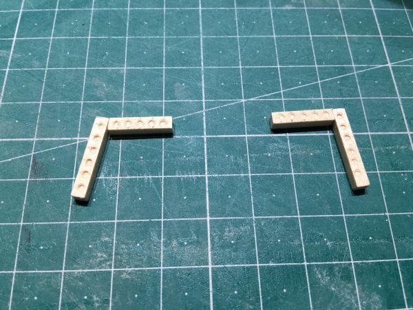

Skid beams fitted... companionway ladders fitted... inner side of bulwarks at bow built up... laser etched part numbers filled with milliput for sanding smooth.
Bow bulwarks cut and sanded smooth... front wall of the bulwark also built up inside... frames around quarterdeck opening fitted... deck edges protected with masking tape to protect it during painting the bow/poop bulwark insides. Now waiting for the milliput to dry which is insanely slow in the cold temperature... also some racks for cannon balls prepared.
That’s it for today, my hands are frozen...
Happy building!
