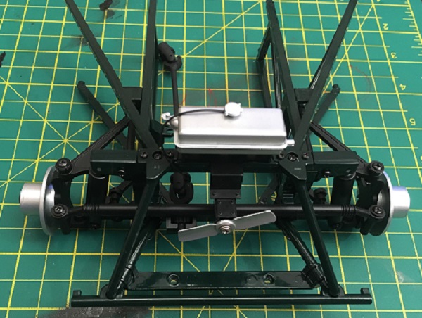

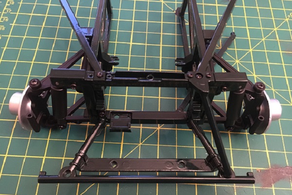

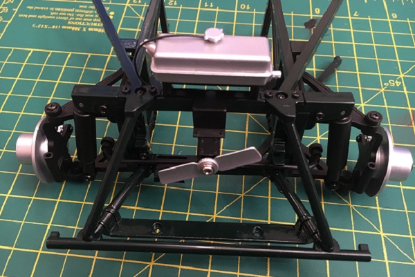

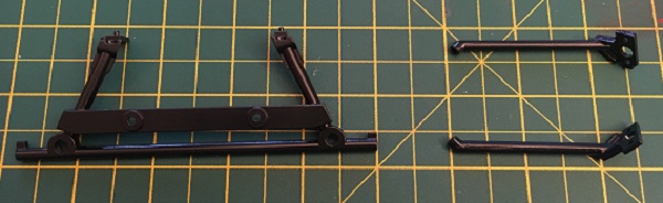

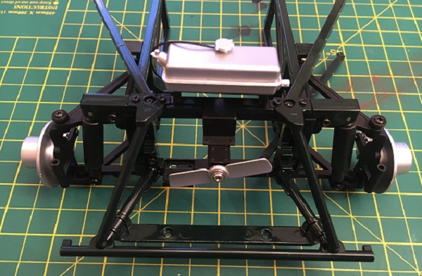

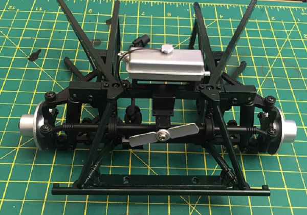

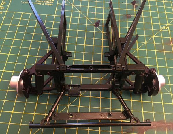

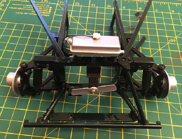

Build the Jaguar E-Type, Stage 31
Parts with Issue 31
Front subframe base
Front subframe right stay
Front subframe left stay
Line up the front subframe base with the bottom of the main frame assembly and secure with 2 screws. (Picture 2)
Secure the 2 upper braces with a screw each. Take the left stay and fit the cranked end into the hole in the subframe base. Position the other end into its recess in the top of the main assembly. Secure with 2 screws. (picture 3)
Take the fan assembly onto the top of the subframe by sliding the pin into the hole (picture 4)
Secure the right stay in the same way as the left stay. secure the cranked ends from beneath with a screw in each (picture 5)
Ian23 attached the following image(s):

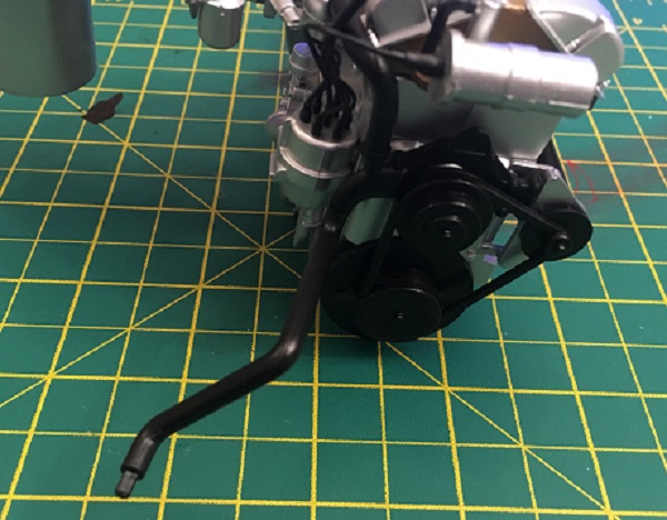

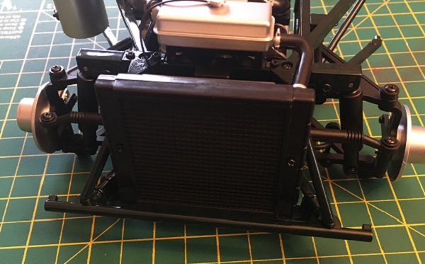

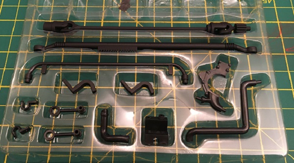

Build the Jaguar E-Type, Stage 32
Parts with Issue 32
Steering rack assembly
Steering column assembly
Anti-roll bar
Steering rack mounting
Anti-roll bar links x2
Rack mountings x2
Anti- roll bar mountings x2
Short hose
Long hose
Water pump
Take the anti-roll bar and the 2 links as secure together with a screw through each. Fit the pins on the links through the indicated holes on the bottom wishbone and secure from the front with 2 screws. Take the 2 anti-roll bar mountings and fit over the roll bar as indicated and secure each with a single screw (picture 2)
Take the steering rack mounting and push it into the matching holes in the front subframe. Take the lower right brace from issue 26 and fit it into place mirroring the left brace. Secure the brace and the mounting with a single screw. Fit a second screw into the steering rack mounting to secure in place.
Take the steering column assembly and feed it through the subframe and press the pinion gear into the steering rack mounting. Feed the steering rack assembly through the subframe messing the teeth with the gear. Position the ends of the steering rack over the steering uprights and secure each with a single screw. (picture 3)
Take the 2 rack mountings and secure each to the front of the subframe with 2 screws in each. (picture 4)

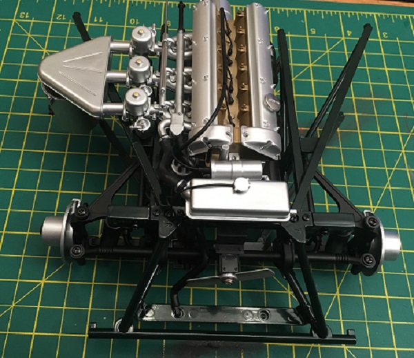

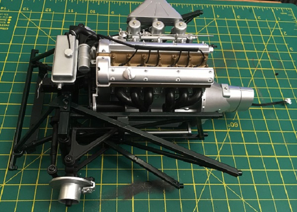

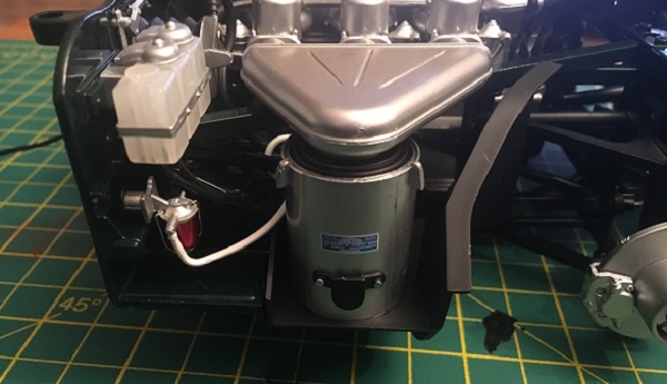

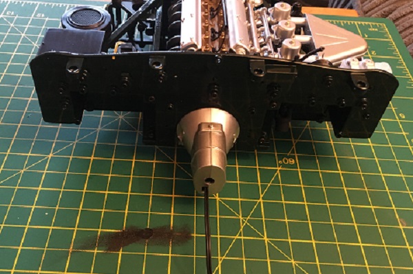

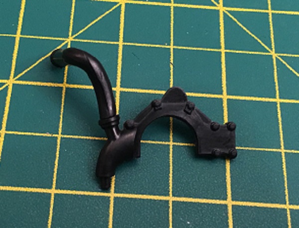

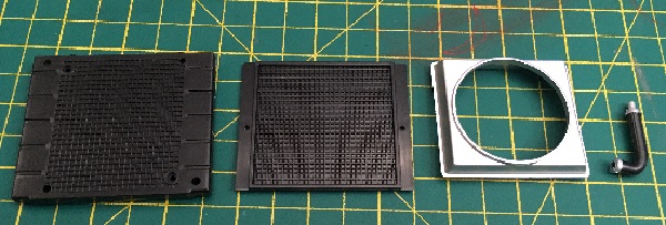

Build the Jaguar E-Type, Stage 33
Parts with Issue 33
Radiator (front section)
Radiator (back section)
Cowl
Hose
Take the water pump and short hose from issue 32 and fit together as indicated. (picture 2)
Take the longer hose onto the other pin and slip the water pump behind the engine pulley making sure the hoses are correctly positioned (picture 3)
Align the engine with the rear of the front subframe ensuring the longer hose passes through the front of the subframe below the fan and ensuring the engine mounting tabs line up with the mounting points on the subframe. secure from below with 2 screws. (picture 4)
Using a small amount of superglue stick the small hose to the engine where it touches. Take the oil filter from issue 26 and glue it with superglue to the front of the oil pump. Take the hose from issue 32 and secure it between the radiator fan tank and the engine assembly as indicated. Next take the sump assembly and fit it to the bottom of the engine over the battery compartment securing all the pins into place (picture 5)

another month done and we are now a third of the way through with the engine attached onto the subframe and the rest of the chassis ready to be built.
we now have a real chunky and heavy hunk of car and im loving it!!

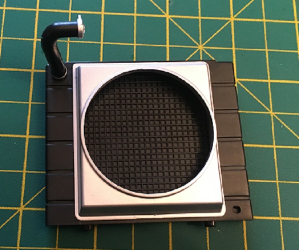

Build the Jaguar E-Type, Stage 34
Parts with Issue 34
Front Bulkhead
Take the parts supplied with issue 33. Align the cowl with the back of the radiator. It can only fit one way. Push the 2 parts together and secure from behind with 2 screws. Line the front of the radiator up with the assembly and press the parts together securing with 2 screws. (picture 2)
plug the hose into the hole in the back of the radiator positioning as shown (picture 3)
line the 2 lugs up with the matching holes in the subframe fitting the bottom hose from the water pipe into the other hole in the radiator. once the radiator is in position press the top radiator hone into the pin from the header tank. secure from beneath with 2 screws.

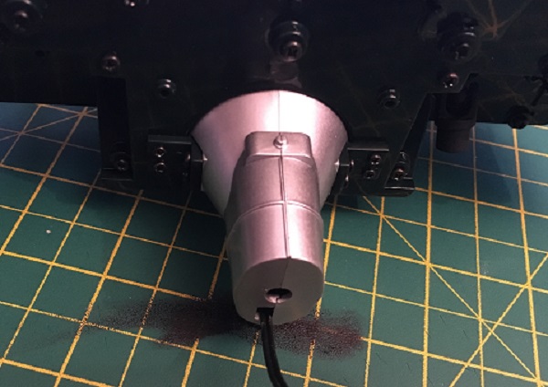

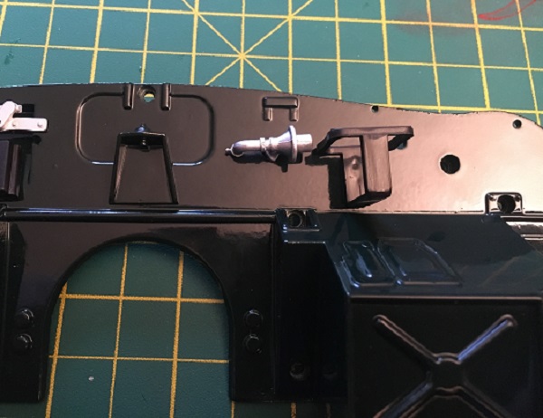

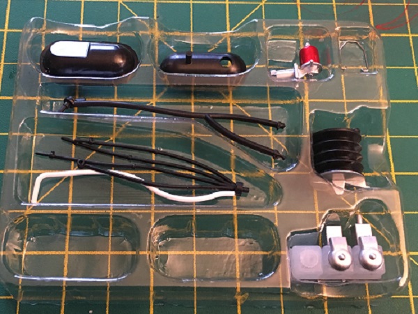

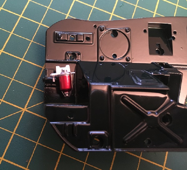

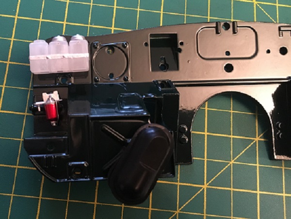

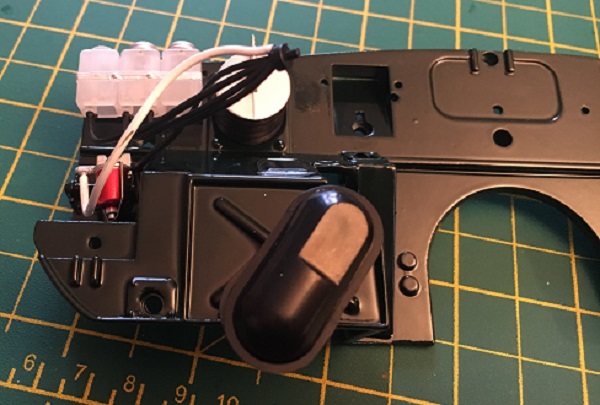

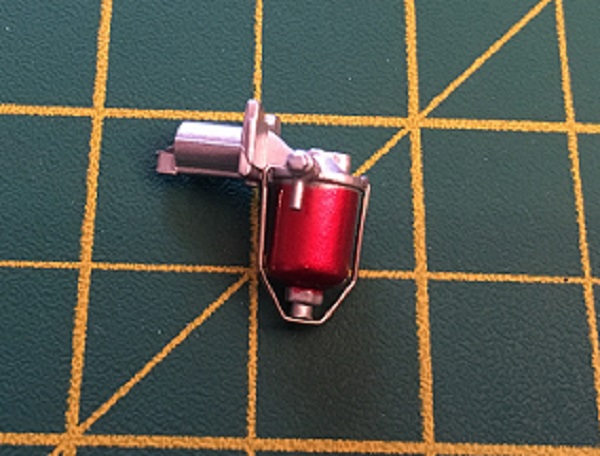

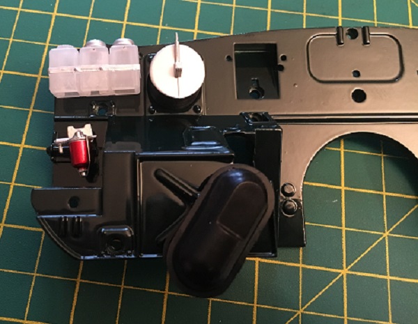

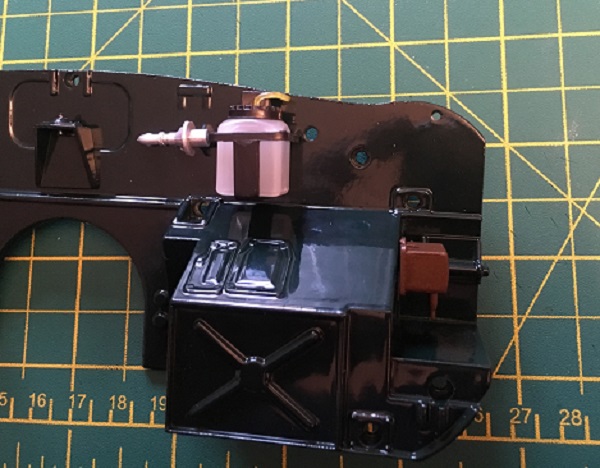

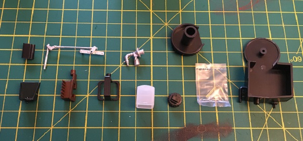

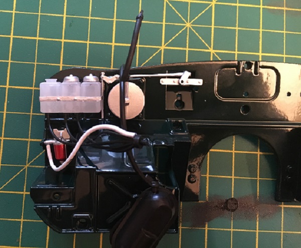

Build the Jaguar E-Type, Stage 35
Parts with Issue 35
Reservac tank
Brake servo unit
Fluid reservoirs
Fuel filter
Clip
Brake vacuum hoses
Hydraulic and fuel pumps
Take the fuel filter and clip and position the clip over the fuel filter as shown (picture 2)
secure the filter to the bulkhead from behind with a single screw (picture 3)
push the 2 halves of the Reservac tank together and position the assembly on the bulkhead as shown securing with a single screw (picture 4)
position the fluid reservoirs onto the bulkhead and secure with a single screw (picture 5)
Position the brake servo into place besides the reservoirs and secure with a single screw (picture 6)
Take the fan of 5 pipes and push them into the holes as indicated using tweezers. (picture 7)
take the brake vacuum hoses and fit the long arm into the hole in the reservac tank and the short arm onto the pin on the brake servo (picture 8)

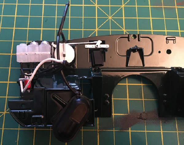

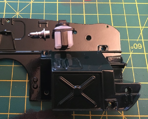

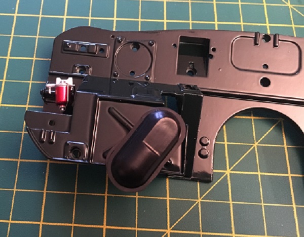

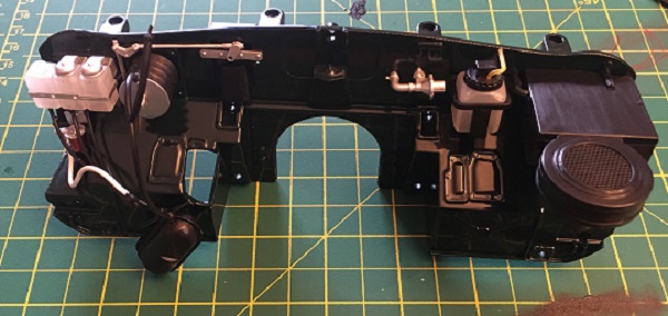

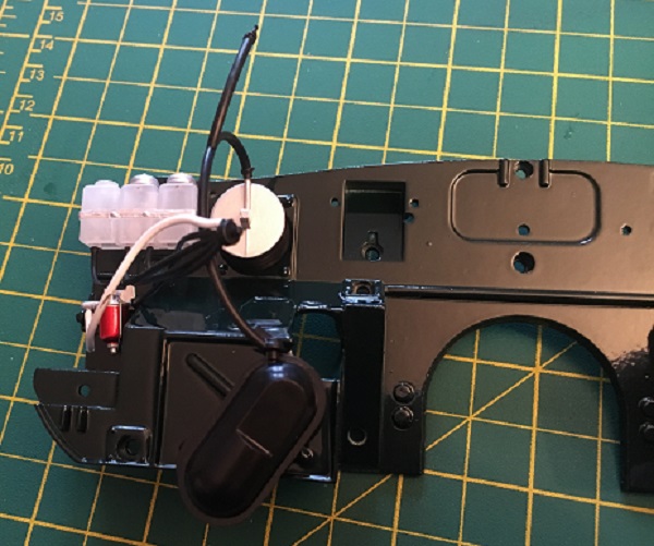

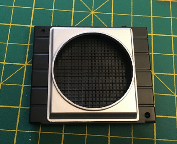

Build the Jaguar E-Type, Stage 36
Parts with Issue 36
Windscreen wiper motor
Engine stabilizer mounting
Throttle linkage
Voltage control unit
Reservoir bracket
Washer Reservoir
Washer cap
Heater water control tap
Washer tube
Heater Motor
Heather case
Align the throttle linkage with the bulkhead and push the 3 pins into place (picture 2)
align the wiper motor with the assembly and secure with a single screw. Align the 2 pins on the engine stabilizer and secure with a single screw (picture 3)
line up the water control tap and secure with a single screw. Align the reservoir bracket and secure with a single screw (picture 4)
Fit the cap to the reservoir and secure with a single screw. Push the reservoir into the bracket noting the alignment. (picture 5)
Fit the wash tube into the holes in the washer cap and the bulkhead. Fit the voltage controller and secure with a single screw (picture 6)
Line up the heater motor with the heater case and secure together with a single screw. Align the 3 pins to the holes in the bulkhead and secure with a single screw (picture 7)

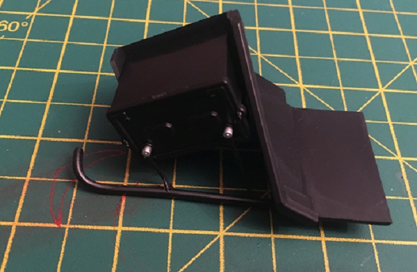

Build the Jaguar E-Type, Stage 37
Parts with Issue 37
Left hand mudshield
Right hand mudshield
Battery leads
Battery
Gearbox mountings x2
Take the completed bulkhead and the subframe/engine assembly and carefully bring the 2 parts together ensuring the mounting points meet there corresponding holes. Holding the parts together fit the throttle linkage and the water hose into the holes in the bulkhead and ensure the steering column is through its hole in the bulkhead. Secure the 2 assemblies together with 8 screws. (picture 1)
Take the gear box mountings and position them into the recesses at the back of the gear box. Screw them into the gear box first with 2 screws each. Attack the mountings to the bulkhead with another 2 screws each (picture 2)

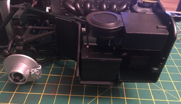

New month brings new parts and unfortunately another dreaded wheel...

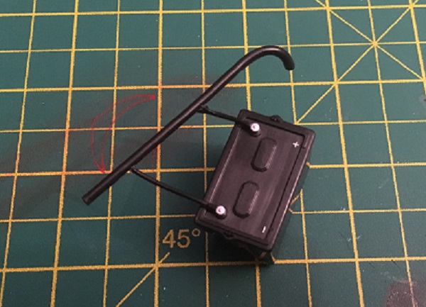

Build the Jaguar E-Type, Stage 38
Parts with Issue 38
Wheel Rim (outer)
Inner spokes x24
Take the battery and the battery leads provided in the previous stage. Push the 2 connectors into the holes on the top of the battery (picture 2)
Secure the battery to the left hand mudshield with a single screw (picture 3)
Slide the assembly into the subframe under the heater motor and secure with 2 screws. Ensure that the end of the battery lead is in position in the notch on the voltage regulator unit (picture 4)
Take the end of the cluster of wires from stage 35 and plug it into the hole on the subframe behind the air filter, Take the remaining vacuum hose and plug it into the hole in the end of the air balance pipe.
Next take the right mudshield and and fit it under the air filter securing it to the bottom with a single screw and to the bulkhead with a single screw. (picture 5)

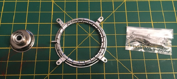

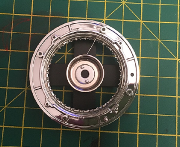

Location: Worcester, UK

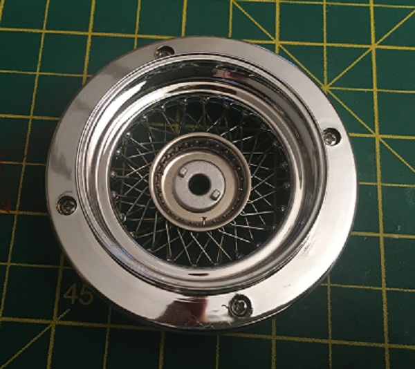

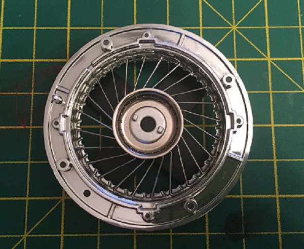

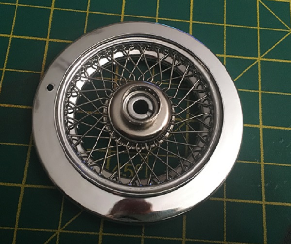

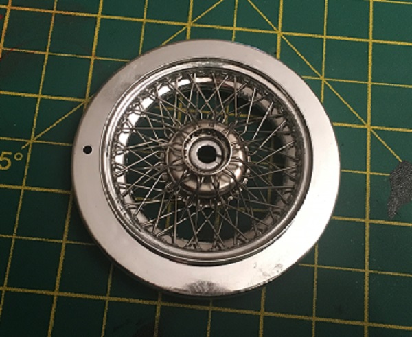

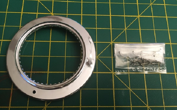

Build the Jaguar E-Type, Stage 39
Parts with Issue 39
Wheel centre
Inner spokes x24
Spoke retainer ring
First take the wheel centre and fit it onto the building jig making sure the slot and tab engage. Then fit the outer wheel rim onto the jig making sure the hole in the rim engages with the post on the jig.
Next cut some double sided tape and work it into the groove around the rim. Now you start fitting the spokes. they can old go in one way as they have a pin head at one end. Starting with the lower row of holes feed the spokes through until it reaches the grove on the outer rim. The length and angle of the spoke means it will only fit into one of the grooves (Picture 2)
Continue with the bottom row of holes until you have all 24 fitted and facing the same direction (Picture 3)
now take another spoke and feed it through one of the upper row of holes ensuring it is angled the opposite way to the lower set of spokes. Carry on adding spokes to the upper holes until all 24 remaining spokes are in place. Take the retaining ring and place it over the rim. It has several notches and posts on it the mean it will only fit one way. Be very careful that you don't dislodge any of the spokes. Screw the retaining ring down with 4 screws and remove it from the jig with a sigh of relief (Picture 4)
Building: Deagostini R2D2, Eaglemoss Delorean, Deagostini E-Type
Built: Deagostini Millennium Falcon

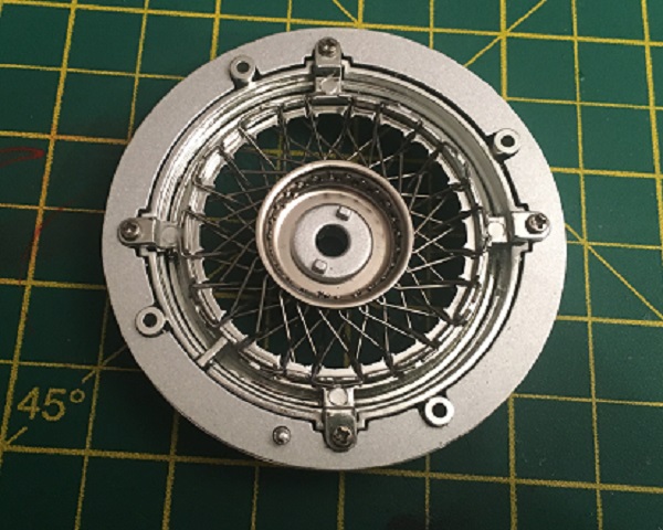

Ian23
#100 Posted : 07 January 2018 15:40:16
Joined: 15/03/2017
Posts: 91
Points: 276

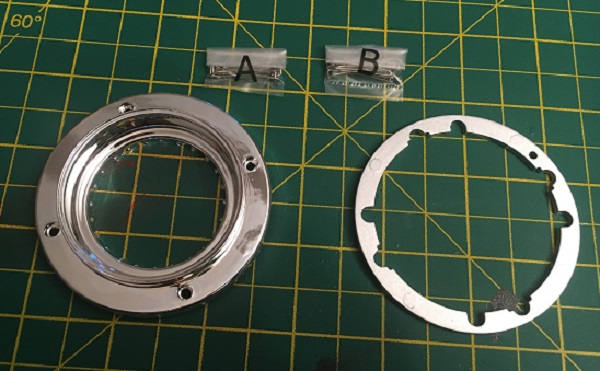

Build the Jaguar E-Type, Stage 40
Parts with issue 40
Outer Spokes (Type A) x12
Outer Spokes (Type B) x12
Wheel rim (inner)
Spacer Ring
Take the Assembly from issue 39. The instructions say to use more double sided tape, which I did use, but in the end I got so fed up with them still falling out I broke out the superglue.
Take one of the spokes from the packet labeled A and fit it through one of the lower holes in the wheel centre. Feed it through the V made by the closest pair of inner spokes. Spokes from packet A go in the lower holes and spokes from packet B go in the upper holes. (picture 2)
Once this has been done with all the spokes, Take the spacer ring and place it onto the assembly aligning the hole and the post to ensure it fits the right way round. (picture 3)
Then take the inner rim and place it onto the assembly again aligning the hole and post to ensure its the right way round. Secure this with 4 screws (Picture 4)
