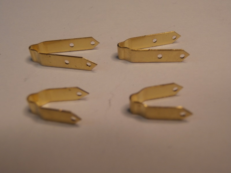

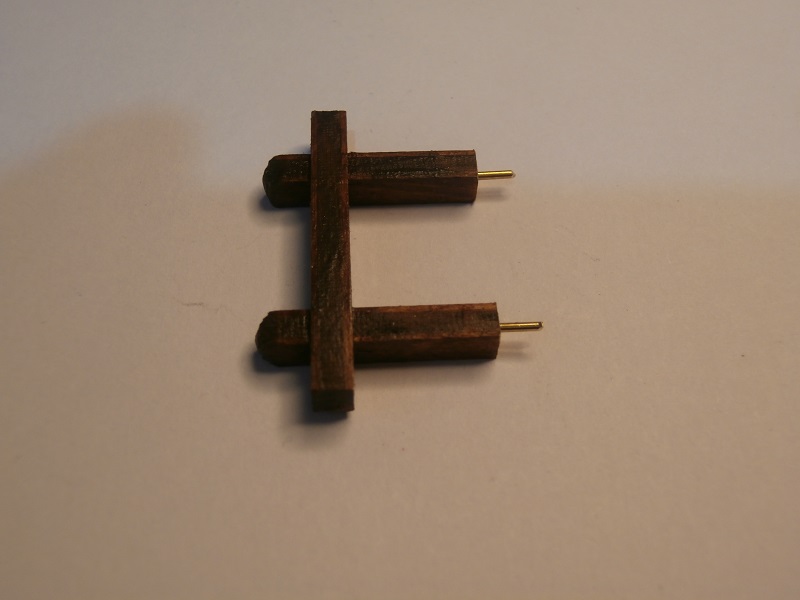

Just a short update. Pic 1 shows a rudder hinge as received (out of focus I’m afraid). The hinges were cut down to two 2 hole lower hinge halves and two 1 hole upper hinge halves, Pic 2. Hinge pins were glued to one half of each hinge, Pic 3. and these halves were then fitted to the rudder, Pic 4. The rudder was then fitted to the hull and the tiller arm fitted to it.

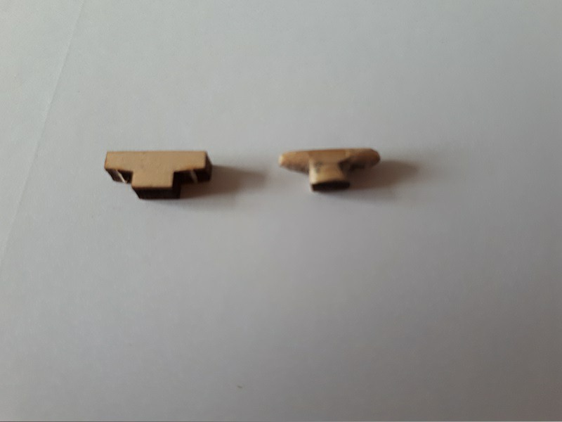

The anchor castings were filed to remove any mold lines and a brass wire brush on a rotary tool was used to remove any oxidation. They were then cleaned with alcohol prior to painting, Pic 5. The anchors were assembled and the anchor rings fitted. Pic 6 shows the completed pin rail and anchors.

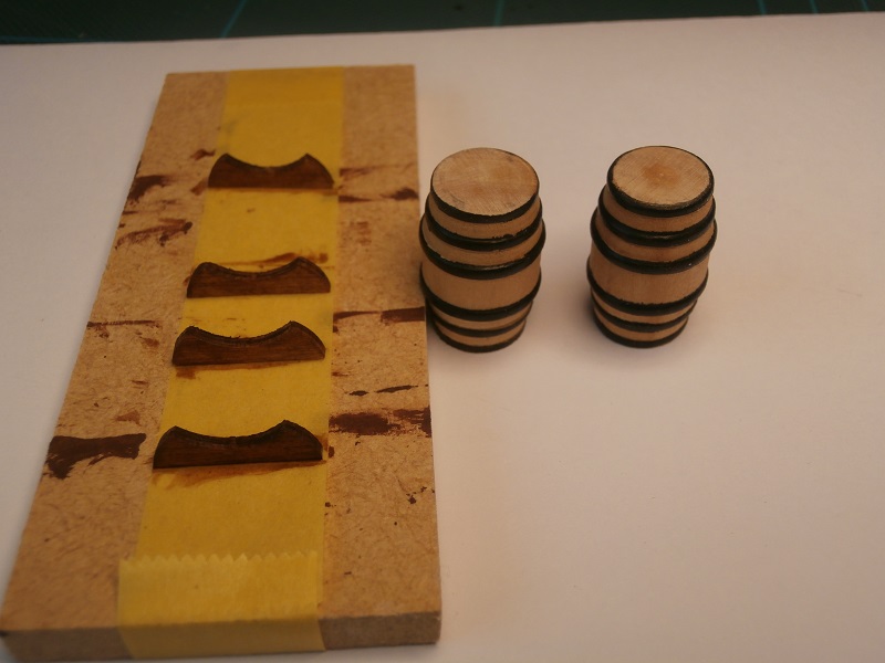

The next job was to prepare the barrels and pails. These were masked using Tamiya masking tape, pic 7, and the hoops painted black. On removing the tape there was a little bit of bleed but on the whole the finish was pretty good, better than I could of achieved freehand. The stands for the barrels were stained walnut. Pic 8 shows the stained stands and painted barrels. The barrel plugs were fashioned from the ends of a stained toothpick.
The pails were painted in the same way as the barrels and handles formed from rigging thread. Pic 9 shows the completed barrels and pails.

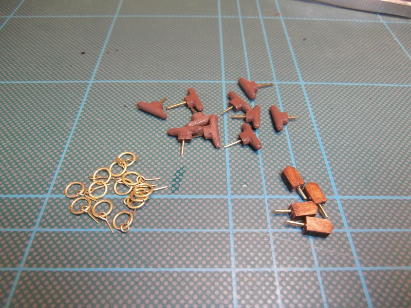

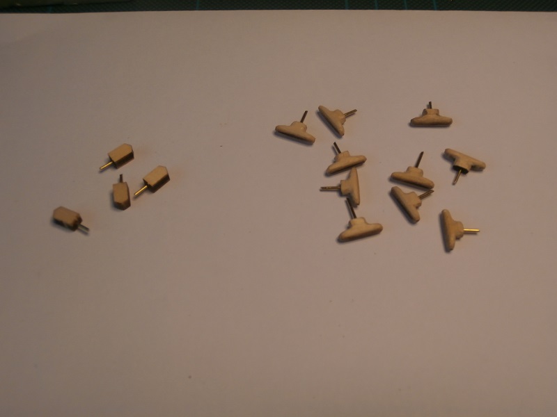

It was now time to start on the deck fitting (cleats, eyebolts etc.). The cleats were removed from the fret and the edges sanded to shape. Pic 1 shows as removed from fret on the left and after sanding on the right. I drilled the bottom of each cleat and a piece of brass wire was glued into it (a planking pin with its head removed could also be used). This was done to both facilitate holding the cleats whilst painting and to provided more secure fixing to the deck etc.. The same was done to the 4 tie down posts, Pic 2.
All the parts were then held in clamps and the cleats painted and the posts stained as per the instructions, Pic 3. Rings were then added to eyebolts and Pic 4 shows all the finished parts. Location holes were then drilled in the various locations around the deck and the various pieces were glued in place, Pic 5.

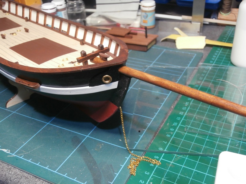

The next job was to start on the bowsprit. This was made from a piece of dowel and the instructions explain how to taper the dowel by hand to make the correct shape. As I have a very modest lathe (hoping to upgrade shortly) I actually used it the taper the bowsprit, Pic 6. Once the correct taper was formed the tip was removed and the bowsprit cut to length.
The pin rail, made last time, was then fitted to the deck. The end of each post was drilled and a short length of brass rod was cut to just protrude from the post end (again a pin cut to the correct length could be used). This was then filed to a point, Pic 7. The correct position for the pin rail was measured from the 1:1 drawing and this was transferred to the deck. The pin rail was then pushed down onto the deck so the pins would mark the planks. The two positions were then drilled to take the rods, Pic.8. The sharpened rods were then removed from the rail, replaced with slightly longer ones, Pic 9, and the pin rail glued in place.
The bowsprit stained and once dry was pushed into position so it sat under the centre of the pin rail and a hole drilled down through the centre of the rail and into the dowel and a pin glued in place to secure the bowsprit. A cleat was added to the top of the bowsprit half way between the pin rail and prow. An eyebolt was fixed to the stem at the level of the waterline and a length of chain fixed to it.
Pic 10 shows the bow at this point in the construction.
