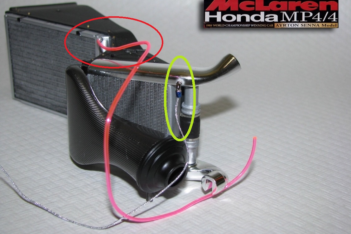

Hi Maurizio, i ask you some details about your (awesome) build
I read whole topic to find spec for extra coolant hoses.
When i can get violet hose and braided hose with the plug end? (in the red and green circles)
maurizio67
#89 Posted : 05 April 2017 06:40:51
Joined: 27/09/2016
Posts: 328
Points: 1,047
So larger radiator:
Tapping 0.8 and then switch to a tip 2 mm, fitting insertion aluminum DMADM3094 Combination fitting 4 1.88mm taken from model fitting and baracca.Il 'hex the round hole and then to fill the space that had been created I used the liquid vinyl positioned with the toothpick in order to make uniform and devoid of spaces drilling, once I dried the vinyl I painted with aluminum above the vinyl "always with the toothpick" then I cut about 1.5 mm tube silicone and positioned above the painted vinyl so as to simulate a gasket.
For the small radiator I drilled with a 0.8 mm bit 'attention to the chrome if escapes the tip goodbye ... "and then enter the chrome siding, but now I have seen that there are more but these are of hiroboy; 1:12 Hose Joint Set B - P1119
for the braid tube or modeling cabin or always hiroboy

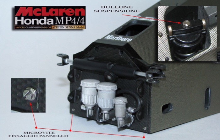

#98 Posted : 30 April 2017 22:19:19
Nice work on those brake reservoirs, they look suitably dirty.
