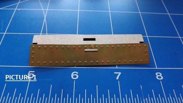

PICTURE 1
This is the rear buffer rail for the locomotive. This part requires an etched overlay to be glued in place. Again with some of the other etch parts this has a real strong “spring” to it. To ensure it glues into place with no problems in the future it was annealed as I have described in earlier entries. This removes “spring” from the part ensuring when glued in place that is where it will stay.
PICTURE 2
I have used “Timebond” again for these etch to wood joins. Joining 2 dissimilar surfaces means applying the glue to the least porous surface so in this case the back of the brass piece.
To get the best even pressure when clamping up the parts it’s an idea to use some folded paper towelling as this allows the clamping pressure to press onto the whole part. Without the paper towel padding you would just be applying the pressure to the raised rivet detail and that could mean some of the brass does not get glued down firmly enough.

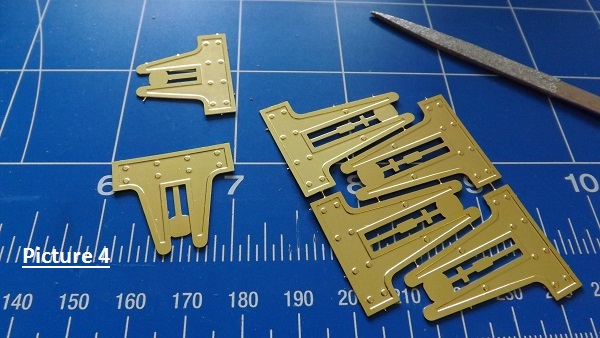

These are the etched overlays that will be fitted to the “front” of the side rails. To save yourself a little time try and remove the parts from the etched fret as close as possible to the part.
A quick rub over with a small file removes any remaining traces of the connecting burrs.

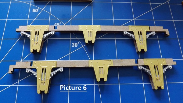

PICTURE 6
And once these 5 etched parts (3 per side) this is how the side rails look.

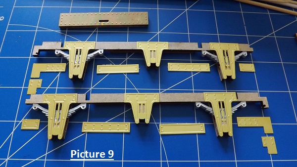

PICTURE 9
Here we can see the rest of the etched sections that complete each of the side rails.
What is interesting to note here is that in the early kit each of these etched elements was supplied as a white metal casting and once in place would have made the side rails far too heavy to remain glued to the locomotive for very long.

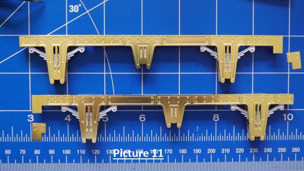

PICTURE 11
And once all of the etched parts have been glued in place and allowed sufficient time to dry this is what the side rails now look like.
There are 2 small etch sections still to be added to the ends of the rails and for these 2 parts I will use a cyno based adhesive. Something like a “SLOW ZAP” adhesive will allow sufficient time to align the parts before they bond tight.

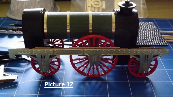

PICTURE 12
At this point none of the sections are glued together as I still need to work on the valve gear that fits under the Loco. I have primed these parts and next weekend will be breaking out the airbrush to get them painted and installed.
From this picture though you can see what the side rails are supposed to look like when in place and hopefully from this image you can see why having those side rail slots correctly cut is important.

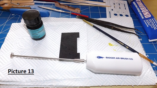

And the very last task I tried out this week was to have a go at dry brushing the footplate to try and highlight the tread plate pattern.
The footplate was painted with Satin Black and I thought possible the Metal Black from one of my Caldercraft paint sets might provide enough of a contrast between the parts but it does not appear to have done so.
Do not really want to add any strong contrast between the colours so will have a look at this section as the build progresses.
“OBSERVATION”
If you are using a battery powered paint stirrer always make sure you turn it off before removing it from the paint jar LOL . I had one of these years ago (and it’s probable still hiding some place. That had a press and hold switch were as this one has a slide on/stay on switch. I will leave you to guess what happened Blushing

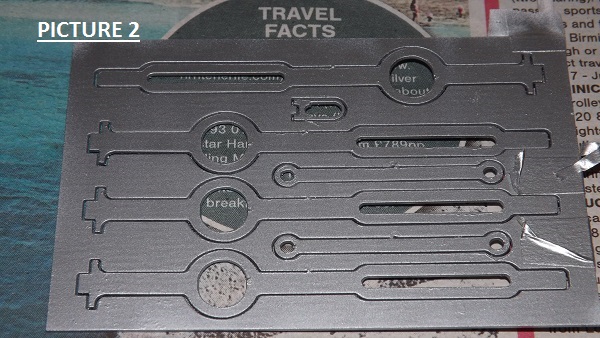

PICTURE 1
There are a few parts this week that I felt were better being spray painted rather than hand brushing.
For the Steel colour I have used Vallejo “71065 Steel” from their Model Air range with comes already pre-thinned for spraying. It’s a water based paint so clean up is nice and easy with no need for “whiffy” chemical smells. The only slight downside is that it takes longer to dry in this damp weather.
My choice of airbrush for this one was my Sotar 20/20 and for no other reason that this one has a nice small paint cup which was ideal for this limited amount of painting.
PICTURE 2
These parts will form part of the engines valve gear and are laser cut from a sheet of fairly thick metal. The parts are only held in place by one tab so I decided it was easier to paint these parts while still on the fret.
The picture you see here is after the coat of steel colour has been applied.

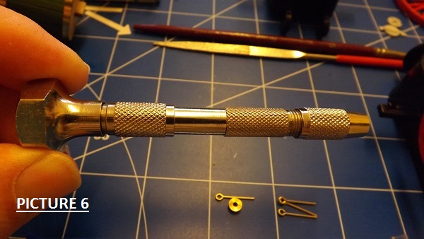

PICTURE 5 & 6
While the etched overlays have the majority of the holes pre-made the same does not apply to the base MDF parts. Therefore, you will need to deepen the holes ready for the shaped brass parts you are making.
A small pack of the drill bits you can see in Picture 5 are ideal and cheaply available from a whole host of retailers. That along with a pin vice makes the task nice and easy.
PICTURE 7
Very carefully drill through the guide holes in the etched overlays and through the MDF surfaces underneath.

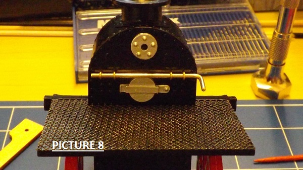

Here we can see the firebox door, a control lever base as well as one of the shaped brass parts fitted in place.
As with earlier brass work were the part remains un-painted I have cleaned the brass using Rustin’s brand metal polish and then coated in Rustin’s Metal Lacquer to ensure the part remains nice and shiny without tarnishing over time.

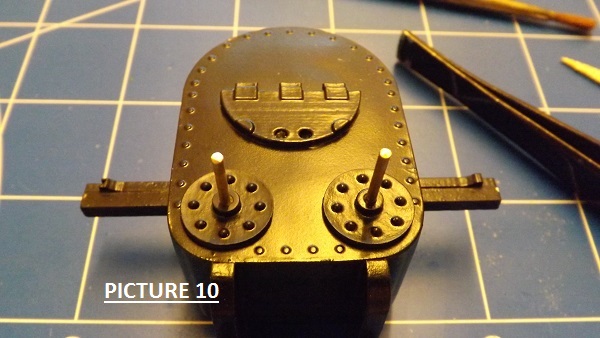

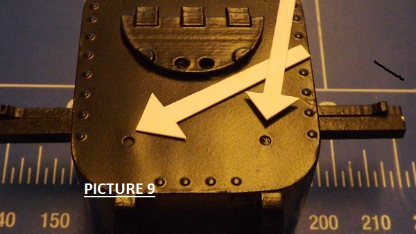

Moving onto the front of the smokebox we have to glue in place the 2 cylinder ends. You need to ensure these are correctly aligned. So what I have done here is to use a couple of scrap lengths of brass rod to ensure they are glued correctly in place.
Later on these brass parts will be removed and some shaped brass parts will be fitted in place.

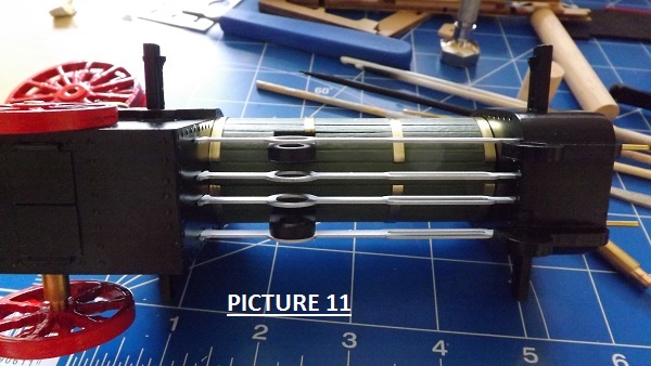

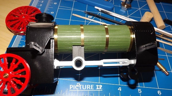

PICTURE 11, 12, 13
“CALLOUT -PROCEED WITH CARE”
This is the time that we finally glue the firebox and smokebox end to the boiler itself. As well as joining these sections we also need to fit in place the 4 “steel” bar sections that will support the valve gear itself.
This is one of those occasions that an extra set of hands would help because you need to joggle the 4 bars into the preformed slots in both the front and back ends of the loco.
Elastic bands provide clamping pressure to ensure its all held nice and tight until dry.
“RECOMMENDATION”
Its probable worth mentioning at this point that in my kit there is some very slight movement in the joints between boiler and firebox end and boiler and smokebox end. This will allow for minor twisting of the parts and if not spotted and corrected you will find that the wheels do not all touch the surface.
Therefore, I would suggest you put the wheels back in place and just ensure everything touches the ground before these glued parts fully dry.

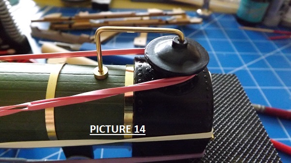

Here we can see another of the brass parts that you are asked to make form the brass rod in the kit. Again I have used the brass rod I purchased.
“OBSERVATION”
The kit would have you use 1mm dia rod for this pipe but both the hole in the ferrule that goes onto the boiler top and well as the cast part on the firebox top are pre-drilled to 1.5mm so in this case I went with 1.5mm brass rod rather than the recommended 1mm rod.

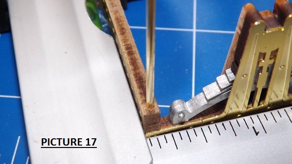

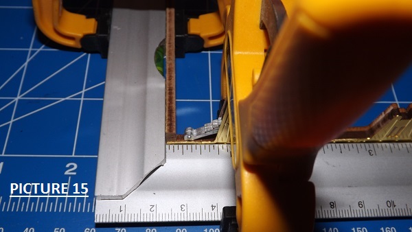

At this point its time to start gluing up the “skirt” that fits around the loco. I am gluing up each corner in turn and clamping the parts against a square to ensure they dry at a nice right angle.
PICTURE 16

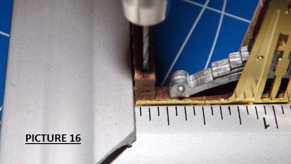

The gluing surfaces on these corners are not that big so on the basis this part will undergo a lot of handling, both for paint preparation and fitting I have decided to reinforce the corners with some 1.5mm brass rod.
Here we can see the hole being started off using one of the smaller drill bits from which we will work up to the 1.5mm drill bit. It pays to take very special care when drilling these corners as there is not a great deal of wood to work with. Also being MDF if you go straight in with the largest drill bit there is a chance of splitting open the part and if you do that it’s going to cause you some major problems.
PICTURE 17 & 18
Having enlarged the hole to 1.5mm I have superglued in the brass rod. This in turn gets cut off and finally filed down to give a nice even surface.
These reinforcements should allow the framework to be handled without the risk of it all falling apart.
