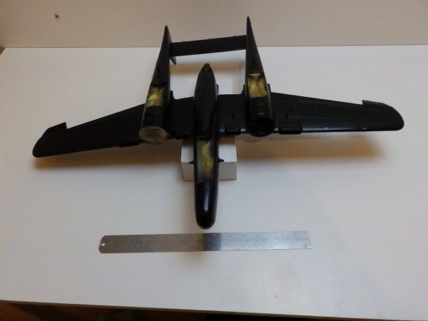

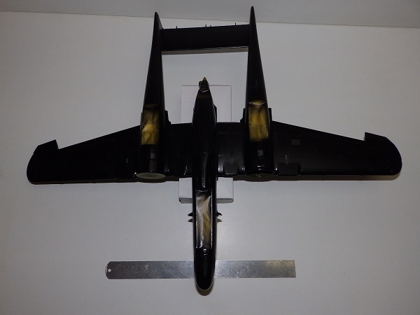

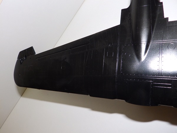

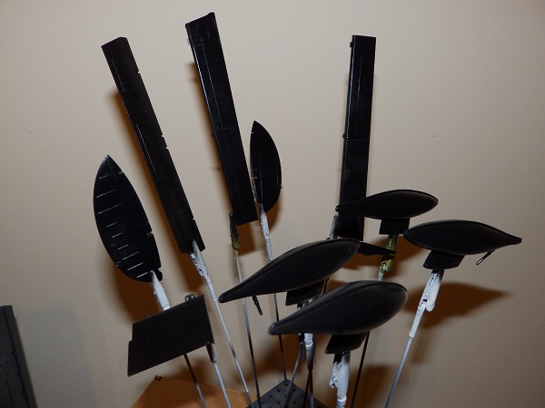

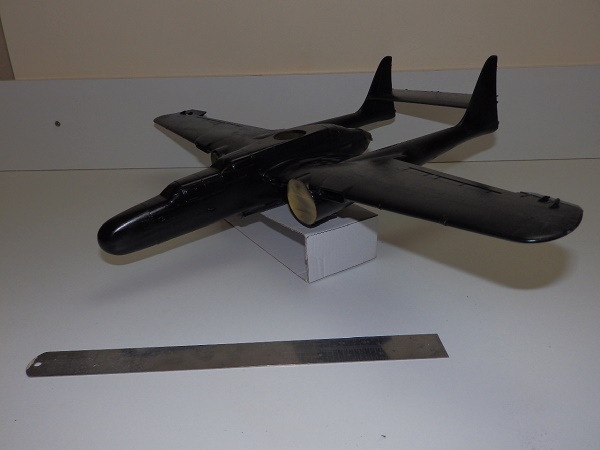

I have started painting with Alclads Black Gloss Base and as a side note you may find this interesting.
During my research for this aircraft I noticed that many pictures that survive of the aircraft seemed to have a semi gloss finish to them and I finally found out why. When the P61 was first introduced they were painted in either a matt olive drab on the upper surfaces with matt black undersides or completely matt black.
Three P61's were prepared for an experiment with searchlights the first was finished in the olive drab paint ,the second in matt black and the last one in a gloss black. It was found that both aircraft with the matt finished could be easily spotted and held in the searchlight beams but the aircraft with the gloss black finish disappeared in the searchlight beams. All P61's after that were finished in a gloss or semi-gloss black paint.
Being a gloss undercoat you can get an idea of what the finished aircraft will look like but for now this is how she looks in undercoat. also you can see how the panel lines/rivets have popped.
More soon
#82 Posted : 30 November 2016 21:43:26
Now we are getting an idea of what the final look will be. Very nice base coat finish that will carry through to the top coat. Superb work as always Andy, this is going to be a stunner!BigGrin
#83 Posted : 30 November 2016 22:10:27
Interesting detail on the paint finishes Andy. Would never have thought about that but now you have explained it i can see how it would work with the light shining back from a glossy surface - very interesting indeed.
#84 Posted : 01 December 2016 12:09:37
Great job on the undercoat, it has brought out the detail nicely.
#85 Posted : 01 December 2016 17:14:05
Lovely finish and certainly brings out the panel details Cool

#86 Posted : 01 December 2016 17:18:38
Joined: 19/05/2015
Posts: 1,419
Points: 4,272
Location: Darmstadt, Germany
I would have guessed the exact opposite to happen, but then again I never was good in optics.
#87 Posted : 01 December 2016 17:30:01
Hi looking superb Andy cheers mick. BigGrin
#88 Posted : 01 December 2016 17:38:48
Looks fine, that Alclad base is good.
Cool Cool Cool
#89 Posted : 01 December 2016 19:55:41
That really looks great can`t wait for the finishDrool Drool Love Love Phil

looks great Andy.Which paint did you use?
#92 Posted : 02 December 2016 22:13:11
BigGrin Hi Carl read post #81 it gives all the paint info thereCool

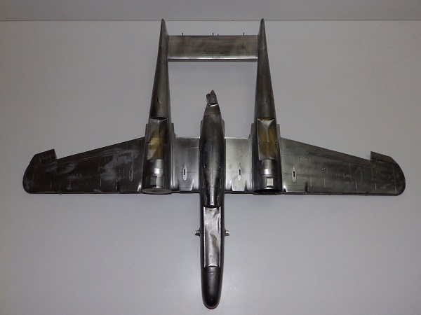

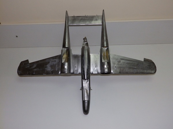

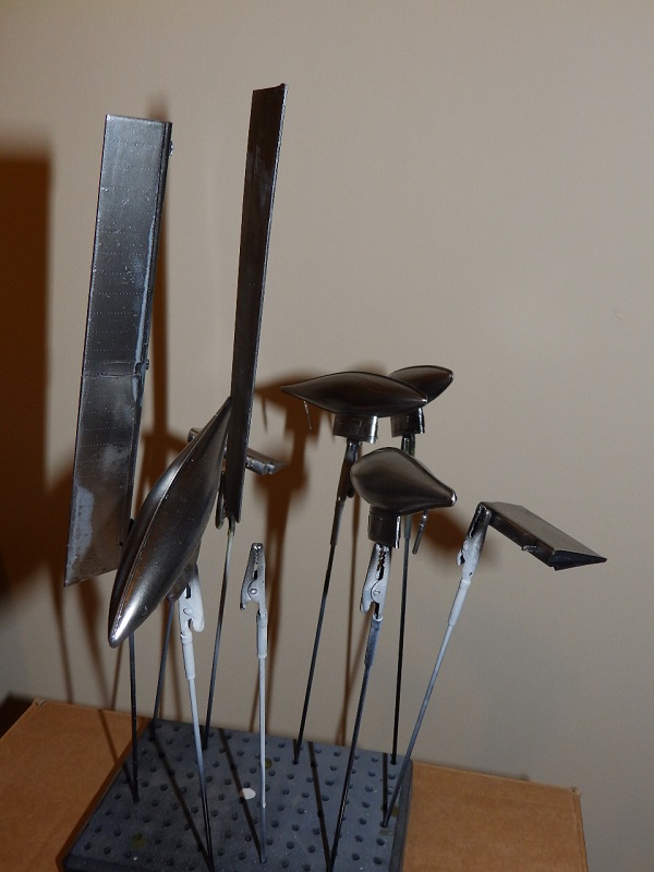

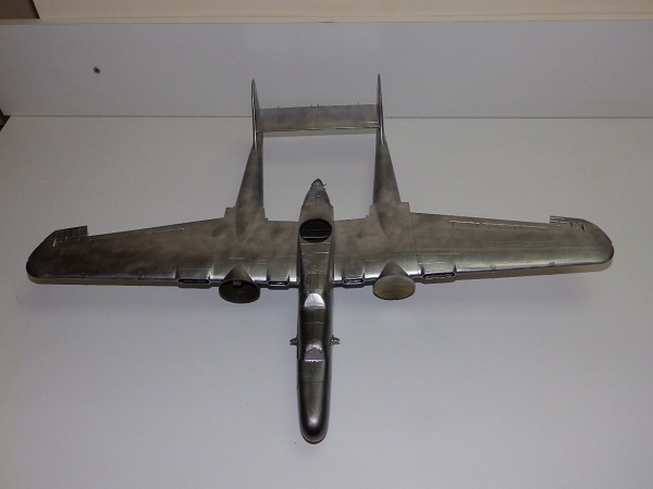

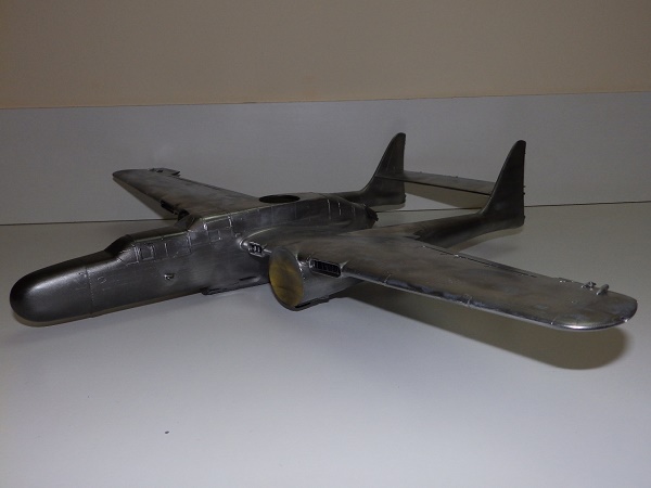

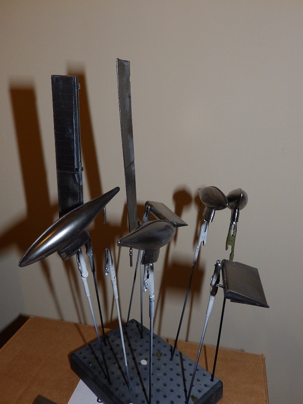

BigGrin Hi All
More paint in the form of Alclads Aircraft Aluminium has been added although the pics make it look patchy in normal light its a nice overall covering. The engines have been started and im making them up into sub assembly's to aid in the painting of them.
The last picture is of a P61 being rearmed but your probably wondering why go to the trouble of Alclad just to paint over it. In the picture look at the wing leading edge its chipped and has lost lots of paint, this was common on Pacific aircraft at the time the reason why was a lot of runways were made from crushed coral.
On take off and landing the dust and debris thrown up was like sand paper that would chip/wear away the paint on many surfaces of the aircraft. so some serious chipping in places is in order.
More soon

#94 Posted : 03 December 2016 19:51:36
Superb update Andy, the paint job is going to look really cool! What technique are you going to use for the chipping effect?BigGrin
#95 Posted : 04 December 2016 00:11:58
BigGrin Hi Nem
Thanks for looking in.I will probably use chipping medium to get the effects needed for the weathering did you also notice the chipping on the rear fin and the balloon chipping on the central rear stabilizer a typical sign of debris hitting this part of the aircraft from prop wash.

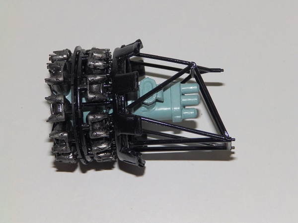

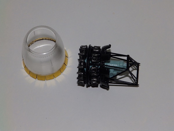

#97 Posted : 04 December 2016 20:18:10

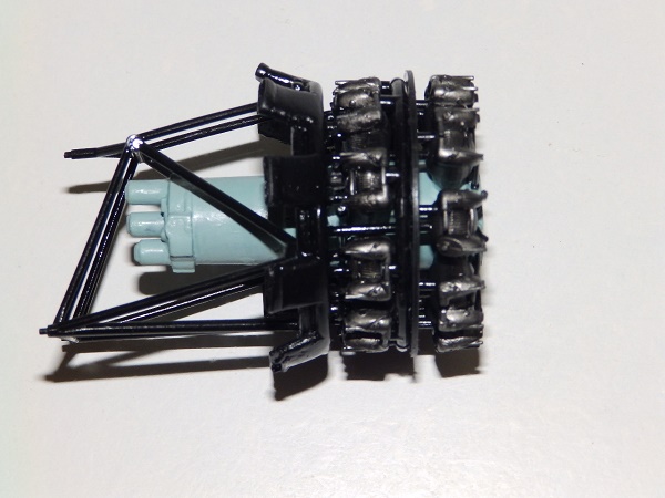

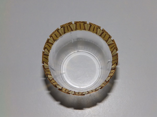

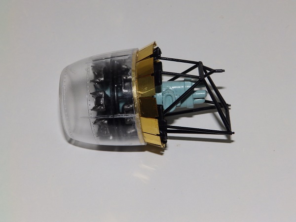

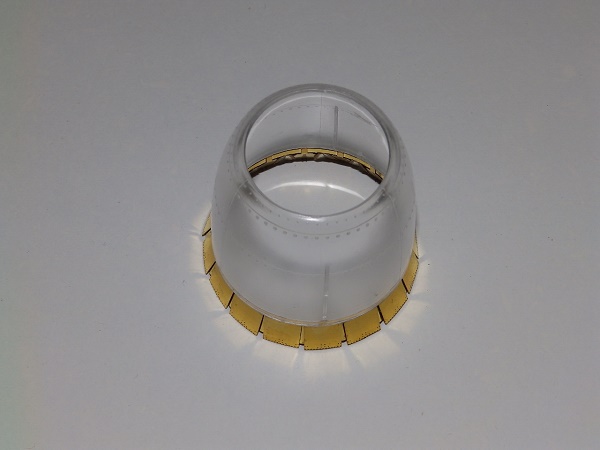

BigGrin hI aLL
Started to assemble one of the engines after painting there is still some etch to add to the cylinder heads and the ignition loom at the front end. I also made up one of the etch cooling gills for the cowl which has improved the cowl no end.
More soon.
#98 Posted : 04 December 2016 23:47:41
Beautiful job with the paintwork Andy, I've always found it hard to get a good picture with metallics

#100 Posted : 05 December 2016 20:42:08
BigGrin Thanks for looking in and your comments everyone.
I have simple washed all the plastic parts in soapy water and have had no trouble with the adhesion of paint on the clear parts.
The etch parts are cleaned using an ultrasonic cleaner before use.
Although I have used Alclads Black base undercoat which is a spirit based paint and not water based.
I hand paint aswell as use an airbrush as and when necessary on parts I favour Iwata Airbrushes and have several.Cool
