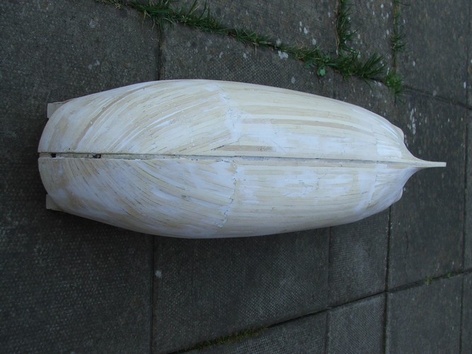

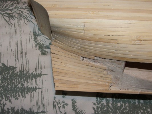

Hi All And Thanks For Looking In
Planking Update
As mentioned before, I first removed all the rear planks from keel up to their limit on the sternpost. 13 in total and to be clear that's the same number that will need to be fitted midships to fully enclose the hull.
With the hull inverted I measured the smallest gap between the remaining planks and keel. Then using a planking fan I was able to determine how much to taper the planks at this point.
Next I just have to allow the planks to taper back to their full 5mm depth in their run forward and so fully enclose the hull with it's first layer.
Ultimately I want to paint the lower hull and I'm not sure any of this will even show. LOL LOL LOL

Thanks Alan for your kind comments. As to your following along and support I'm rather counting on it. BigGrin
I am still following everyone's builds, learning as much as I can and love what everyone is doing.
I realise my workmanship isn't anything like that of you guys here but needed to try this in order to understand the problem. No better time to try than on the first layer.Blink
I wont get build pack 3 until the end of Feb so it will be March sometime before the lower hull is fully planked and I can post pictures of my results.
Just wish sometimes the guys who built the real ships where around so I could ask "How the heck did you do that"
Perhaps on completion of the first layer I should do a round up of what I've learned in case another fool wishes to try.LOL LOL

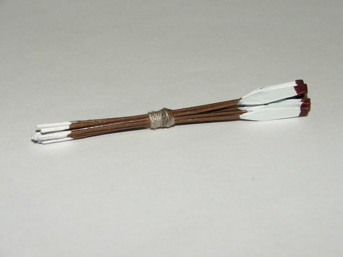

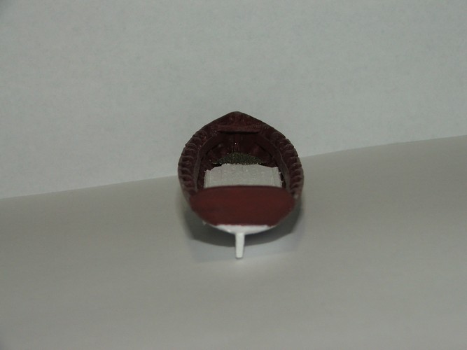

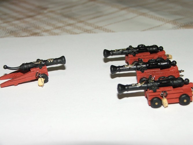

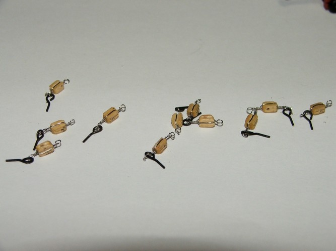

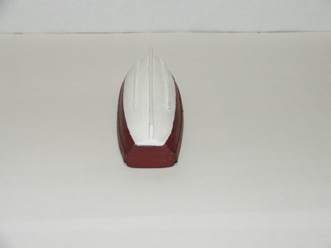

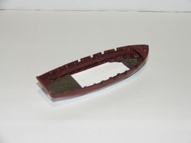

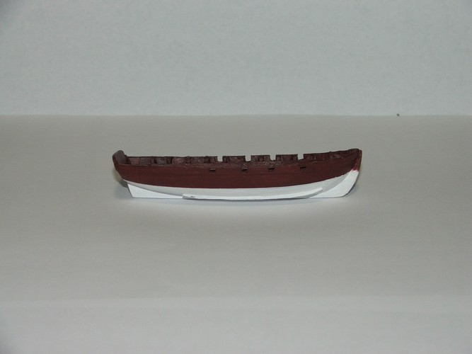

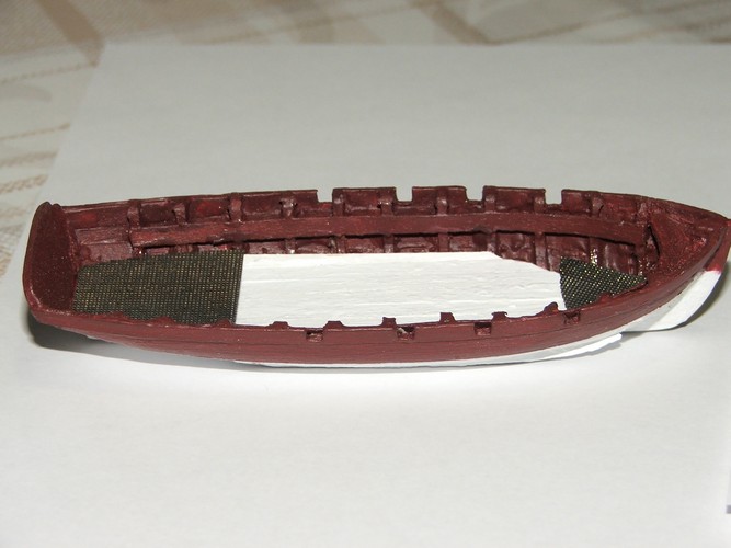

Have now completed the last remaining tasks from build pack 2. If things get any smaller I'm going to need a bigger magnifierLOL

Your skiff and cannons look great. Some very nice work on the small bits. I know what you mean about needing a bigger magnifying glass. The pictures on the forum never really give you a good idea of how small everything really is.

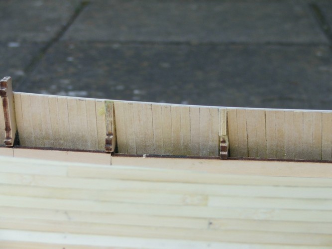

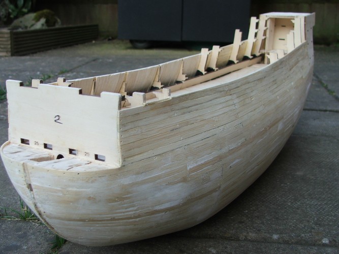

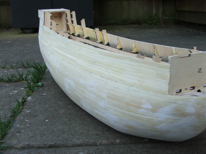

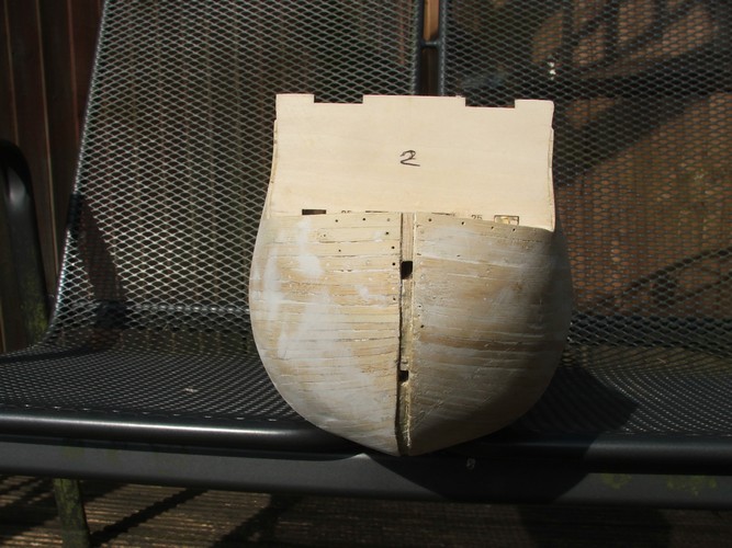

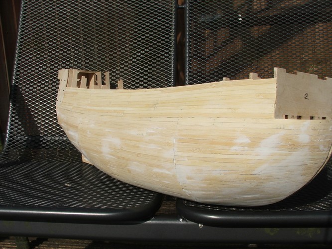

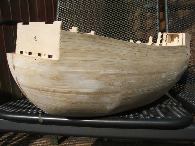

Hi Everyone / Update Time
Progress has been slow but I have steadily continued planking the hull and build pack 3 is now complete. Had a couple of problems along the way that needed sorting.
1) Managed to break off three of the pointed rib tops during the planking just from generally moving the hull about. And thought that area a bit flexible when planked so added a layer of 1mm x 5mm Limewood strip.
2) As I started the upper planking it became apparent that rib 26 on the left was out at the top by 5mm. Now I know it wasn't like that when I glued it in so can't explain why.
Spent a whole 2 weeks just considering my options on that one and in the end just cut the rib off at deck level and re glued.
As to my attempt not to have any droppers or stealers, managed it at the bow but not quite at the stern, still I'm glad I tried it and I can tell you its one heck of a lot of tapering. As this build will have a painted white hull the second layer will follow the build instructions.
So now I start sanding and filling the work so far until pack 4 arrives but in the mean time if anyone spots errors I would be grateful for a shout.
Rgds Nige
