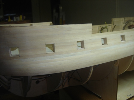

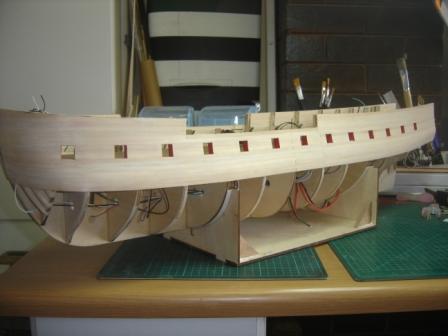

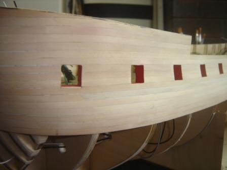

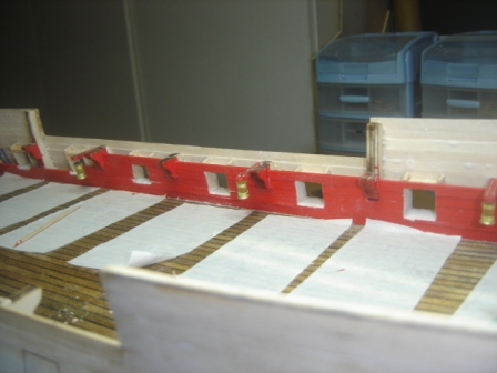

I started cutting out the port-side Gun Ports around the 18th, now the 28th June, had no idea it would take that amount of time after lining them and fitting the inner planking...Happy with the results so far though, now onto the starboard side..here's a few pics..
Barry

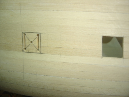

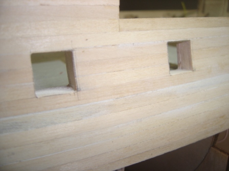

TIP..when cutting out the Gun Ports it's much easier to cut a "V" section than trying to cut through the Basswood when cutting the vertical sides across the grain, a bit like cutting down a tree..
Barry

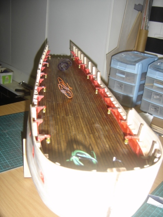

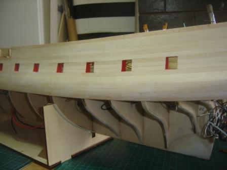

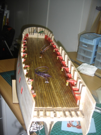

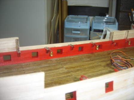

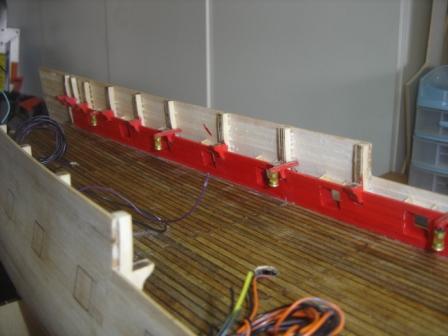

Managed to get the Starboard gun ports finished today together with the lanterns..was much easier and quicker than the port side, just got to add a couple of planks onto the inside of the bow section and then a couple more on the stern and then wait for the hull planking to arrive...
Barry

#89 Posted : 04 July 2016 22:11:35
Hi Barry.
Very nice clean build. look forward to seeing more.
Ian
#90 Posted : 04 July 2016 22:33:26
Lovely work Barry, excellent job on those gun ports....

Glad I'm not building the Victory, don't think I could manage all those gun ports...
John..I had some yellow standard LED's in my toy box and started playing with those and the .22 cases, they looked o/k so I bought a few more, never thought about flickering LED's, great idea...too late now though.
By the way John, what camera are you using your pics are awesome?

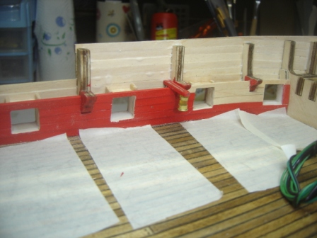

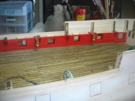

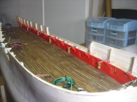

Added a little more planking on the inside to bring it up to the correct level..

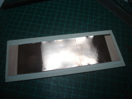

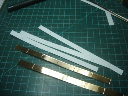

The inner hull planking is complete extended up to the bottom of the top deck and the inner bit up at the front....

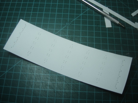

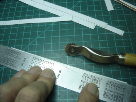

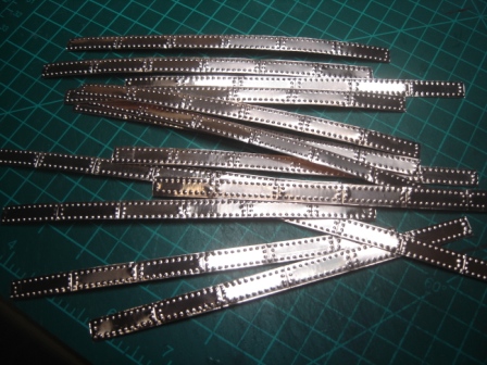

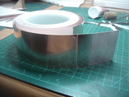

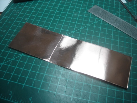

Waiting on the Hull Planking should be here in a couple of weeks, mean time to keep myself busy I've decided to copper plate the hull after looking at many other builds. I'm going to use self adhesive copper foil after looking at a few "how to do it" pages, couldn't find any 8mm strip down here so had to buy 50mm wide and perform some surgery on it.

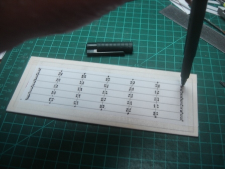

First made a jig with 1mm holes drilled in it strategic places..
Next roll out the copper foil and cut off a piece..

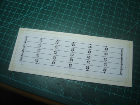

Attach the foil to the jig with a couple of bits of masking tape with the peel off inner facing the jig..
Using a .7mm marker mark the holes onto the foil backing..

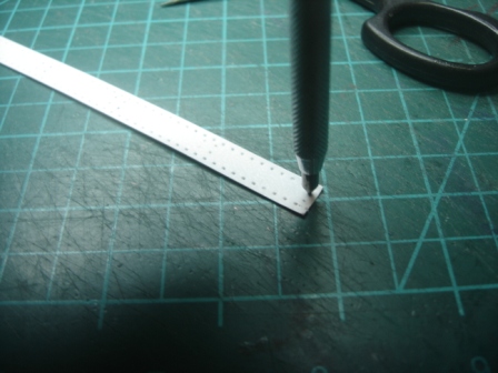

Score the copper side to represent the individual tiles and then cut the strips..
Use a pounce wheel on the edges and a small punch to mark the edges..and presto..
Going to need considerably more, but time on my hands right now..
Barry

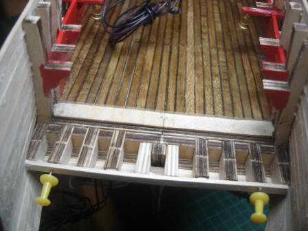

Got around to a couple of those little jobs that needed doing...
Stern planking..

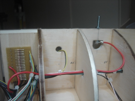

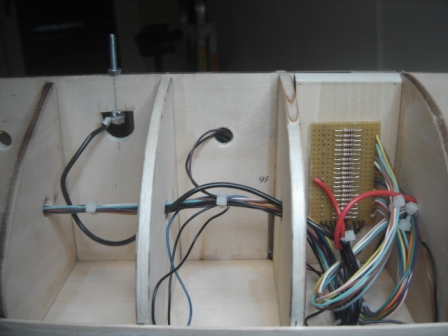

Wiring studs..
And trim the lower decking at the stern..

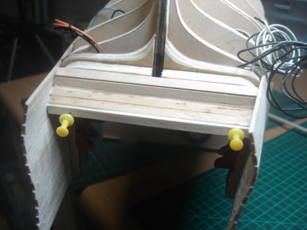

Barry
BarryM attached the following image(s):
