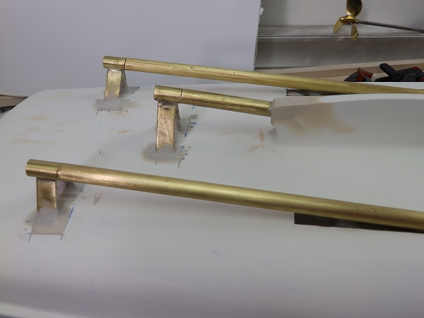

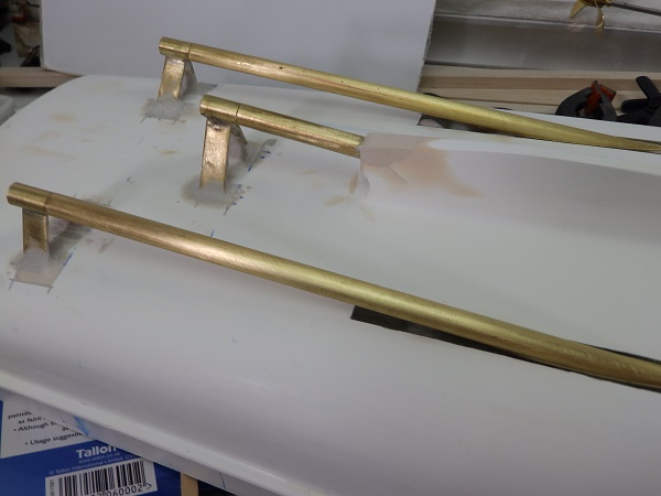

#91 Posted : 07 February 2016 19:16:53
BigGrin Hi All

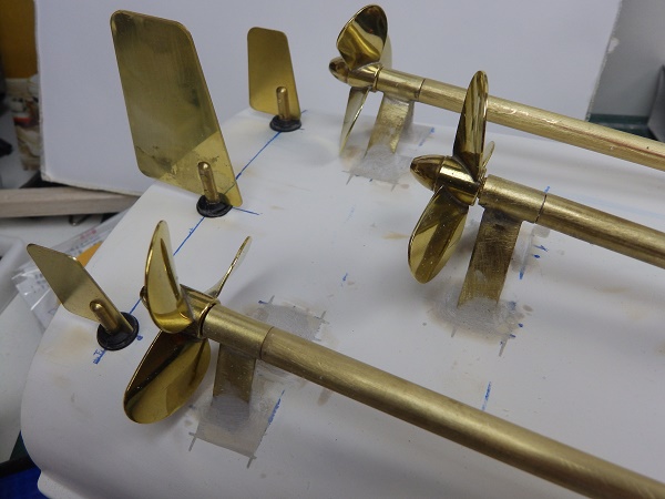

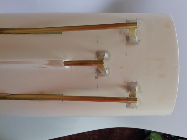

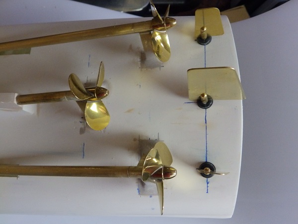

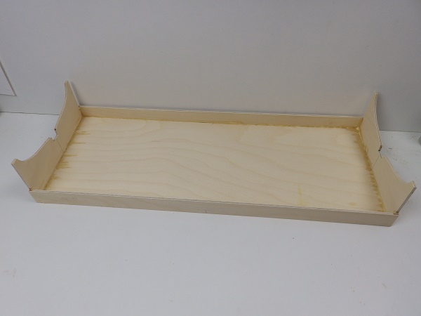

The A frames have now had the P38 faired back and the test fitting of the screws to give an idea of where to add the main central rudder and the side half rudders. Once the hull was marked out the holes were drilled by using slightly larger drills until the correct hole size was achieved, the rudders were then put in place to test there movement.
The hull itself will now need to be supported off the build table so I have built a simple cradle to hold the hull out of 4 mm ply. Next I will start fitting out the motor and battery area in the hull. More soon.
#92 Posted : 07 February 2016 21:09:29
That looks brilliant.
Those brass props are 100% better than any plastic offering.
I bet this will upset the ducks on the pond when you power this one up.
Looking forward to the next instalment.
#93 Posted : 07 February 2016 23:42:03
BigGrin Hi Tony
The brass props are from a dutch company called 'Raboesch' they do from 2 blade up to 7 blade brass props and I think there pretty nice too. Thanks for looking in and your comments.

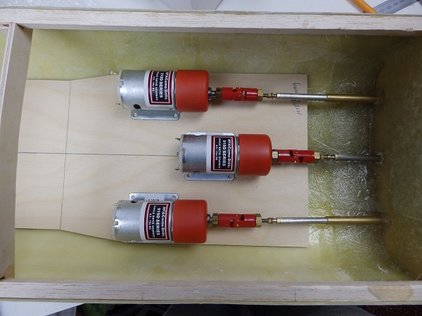

#100 Posted : 13 February 2016 19:09:38

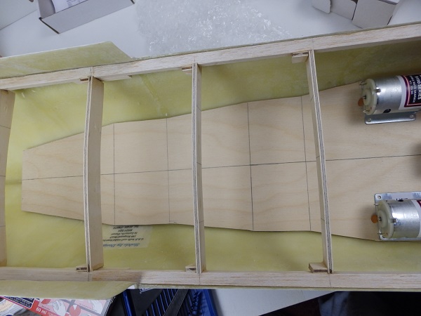

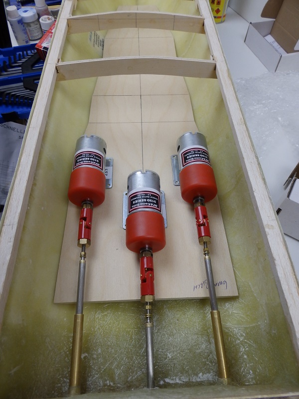

BigGrin Hi All
More progress. I used some more brass tube to give more support to the outer prop shafts. Then cut out the motor/speed controlers,battery mounting base. The base is still free floating for now as the captive nuts for the motor bolts have yet to be fitted along with the battery slot to be cut out. Once this is done the base will be laminated in with glass fibre. More soon.
