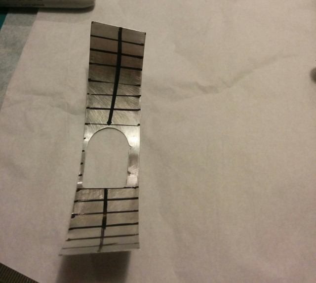

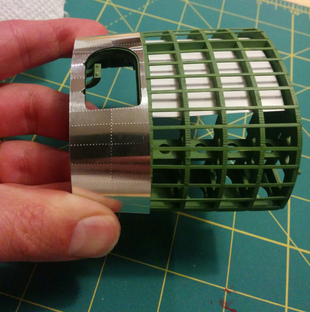

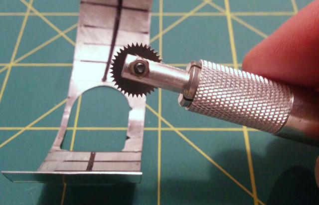

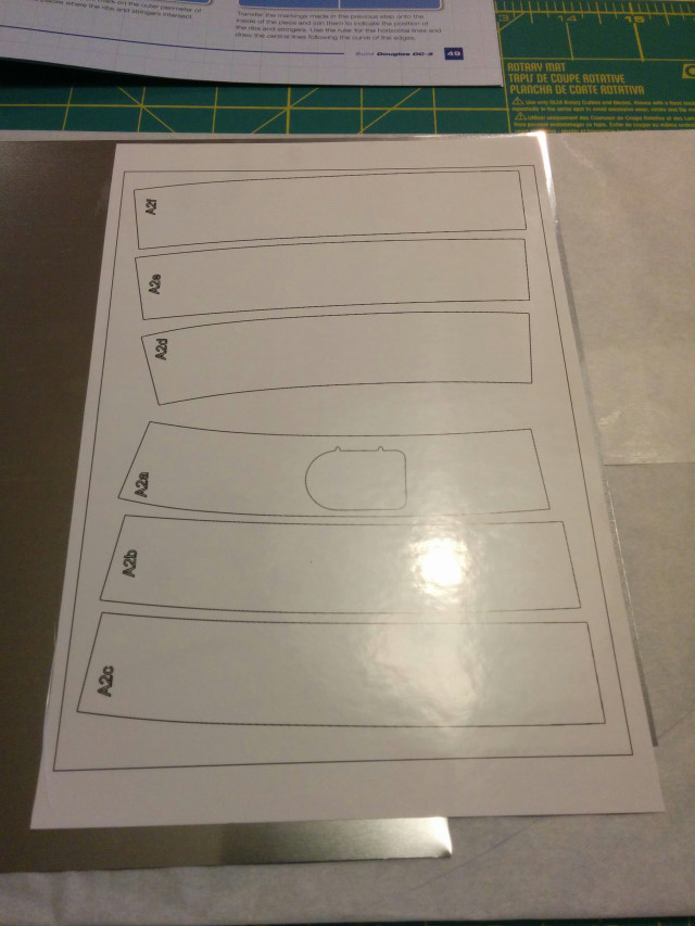

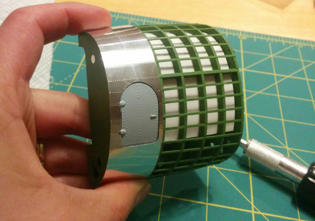

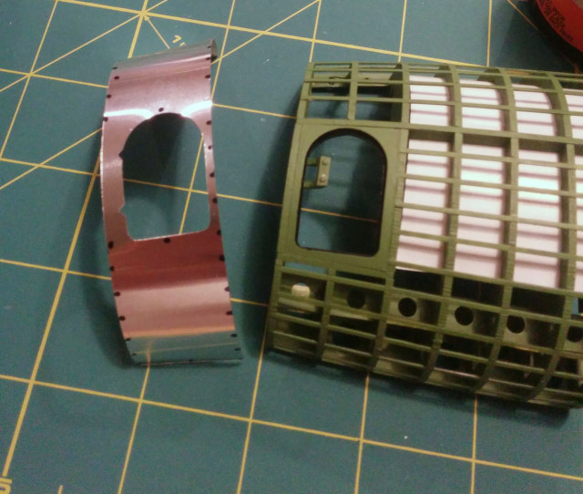

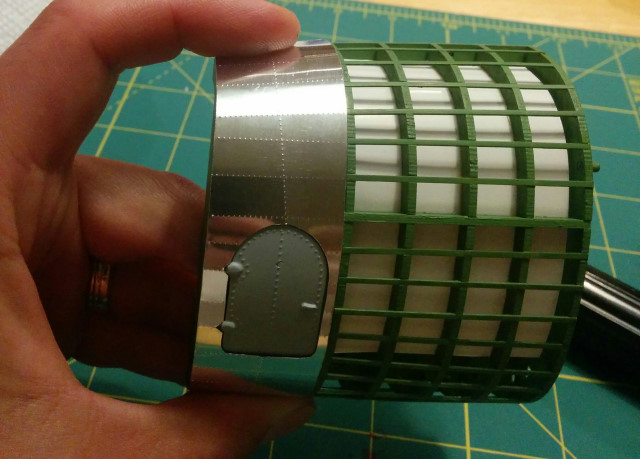

Well this is where we separate the men from the boys. Tonight was just a test to see what it would take to cut the aluminum, shape it and make the rivets. I must admit, this part is going to take what will seem like forever.
I learned a lot, and I was hopeful I would come out with an acceptable piece, however my technique for cutting the notches for the doors didn't work well, no top of that I really messed up 2 of the rivet lines, you can see how terrible the angle is in the last picture.
The aluminum panels do not cut easily, in some spots you are going over the spot 5-8 times before you get through, especially on tight curves. This is not for the faint of heart or impatient.
Later this weekend i will take what I learned and re-make this panel. I was smart enough to scan the templates into the computer ahead of time just in case I ran into this issue.

#82 Posted : 05 September 2015 04:38:56
Hi,
It' definitely a game of patience.
I checked the marks for the rivets twice before committing to the rivet tool and a tip for the two slots round the door hinges is to use a miniature triangular file. A lot easier than trying to cut them.
Keep at it and you'll get there.
Good luck
#83 Posted : 05 September 2015 09:36:46
Can see that is going to be a job requiring the highest level of patience to get to look just right... Think it was a great first attempt though and from your tests you are sure to work out a technique that will suit you best. As it progresses you will probably find you'll be able to produce these panels without too many problems.....Cool Cool .. Superb work to date, very well done.....

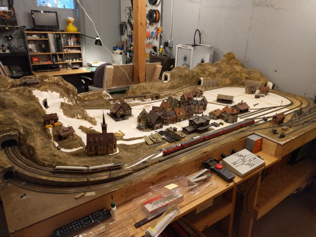

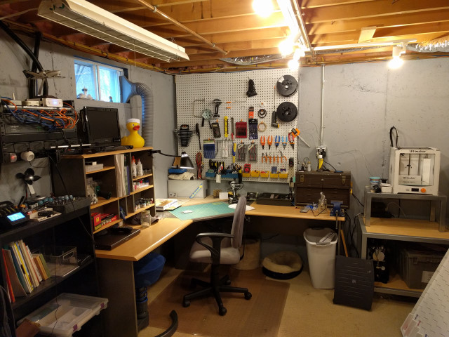

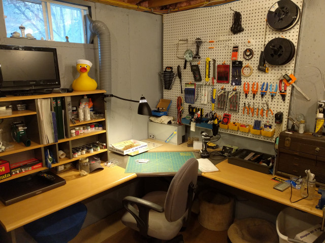

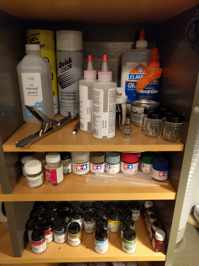

Great news! I have resumed the build! After nearly 5 months of moving and getting resettled into our new place, I have started on Pack 3 (i have up to #8! i better get moving!). Here is the progress and photos of the new model building area. As you will see I'm also building model trains, so I split free time between both of these projects (And I have the Millennium Falcon to do yet!)

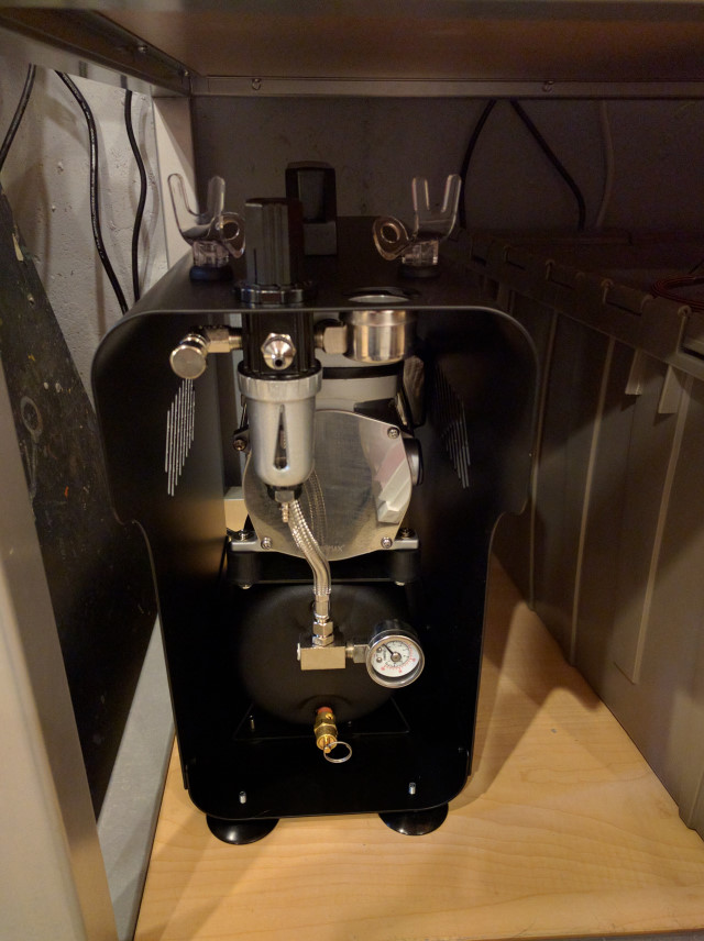

New to the setup is are two air brushes from Iwata, a compressor (w/storage tank) and a ventilated hood for painting. Yet to try those out, should be interesting!
Frederik,
I used the magnets that came w/the kit and I bought more so that I could make other parts of the model come apart. See the photo below comparing the kit magnets (middle) with the other 3 sizes I purchased.

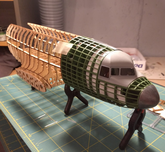

#90 Posted : 15 March 2016 01:37:36
Good to see you back.BigGrin
Nice set up in the work shop.Cool
#91 Posted : 15 March 2016 14:47:26
Good to see you back, loving your man cave Drool
#92 Posted : 15 March 2016 22:47:38
Hi Todd,
Your build is looking good as well as your train set up,just looking at your Iwatas,you will find the Revolution a very good brush,and with PTFE you will be able to use most paints without damage to the seals.
Also I note that that you have a storage tank air compressor excellent buy as this will keep an even pressure while spraying.
Well all the best with it all,watching for the next update.
Trev.
Wnt2Fly
#93 Posted : 15 March 2016 23:42:33
Rank: Amateur level 2
Joined: 28/07/2015
Posts: 42
Points: 122
Location: USA
tf64 wrote:
Hi Todd,
Trev, yes I originally purchased a small compressor with no tank. First of all the regulator and condensation trap wouldn't even thread properly. Piece of junk and I returned it. Do you know how hard it is to find a decent compressor system? The one I purchased is a SPARMAX TC-620X. I could hardly find any sellers here in the US. Looks like most of them are on the other side of the pond in the UK - where, so it seems from reviews and ships, air brushing is much more popular. Everything here sold at the major hobby retailers is absolute junk. I figured I'd spend a bit more and get quality components.
-t
#94 Posted : 15 March 2016 23:51:52
Now that's a man cave I could get lost in, you're very lucky to have that amount of space.... Great work on the build, enjoying your progress very much......Cool Cool

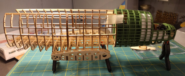

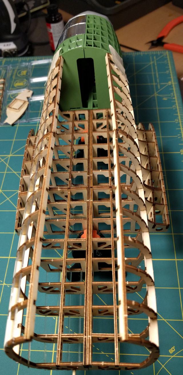

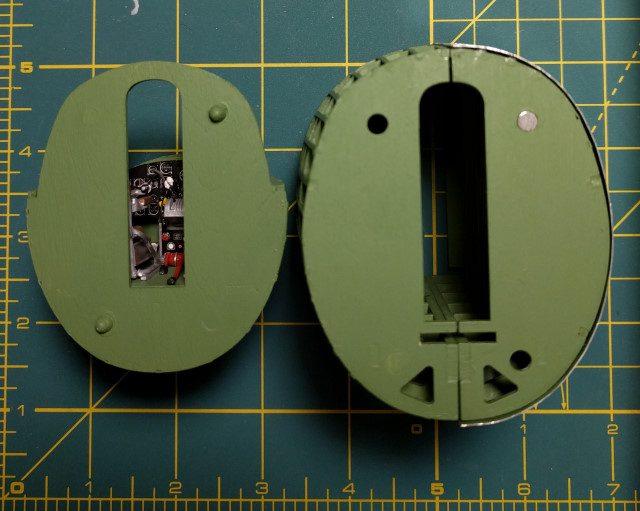

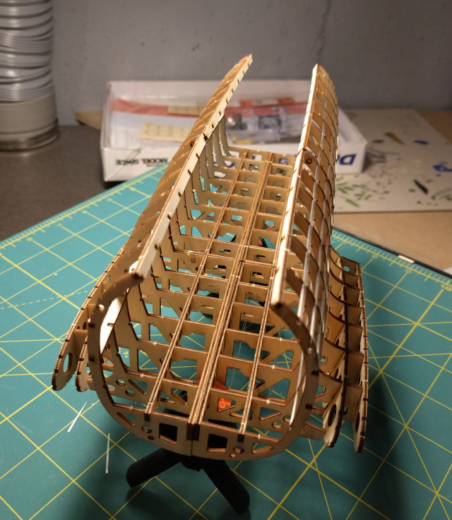

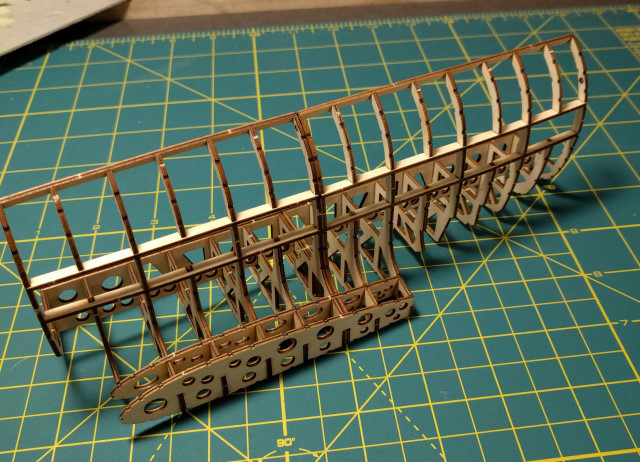

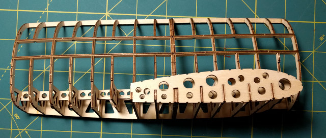

So did some work on it the past few days, and something is becoming very clear. Before I go on this mini rant, let me first say that this is my first Model Space kit, while I do not consider myself a professional modeler by any means and I am not out to make this 100% accurate. I do want to have incredible detail that can be seen.
Now with that said it is becoming more and more clear to me that this model build is full of un-necessary steps and poor design. Both of which is clearly resulting in wasted hours, extra materials, extra paint glue with a net of a model that you can't see details. Now having instructions 1-8 (out of 12) I can see massive changes are in order.
For example, all the work that goes into the cockpit, if you follow their directions you'll hardly see any of it because you glue all your hard work together! Am I modifying it? Yes. If you follow their directions the radio room will never be seen. In fact 90% of the green paint that is applied to the sub-structure is only covered with aluminum and can't be seen. The additional ribbing? Can't be seen and isn't even needed for any structural purpose.
So where is this all taking me? Personally I understand there are people out there that are over the top with builds and despite not being able to see something they can't sleep at night knowing that shortcuts were taken for presentation purposes. I am not one of those people.
I'm going to modify this build in a few ways. First I'm most likely only going to build half of the model. Yes you heard me right, one half. The sections will all be secured with magnets so they can be removed, but I'm going to build it in such a way that some areas of the aluminum skin will not be applied so you can see what lies underneath. This will also allow for better display as this thing will be quite large when done.
With that said, here is the progress. The side you see with out the ribbing will most likely not be used. I'm not sure which side will have the wing just yet...The first picture shows some window frames and a jig I made to make them easier to build.

#96 Posted : 18 March 2016 09:44:05
Lovely work on the fuselage sections Wnt2Fly, all looking very neat and tidy and very well aligned by the look of it - no twists in there!! Cool ThumpUp
Great to see you back on this build, I was very much enjoying your diary before your house move forced the sabbatical but it looks like it is going from strength to strength now? I understand your reasoning for just building one half of the model and it will be a fairly unique approach amongst other builders of this model, though my feeling is, would it not be better just to spend some extra time constructing lots of extra removable panels, using your magnet system, in order that the detail which might be lost otherwise can at least be seen and you'll still retain the look of a completed model and justify the cost of all of the parts that would otherwise be discarded?
Not a criticism, just a thought and you are free to build your model how you choose of course? Cool Cool ThumpUp
