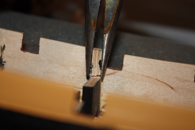

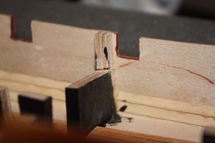

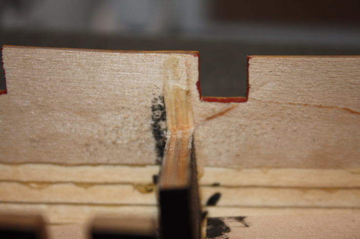

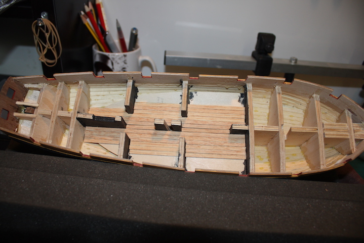

Inserting the upper Deck.
Before we can fix the second false deck in place, this will become the substright for the upper deck, we need to remove the rib tops that the outer bulwarks were mounted to. This can be a tricky process and care is needed not to damage the bulk head. Begin by cutting through the base of the rib at the correct point. a razor saw is best for this job. However the ribs at the bow will be much more difficult to get a razor saw into. using a sharp craft knife blade and gently rocking the blade backwards and forwards while applying pressure you will slowly make your way through the wood. Do not cut right through 1-2mm can be left.
Then using a pair of suitable pliers or mole grips gently 'waggle' the rib until it breaks free. do not worry if some splinters of rib are left behind. These can be removed with a craft knife and then sanded flush along with any glue that may be left behind.
Once this task is complete the deck supports need to be sanded to ensure they are smooth and even ready for fixing the false deck. The bulwarks should also be sanded smooth at this point ready for lining at a later stage. It is important you do not over sand. The formers are deliberately shaped to give the upper deck a camber and this should not be removed.
Test fit the false deck to ensure it fits comfortably. When your sure you have a good fit you will need to paint any visible wood black so that it cannot be seen through gratings and deck fittings, if you have not already done so.
Before fixing the false deck in place mark out a line running the full length of the deck at the half way point, this will be used to start the planking.
Wood glue is applied to all the contact points, once the Deck is installed I used pins to ensure it stayed in place and sat correctly on the supports. you could use weights if you prefer. the pins are removed once the glue is cured.
