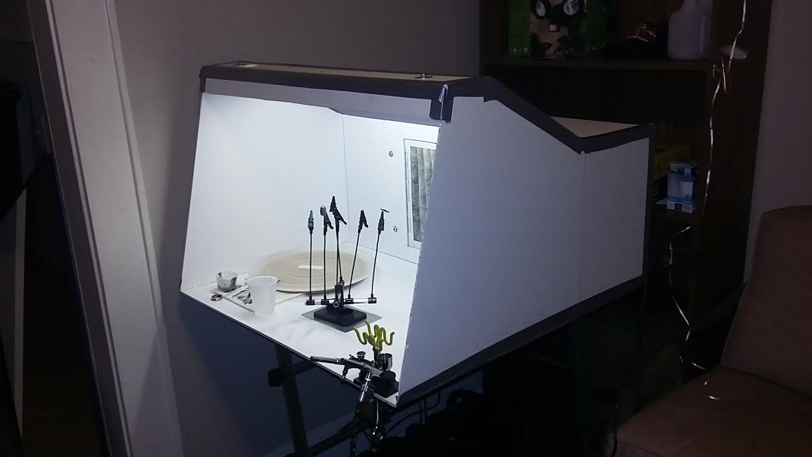

Mental note to self... remember that not all lights are as cool as LED bulbs are now!
So here's the situation... Here I am happy as can be using my new spray booth and everything is going great... I get up from it for a moment and turn my back and all the sudden I hear CRASHHHHHHHHHH! The florescent light strip I was using in the hood I had attached with hot glue thinking it would be good enough to hold it with no problems seeing as its a florescent bulb... well I was wrong... it got hot enough to melt the glue and the whole think came crashing down... luckily the bulb didn't break. So I drilled a couple of holes in the top of the hood and reattached the lamp with some bolts and washers (notice the top)... now everything is right with the world again! I'm just glad that nothing was damaged (including none of the parts I was working on including some printed pieces!)

I like your solution for the spray booth, looks like a shop bought one.
