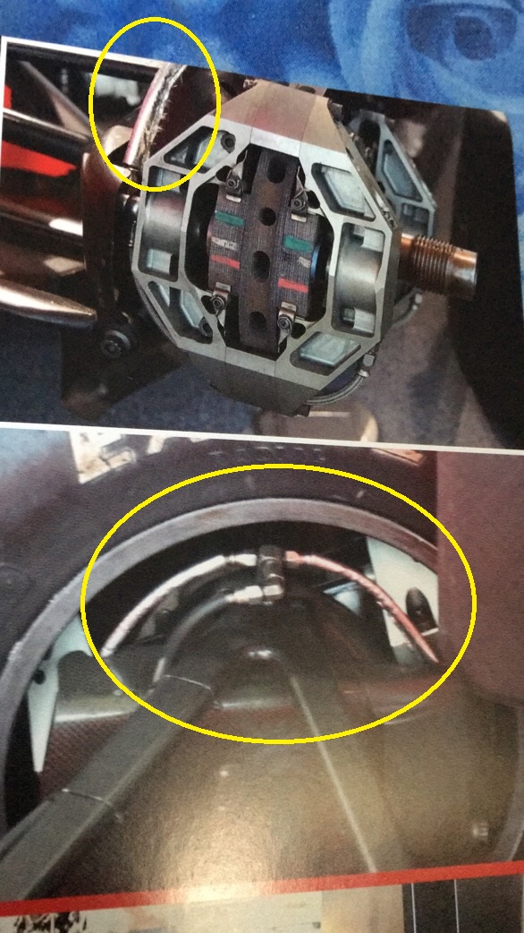

NSXKid wrote:
Added foil to simulate when they used to wrap (to insulate?) the brake lines:
Hi Jim, i have a question.
Many people remade the brakes hose with braided wire, but on mfh book i saw the the brakes hose are black wrapped with allumium sheath.
I see this mod on your build. Did you used allumium tape to make this?
NSXKid
#91 Posted : 29 March 2017 01:51:35
Joined: 01/12/2014
Posts: 102
Points: 312
Location: Chicago, IL
Hi Frah2o,
For the brake hoses, I bought a sheet of Bare-Metal foil.
https://www.amazon.com/C...-Adhesive/dp/B00DR26YYO
Jim
