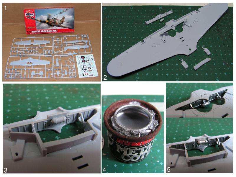

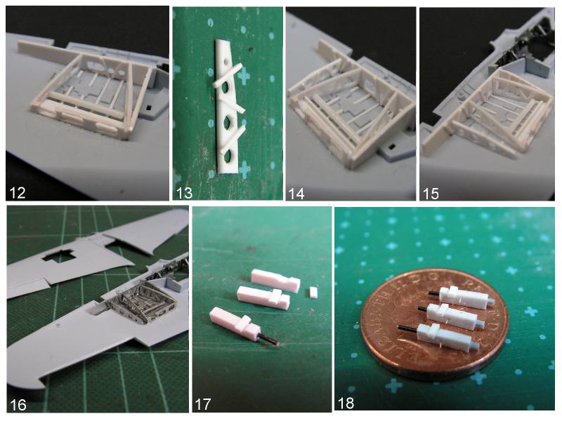

So, on to the kit. In Photo 1 you can see the entire kit contents laid out, four sprues of a nice light grey plastic with a fifth sprue in clear for the canopy parts and lights etc. The canopy itself is composed of three parts but only two are used, the main ‘greenhouse’ sliding part and a choice of two front windscreens, the earliest ‘flat’ version or the upgraded thicker one with the additional bullet proof panel. I’ve gone for the bullet proof version, partially because most of the Hurricanes in the Battle were retro fitted with them and also because the early version was unfortunately broken in my kit (snapped away at the sprue attachment). What I haven’t shown is the well drawn out instruction booklet composed of seven pages of A4 (not the single double sided sheet in the Spitfire!) Whereas the Spitfire kit was a ‘Beginner’s’ model, the Hurricane most definitely isn’t and there are some issues with the fit of parts as I’ll explain when we come to them. The first thing to notice is the construction of the cockpit, which is completely different to the Spits. Where I could build the Spitfire cockpit as a separate unit, super detailing it before, then adding the whole thing into the fuselage halves, with the Hurricane you can’t do that. The Bulkhead which holds the seat and the instrument panel locate into the left fuselage but the foot pedals and control column fit onto the cockpit floor which is part of the upper wing component. We’ll come to that later on, but the starting point (following the instructions at this point) is the lower wing half and the undercarriage wheel well. In Photo 2 we have the main components of this section laid out, there are some further details which go in after the fuselage is added and the u/c legs go in. Photo 3 illustrates those same parts in position ready for painting. I believe later marks of Hurricane had the same ‘cockpit green’ protective paint like the Spitfires but the Mk I’s were bare polished aluminium in most of the exposed metal areas. In order to paint these areas I found my old tin of Humbrol Polished Aluminium Metal Cote. I thought it was still in the old garage but after a long and fruitless search I discovered that I’d already brought the thing up on a previous salvage trip! As you can see in Photo 4, the tin is really rusty on top but the Metal Cote is as good as the day I bought it which, when you consider that that day was over thirty five years ago, is pretty good going!Blink (If only the acrylics would do that!) The composite Photo 5 shows the wheel well after painting with the Metal Cote from top and bottom. The only problem I’d overlooked with the Metal Cote was that, being spirit based itself, trying to use the Blue-Grey Enamel Wash to shadow the details tended to dissolve the aluminium! I should have coated it with the acrylic varnish first of course.

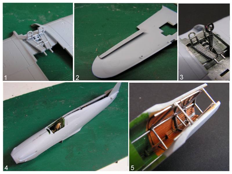

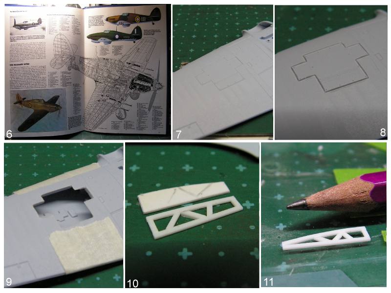

There was going to have to be a whole lot of scratch building on the Hurricane. My initial plan was to cut the fuselage through the middle to expose the innards of the airframe but the moulding of the model was so good I decided it would be a pity to spoil it and so the Hurri would go in intact. Unfortunately, when I started to fit in the various elements of the diorama; the two Spits, the hut, Bofors gun and the two vehicles it became apparent that no matter how I arranged them, it just looked too crowded for an operational airfield. The only way to get the space the model needed was to lose the back half of the poor old Hurricane – so back to Plan A it went. For the internals I again used one of my excellent volumes of The Illustrated Encyclopedia of Aircraft, a weekly part work from some time ago, each aircraft featured came with a highly detailed cut away diagram as you can see from the photo I took of the Hurricane pages in Photo 6. The only problem with that collection is that the full colour plans often show one model and the cut away drawing shows another. In the case of the Hurricane the full colour was a Battle of Britain MkI and the drawing was a MkII Sea Hurricane armed with flamin’ cannons which meant more research on the web to get the gun bay layout!Crying

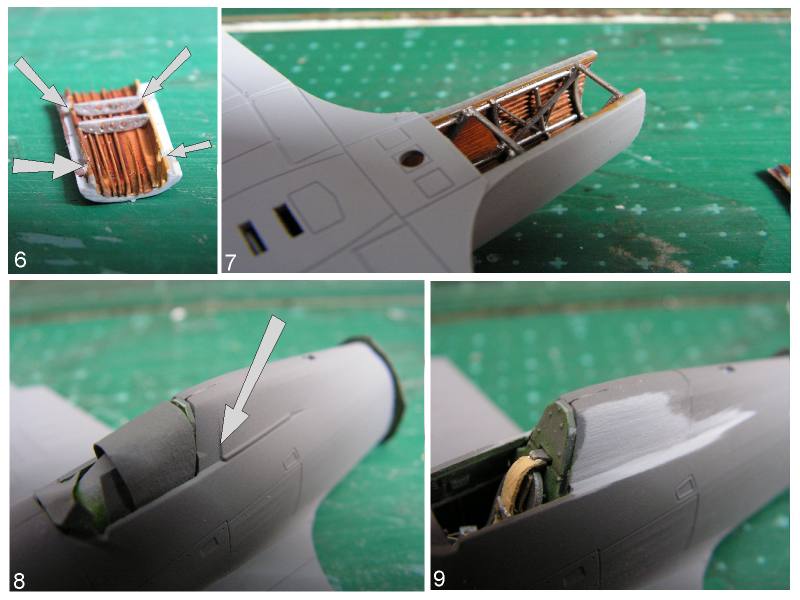

Speaking of the gun bay, that was the next stage! In Photo 7 we have the finely moulded panel lines of the gun bay on the port wing. There seemed to be some re-designing going on in this area among the early Hurricanes, this one has the more rectangular panel but others, (possibly when the all metal wings were coming in) have a sort of rectangular with hexagonal bits instead. The first job was to carefully scribe along the panel lines with a sharp pointed knife as in Photo 8, repeatedly going slightly deeper each time until the entire panel was removed, shown in Photo 9. The wing halves are held together with masking tape as seen here, I had to keep putting it on and peeling it off as the various components of the gun bay were made up and test fitted (sometimes needing a little tweaking when I’d forgotten that the wing was getting thinner towards the tips as well as from front to back!) With the panel removed, it was necessary to file back the thickness of the upper wing at the edges of the now open bay to bring those edges back to something closer to the metal skin thickness. I could now start to plan out and construct the intricate aluminium spars and box girders, which make up the interior of the Hurricane’s wing. I began by first cutting and sanding offcuts of Plasticard to the shape and size of the spars and then drawing the zig-zag pattern of the internal struts. A copy of the template was then glued together out of 0.5 x 0.8mm Plastruct styrene strip (the same as I used on the Hut windows) as shown in Photos 10 and 11. Again, these were glued together on the sheet of glass so they could be carefully removed by safety razor blade once dry. The procedure carried on with frequent referrals to the cut away drawings until the main part of the bay was done as in Photo 12. The extra long bit is the Leading Wing Spar with the series of holes through which the Brownings barrels pass and the rear most section is the Main Wing Spar which carries right on to the wing tip and back to the fuselage where it is one of the main attachment points joining the wings to the fuselage. The last major piece was the next spar along which is almost hidden from view but does form the outer wall of the ammunition box stowage. This can be seen coming together in Photo 13. The finished bay can be seen in Photos 14 and 15, and after it’s Metal Cote in Photo 16. Once the bay was suitably weathered down (or grimed up whichever is closest!) I had to construct the Brownings. This is where the natural sneakiness of the modeller comes in. I have a couple of hard plastic ground crew figures carrying a Browning, they came with the RAF Refuelling set and I’ll be using one of them in this model. Not only did I use the gun he was carrying to get the dimensions from, but by having him carrying one of the things, I only needed to make up three more instead of four!BigGrin

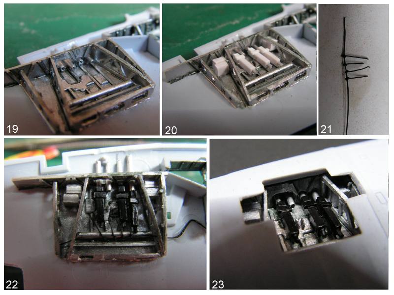

Photos 17 and 18 illustrate the sequence in building the Browning .303. Starting with a strip of plasticard cut off one of my thicker sheets, first a ‘shelf’ is filed out of the top surface which will take the ‘wings’ which stick out slightly (part of the breech mechanism which is raised up when loading the gun). Once the shelf was correct, then the strip was cut to length, this saves having to get the shelf in the right place and also allows better handling with a longer strip to hold onto! A thin strip of plasticard was then cut and glued on to form the wings and the front was drilled out to accept a short length of 0.5mm black coated copper wire which forms the barrel. None of the barrels are actually seen once in position, I simply added them on as a guide to stick into the barrel blast tubes as you’ll see shortly. To finish off, a short piece of stretched sprue was added to the rear of the gun and an even thinner piece was drilled and glued into the left side to form the cocking bolt.
The last item to add to the bay before the guns could be fitted was the set of four blast tubes. These pass through the leading edge spar right up to the muzzles on the front of the wing. They were also fitted with a heating element, with another back in the gun bay itself to prevent the guns freezing up. The tubes were formed from 2mm diameter aluminium tube (no painting required here!) and were super glued into place lined up with the muzzles as shown in Photo 19. Photo 20 illustrates the final test fitting of the three machine guns and their four associated ammunition boxes, also made from thick plasticard. (There are also a complicated set of curved ramps which feed the ammo belts into each gun together with smaller ones to guide the spent cartridges out of the slots in the slower wing. I got away with making them though as they would be removed before servicing the guns!Flapper ) The strange looking thing in Photo 21 is a single strand of electric wire with four other strands knotted on and stuck in place just by the black acrylic paint. I did try super gluing the first attempt but in this minute scale the super glue made big ‘blobs’ at the knots, which didn’t look right. What this object turns into is the pneumatic tube assembly attached to the bolt mechanism, which actually fires the guns. This tube runs all the way back to the fuselage to a compressed air cylinder, another reason not to take a bullet in the air bottle - as well as the powered undercarriage, you’ve also lost your guns! In Photo 22 the guns, now painted satin black are in position with the pneumatic tubes attached apart from the dangling one for gun number two and finally, in Photo 23 the top wing is temporarily back in place to show the finished gun bay. Note those two little flat plates sticking up in front of the empty blast tube, those are two tiny pieces of lead strip and represent the two metal plates onto which the body of the Browning is bolted.
In the next instalment, onto the Hurricane's cockpit – and beyond!Blink

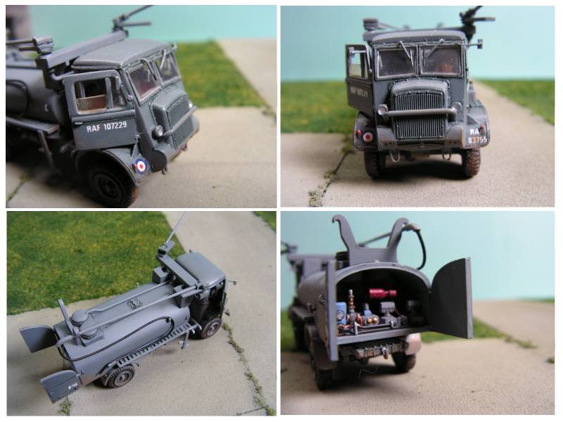

Anyway, here's a 'shorty' whilst I'm putting the Hurricane cockpit instalment together - a photo-shoot of the completed Bedford Bowser with another Film Fact.
Did you know... The sequences which were supposed to be an attack on Manston Airfield during which a hanger blows up were filmed at RAF Duxford, and that exploding hanger WASN'T a special effect - the hanger was a type called a "Belfast" which was erected during the First World War, Duxford wanted it removed and so the film producers paid to have it blown up during filming!Blink
Of course, with the Centenary of WW1 now well underway, that hanger would have been considered a priceless relic!Blink Blushing Crying
Oh well!
Here's the Bowser!

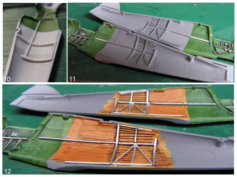

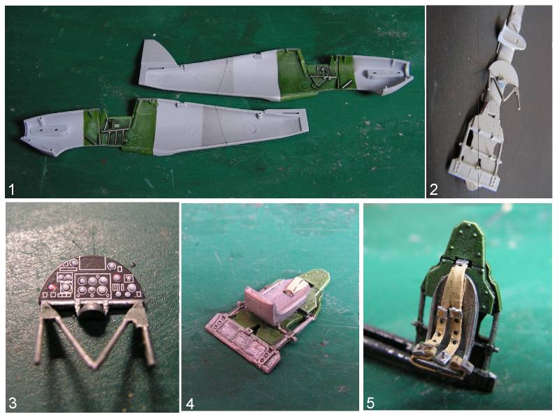

Photo 1 shows the two basic halves of the Hurricane fuselage, like the Spitfires, the wings form the bottom of the centre fuselage but unlike them, there is also a separate rear fuselage floor – more on that piece later. As you can see, there are moulded instruments on each side wall, and in addition, some straight ‘bars’ as well. These are actually parts of the Hurricane’s aluminium frame and in the early versions like this one, were left bare polished metal – a whole lot more bare polished metal coming up soon! The rest of the cockpit area was the same ‘cockpit green’ as the Spitfires. You can also just make out the pencil lines where the fuselage will eventually be cut in half.Crying
Photo 2 illustrates the three other cockpit components: from top to bottom, the aluminium seat, the front instrument panel and the rear bulkhead, which holds the seat. Here the parts have been primed, note; on both the seat and bulkhead, the slots for the Sutton Harness have both been included in the mould! The instrument panel has been painted up and the instrument decal has been added in Photo 3 and the dials have each received a blob of Micro Kristal Klear to make them more ‘3D’. As I mentioned earlier, the Hurricane’s panel is completely flat so I didn’t need to cut out the central section. In a larger scale model however, that middle bit should have a gap all around it as, like the Spits, it is actually a separate piece with it’s own anti vibration mountings.
Photos 4 and 5 show the final assembly of the seat and bulkhead, the rear shoulder straps, again from lead strip have been added in 4 with the rest of the Harness completed in 5. Although it’s the same set of straps as in the Spits, the slot in the seat back is much higher up in the Hurricane and the waist belts attach directly to the underside of the seat as you can see here. In Photo 6, it’s back to the fuselage halves to begin constructing the main aluminium tube framework. For the most part this is made from the recently re-discovered Rico Styrene Rod. Although the full length rods do have a slight curve probably due to their decades of less than perfect ‘storage’, it’s not noticeable over these short lengths. The first pieces to be made however were the curved flat ribs (the vertical bits) these were made from my more modern Plastruct styrene strip, the very last of my 1.1mm strips from the Messines tanks. These are not solid however but drilled out with lightening holes along their lengths. I forgot to show them from the drilled sides here but I’ve popped the photo in a little later!Blushing The main tubular frame then runs between the ribs and back behind the seat bulkhead.
Photos 7 to 9 illustrates the two methods to create the wooden ‘Stringers’ which run across the outside of the metal frame. This is where the Hurricane regresses back to its Bi-plane heritage, the wooden stringers form the actual shape of the fuselage over which the doped fabric is run to create the outer skin. It also meant that the Hurricane was far quicker to repair than the Spitfire, as long as nothing vital was hit, the repair simply entailed sticking a fabric patch over the bullet holes and a quick dab of paint!Cool The stringers closest to the open rear were made from lengths of stretched sprue carefully glued into place with liquid poly. The section behind (or actually in front of) the larger ribs will hardly be seen once the fuselage is put together, all that is required here is the ‘impression’ of the stringers so I used a variation on the corrugated sheet method employed in both Messines and the Dispersal Hut roof. Instead of the brass sheet former, I used the blunt back of a modelling knife blade to score the same soft metal sheet from Mum’s eye gel tubes as seen in Photo 8. Once a large enough piece was scored, it was cut to shape and super glued into the fuselage interior as shown in Photo 9. Photo 10 shows those ribs from the drilled out side as promised whilst Photo 11 shows both sides of the fuselage after the smaller metal cross struts had been added and the whole lot given a coat of primer. The smaller struts were thinner lengths of Rico rod. I think I glued them in with a drop of Contacta poly on the ends as it gave more of an ‘instant grab’ (and didn’t flood the whole interior with liquid poly like the first attempt did!)Blink
Finally, in Photo 12, the side frame assembly has been painted up. The inner wall was painted with Admiralty Yellow Ochre then tinted once dry with a thinned down Citadel Rust Wash for the inner face of the doped fabric. The framework was painted with the Humbrol Polished Aluminium Metal Cote and the area around the frame was given another detail wash with Citadel Skaven Brown to highlight the frames. OK, that’s the easy part! In Part two, the fuselage halves go together and I have to try and build the cross members in-situ!Crying
Until then, Happy Modelling to you All!BigGrin
