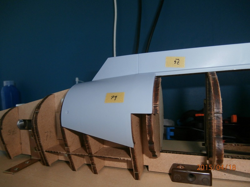

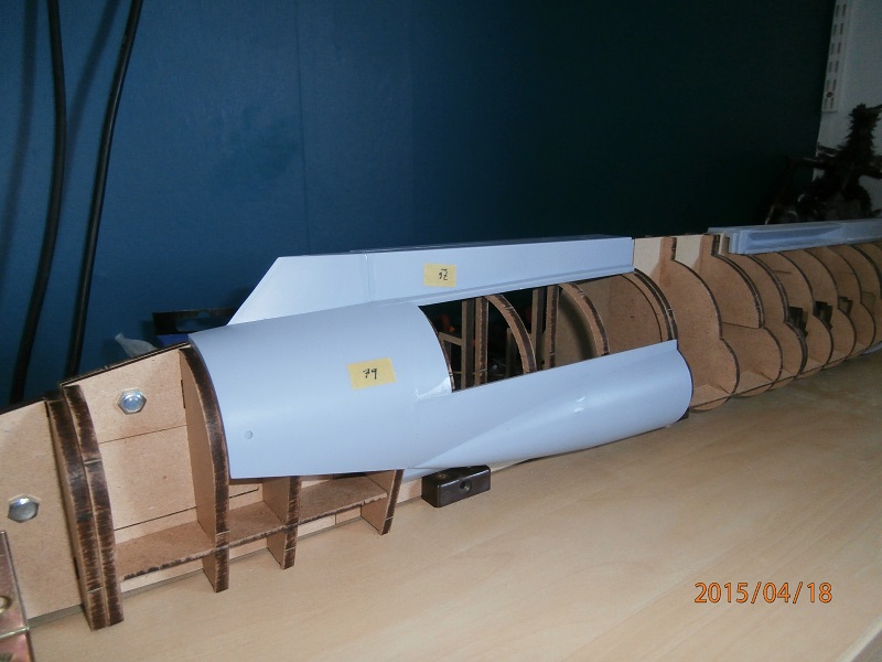

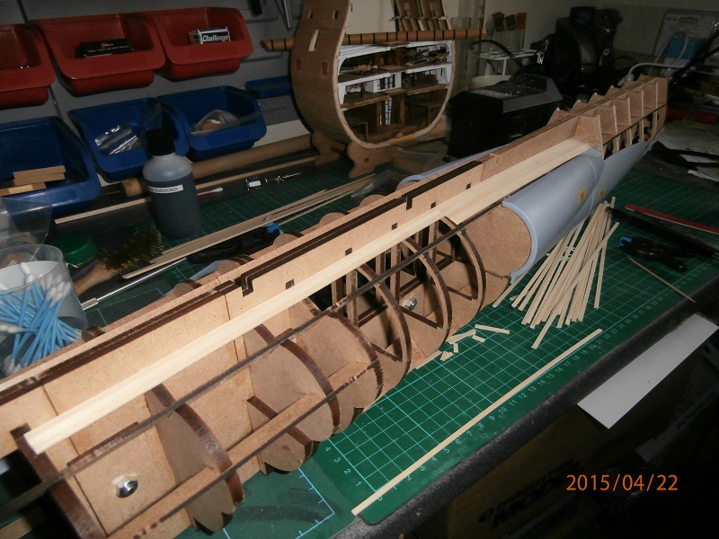

I received my latest delivery on Friday but found the package contained 2 issue 31's and no 30. CS sending out replacement.
I have fitted the parts from issues 28 & 29 together with the 2 parts 78 and 79 from issue 27 which were fitted but not glued last time.

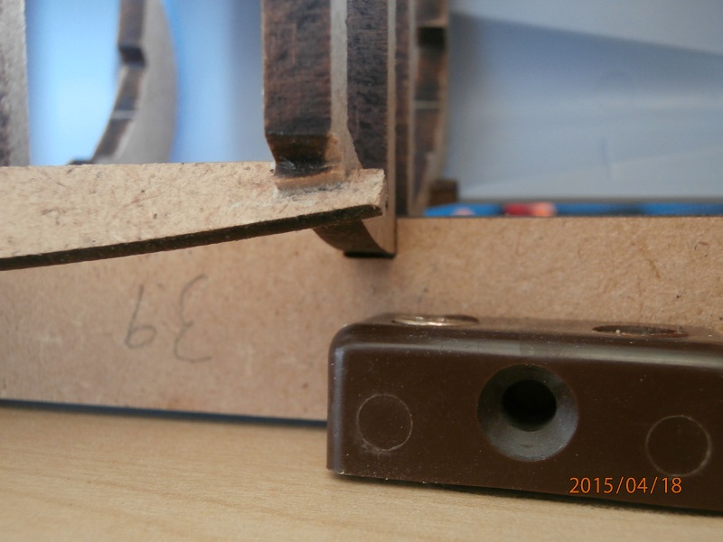

The only fit issue was with part 74 which needed the corner of transverse frame 29 cut off to give the correct fit (3rd pic).
I will still be able to start the planking but will have to temporarily fit parts 64 & 65 in place at the bow as the planking butts up to these (these were left off to allow the fitting of the torpedo room later).
In fact, as I have copies of issue 31 and issue 32 just mirrors 31 on the port side, I will be able to get a head start on next months build.Laugh

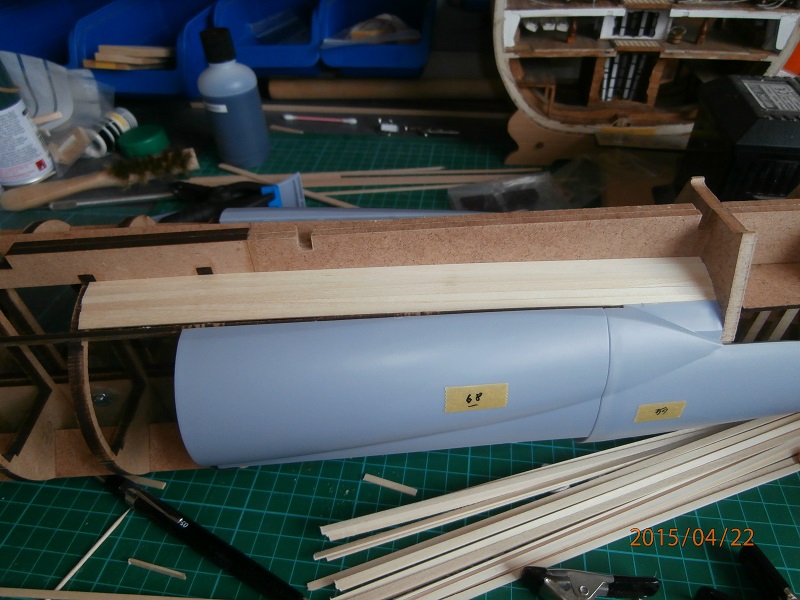

Hi all, thanks for the comments. I have temporarily fitted part 64 at the forward end and started planking the starboard side. Most of part 64 will need to be cut away before final fixing to allow for the torpedo room to be fitted.

Hi Greame.
Looking realy nice. nice to see some planks going on. Is there much difference between the plank thickness and the plastic thickness.
look forward to seeing more IanCool Cool BigGrin
#88 Posted : 23 April 2015 14:14:54
Thanks for the comments guys. Ian, these planks are much thinner than the plastic but don't butt up against it except at the very bow end where the plastic is thiner. The planks for the outer hull, wich come later, are thicker and the hull is double planked which should bring the planking slightly proud of the plastic allowing it to be sanded back to the same level.

#89 Posted : 24 April 2015 13:03:34
Hi Graeme.
Thanks for the reply. a lot of carefull sanding to be done so you dont scratch the plastic parts.
Ian.Cool

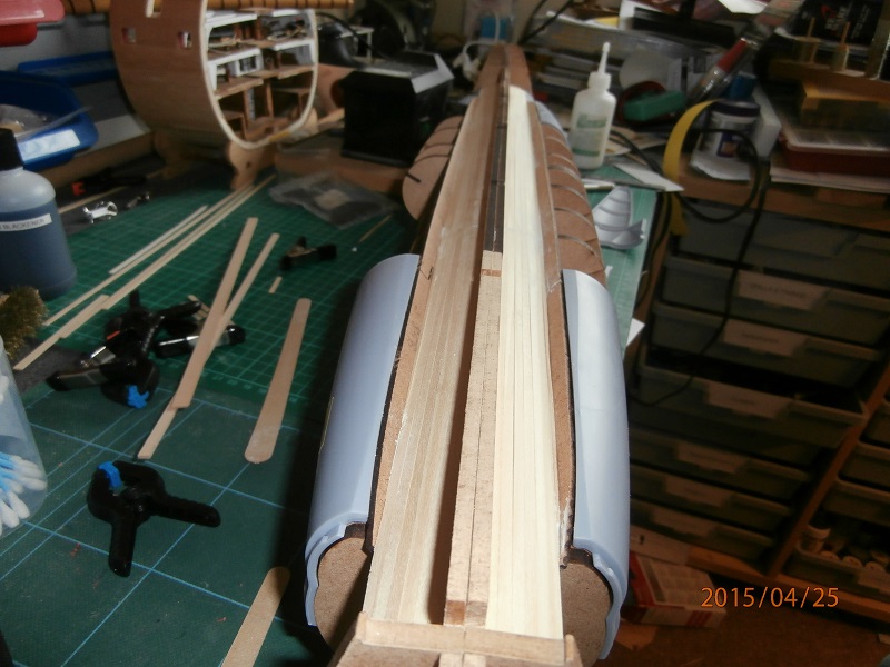

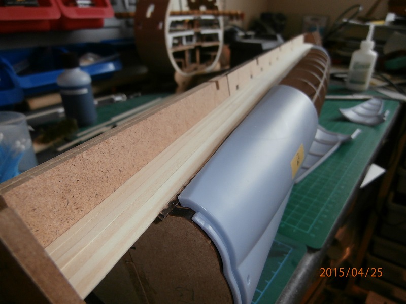

Well I have now finished the issue31/32 planking and removed parts 64 & 65 again. i am now waiting for my issue 30 to arrive so I can start drilling out all those lovely vents. Cursing

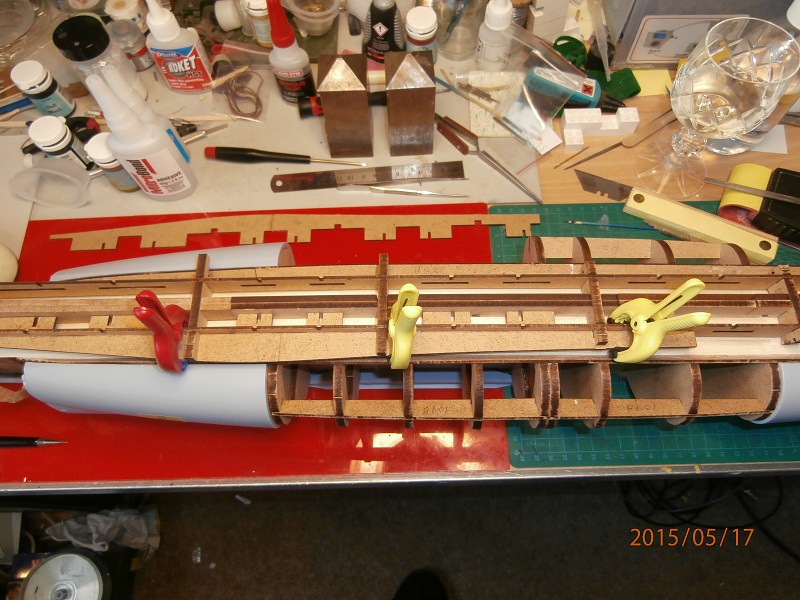

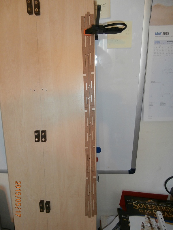

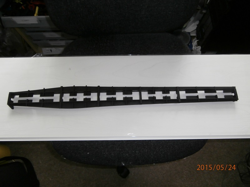

#93 Posted : 26 May 2015 14:21:44

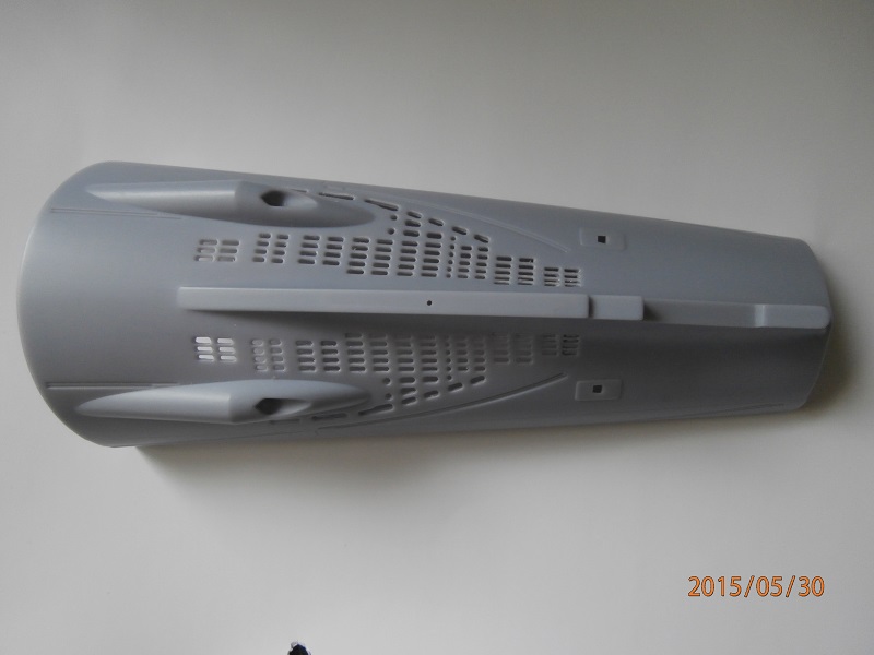

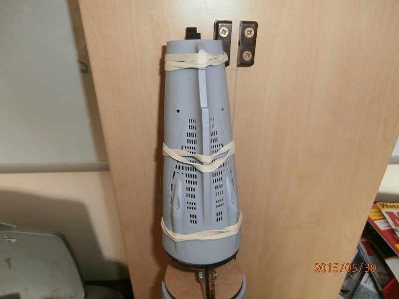

Hi all, I have now completed the build to issue 35 with the exception of the stern plastic part from isue 30. I have cleared out most of the vents by sanding back the inner surface with silicon carbide paper used wet under a running tap (first picture shows progress so far). The vents which have the reinforcing ribs moulded on the inside will need to be drilled out in the same way as the the bow ones were.

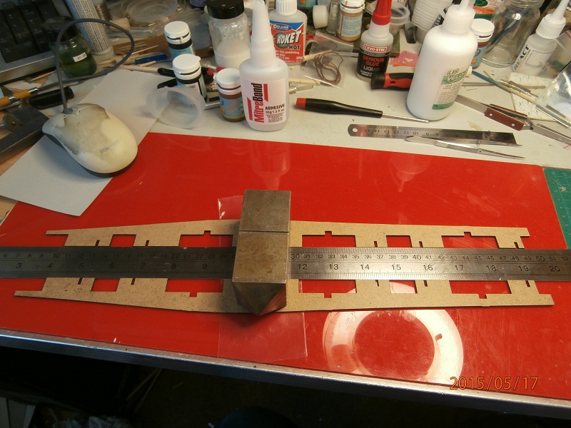

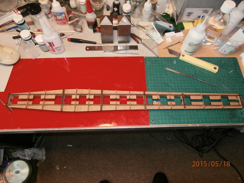

The removeable deck went together with no problems apart from the slots on the hull needed to be filed slightly to give an easy fit.
Once complete the removeable deck was sprayed black using a games workshop Chaos black aerosol can.

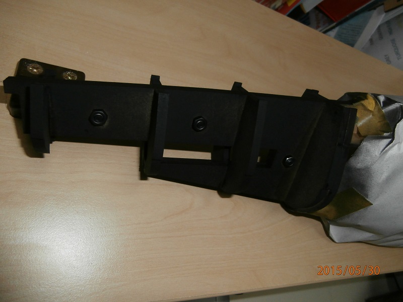

#95 Posted : 30 May 2015 15:40:08
Well I've finally finished opening up the stern vents. I have sprayed the stern framework black and glued the stern piece on. Now just waiting for the next delivery.
