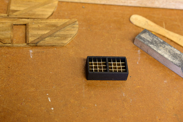

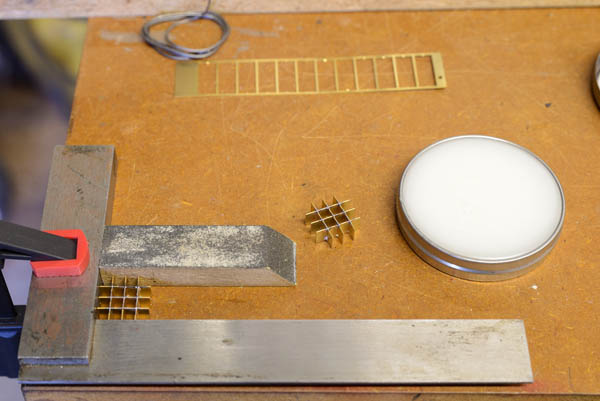

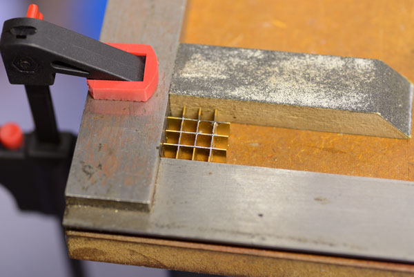

Assembled the wine rack this past weekend. Thanks to Dennis for his article on soldering – no more fights with the superglue.
I clamped a square to the bench to keep everything aligned, applied flux and then soldered the joints.
Once cooled I cleaned up the edge with a file. I followed the instructions here and decided not to paint the brass bits.

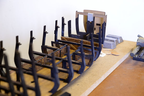

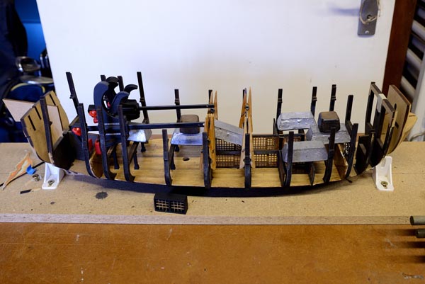

Hi All,

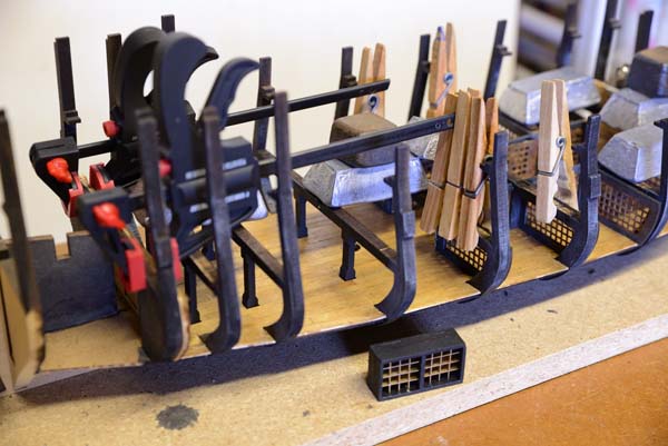

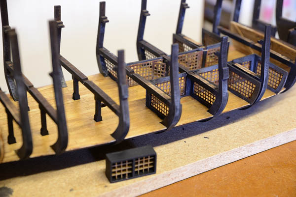

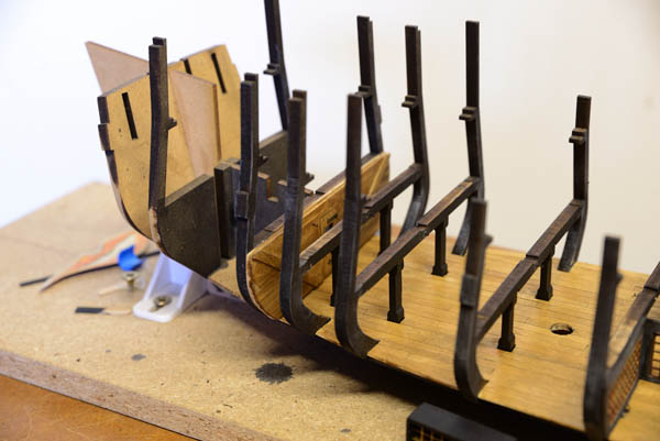

Painted and fitted the lower deck bulkheads and end walls. I painted and fitted the lantern hooks as per the instructions. No curve balls here. Everything went well according to the instructions.

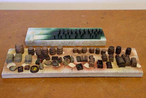

#98 Posted : 24 October 2017 09:15:36
Hi All,
Back on the Pearl again after a busy month at hte office.

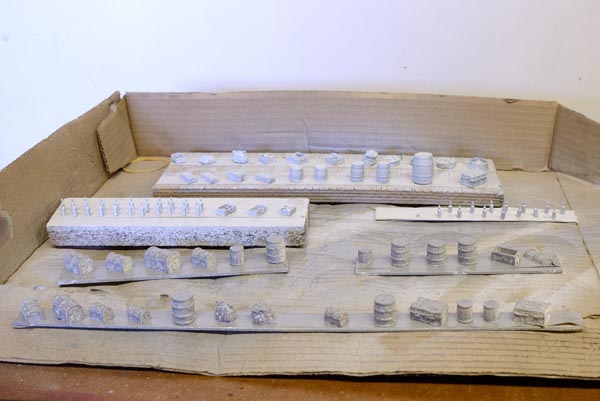

Primed the bottles, barrels and containers. I used spray can primer here. Metal primer for the cast bits and plastic primer for the resin pieces.

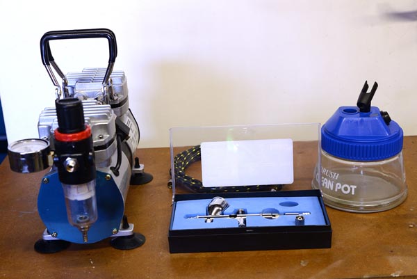

A gift to myself; a bought a cheap compressor & airbrush. The compressor is designed specifically for airbrushing, it has a three pole switch, off, on constantly or on only when air is consumed. They are Chinese copies, but are about 1/5th the price.
I have been reading up on making your own washes and it seems quite easy. They are basically artists inks diluted in a solution consisting of various ratios of distilled water, matt medium, dish washing liquid and Rinse Aid.
Once the paint has dried I either brushed on the wash, or dunked the parts into it and wiped off the excess.
Trial #01, About 25ml distilled water, 10 drops black ink, 10 drops matt medium – barely covered, had to add another 10 drops of ink.
Trail # 02, 25ml Rinse Aid, 10 drops black ink – worked really well but dried gloss. My next attempt will be using the matt medium as a base.
I will keep updating my findings until I get it right – hopefully.Blushing

Looks good Garth, am sure you'll have fun getting the best out of your airbrush....Cool Cool
#100 Posted : 24 October 2017 10:08:38
Those ships stores look fantastic.
Really nicely painted and will add so much more detail to your ship model.
