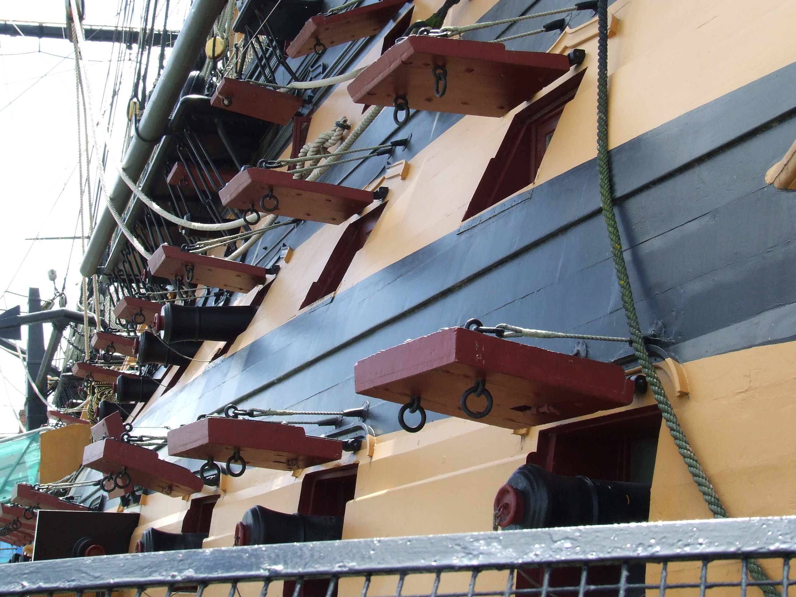

Here is how I am planing on doing my Gun ports. I will cut the holes 13mm instead of 12mm then using 1x6mm lime strip will line the inside of the gunport with 1mm over hanging the front. Gluing with thick super glue. Then sanding flush with the front. Here is the result. (the real victory seems to not have a lip on the gunport so I haven't added one.
Jack Sparrow
#87 Posted : 17 September 2010 20:29:10
I found a pick that shows the gunports have a recess allowing the covers to fit flush in the hull as a sort of seal. Might be wrong and this is how its done now not then!!BigGrin BigGrin

That is correct Jack Sparrow, the only ones to my knowledge without the rabbit are the ones without gun port lids

Does this pic help for the gun port rabbets or whatever there called
