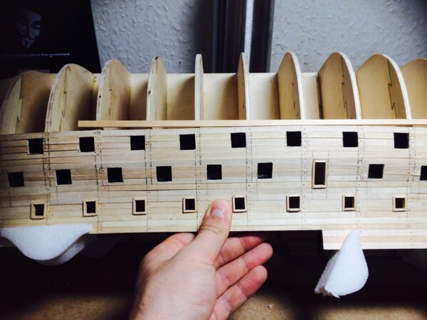

Hi William, I cant really see what you mean from that one pic, but from what I can see it does look like you can add the next row as normal. If you find you need to force lateral movement in the bow plank then you will need to add a dropper.
Unless I'm missing something in the pic?

Thanks Steve-o. Purhaps this demonstrates this better.
William's Build attached the following image(s):

Thanks Steve-I so just to be clear, the whole line doesn't have to be perfectly straight as long as it all marry's up ok? I'll have to vertically bend it slightly when I'm at the bow end.....
Yes, that's right - the planks dont have to be seen to be a straight line when viewed from the side, they may curve up toward the bow.
The planks will bend laterally in a gentle curve but if it needs to be forced then this is where you will need to follow alternative measures as mentioned in the mags.
