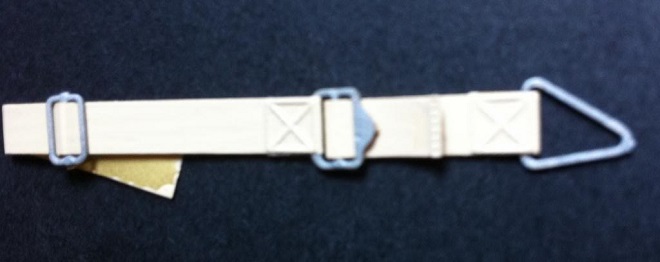

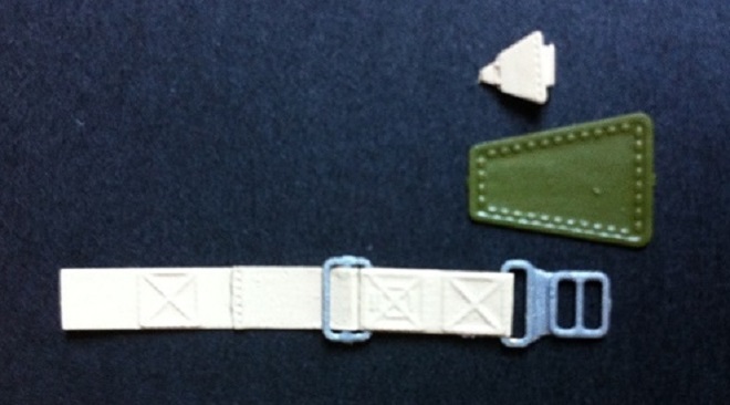

This is the build of the pilot`s harness.
The first part to be constructed is the right hand lap belt.

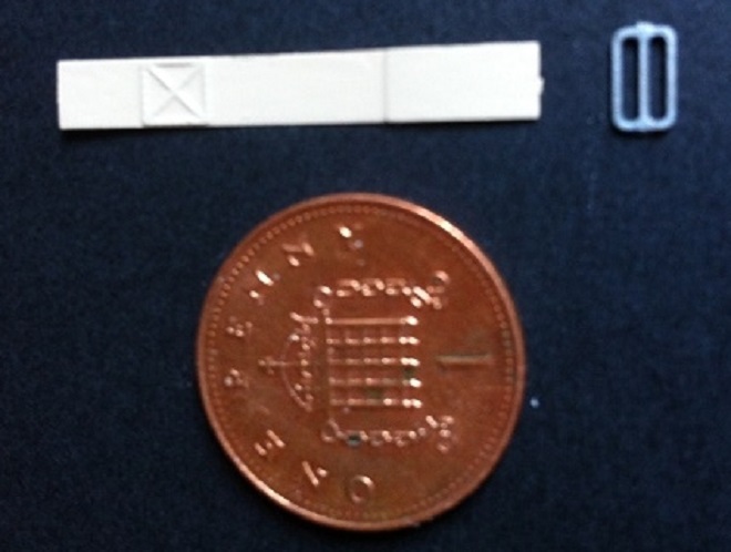

Number of parts, seven.

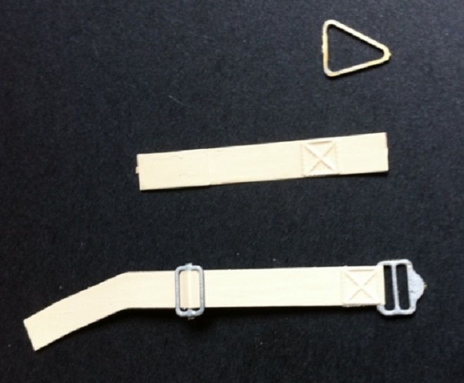

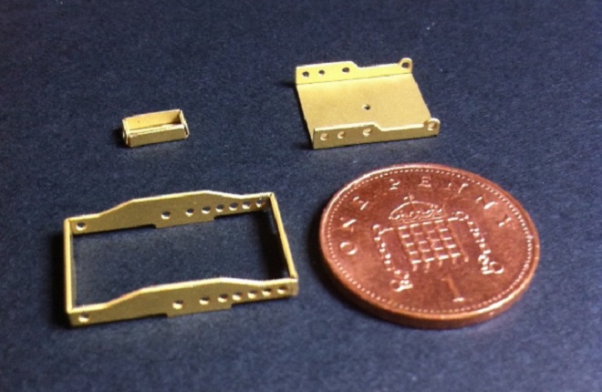

Size, take a look. LOL First parts. Pic 1
Now the folds on these parts have to be very accurate, as they depict straps folded onto themselves and then stitched together. No margin for error, because once folded on this scale of brass I don`t think you`d be able to refold. (These parts are 0.2mm thick)

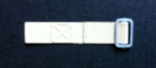

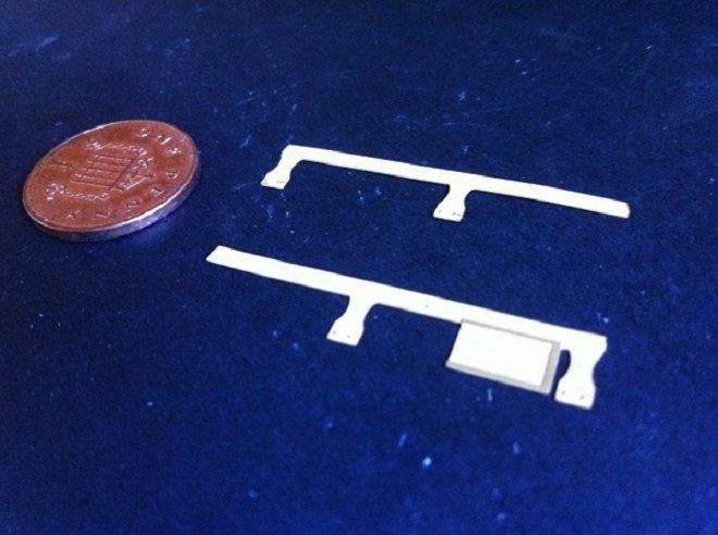

The first result. Pic 2

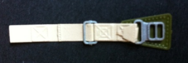

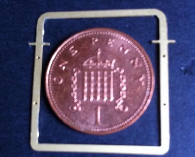

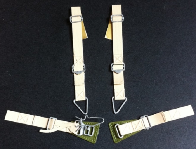

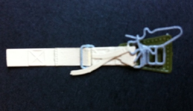

Things start adding up now, the next parts. Pic 3

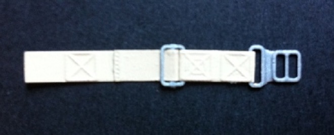

Both ends of this strap have to be bent back on themselves, so I put in 90 degree bends, then fitted , continued the fold and glued. Pic 4
That pic shows the first stage of fitting and the next one shows the end result, with the lower buckle fitted. Pic 5

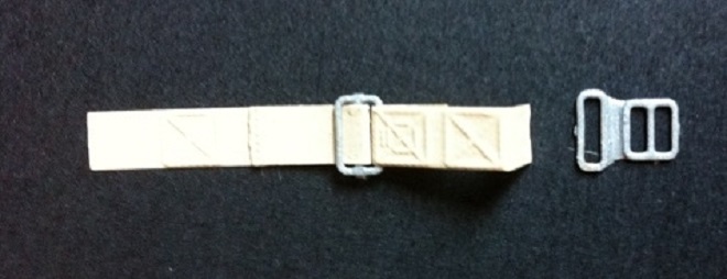

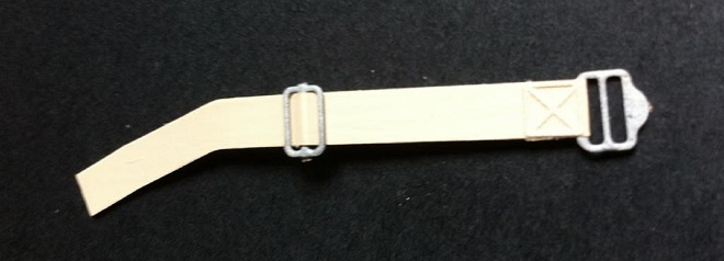

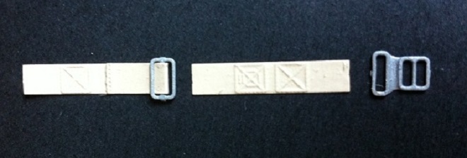

Two parts to be added in the next stage:Pic 6
The smaller part (light stone in colour) has to be bent to fit inside the buckle. Then the Khaki Drab part is fixed behind. Pic 7
Just one more part to add to this strap.
So, the final pic of one of four straps. Pic 8
I have taken over an hour, to make sure that the parts above have been assembled to the best of my ability.

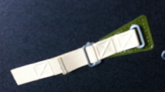

The right hand one is the mirror copy, so with both constructed and the two lap belts, here`s the completed harness.
Only thing to do is to fit them to the seat, but some painting to do first.
Result. Pic 5

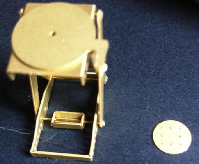

Hi All, BigGrin BigGrin
So here`s the next installment.
Issue 12 "The gunners seat Blink
"Rather him than me" LOL

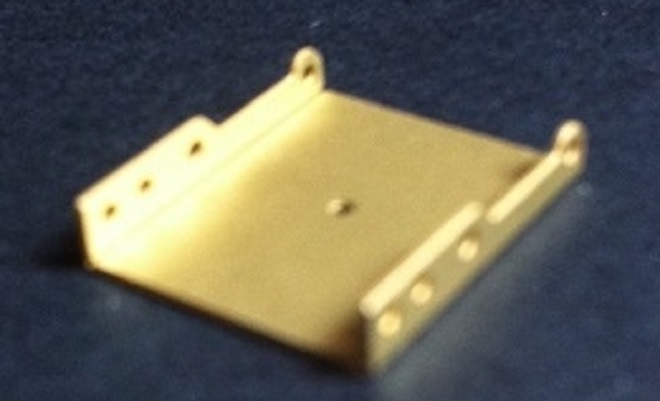

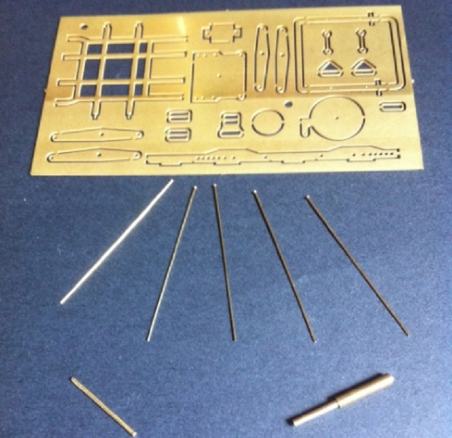

The parts. Pic 1
To construct this the way the instructions show, I`d need to be an octopus.
LOL LOL LOL LOL LOL
On the grounds that I wasn`t the last time I looked, I fixed it together in a way that worked for me. Blink

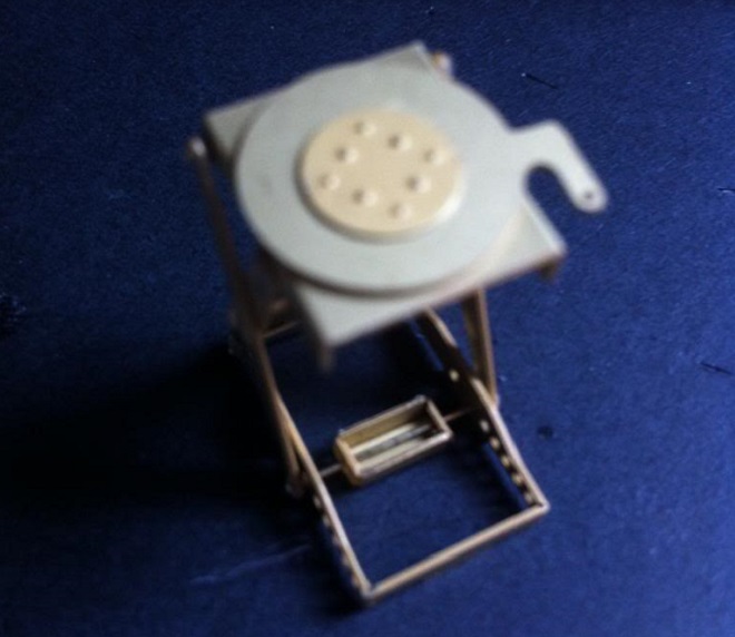

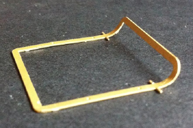

Now, several of the parts of the gunners seat have to be bent to the correct shape.
Some have pre scored bend points and vary in size, others have to be formed in an undefined arc to fit where the instructions show.
So, here`s the easy bits. Pic 2
Bring in the hold and fold 5.5, for all of these parts. Pic 3
The next part is shown partly folded, but if you look at the right hand end plate you can see a hole. A matching hole is in the other end, so folding has to be accurate so the micro thin rod fits through without any problems. Pic 4
Having finished the folding this is what you end up with, but the pic is a bit fuzzy trying to show the scale. Pic 5

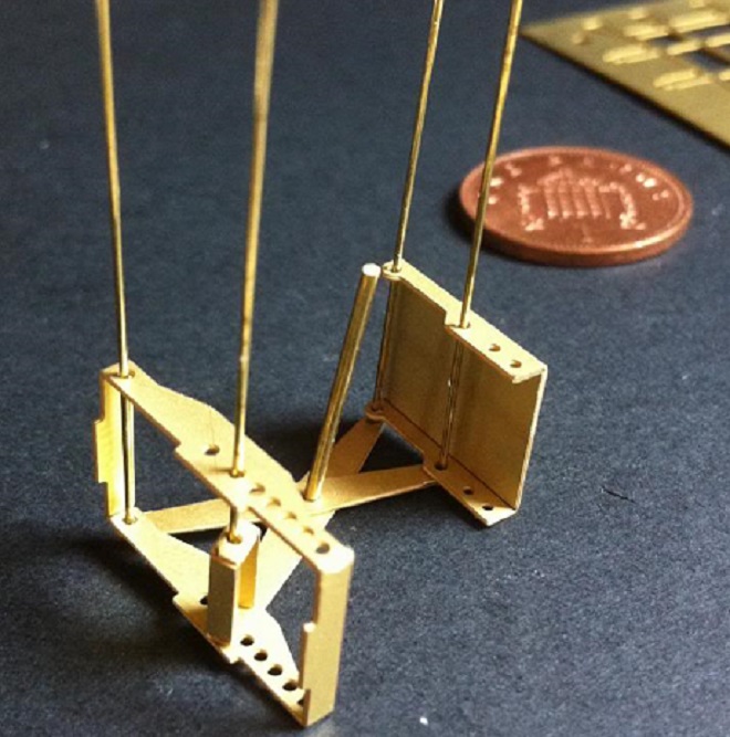

Next part gets a bit larger (not a lot) and requires folding into a box section, the two free ends being glued together. Pic 6
This is a pic of the parts assembled/formed at this point. Pic 7
It`s at this point that the long brass pins come into play.
These form the pivot points of the seat base, they have to be glued to the seat support arms, but not any other parts. Crying Crying
I applied glue to the back of the pin head with a toothpick, pulled the pin through the holes to locate the seat arms flat, then moved them gently away and let them set at right angles.
Having put a pin in each end of the seat arms for one side (watching for correct orientation of parts/part numbers, you need to form everything up to accept the seat base arms on the other side.
Bring in the "OCTOPUS". LOL LOL LOL LOL LOL Pic 8
It`s now time to get everything straight and fit the lower seat arms on the other side of the seat, to include the straight fitting of the pins and centre rod of the seat base. Pic 9
So with that done, my move was to make sure that everything was straight and square.
The next parts start adding to the seat structure. Pic 10
The last pic shows the first disk plate added and the second to the right side.
Next the part to the right fits in the middle of the main disc. Pic 11

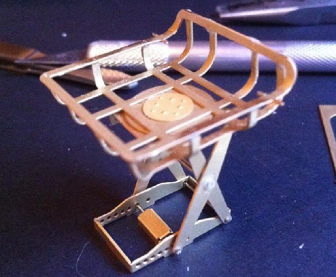

From here on in,I`m assembling the "basket seat" for the gunner. Pic 12
The part shows the top frame surface of the seat.

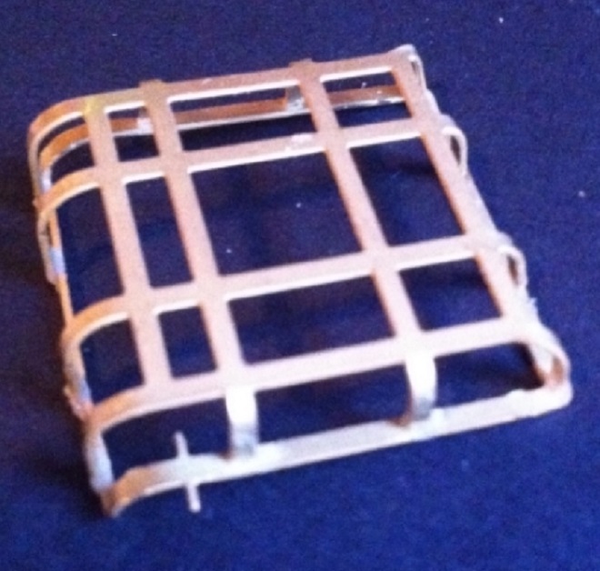

This is formed into an arc at the back edge. This allows for the lower basket section to be folded and make the main seat section. Pic 13

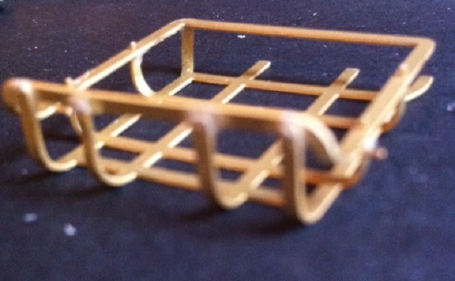

The lower basket section is a one piece unit that needs a lot of freehand bending to fit the upper rim. Four pins set it square. The curved parts of the lower seat have to be formed to meet the upper frame. Pic 14
When all of the lower basket arms are folded up and stuck in place you end up with this result. Pic 15
This is the inverted pic of the seat panel, as it shows the bend forming required.
When you turn it up the right way and fix it to the seat base the final result to this point is shown here.Pic 16

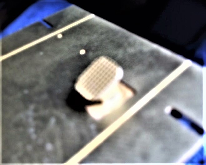

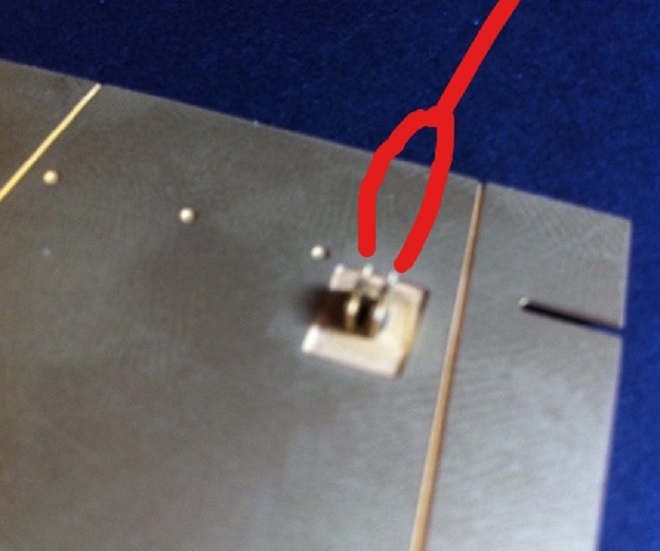

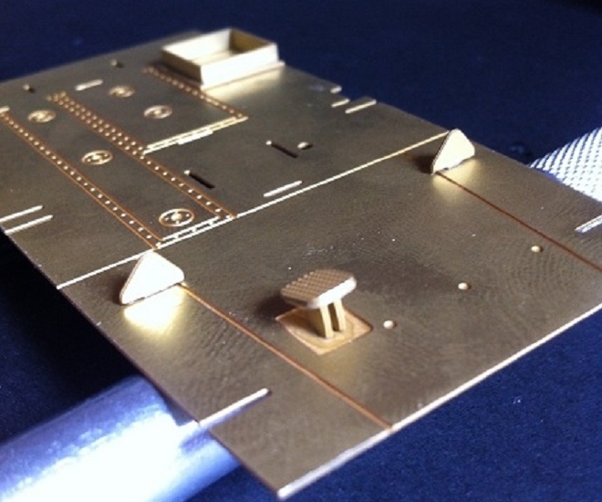

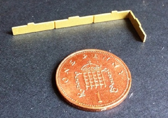

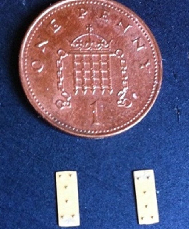

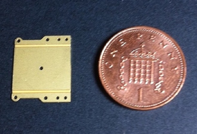

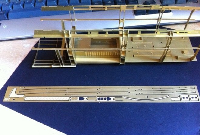

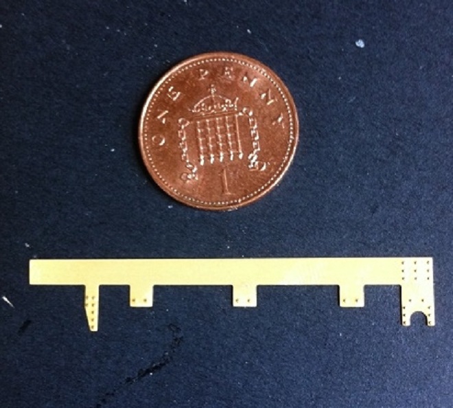

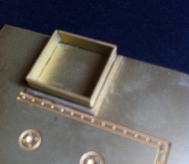

So, here`s a pic of the brass fret. Pic 1
The detail, in this floor plate of the rear gunners position is FAB.
Close-up. Pic 2

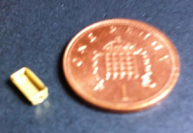

Ok, sorry that`s the big part, back to the mini parts,Glare

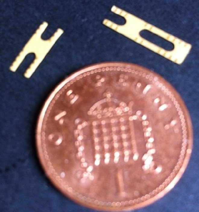

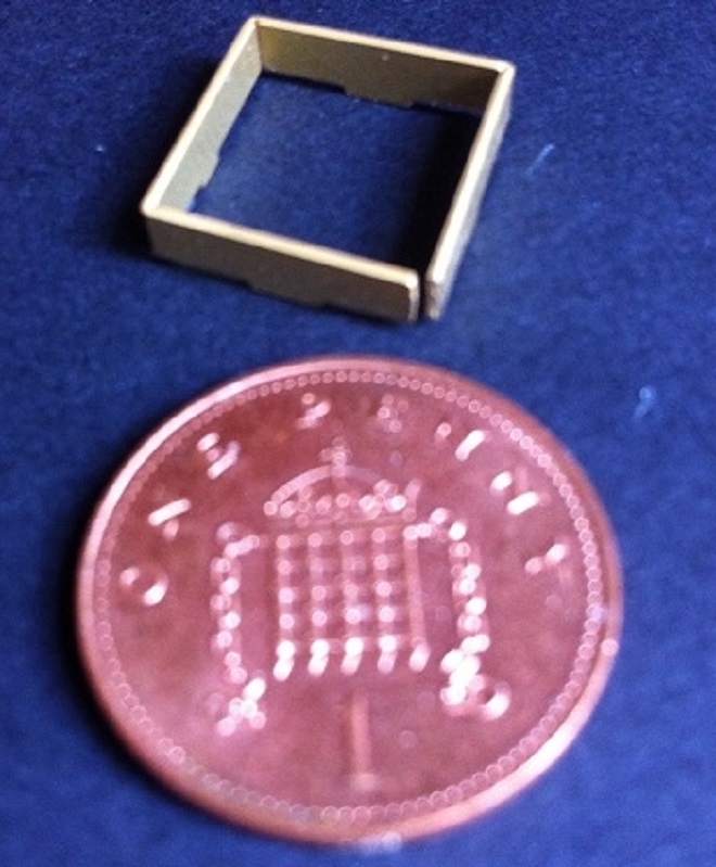

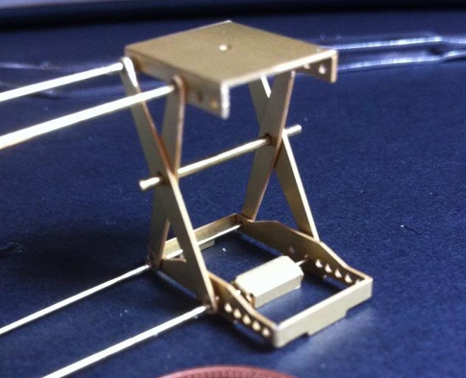

The base of a box section, I think.(more to add later)Pic 3
The previous part gets fully folded and glued shut to form a square.
This has four locating lugs to secure to the base plate.Pic 4

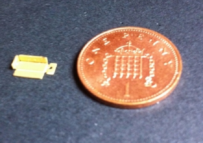

So, when the box is closed and glued it`s fitted into the relevant place on the gunners floor.
A trim piece is then added and the result is as follows. Pic 5

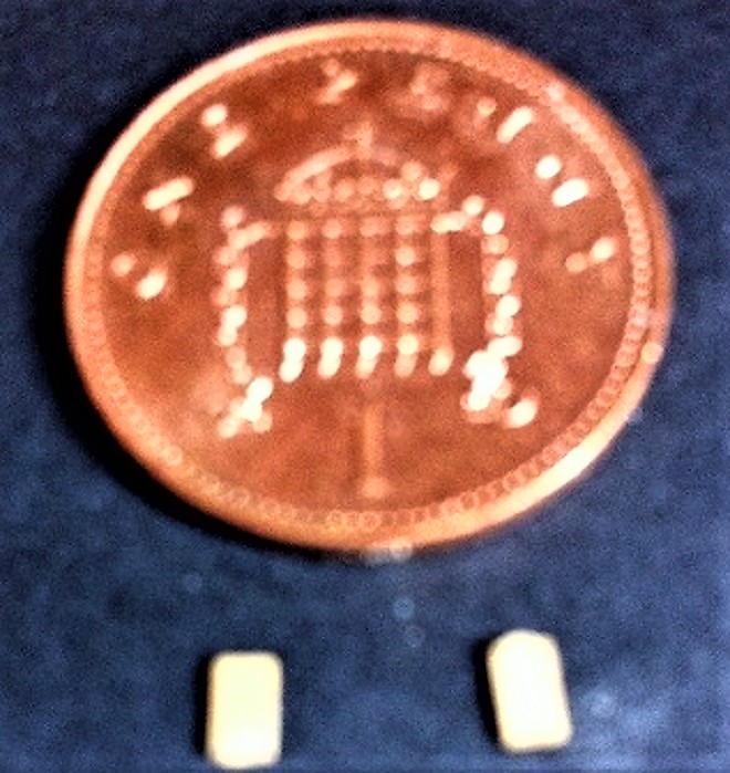

This is followed by two very small parts that form a pedal lever.
Photo not good, must invest in a close-up camera,but here`s the next stage. Pic 6
So, with the lever base in place, the pedal foot plate is added and then followed by a patterned non slip plate. Pic 7
Sorry pic is fuzzy, but Iphone close-up not good.

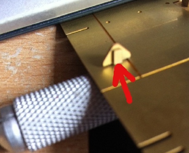

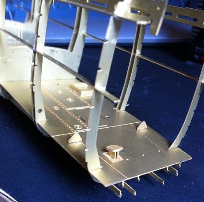

Two triangular parts are added to the floor. Pic 8
The last two parts must be set at right angles to the base plate, as two small parts are added to these prior to being painted and having other parts added. Pic 9

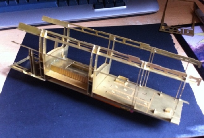

With these parts added, the whole frame and added parts are positioned and stuck to the main air frame. The small parts first. Pic 10
The whole assembly is now added to the air frame. Pic 11
This was a dry fit and just as well as there were a few high spots that needed a very slight filing, to get everything flat.
(0.25 mm at worst).
That done the final fit took place. Pic 12

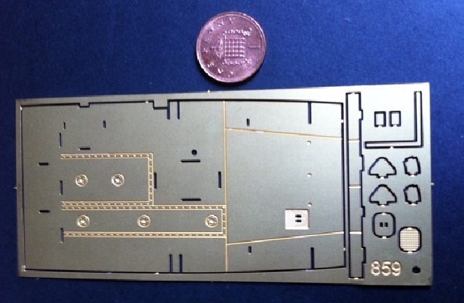

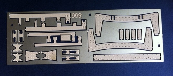

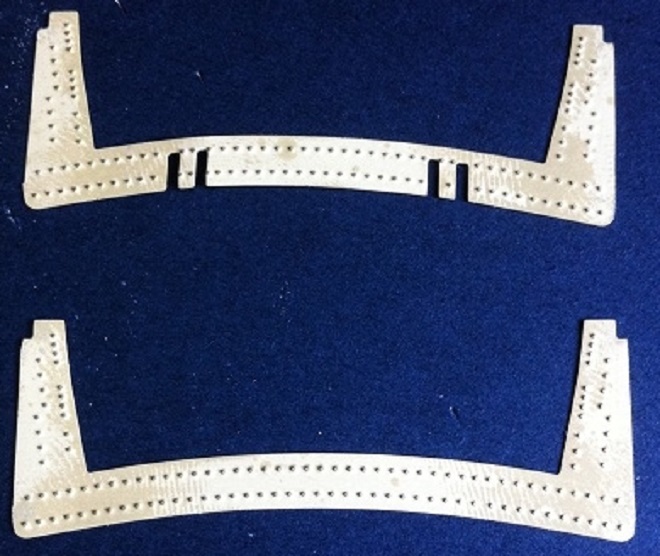

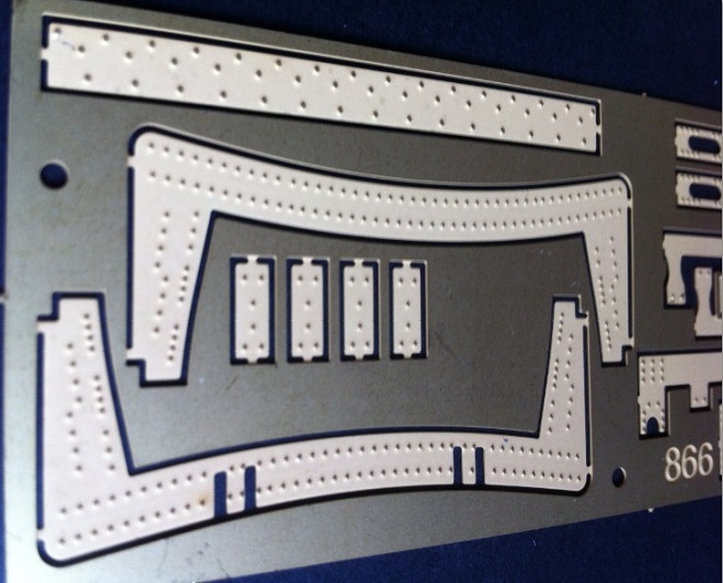

Issue 14, takes on the detailing of the air frame, with the addition of riveted plates for extra detail.

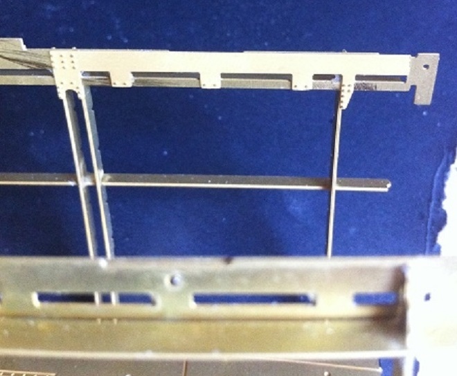

The brass fret. Pic 13

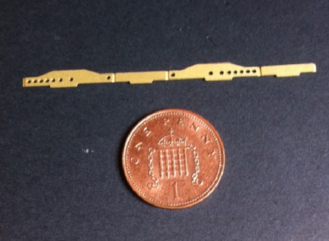

For a close-up of the detail. Pic 14

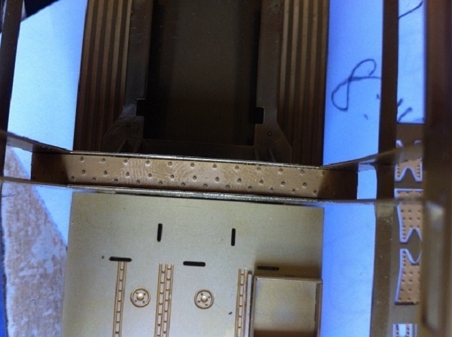

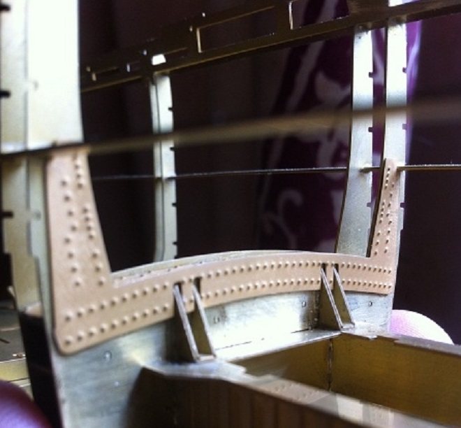

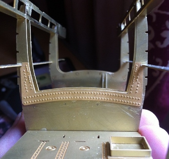

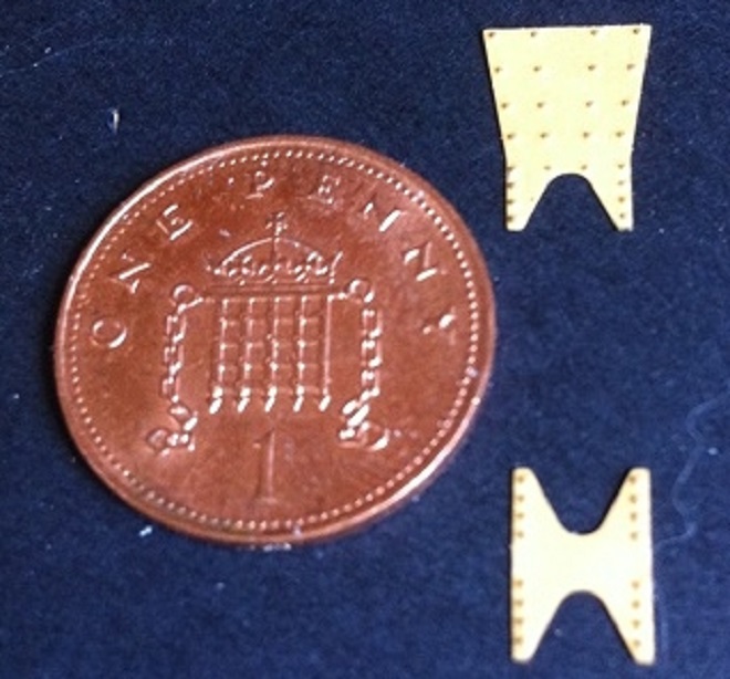

So, you`ve seen the detailing parts for issue 14.

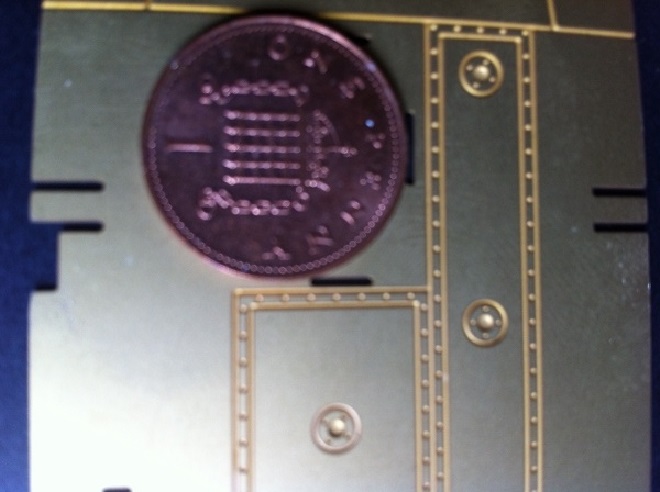

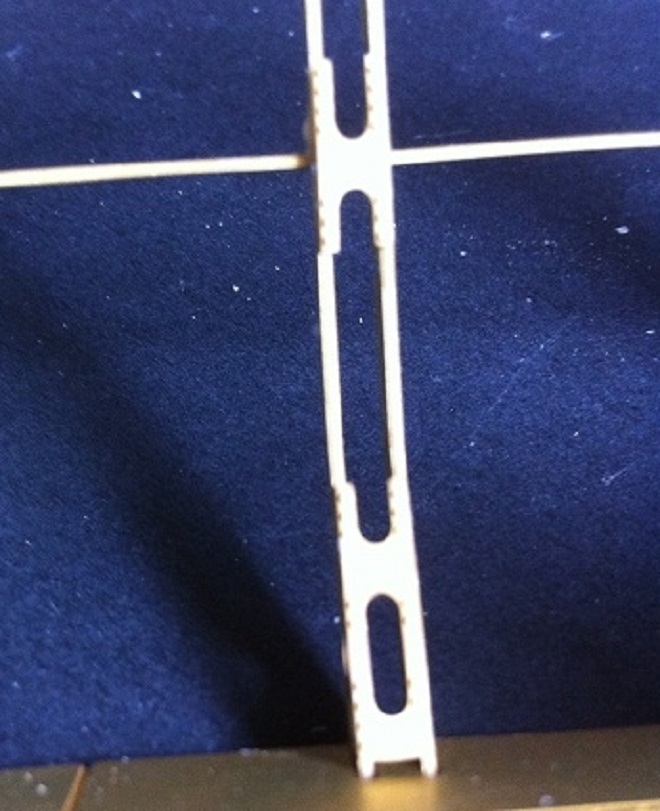

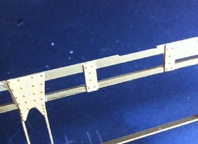

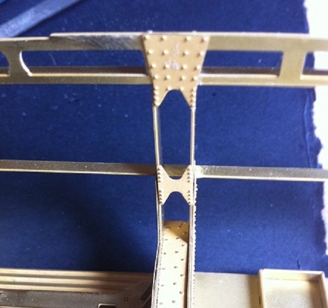

These parts give the rivet detail to the bulkhead between the pilot and rear gunner, plus the bracing plates at other double rib sections. In addition to that, there is also additional detailing for the top rails.
The following pics will show the parts and where they are positioned, but where parts are duplicated for both sides of the fuselage, I will say so.

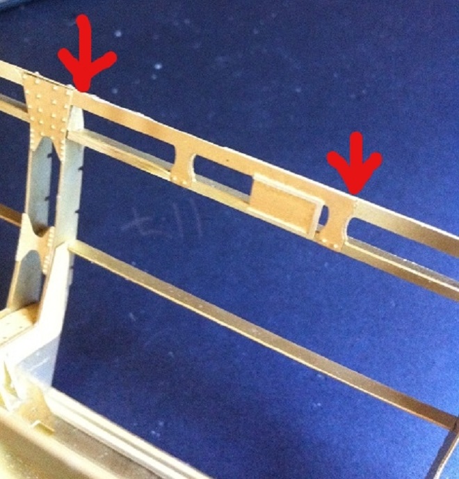

The first pic, shows the top plate detail in place between the two sides of the bulkhead. The part has to be slightly curved by hand, so as to fit to the curved surface it has to stick too. Pic 1
The two parts in the next pic, fit to the same bulkhead, but one each side, obvious as to which is which by the cut-outs to fit around the support brackets. Pic 2
Here`s pics of the parts in place. Pic 3-4
That`s the larger parts done, now we go small scale again!!
These parts are reinforcement plates for the air-frame and they are duplicated for both sides, so will show one side only. Pic 5
You only have the thickness of the brass frame to stick some of these parts too(0.75mm), so gets a bit fiddly getting these in place.Pic 6
So, with both sides done, we move onto the next parts(also duplicated).
These parts are fitted to the frame in the middle of the rear gunner section of the air-frame. Pic 7
It was at this point that I returned to "Google Translate".
The part with the open ends is not symmetrical, it has three rivets at one end(either side) and four at the other. So having translated the relevant info, I was no further forward as it don`t tell you anything relevant. Confused
So, took magnifying glass to the mag pics and the three rivet end is the lower end of the part. Here they are fitted. Pic 8
At this stage we have eight parts to install.
All parts are fitted to the top rail of the air-frame.
Four and then two identical and two generic to the relevant side of the fuselage.
This is a pic of two of the four parts that are the same and they fit on the top rail, within the forward part of the rear gunners section of the air-frame. Pic 9
Fitted like this on both sides. Pic 10
We then fit the two end rail enhancements. Pic 11
This is another duplicated part , so here`s one fitted. Pic 12
Ok, so that leaves two parts that are not identical. Pic 13
These parts are fitted to the top rail within the pilot`s section of the air-frame.
Bit hard to see, so part fitted between the red arrows and alternate part fitted to the other side. Pic 14
So, that`s the end of issue 14, that`s 10% of the build done and only the cockpit built, with still more to come in that section.
Here`s the part fret for issue 15. Pic 15
The above parts add more detail to the pilots area of the cockpit and two stringers to the air-frame.
