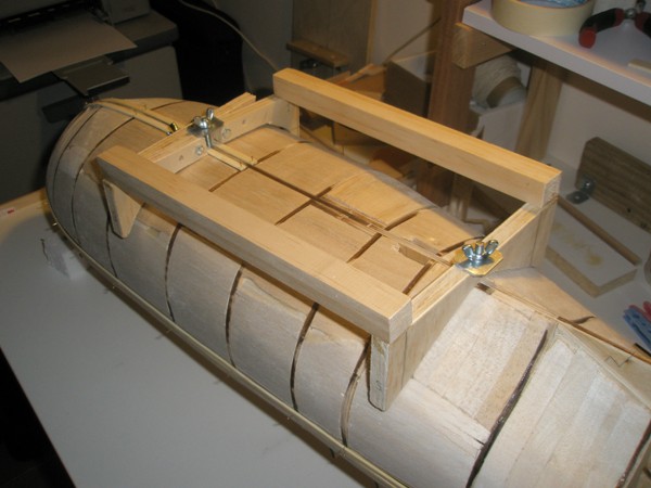

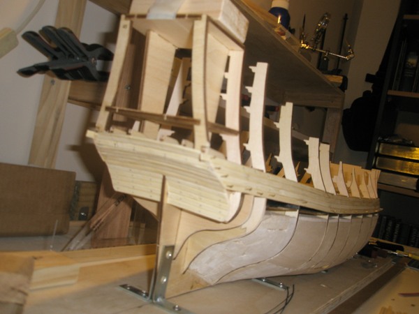

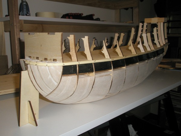

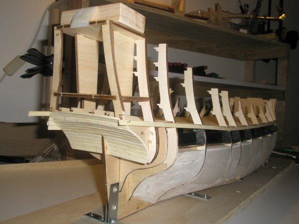

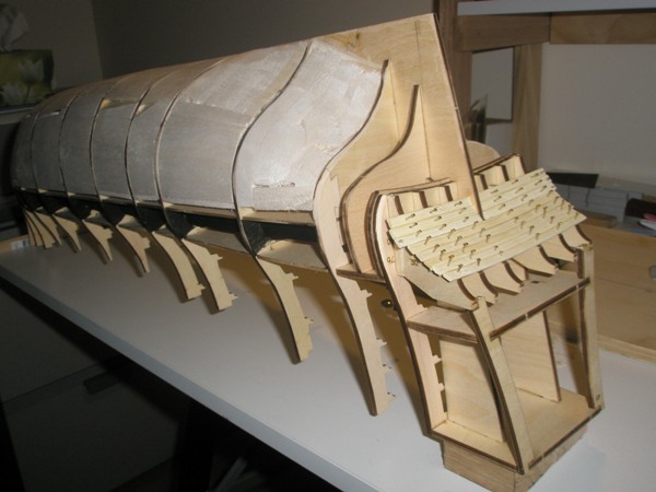

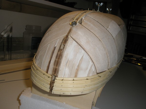

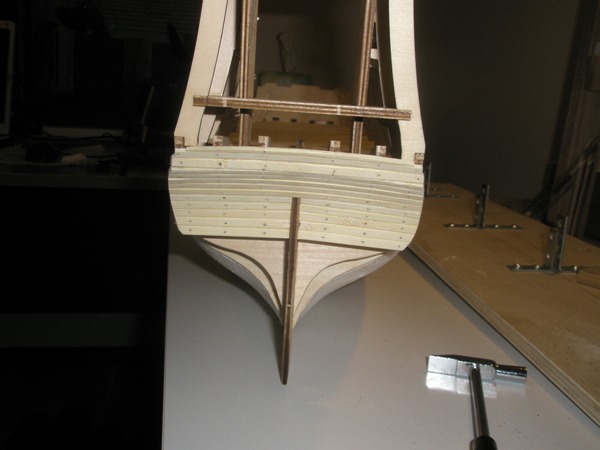

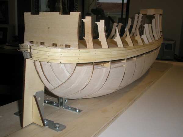

Hi All

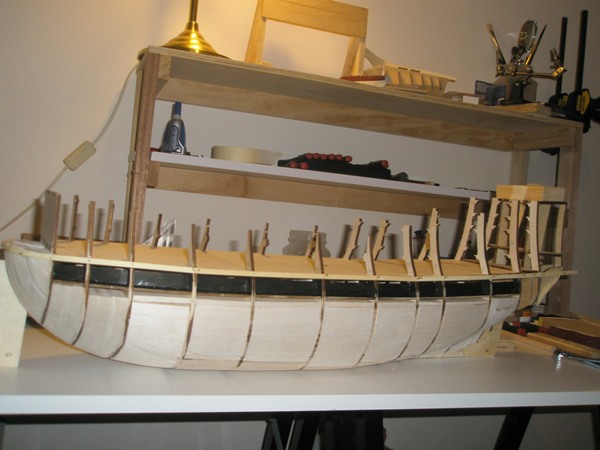

Progress, July 2014 in pics below;

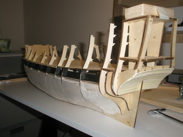

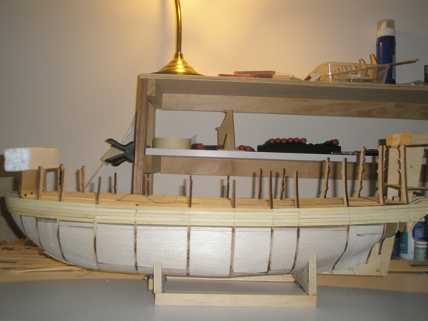

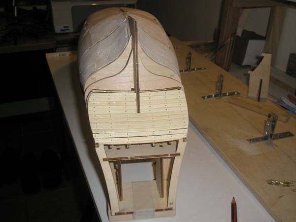

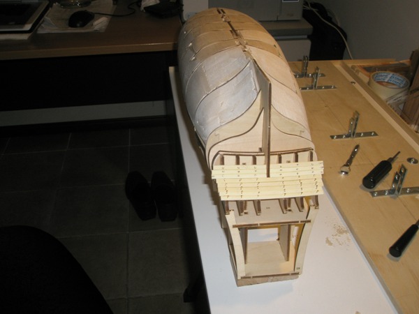

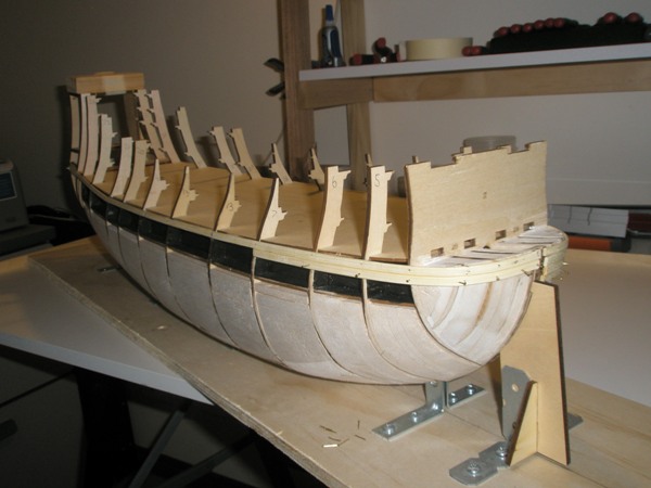

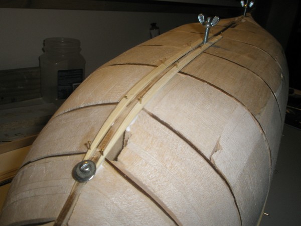

Hull planking was easier than I anticipated, but I found tapering them was a bit worrisome. BigGrin

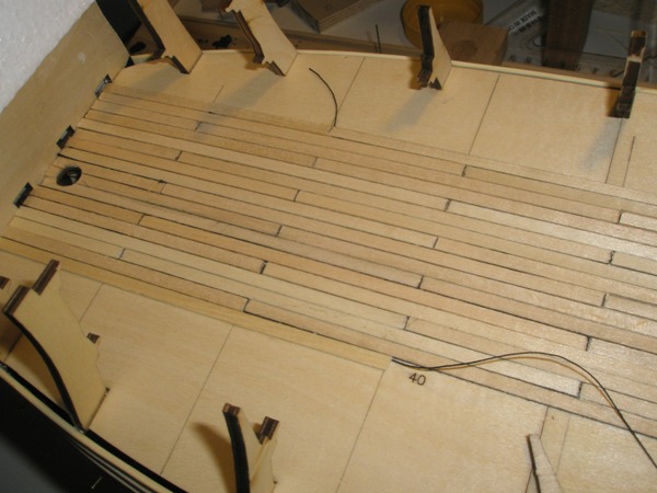

I've done a bit of trial deck planking on the second deck - with a number of different caulking techniques. The black paper looks a bit too "heavy" and is difficult to control when installing. It's shown in the pic below the mast hole. The B pencil method whilst simple to apply, looks a bit scrappy (the section above the mast hole in the pic.) The 0.5mm black thread method is all at the stern end of the deck and looks a lot neater, but is very fiddly. I will do the tree nailing with a B pencil.Cool Cool
I had some bother with the first garboard planks - I didn't cut the bending grooves deep enough and so had to come up with a clamping solution, hence the little screw with washers until the glue cures.BigGrin BigGrin

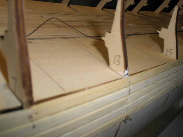

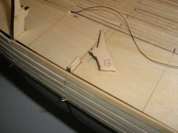

Accidentally broke the top off rib 13 port flush with the deck, Blushing Crying, but luckily it broke quite cleanly in an almost perfect slot and keyway configuration so filled the slot up with glue and poked it back in - making sure it's at right angles. The hull planks on one side and dummy cannon support on the other will further reinforce it.

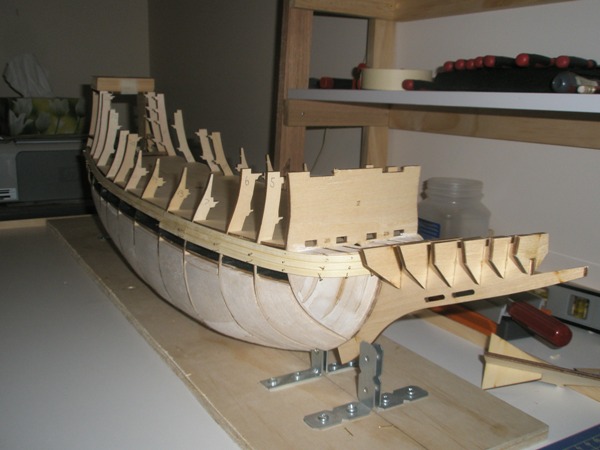

Now the dry dock is redundant I've made a temporary cradle using the previously installed fixing studs. The wing nuts make quick and easy to remove and refit.Cool Cool
JohnP

Looks like repair job on 13. If you check my thread I had to do repair on one rib as well. It turned out good as new. Just ensure clearance for next deck beam and deck when you brace it. BigGrin

#93 Posted : 26 July 2014 09:58:28
Nice work there John, love the build cradle.... Think you will find the tapering will become a lot easier as you progress into the build, the more you do the easier it will become... Decking looks really good and although using twine as with black card is a fiddly process, I think the results are well worth the effort. The deck you are working on will not be seen so use it as a practice session to perfect your technique and also to help you decide on how it is going to be finished in terms of colour/staining etc. Remember with the planking, let the strakes lie the way the want to and not force any into place, any gaps that appear can be filled with tapered pieces..... Cool Cool .. Look forward to seeing more...

John Passmore
#95 Posted : 27 July 2014 04:24:31
Joined: 25/04/2014
Posts: 374

I've repaired rib 13 in the 2nd of the photos. I saw your great repair job earlier but as my piece had snapped off almost flush with deck level, the use of bracings were not an option. I'm hoping that hull planking one side and dummy cannon support on the other will be sufficient reinforcement...Cool
The are a few errors in my trial deck planking, but rectification is not necessary as it's all covered in. Hope you find the pics useful when you start deck planking. I followed Mr Gandales' excellent tutorial from page 16 of his thread...BigGrin BigGrin Cool
The deck planking is Basswood, sourced from Float-a-Boat at about $8.50/pack. 1m lengths. Great stuff to work with - much easier than Bamboo! BigGrin BigGrin

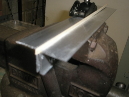

Hi Alan
Thanks for looking in and complimentary comments - much appreciated..BigGrin
Glad you like my rudimentary cradle - wouldn't pass muster at a cabinet makers' convention but serves purpose in this instance! LOL
You would have noticed several errors in my trial deck planking sequence, but I've not bothered to rectify as I know it will all be enclosed later. I've been considering the finish colour/staining and leaning towards NO stain colour and just a very light sanding to leave the bare boards. In my younger years I was a merchant seaman and one of my first ships was the old Stirling Castle (25,000 tons of oceanic splendour) built by Harland & Wolff Belfast - no air conditioning , no heating but beautiful lines. She had all Teak decks, including the well deck which was completely covered. The planks, (from memory) were about 8 inches wide and caulked (about a 1/4 to 3/8 inches thick) with a black tarry substance. These decks used to be scrubbed regularly by the deck crew with big stiff bristled brooms and big square stones using sea water pumped up through hoses. Then the decks were just left to dry and bleach in the sun. I'm sure that the old sailing ships' decks would have been treated in the same manner and looked very similar...BigGrin

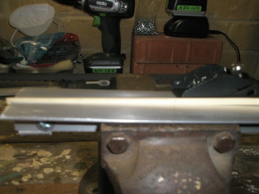

I made a little jig to assist in cutting/shaping the hull planking. Works well. picture below.
John Passmore attached the following image(s):
