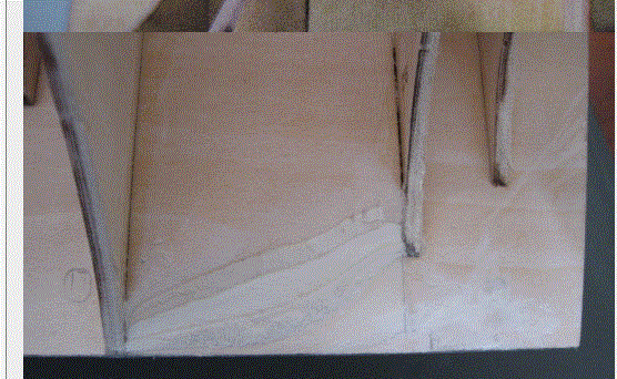

hi george,good progress so far, just a slight inquiry, is the false keel in line? the last two ribs at the stern end look out of alignment,could be camera angle,but just check. BigGrin

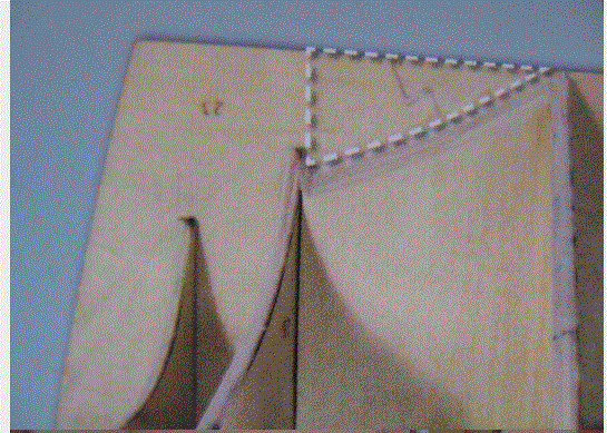

Blink Found it in the formal build diary somewhere after issue 11. Snip toll came in useful
bb1949 attached the following image(s):
Hi karl,
Re false keel what you are seeing is the recess hole from balsa inserts next to keel making dark shadow and looks line off centre. If you check some of my earlier pics from higher angle you'll see it is straight.
BigGrin
Saw the same thing myself in pic burt checking shows still ok. Pic below.
George1
Thanks bb1949Cool
Will sand away with mini grinding wheel when next rib frame comes. BigGrin

Hi bb1949
Have now sanded braces to shape for next rib. Used a Dremel sanding head. Not what you'd call easy. Would have been if loose and not stuck in place. BigGrin
However it really seemed stupid to have to go to that trouble if we were told earlier could have cut to shape. Huh
George1
Building HMS SOTS

Yes totally agree but there is the element of fun working it out amongst friends too! This is what you did for me! thank you friend!

John Passmore wrote:
Hi George
I too have completed up to Issue 7 and I am confused as to why you cut away part of the brace plate at the keel join.
Is it really the case that Bulkhead #26 does not reach the bottom of the false keel? How does this impact planking installation?
Will the planking not continue to the end of the false keel - piece #23?
Hope Mr T and the others read this and can offer some assistance as I have glued the brace plates in place.
I only became aware of this forum a couple of days ago so have got this far without assistance!! LoL as they say...Confused
Hi John
If you look at post 82 from bb1949 this page you'll get a better idea of the next rib frame finishing some 1 inch plus above the bottom of keel. The one after even higher.
Yes the planking will go to the end of the keel but there is a curvature down till it reaches what you may call the bottom flat section. If the braces were left as is then you would get a hump that the planking would have to go over if those braces are not sanded as shown in bb1949's number 82 post. BigGrin
In later issues you will be shown to sand away part of the braces over join as shown in bb1949's post. Look at issues 16 to 20 Tommick's Official Build Diary.
We agree that it would have been easier to do before gluing the brace pieces over the join.BigGrin
Hope this helps.BigGrin

Hi George, coming along very nicely so well done.... You are correct to fair the bracing piece, this is to ensure you have a smooth flow around that section when it comes to planking. An awkward process but it is needed.... Cool Cool .. Keep up the good work, will be following your progress.

Hello there George...Coming along really nice and I wish that I had known about the fairing of the bracing in advance...would have saved a lot of headaches than trying to fare them with all ribs are in place!!...Well done!!

George, there is a method behind the madness of fairing this part above. You need to dry fit the last rib #27 and gauge the profile with a bamboo plank to get the correct fairing line. It is essential that the plank sits tight and smooth at this section to get a smooth profile. It is rather difficult to fair this piece after #27 has been glued in place.
