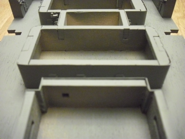

ISSUE 65 BUILD

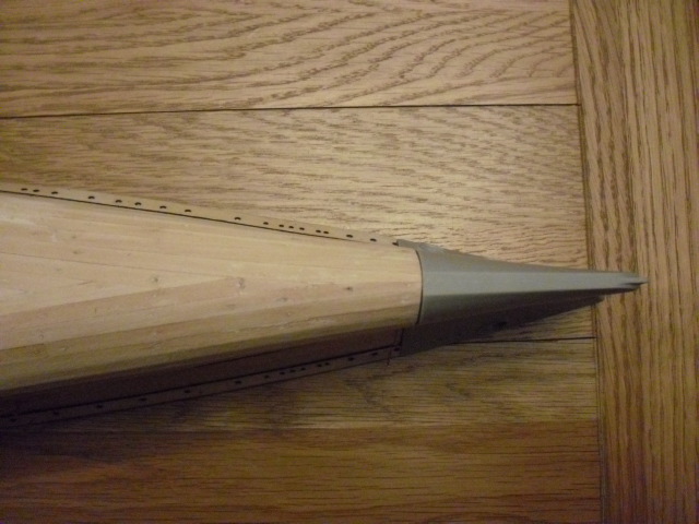

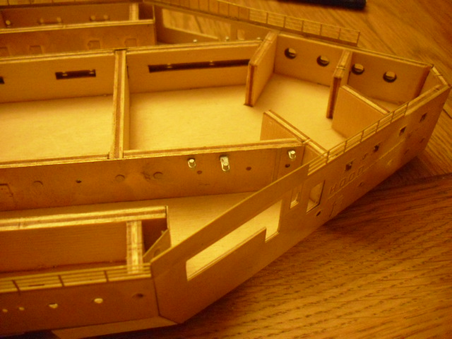

This is a photo of the underside of the fitted bow:-

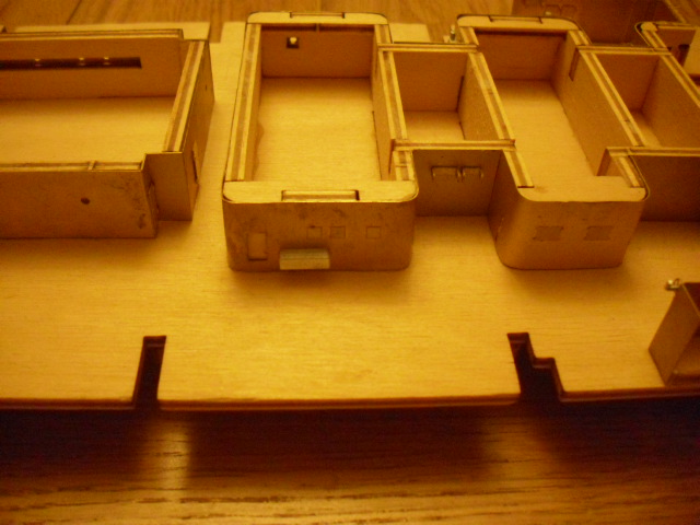

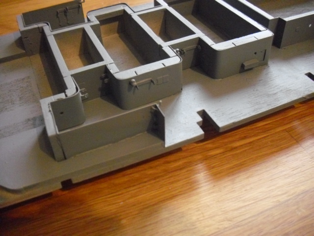

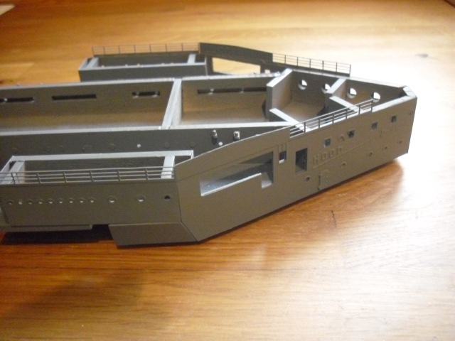

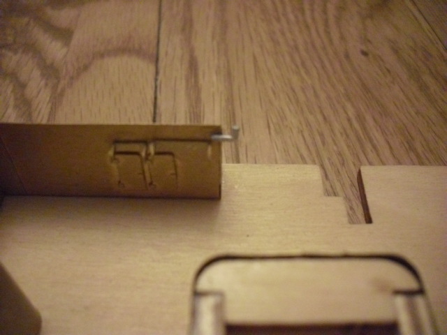

ISSUE 66 BUILD

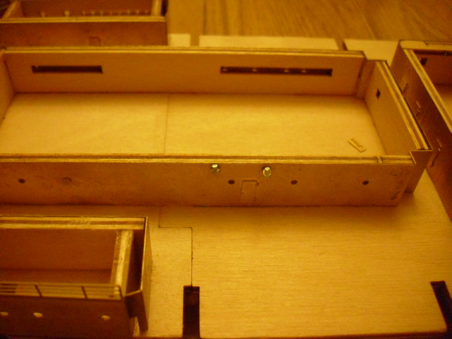

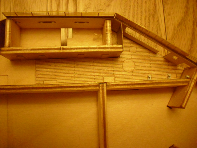

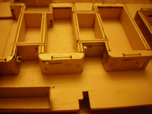

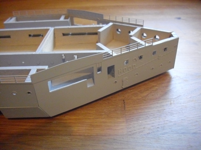

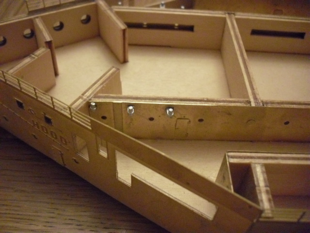

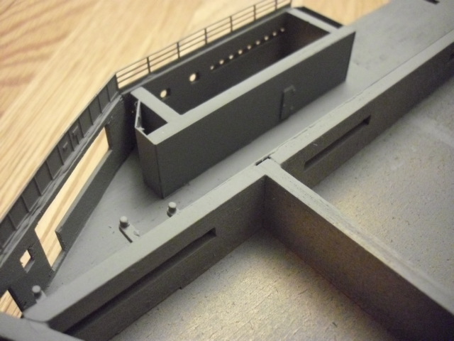

Hi Team in this build we fit some of the metalwork and pipework pieces, also fitting wall piece 360 from issue 43, I hope the photos tell the story:-

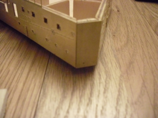

Mike, It's looking good, it will be interesting to see how smooth we can get the transition between the timber and plastic at the bow as i have reservations about a step that has formed on mine.
Good to see you back here.
Cheers
Peter

Hi thank you, sorry to hear about the step at the bow please send me a photo of your bow, for me to see the problem.
Kind regards Mike

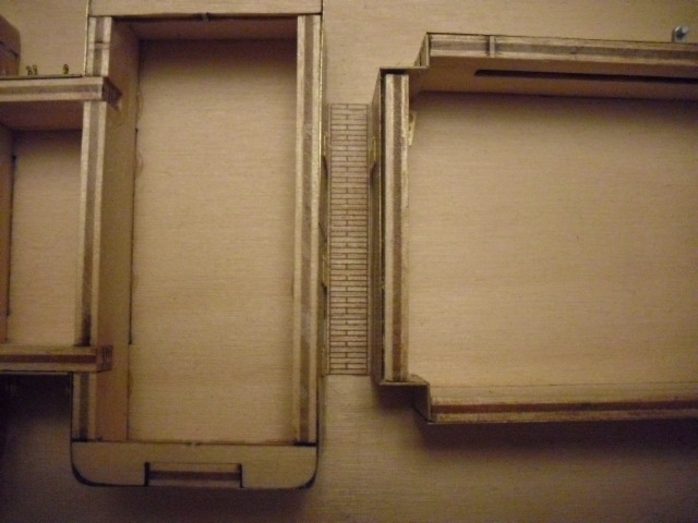

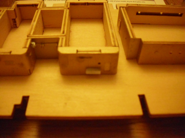

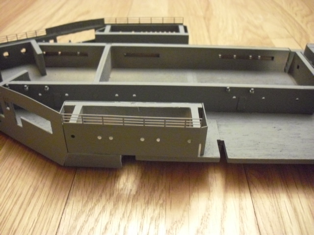

ISSUE 67 BUILD
Hi Team this is the first "MEATY" ISSUE for a while, first we fit part 361 (from part 66 ):-

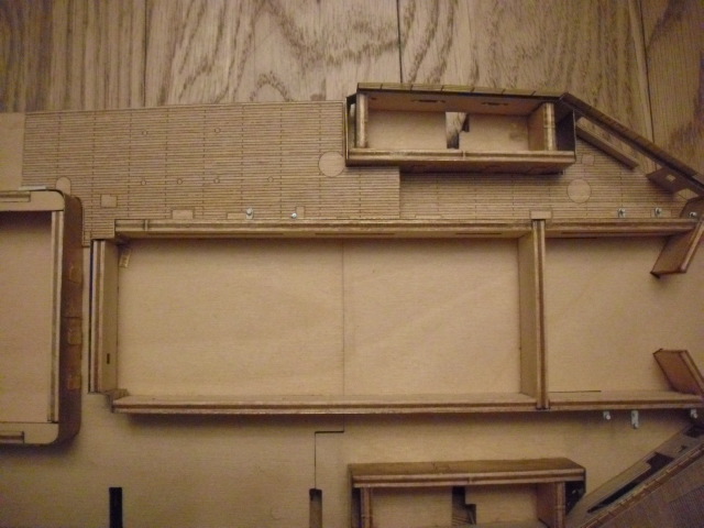

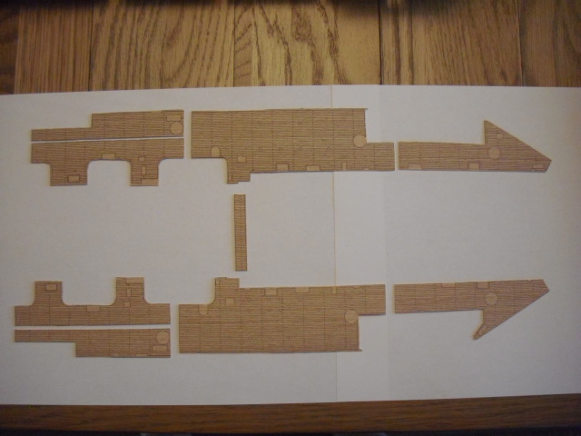

ISSUE 67 BUILD

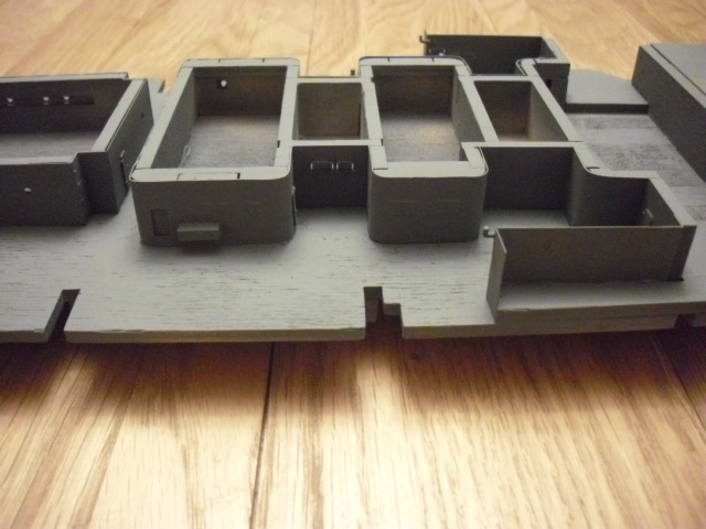

Then we prepare the decorative deck coverings, and cut to fit checking measurements all the time:-

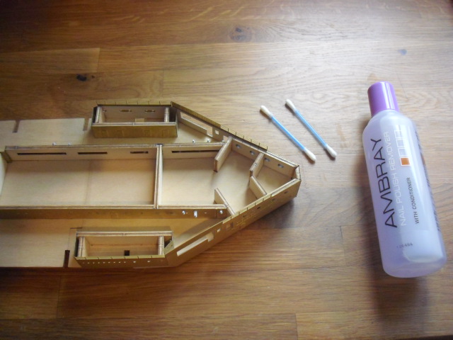

Next job is to clean the brass etch prior to painting, for this I purchased nail varnish remover for £1, and applied and rubbed the brass with cotten buds (use it sparingly, and do not get it on any plastic parts) please use it in a well ventilated room:-

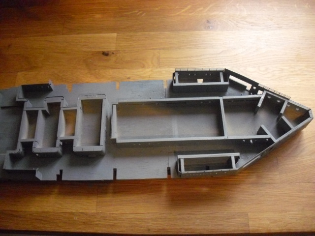

ISSUE 67 BUILD

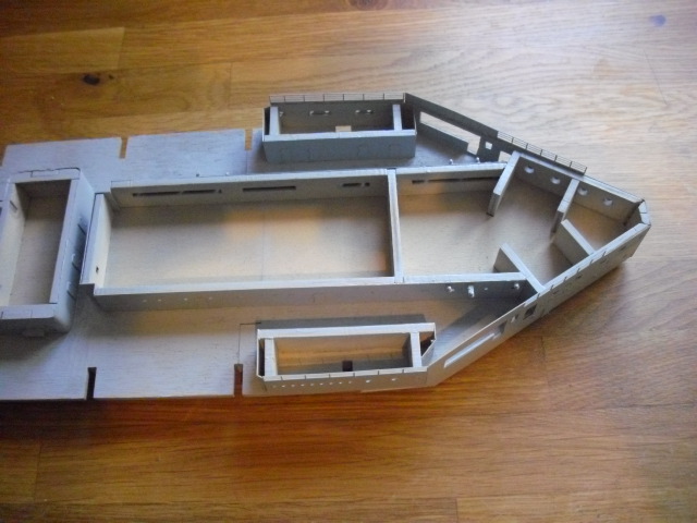

Here is the result of the primer:-

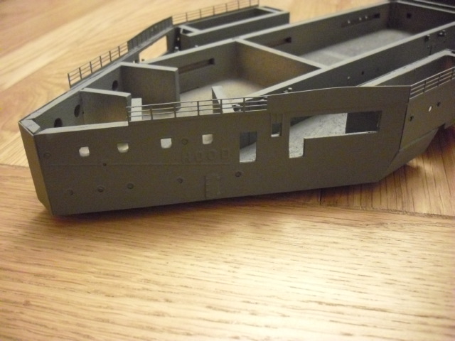

ISSUE 67 BUILD
Then of course the Humbrol Acylic Spray paint two coats in all:-

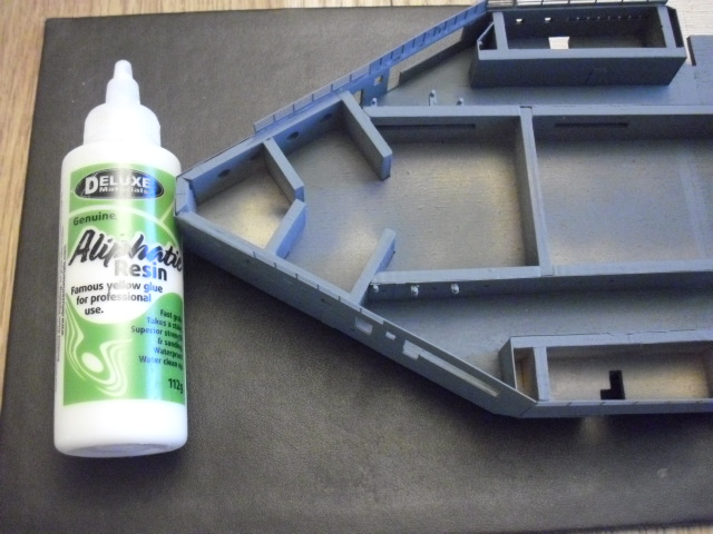

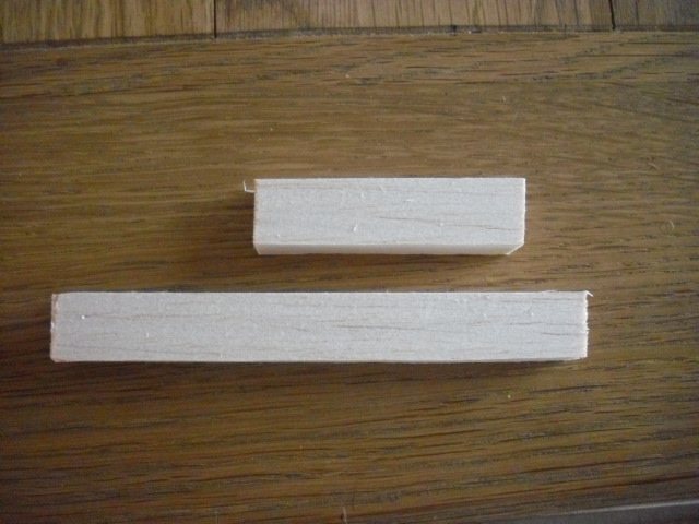

Now to glue the deck coverings ( after allowing the paint to Harden over 24 hours) I prepared some wood blocks to use with mini long bars, I am sure the photos will show how I used them, and I used my favourit wood glue Aliphatic resin:-
