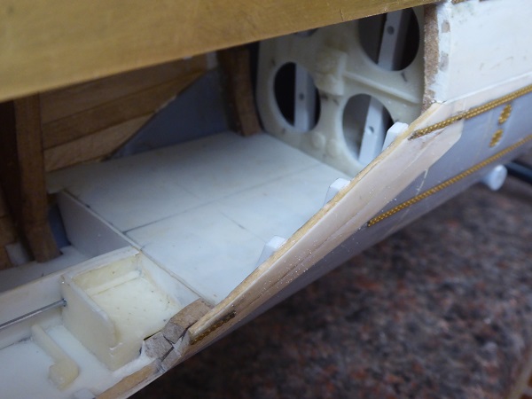

Looking aft showing the torpedo hatch and the cut-out t-frames around the well.

I then proceeded to make small sections of t-frame to fit on the lower half of the hull giving the impression that the U-boat was sliced through. It also carries on the theme I used for the other compartments as mentioned in a previous thread. I glued them oversize to make them easier to handle whilst fixing before sanding smooth and flush.

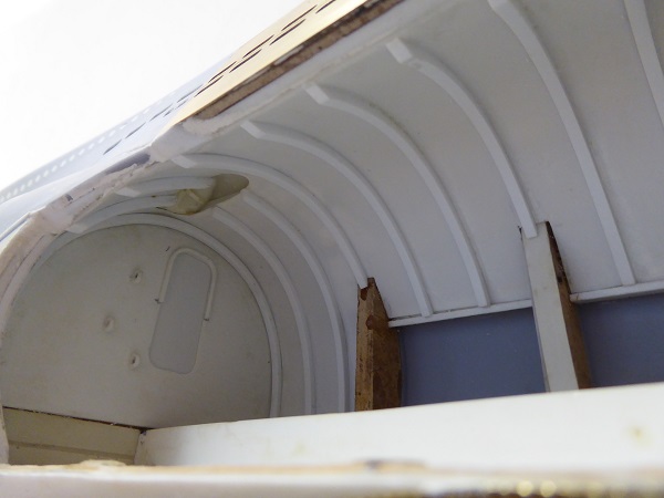

I decided to try and fit a resin AMP I bought as a set from a German supplier a couple of years ago. The part in question forms a section located on the port side of the torpedo tubes. Due to the fact that I have now fitted the inner pressure hull and t-frames, i was conscious that the diameter would change how the part located.
First job was to saw a strip from the top of the part to allow for the new hull diameter. I then recessed the top so the part would sit around the t-frames.
The attached photo shows the part with recesses. .

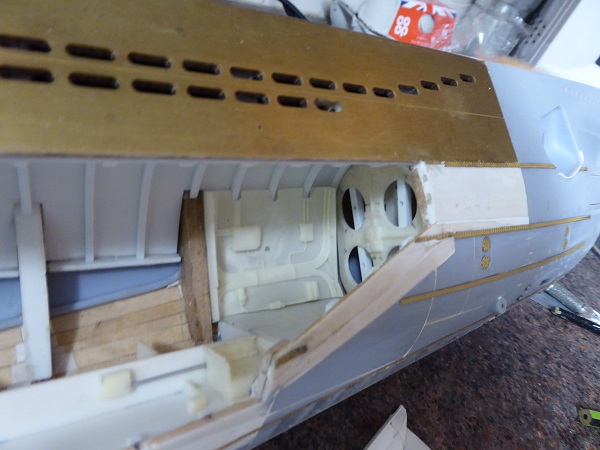

#933 Posted : 12 July 2017 15:19:59
This photo shows the part being test fitted.
#934 Posted : 12 July 2017 15:42:01
After much 'umming and arring'Confused it was clear that the part would not fit correctly and a new approach was required.....Confused
I then referenced some photos of U995 to see how this was configured. It turned out it wasn't fitted, having all it's valves and pipework bolted directly to the t-frames.
I decided to follow the same route meaning I now had to scratch build part of the inner hull and extend the t-frames.
