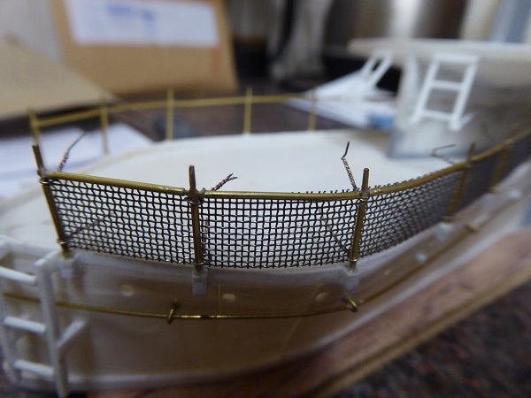

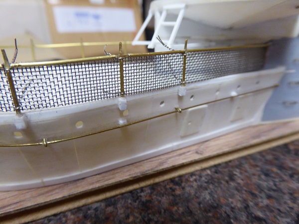

I stripped a very thin piece of electrical wire of it's insulation and then unwound each strand so that I could use each of these strands to wrap around the vertical guard rail supports. By twisting them so that they pulled the mesh in tight to the vertical supports and thus required no glue.
Pretty fiddly work, but now I have a technique, I aim to complete the rest of the mesh by my next update.

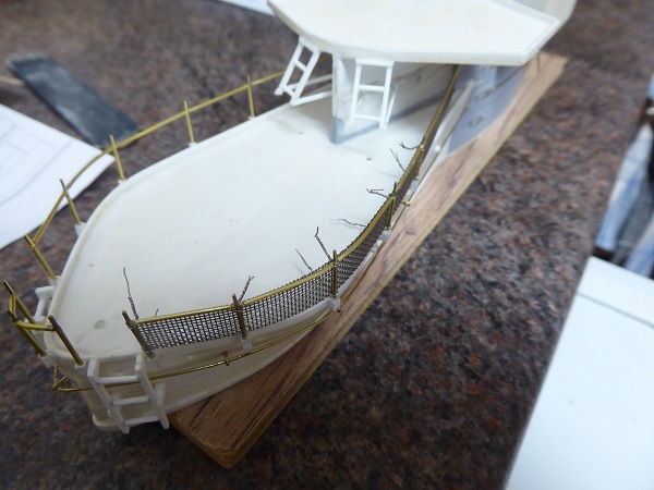

#903 Posted : 25 April 2019 22:55:53
Showing the mesh further along. I cut it as one long piece and trimmed it as necessary.

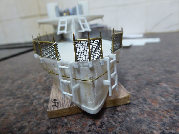

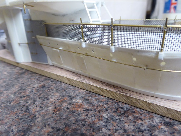

#904 Posted : 25 April 2019 22:57:27
From above showing the mesh attached to the starboard side. At this point I have yet to trim the twisted wire strands that hold the mesh to the vertical guard rail supports.

By twisting the wire strands over and over, they really pull the mesh in tight to the vertical guard rail supports. Not too tigh though, as the wire will eventually snap, as i found out when trying out this technique.

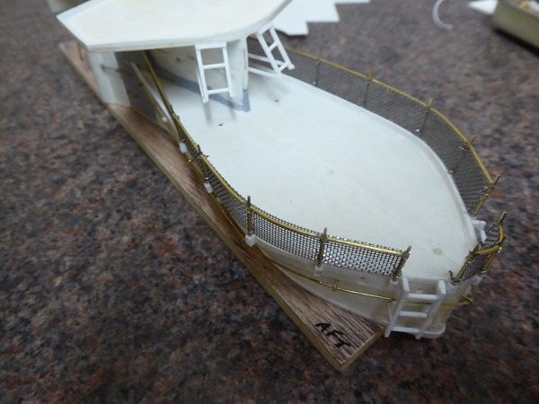

Another quick update this week as I have a long weekend booked and i'm off camping! Could do with being a tad warmer, but there you go! lolLOL
Anyway, I managed to finish the rest of the mesh on the bottom half of the lower deck guard rails.

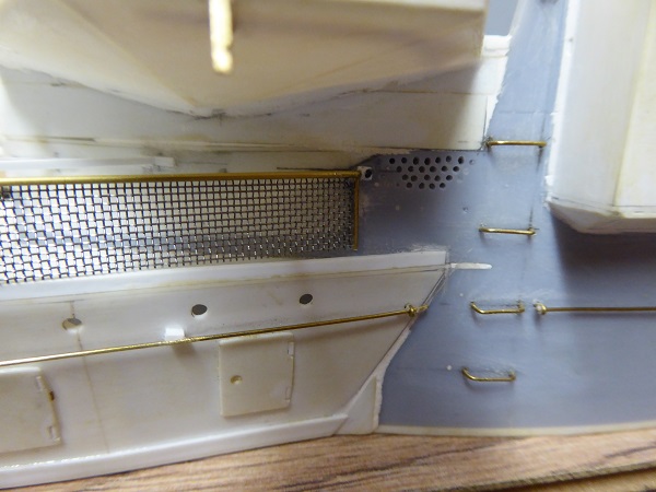

#918 Posted : 02 May 2019 07:21:32
All the wire strands have been trimmed and their ends folded in.

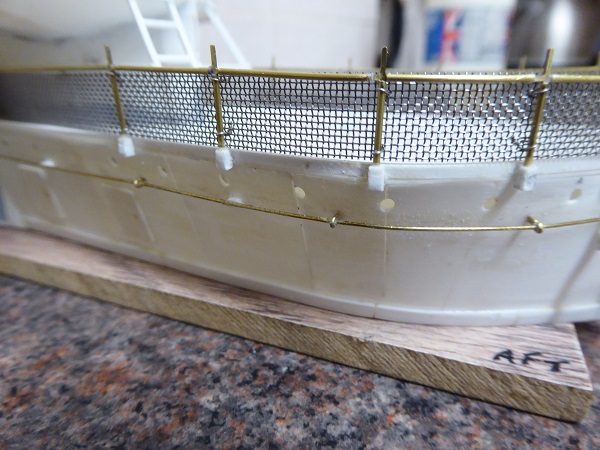

#919 Posted : 02 May 2019 07:22:34
Port side.
#920 Posted : 02 May 2019 07:23:22
From another angle.
