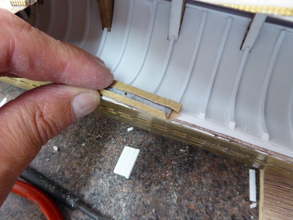

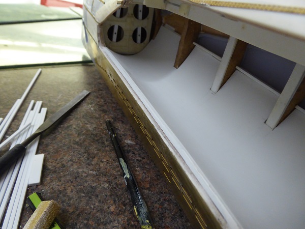

Before I could tackle the t-frames I first had to file and sand the edges where the inner pressure hull meets the external hull.
The attached photo shows the join between the front and rear half of the inner pressure hull being sanded.

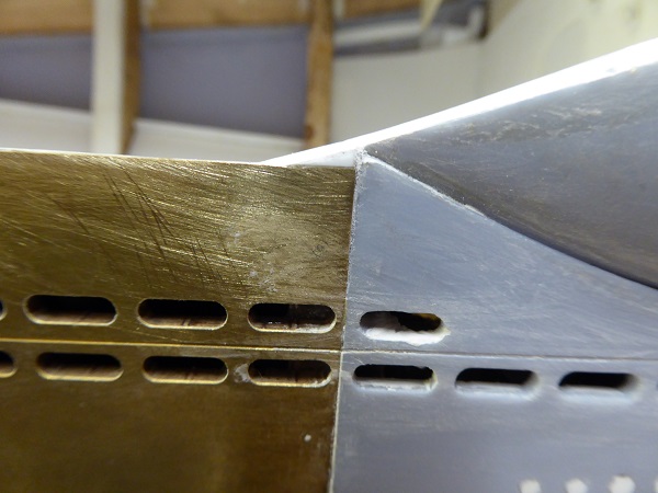

The leading edge was filed, filled and sanded. This photo shows the edge sanded smooth.

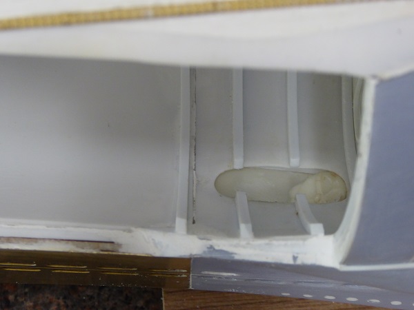

I then glued the 4th t-frame as this one would have to align with the existing mdf support. Once fitted I calculated the required width for a further two t-frames inbetween [12.0mm].
The attached photo shows the 4th t-frame and also the 2nd t-frame in place.

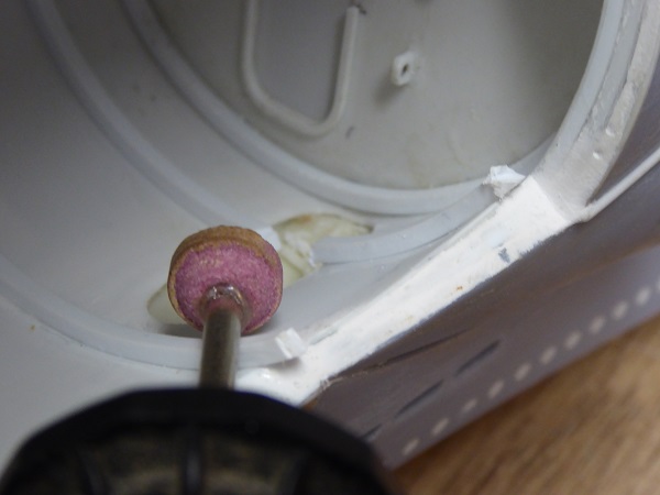

#909 Posted : 10 July 2017 21:22:13
This was followed by a small grinding wheel used to carefully remove the majority that was left before a final sand to ensure the cut t-frame ends aligned with the hatch well profile.

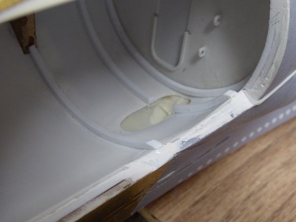

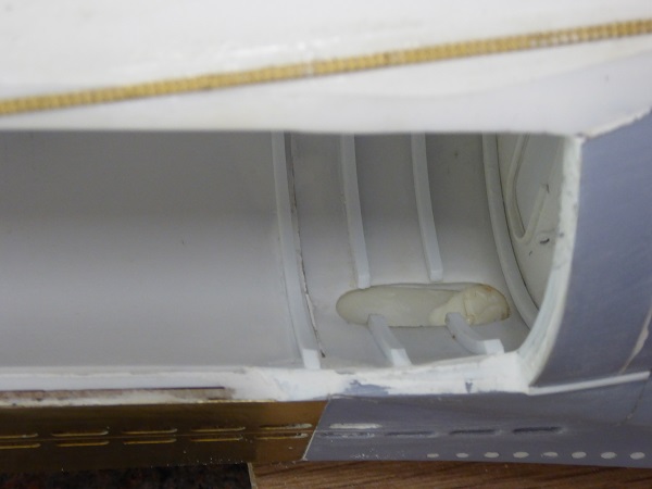

This photo attached shows the 3rd t-frame being fitted.
#913 Posted : 10 July 2017 21:28:21
In this photo you can see the 3rd t-frame being aligned against the 12.0mm spacers I mentioned earlier.
#914 Posted : 10 July 2017 21:29:29
3rd t-frame fitted.

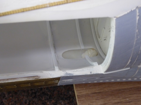

#915 Posted : 10 July 2017 21:31:34
3rd t-frame cut out to accommodate the hatch well using the same method as the 2nd t-frame.
#916 Posted : 10 July 2017 21:32:41
The attached photo shows the 2nd & 3rd t-frames cut and filed to suit the hatch well.

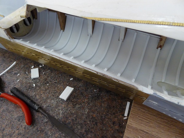

I then continued to repeat the bending/cutting process for the remainder of the t-frames.
The attached photo shows all t-frames fitted.

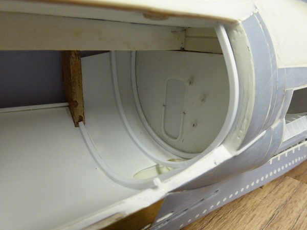

#918 Posted : 10 July 2017 21:37:53
In this photo you see the t-frames being sanded to align them with the bevelled, leading edge.
#919 Posted : 10 July 2017 21:39:09
This photo shows the t-frames when looking aft.
#920 Posted : 10 July 2017 21:40:08
Looking at the t-frames square on.
Guest (10)
