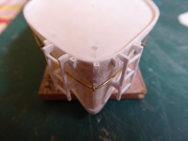

I then continued adding the rest of the supports around the perimeter of the lower deck. The attached photo shows the next two supports fixed in place.

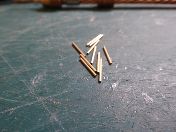

The guard rail is split in two; upper and lower halves. I decided to build up the lower half first as this section will also have gauze attached.
The attached photo shows the 0.8mm diameter brass tube cut into 10mm lengths that will make up the vertical rails for the lower section.

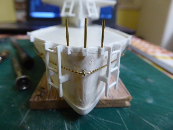

#863 Posted : 11 April 2019 22:11:50
Three of the vertical guard rails temporarily fitted.

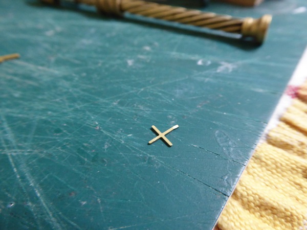

To make up the horizontal rails i used Albion Alloys 'Connecto' which is bought in pack form and contains PE of different shapes. Each 'leg' of these shapes slides into the corresponding brass tube; in this case the 0.8mm diameter tube has an internal diameter of 0.6mm and the PE shapes have a width of 0.6mm. You can buy differing sizes that fit into the corresponding brass tube and all sorts of shapes can be made up using this clever product.
#865 Posted : 11 April 2019 22:16:54
This photo shows one of the PE shapes.

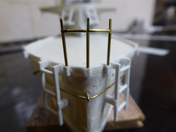

By carefully bending the brass tube using brass rod slid inside to prevent crimping, i formed the correct curve and cut it into two lengths. I then attached theses two horizontal guard rails to the vertical ones.

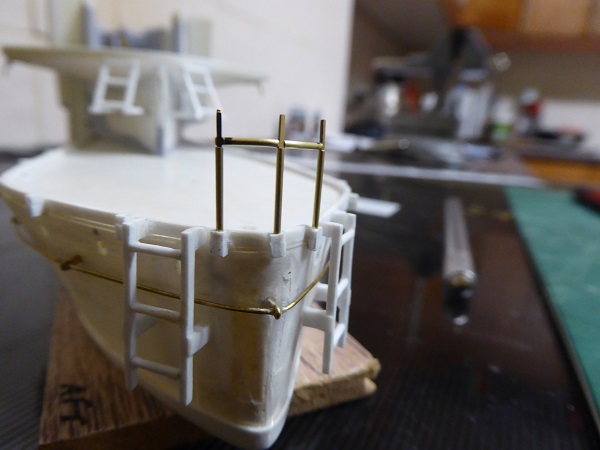

From another angle.
I'm pretty pleased with the way it's gone so far, albeit fiddly, which is good as making the guard rails for the lower deck and upper deck will take awhile!Blushing Blink LOL
