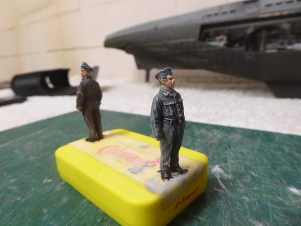

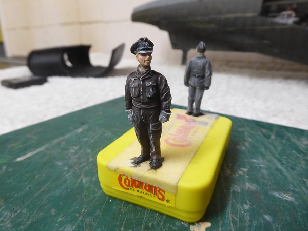

I then finished the painting of 2 crew members who will positioned within the bunk spaces. The attached photo shows an officer.
#845 Posted : 28 October 2021 19:46:02
Junior Rate.

Nice work as always Phil! Drool ThumpUp
Like the way you've used the 'dry brush' technique on the figures and glad you didn't try to paint in the whites of their eyes - it always looks like they have a 'thousand yard stare' when people do that in this scale! Some very sensible and realistic painting on those figures given their small scale, well done!
Kev

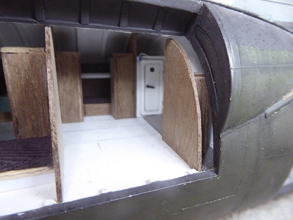

#848 Posted : 04 November 2021 18:03:51
So this past week has seen the final push to complete the Officers Accommodation space.

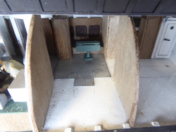

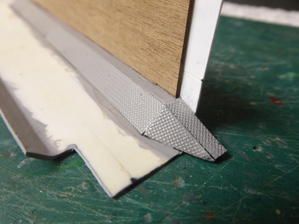

The attached photo shows a walnut bunk divider fitted along with a strip of deck plate next to the bulkhead.

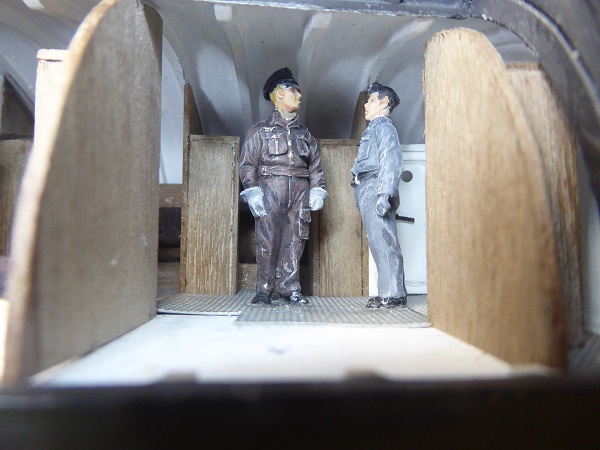

#849 Posted : 04 November 2021 18:07:43

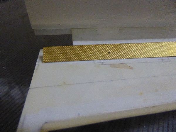

This photo shows more deck plate fitted. I also fitted an Officer briefing a Junior Rating before he goes on watch.

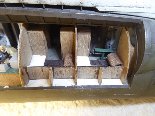

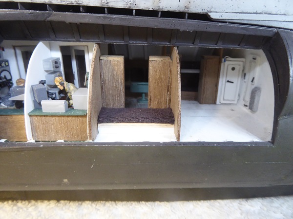

In the attached photo, there's quite a bit of progress on show.
First off i fitted a mess table with a foldable side.
I then added the last of the walnut wardrobes along with the two lower bunks, one of which is an Officer's, while the other is a Senior Rate's.
I then made up 2 pillows using a piece of cardboard as a base. I folded a piece of tissue paper onto itself a few times, to give the pillows depth and stuck them down with double-sided tape to their respective cardboard bases. Finally i cut a strip of white cotton, just slightly wider than the cardboard bases and stuck a piece of double-sided tape to one side. By folding it around the tissue paper and the bottom of the carboard base, i could then pinch the edges to seal it all.
The sleeping bags were made from cotton jersey, very thin. Cut to the length of the bunk and double the width, i rolled each one, fastened each end with double-sided tape and then fixed each piece to their bunks using more DS tape.
The last part was to make the walnut locker sides that edge each bunk. When fitted, i divided each space giving me 4 locker spaces using two pieces of walnut.

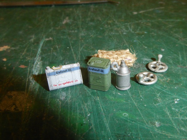

#852 Posted : 04 November 2021 18:26:26

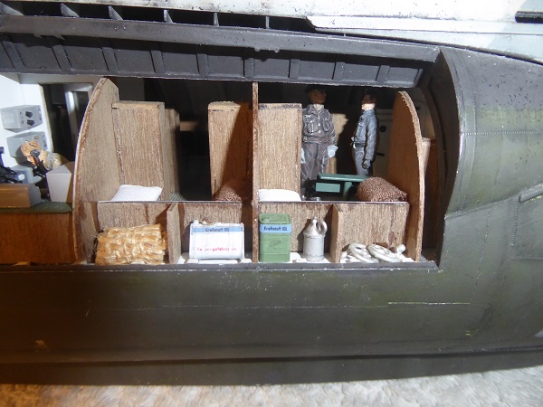

Oil cans, hessian sack and valve handwheels stored in the spare parts lockers.
#853 Posted : 04 November 2021 18:32:09
That concludes this weeks update and sees the completion of the Officers Accommodation space!BigGrin Love LOL Flapper

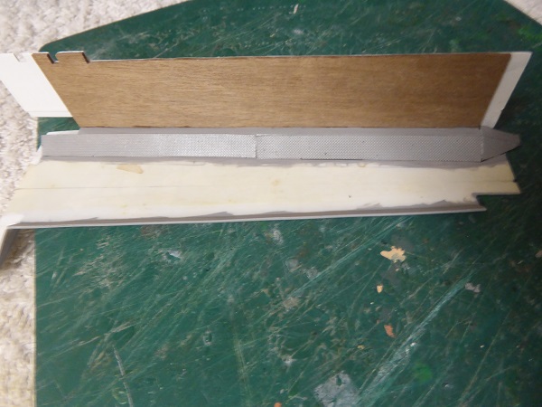

#854 Posted : 11 November 2021 22:46:54
So this week saw me make tentative steps towards fitting out the final compartment of this build; the Torpedo Compartment!

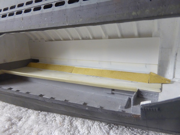

A couple of evenings were spent looking over photos, pondering, rubbing of the chin and more pondering!LOL I also had to order more modelling supplies, so progress has been slow this week. Fortunately, i scratch-built a basic deck area way back in Nov 2015 and have kept it safe until now, 6 years later!Blink
The attached photo shows the deck area i mentioned. I added a higher side to it, plus deck plate on the tapered sides. In reality, these deck plated areas were in fact lockers and when opened, revealed the stored torpedoes.

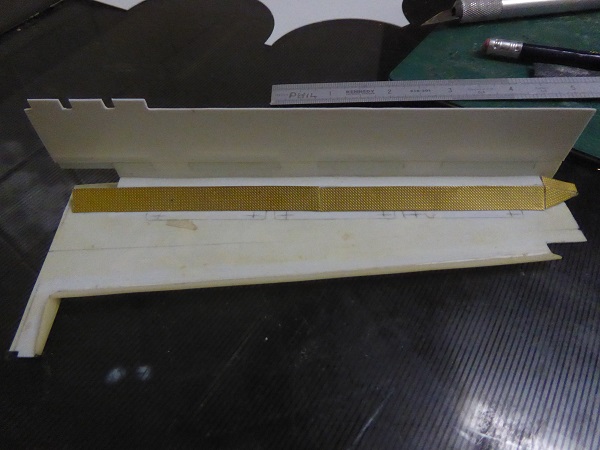

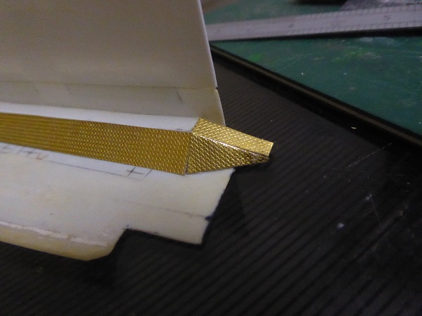

#855 Posted : 11 November 2021 22:49:10
Close up of the rear section.
#856 Posted : 11 November 2021 22:50:14
Close up of front section.
