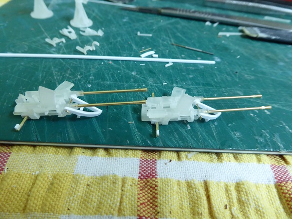

This weeks update sees the modifications carried out on the two 2.0cm Flak 38 guns that will be located on the upper deck of the conning tower.
These two guns were bought as 3D printed items, but suffered from being very fragile and so it was necessary to replace the smaller details making them more robust in the process.
I also wanted the guns to pivot on their mounts so that I can have them aimed upwards which meant scratch-building the 'a-frames' that connect the guns to the their mounts.
For these i used 1.0 x 1.5mm plastic strip, with one length bent around a needle file handle to obtain the correct curve. I also drilled through the guns with a 0.5mm diameter drill so I could insert a brass rod, cut to length to act as pivot point. See attached photo.

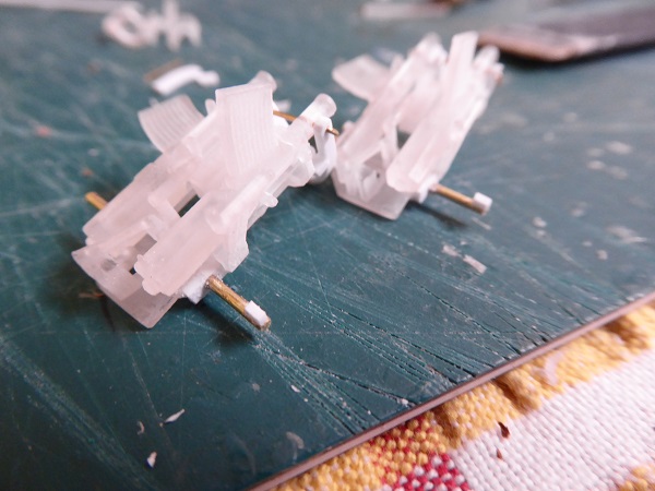

#830 Posted : 28 March 2019 23:25:07
From another angle with the original parts next to them.

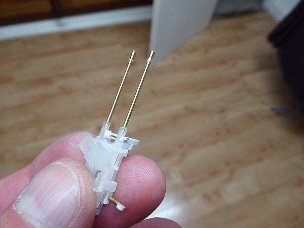

I then proceeded to fit the after-market gun barrels. I posted a description of these gun barrels in a previous thread.
#835 Posted : 28 March 2019 23:30:22
From another angle, showing both guns fitted with their double barrels.
#836 Posted : 28 March 2019 23:32:59
That concludes this weeks update. Next week I will continue adding details and replacing fragile parts on these guns and their mounts.
Thanks for looking in, have a great weekend and happy modelling!BigGrin
