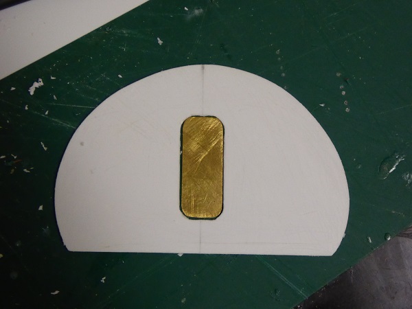

The brass bulkhead door being checked for fit.

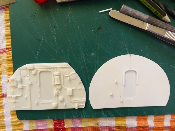

In this photo you can see the difference in size between my bulkhead on the left and the AMP on the right.

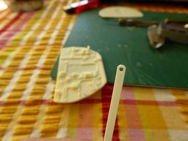

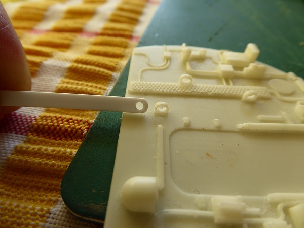

I decided to make my own based on the measurements I collated from the AMP.
The eyelets were made from 3mm x 1mm plastic strip. I drilled a 1.6mm hole through the strip to form the eyelet itself. I filed the curve around one end and cut the other end to give me the correct length. I made three in total.
The attached photo shows the first eyelet drilled and filed prior to cutting compared to the AMP part.
#824 Posted : 15 June 2017 18:13:29
A close up of the eyelet prior to cutting.

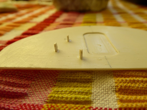

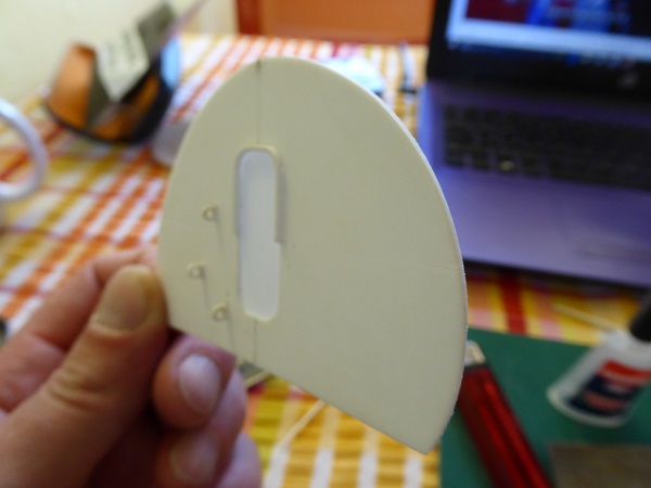

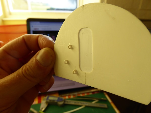

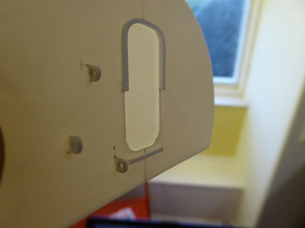

After transferring the measurements for the eyelet locations over to the new bulkhead I glued all three in their respective places.
The attached photo shows the eyelets fixed in place.
#828 Posted : 15 June 2017 18:35:35
From another angle showing the eyelets attached.
#829 Posted : 15 June 2017 18:36:58

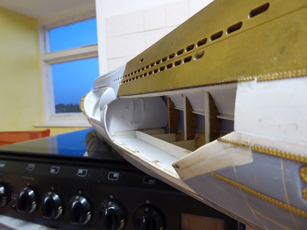

This photo shows the different locations of the eyelets that were used for lowering torpedoes down into the U-boat.

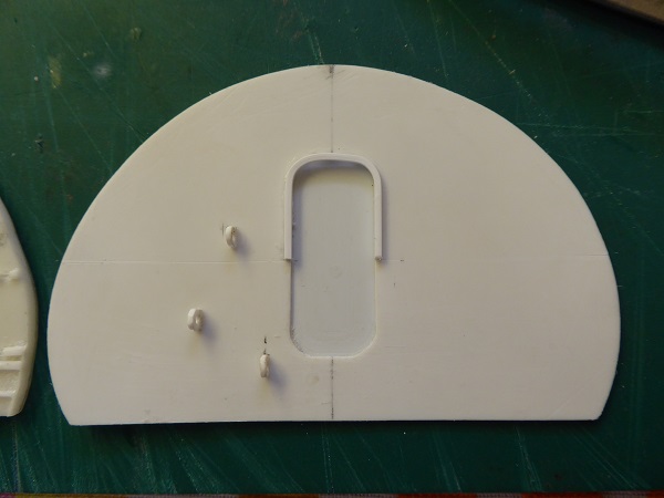

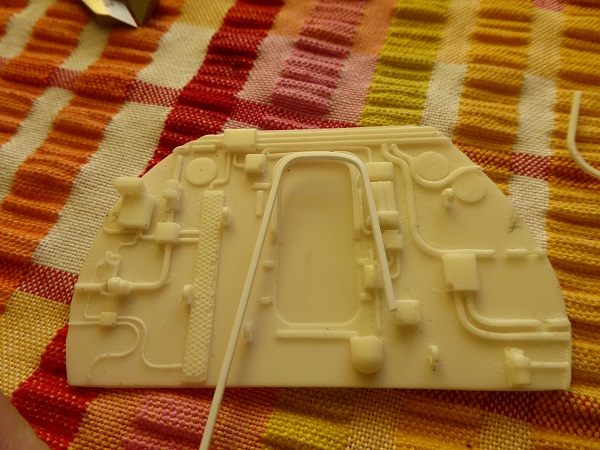

The next job was to make the bulkhead door surround to mimic what was on the AMP. For this used 1.0mm square plastic strip. Having marked out the start and finish of the surround on the bulkhead, i bent the strip around a 5.0mm drill bit to form the curved corners. Superglue was applied to the edge to fix in place.
The attached photo shows the strip being compared to the AMP bulkhead.
#831 Posted : 15 June 2017 18:43:16
Surround fitted and compared next to the AMP.

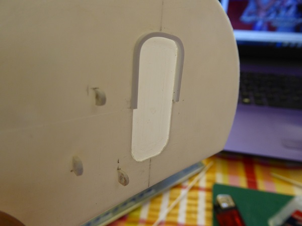

#832 Posted : 15 June 2017 18:44:19
A close up of the new bulkhead.
#833 Posted : 15 June 2017 18:45:15
Looking from the left.
#834 Posted : 15 June 2017 18:48:06
Looking from the right.
#835 Posted : 15 June 2017 18:49:26

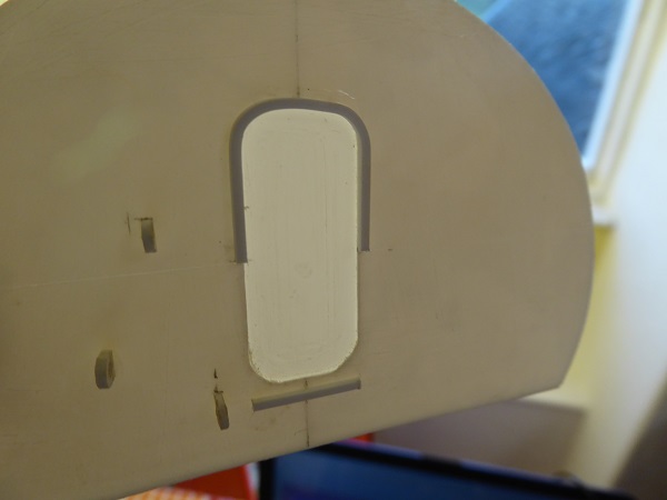

I also fitted a smaller, straight piece under the bulkhead door opening.
#836 Posted : 15 June 2017 18:50:39
The completed aft bulkhead looking side on.
#837 Posted : 15 June 2017 18:51:45
A close up of the completed aft bulkhead.
#838 Posted : 15 June 2017 18:53:22
The torpedo compartment aft bulkhead completed and fitted in place.
#839 Posted : 15 June 2017 18:56:10
A distance shot of the aft bulkhead.
