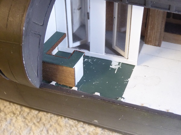

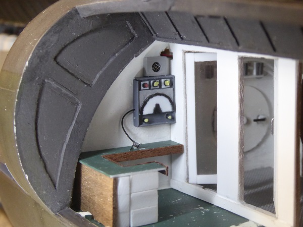

I then fitted out the worktops for the Wireless Transmission [W/T] shack. The height is made up of short lengths of 4mm square section acetal, giving a height of approximately 2 feet in real life when stacked giving a model height of 12mm. This is about right, as i measured the height of my knee when sat down, so know the proportions are about there. The tops were painted green and the edges lined with mahogany veneer. The deck at this stage looks a little scuffed while i fitted out the access doors, but i'm going to leave it as is, thinking that the watchkeepers stools would of worn it like that.
#803 Posted : 14 October 2021 21:06:46

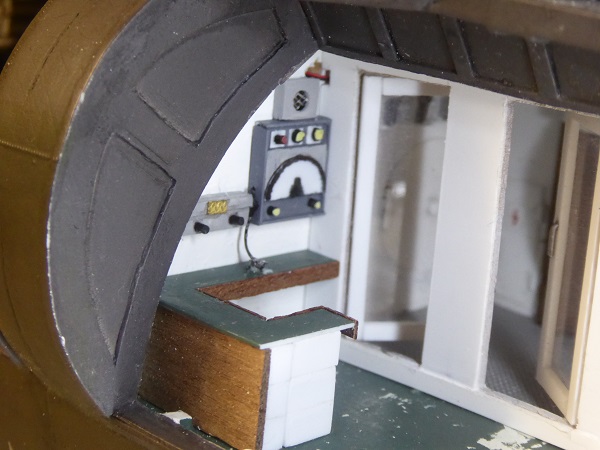

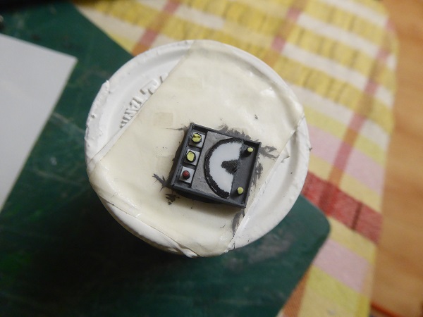

The W/T shack is fitted with all manner of amplifiers, transmitters and receivers. The first item i made is a morse code translator, i believe. Acetal sheet of varied thickness was glued together to give the profile and the knobs were made of 1.6mm and 1.0mm diameter acetal rod, cut to length, painted matt black, glued in place and their tops painted either red or yellow. The bearing indicator was made from 0.25mm thick acetal sheet using a compass cutter and the edges and dial indicator drawn on free hand.
#804 Posted : 14 October 2021 21:08:20

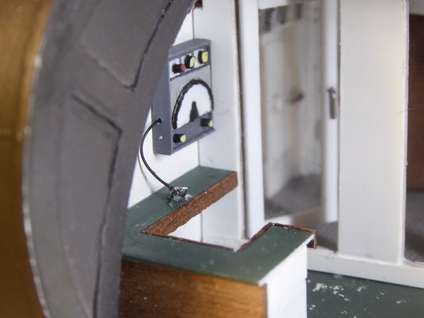

Device fitted with the morse code tapper and connecting wire.
#805 Posted : 14 October 2021 21:09:32

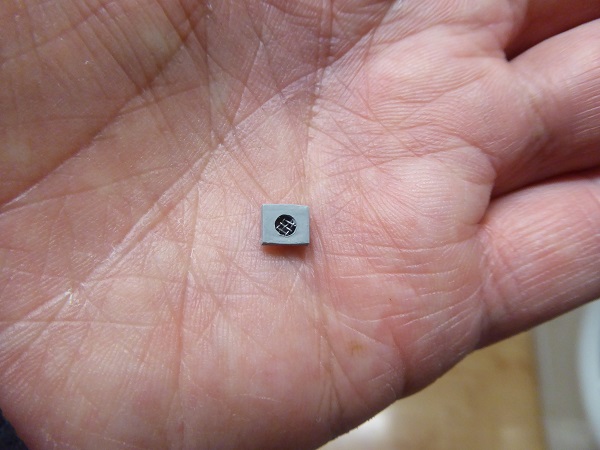

A tiny speaker made up using acetal sheet and a bit if wire mesh. This speaker was so that watchkeeper can hear orders sent around the U-boat.
#806 Posted : 14 October 2021 21:09:54
Speaker fitted.

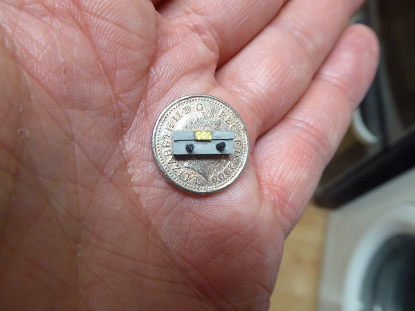

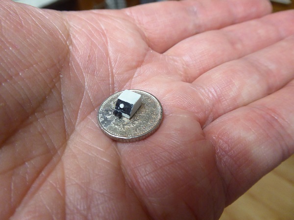

The next item i made was an amplifier. Pictured against a 5p coin to give an idea of scale.

Amplifier fitted.

I then made a reciever [?] from a 4mm square section acetal, cut to length, front face filed at an angle and a couple of black knobs added, made from 1.0mm diameter rod.

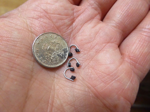

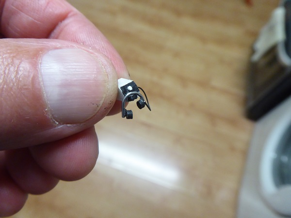

I then made 3 sets of headphones. Using 2.0mm diameter acetal rod, i cut 6 discs, painted them black and joined them together via a small length of 0.7mm diameter solder. I test fitted each set on to the head of a watchkeeper, so i know the proportions are about right.
#811 Posted : 14 October 2021 21:18:48

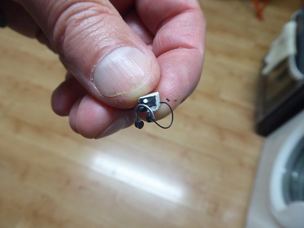

One set of the headphones, plugged into the receiver and hanging off the two knobs.
#812 Posted : 14 October 2021 21:20:26
From another angle.

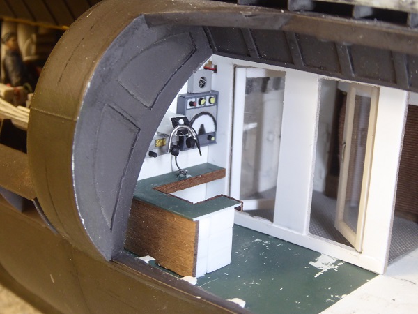

Receiver and headphone set fitted.

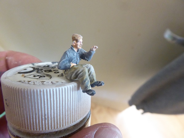

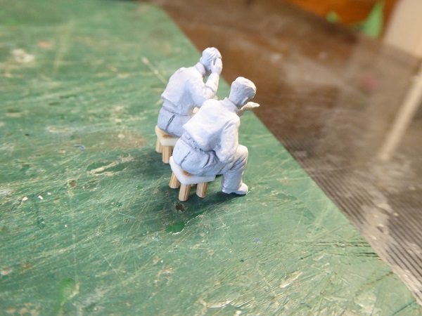

More progress this week on fitting out the W/T and Sonar shacks.
The attached photo shows the W/T watchkeeper, painted and pin washed.

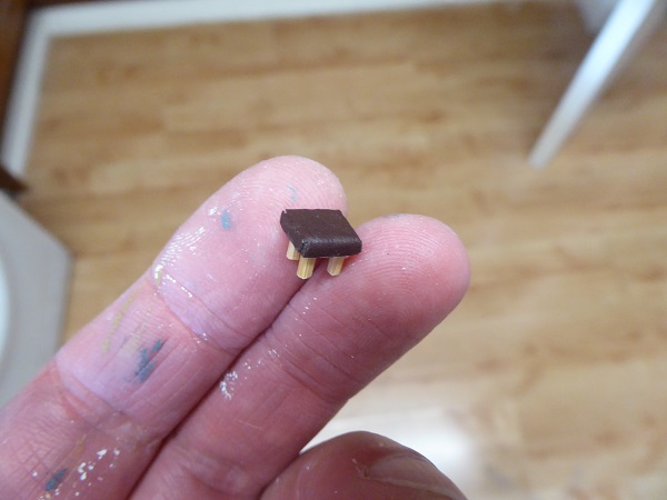

#820 Posted : 21 October 2021 18:49:25
The watchkeepers seats were then covered in leatherette. Only one shown here.
